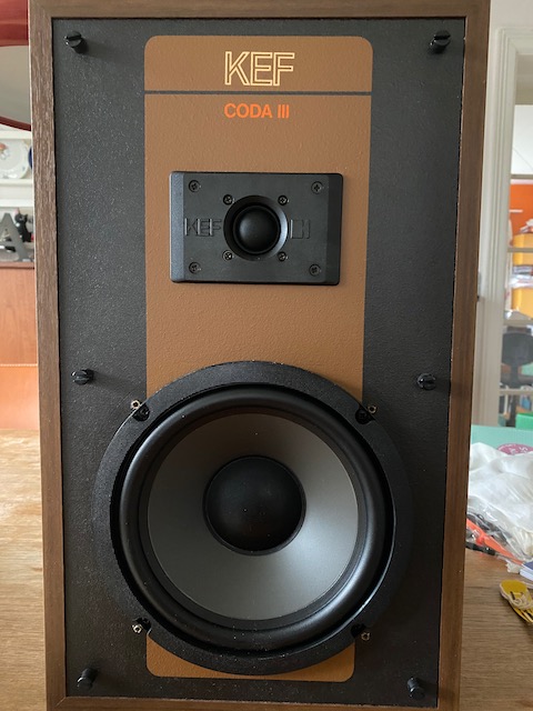

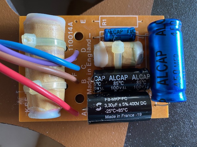

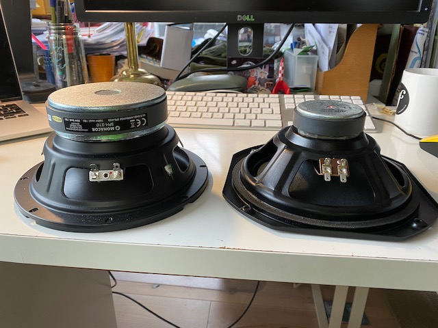

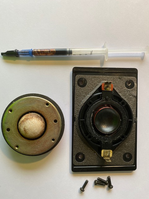

Restored KEF Coda III
Hi
I restored a pair of KEF Coda III back into working condition for a family member.
- New ferrofluid for the tweeters
- New capacitors for the cross-over
- 2 new Monacor SPH-210 bass-midrange speakers
Tom
