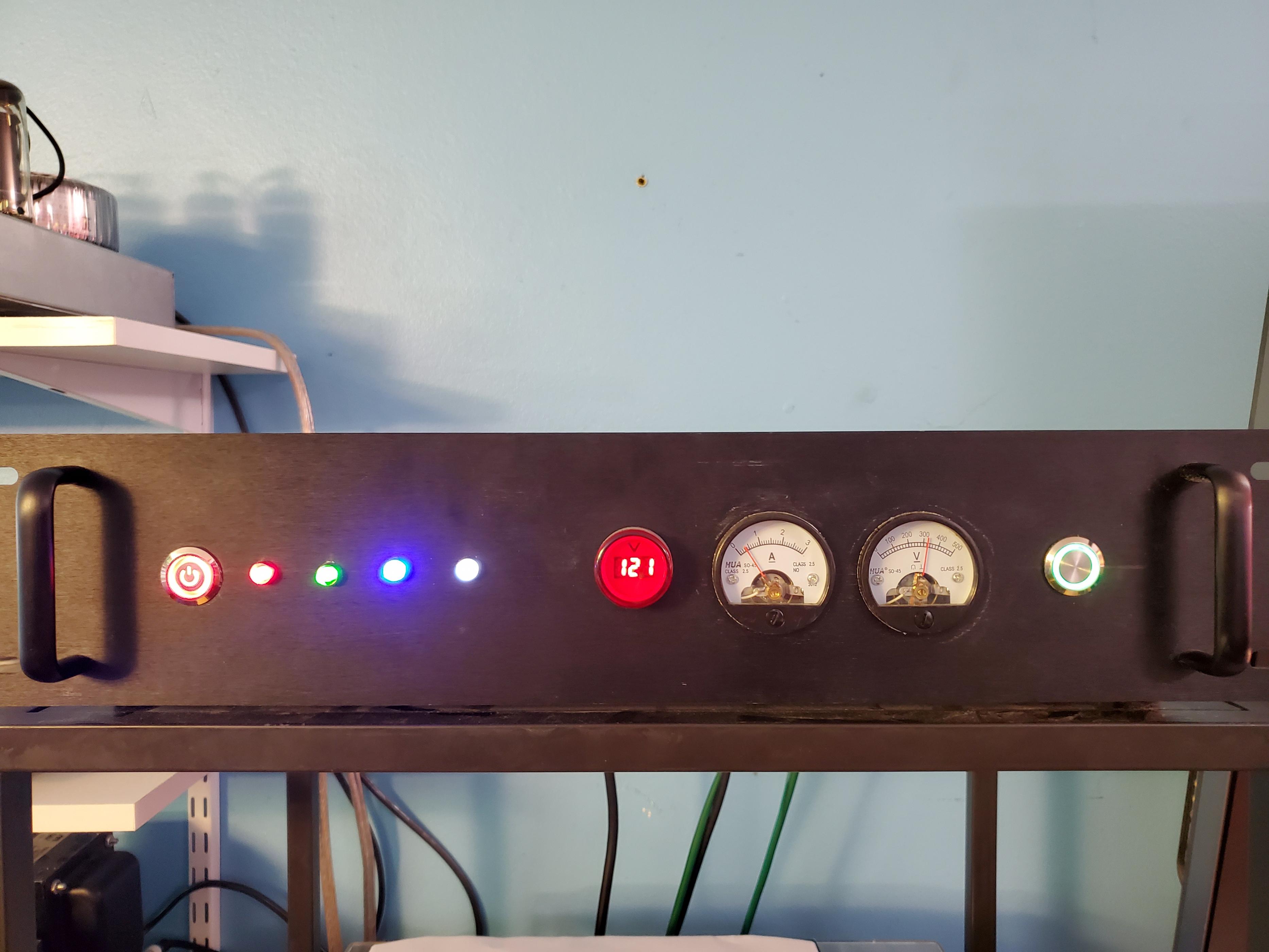

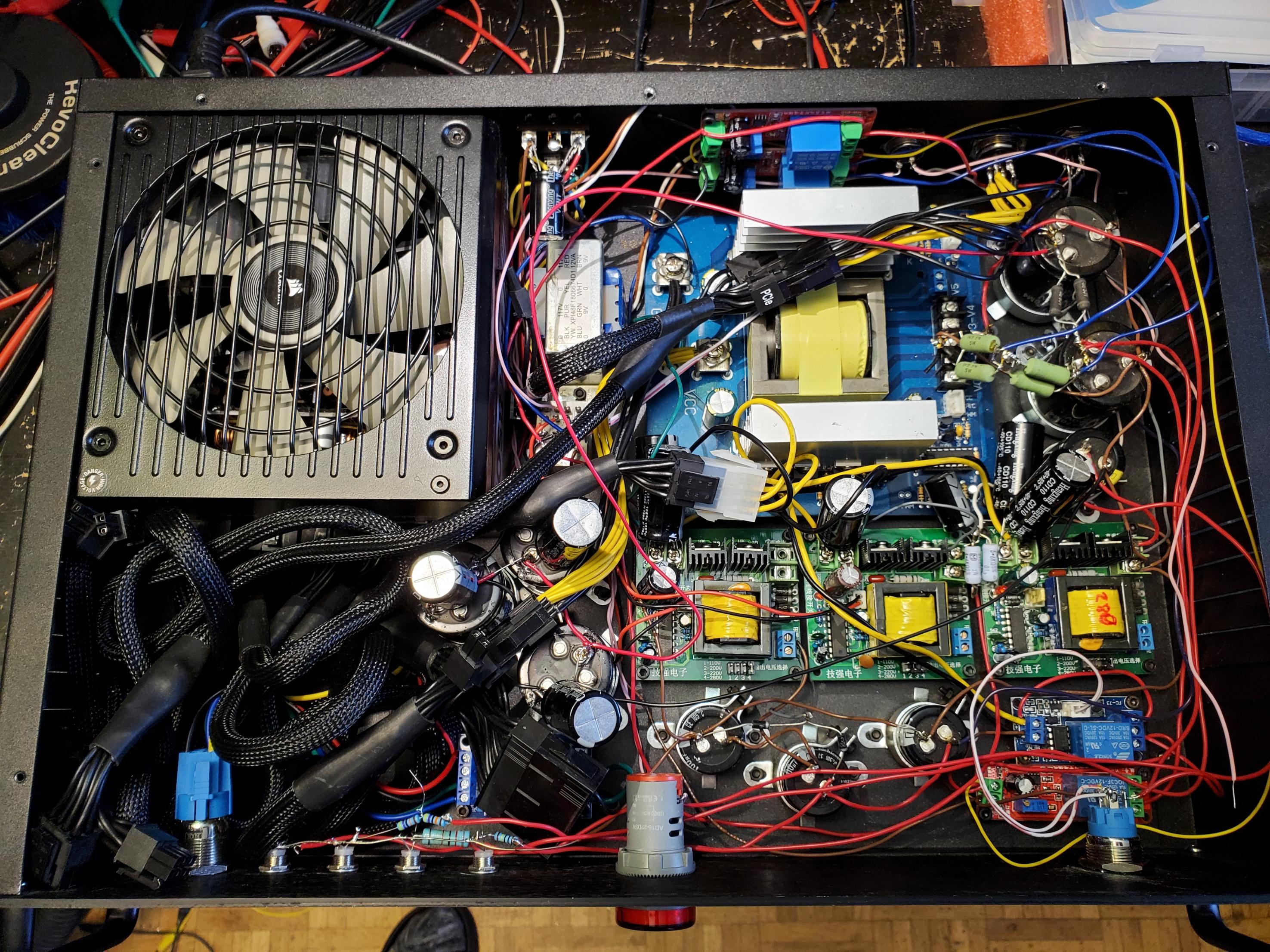

Today was more of an upgrade / mod than a repair, but I changed the output transformers and output tubes in my IA from 6P36S on 2k2 to 6P45S 1k.
Also upgraded the power supply with 50,000uF on the 12V and another 2000uF on the 320V, and made the time delay longer to accommodate the extra capacitance avoiding OCP. Lowered some 5R to 3R3, and changed the 10R in the amp to 5R. They gets about 5 volts less drop on the B+ at high power.
Also changed the bias supply from -110V to -200V and added an RC dropper to allow for 75 / 90 / 105 VR tube for the bias regulation.
And then I added a voltmeter and an ammeter to the PSU. All while my lover sleeps 5 feet away (I dunno how they slept through the drilling of the 44mm holes in the face plate...
All in all, an eventful morning!

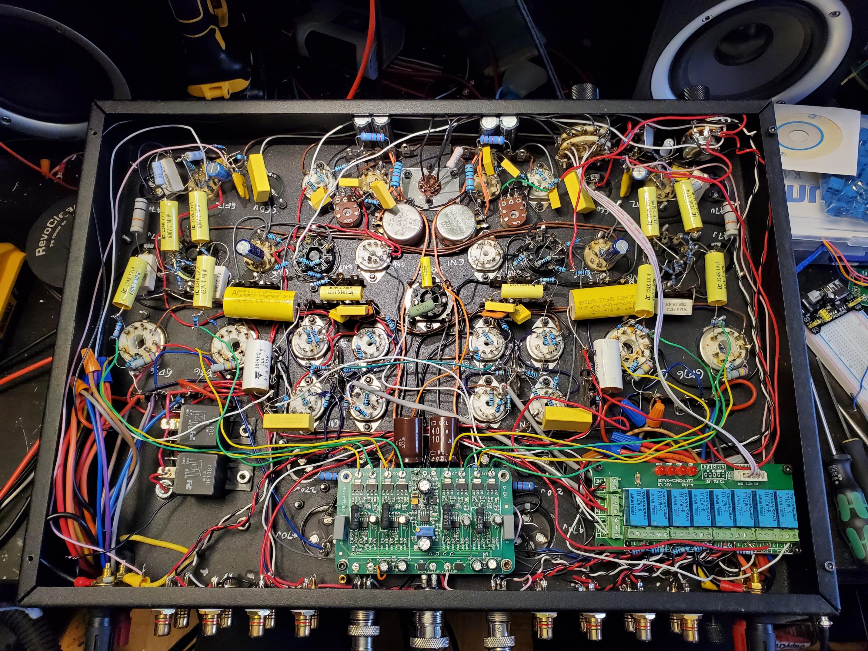

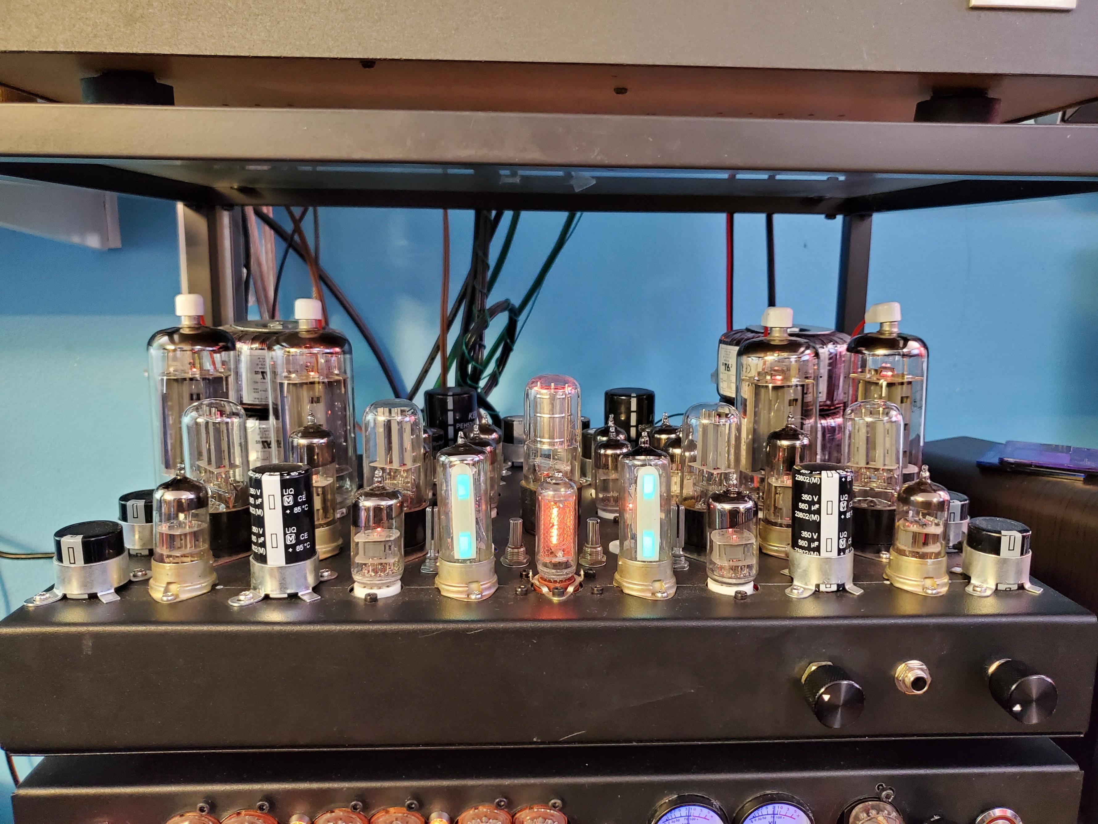

Yup...
It powers this like in the middle picture in my last post...
It has a phono stage (only get power when you set it to phono (0) though.
Also a headphone amp/line amp based that will drive 32R (even if only at a few mW - I use 470R ATH-R70x).
~80W 6P45S trioded output stage...
6E2 Level meters
6 input board for 5 +phono input. 2 pre out, 2 line out.
The empty sockets housed a HP filter for the phono, but I thought it was trash, so I left them there as a place holder for if i try and add balance and tone control...

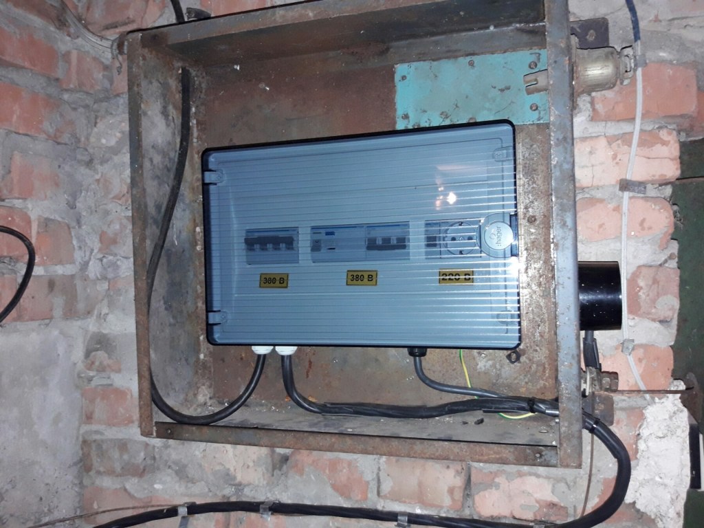

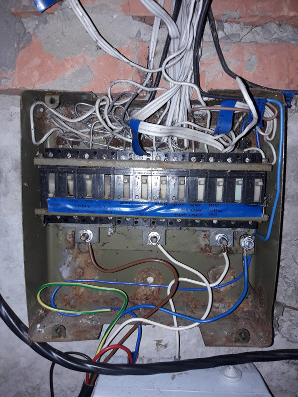

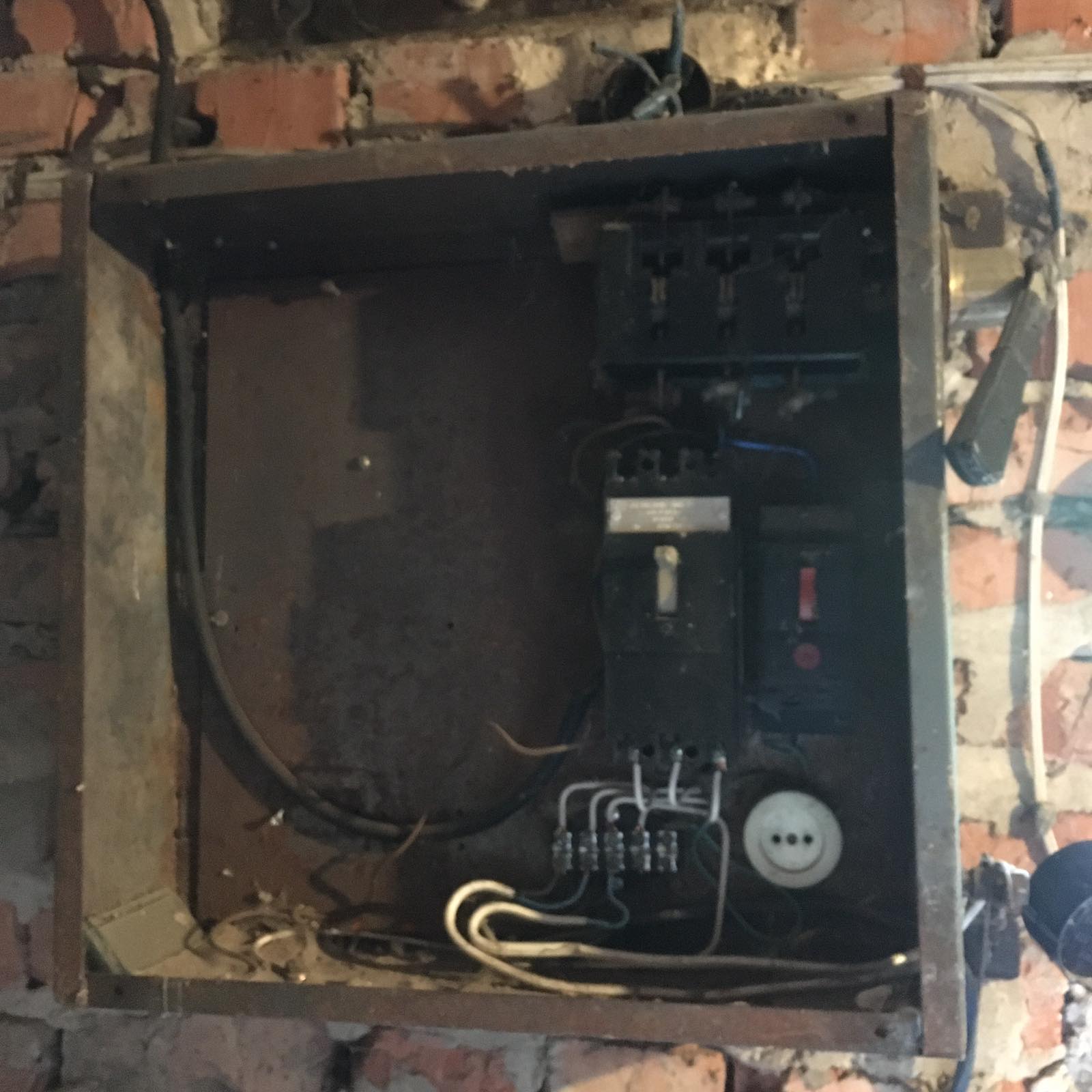

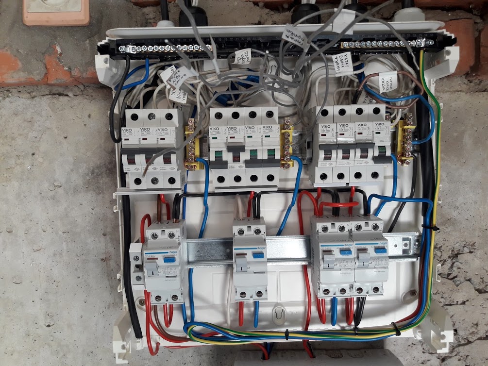

I made not repair but rather an upgrade for my parent's house old mains input cabinet and distribution cabinet. It was only equipped with old soviet circuit breakers but now it has RCDs too.
The main cabinet moved from this:
to this:
And distribution changed from this:
to this:
I believe it is much safer now.

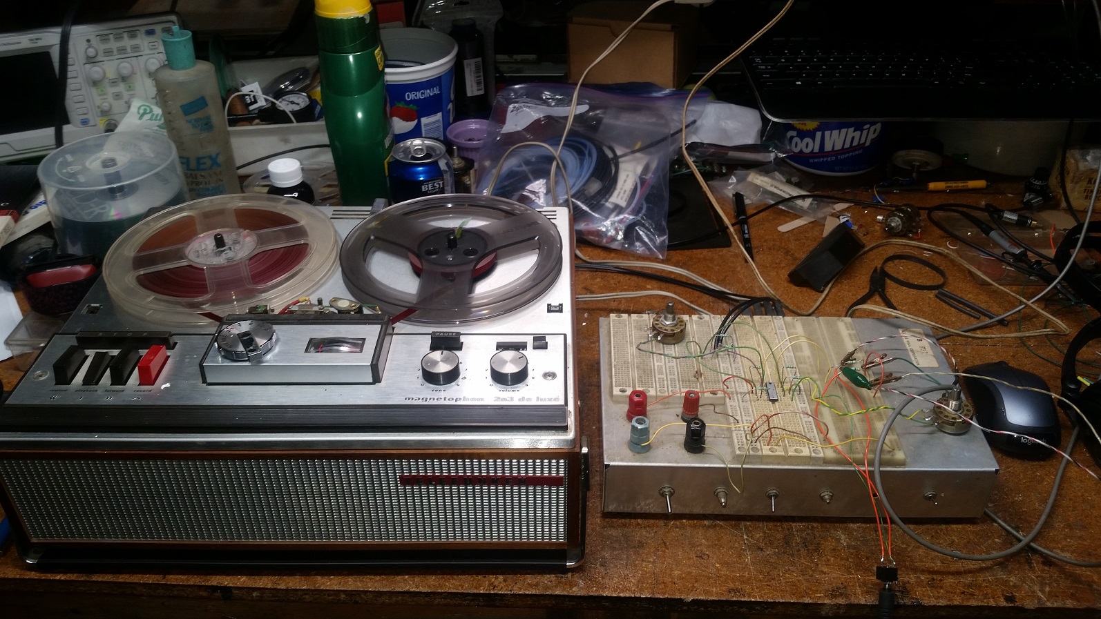

I am working on an old Telefunken Magnetophon 203 De_luxe.
It was my fathers.
He passed away 10 years ago and I finally got the belts I needed to get it going. I have been replacing caps in the PS section and got most of the hum out. I'm debating replacing the coupling caps as well.
It is good enough now to start digitizing the 37 tapes I got with it.
I had to breadboard a buffer amp as the output from the line out was too low to drive the audio card in my computer.

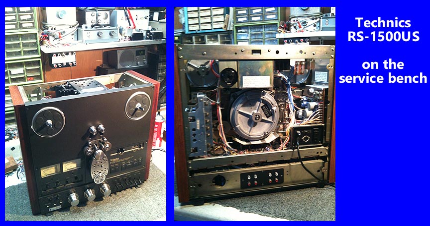

A lovely cool day to do some more servicing to that Technics reel to reel.
Some dirty switches, relubing the mechs, and alignment are on the list.
Biggest damn flywheel I ever seen in a tape deck!
Whoa - nice Iso-Loop porn there. And that flywheel looks like it could knock off a fingernail.
Actually, this brings to mind a question (to which I feel I should know the answer by now, but I don't) about dual-capstan systems like this, also the many cassette drives of the day: What mechanism is it exactly that maintains the exact proper tape tension across the heads in this setup?
The only thing I can guess is that the leading capstan is attempting to "push" the tape at a slightly slower speed than the trailing capstan is pulling it. Is that how it works? If this is correct, how is it achieved? I suppose the leading capstan could be machined to an ever-so-slightly smaller diameter, but I guess it would be easier to make its drive pulley slightly larger? Or is there something else altogether going on here?

Well Jim, this Technics rs-1500 doesn't have "dual" capstans, just one.
What you see is..... the top large drum IS the capstan, (on the same shaft as that huge flywheel inside - Direct Drive) flanked by twin pressure rollers, the lower large drum is merely an idler that basically drives the tape counter, and acts as a secondary smaller flywheel.
Above the capstan are a pair of tension rollers that control tape tension across all 4 heads and 6 tape guides.
The reel motors are controlled by a complex logic system with several IC's - and they also control tension as needed.
Very sophisticated machine this is - but then again, it's a Technics.
In dual capstan cassette machines, the belt/flywheels are designed to slip so that tension is always applied to the head block.
The "driven" flywheel does the "pulling" and the other flywheel does some slipping.
