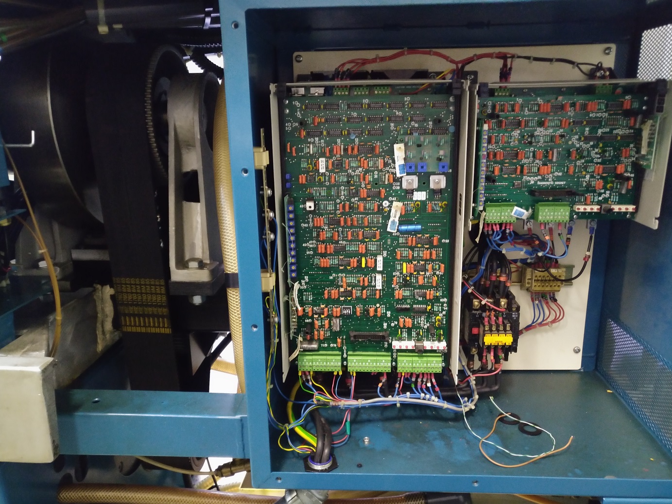

I repair everything because it’s my job, but this is interesting, Leslie Hartridge from 1986 with faulty 11kW DC motor drive modules, most of the tantalum is shorted, now I’m looking for new modules.

It's quite a sad state of afairs wiseoldtech. I have repaired many things for peanuts that I was told I'd have to replace an entire module at significant cost.

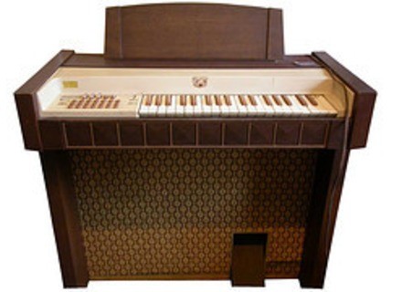

Jim, you ever hear of the Optigan organ?
I had one come into the shop once about ten years ago.
They were made around the late 60's into the 70's.
Weirdest thing I ever came across!
The thing played optical disks.
This one was stereo, the disks were driven by an idler wheel similar to ones used on record changers.
Had a pathetic stereo amp and speakers, but I hear they're quite rare these days.
I had to completely overhaul the keyboard because the leaf switches were corroded, rebuild the amp, etc etc....

Sure, we used to sell those damn things! Had a big old box of spare parts in the shop that eventually went into the Dumpster probably 20 years ago. About the cheapest junk I ever worked on, but an interesting concept - one of the first sampled keyboards, heh!
I still have a few box sets of those funky sound discs in the closet. Awhile back I got it into my head that it might be a fun project to scan them, then write some code to "read" the circular audio tracks from the bitmap graphic files into .wavs. But once I started doing the math on stuff like scanner resolution, backlighting, etc. etc., it seemed like the end result wouldn't be worth the effort. I think it would probably make more sense to just rig up an LP turntable with some kind of optical sensor & do it the old-fashioned way, albeit one track at a time. (This is currently Item #132 on Jim's Big List of Grandiose Plans.)
I saw a website once that was selling discs (CDs that is) with dubs from the original factory masters (on 35mm mag tape!) used to make the optical discs, but they weren't cheap! Dunno if they're still around. They did have some fun/goofy stuff on some of those optical discs - cheesy Hammond organs, scat singing, the works. We actually had fun with them back in the shop, but man, what a piece of crap. :p
