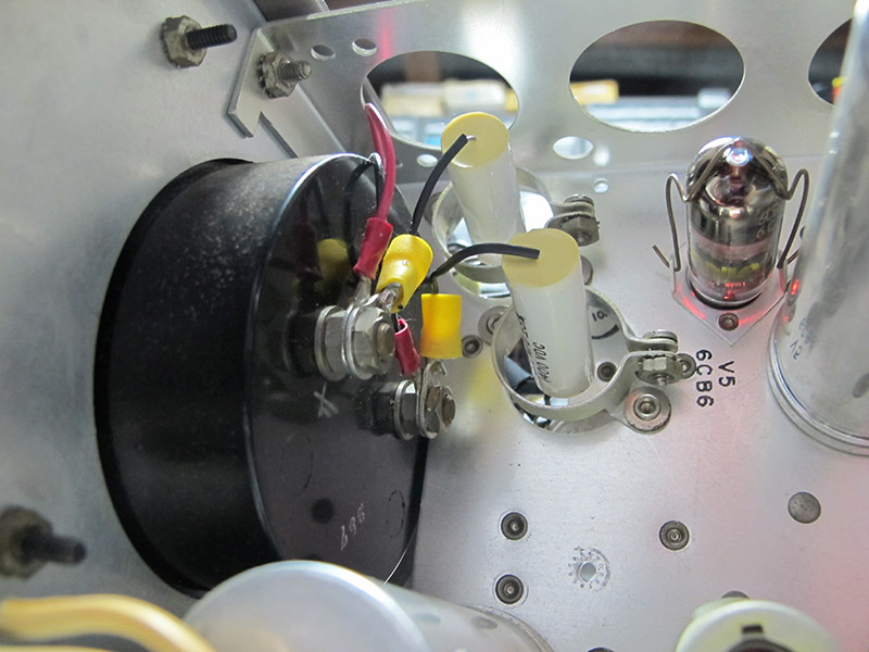

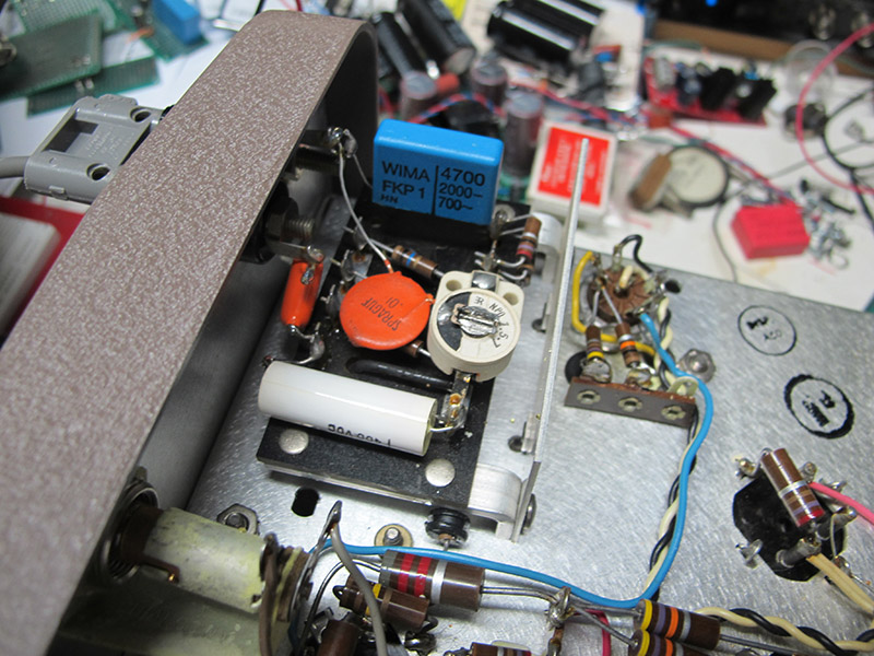

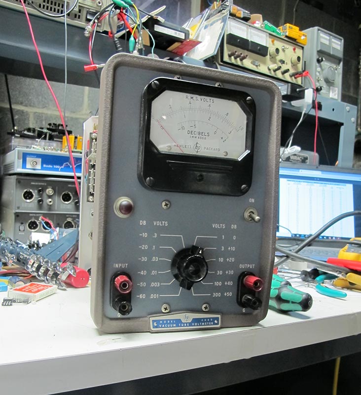

Today I repaired an HP400D purchased a few years back from a ham radio guy. It wasn't expensive. The input capacitor was leaky and the mica on the input way out of spec. One of the 6CB6's was weak and replaced. 1uF/400V meter capacitors replaced. The early silicon diodes were way off spec, one measurng Vf of 1.6V, the other 4.4V.
Why a panel meter in this era of digital -- it can monitor the output of my THD analyzer and tell me how much I am heading in the correct or wrong direction with the adjustments.
Works great!
Works great!
Looks good. Too bad about the diodes, they have a nice vintage look. What's up with those caps? They replaced cans?

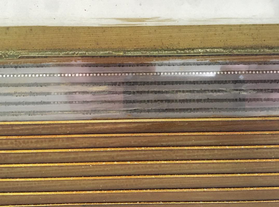

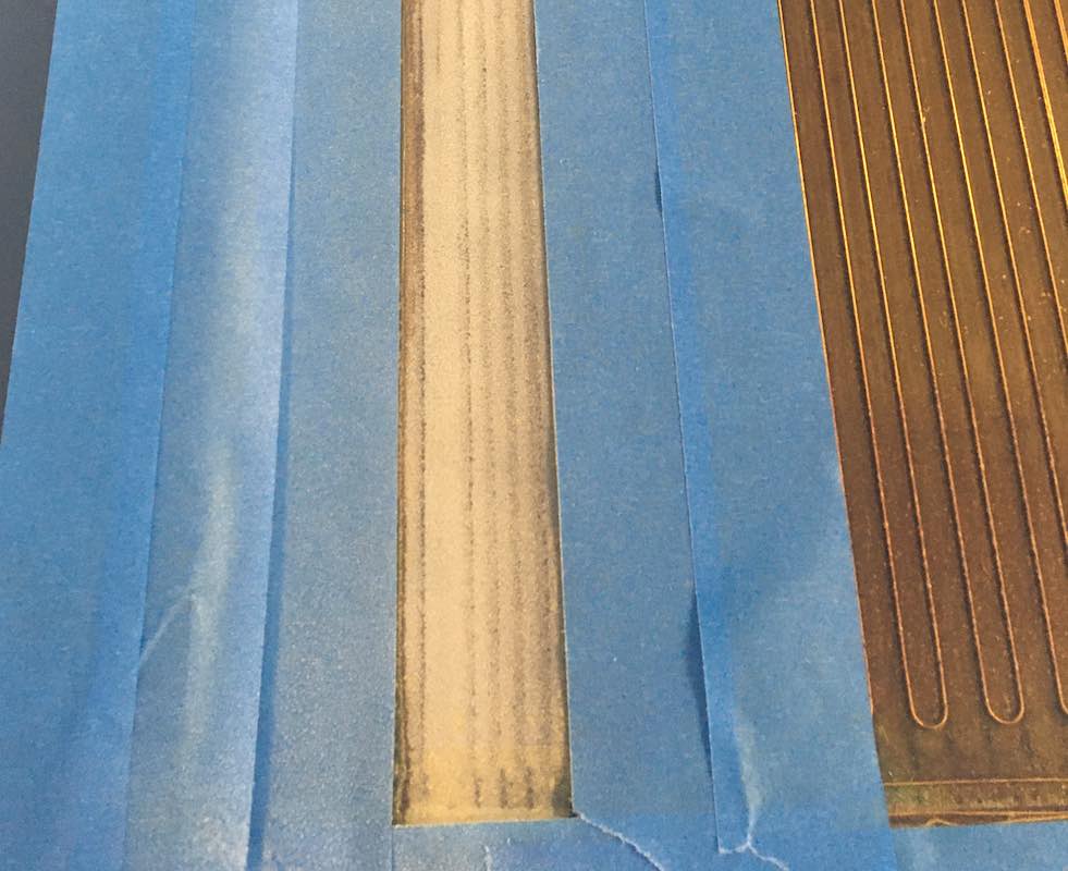

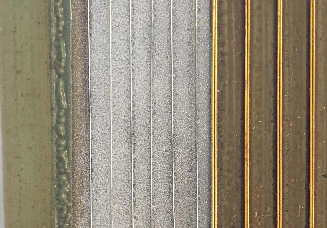

This morning I repaired a pair of Magnepan MG-1b speakers that had been languishing for years. Fortunately only the tweeters needed a full rewire (the wire as nearly dust) and one woofer had a break right at the end which is now repaired with a good old lineman's splice and solder. Acetone and glue is mostly all it takes.
Pics are:
Tweeter section cleaned down to mylar.
3M 77 spray glue
32 gauge tweeter wires glued on.

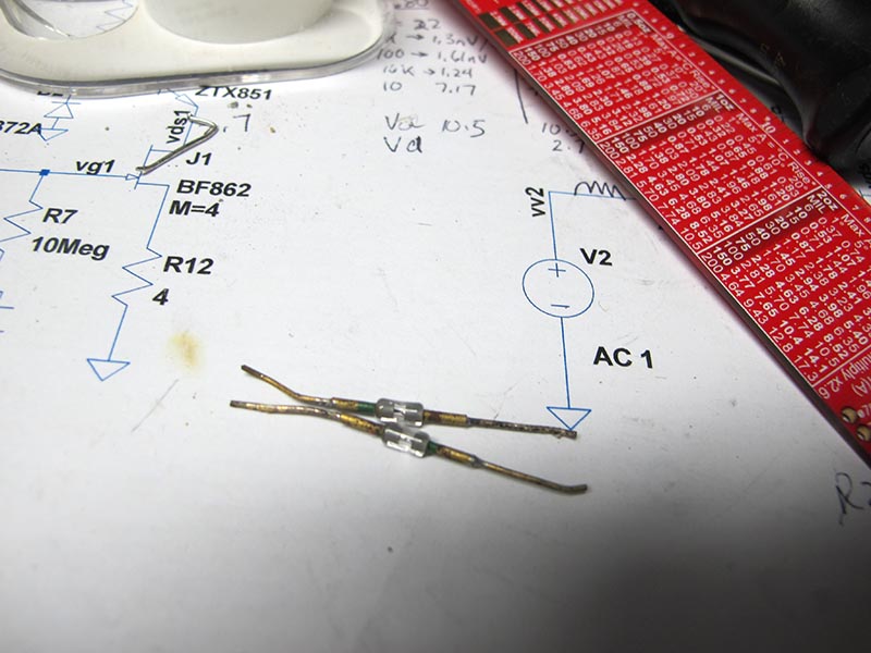

The originals were 1uF/400V paper -- they had 16AWG leads!!! -- were probably the most significant issue. The input cap -- 10nF was also a 10nF/600V paper and leaky.
It is too bad about the original rectifiers -- I started out when we had to solder diodes and transistors with an alligator clip so they wouldn't destroy themselves.
Aside from color blindness, it has gotten harder to read modern resistors. The grey body makes it harder to tell the difference between red and orange. Older dark brown was easier to read.

Nice work Pano! I'm guessing you will get a lot of enjoyment out of this repair!!
Thanks Tony. The repair was fun, and the speakers sound very nice. I actually got them in trade a couple of years ago from a friend. He found them at the Goodwill thrift shop!

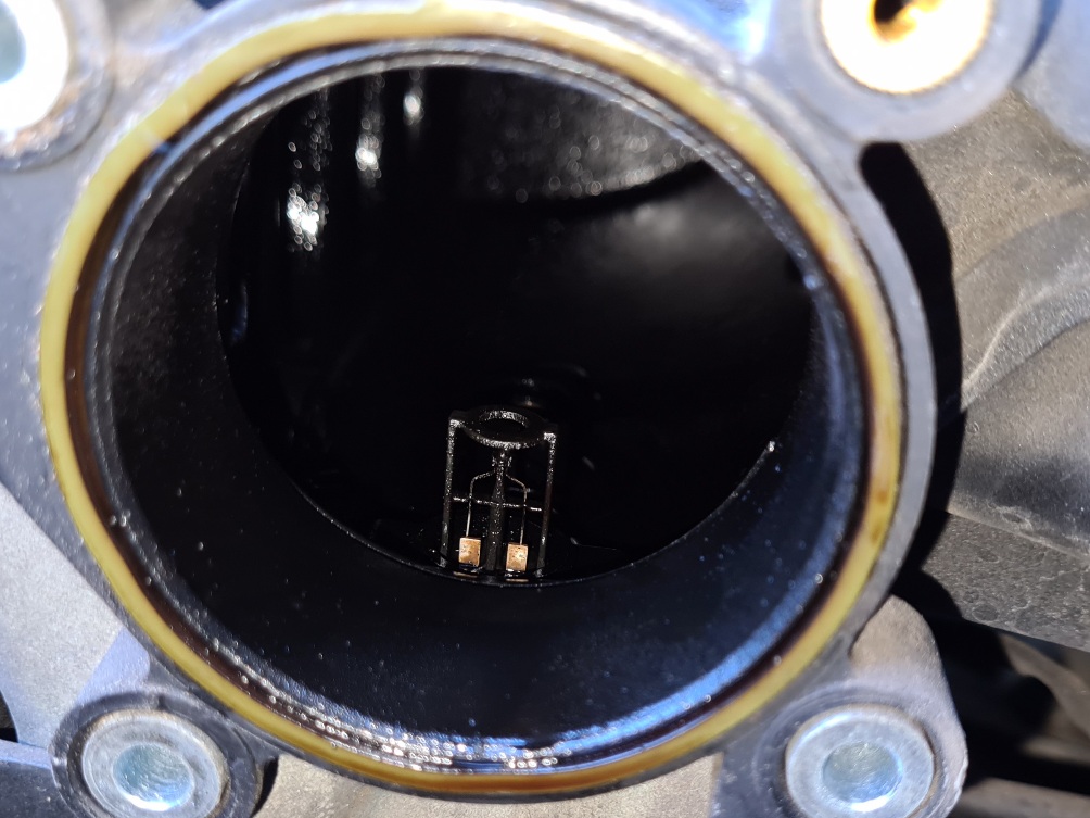

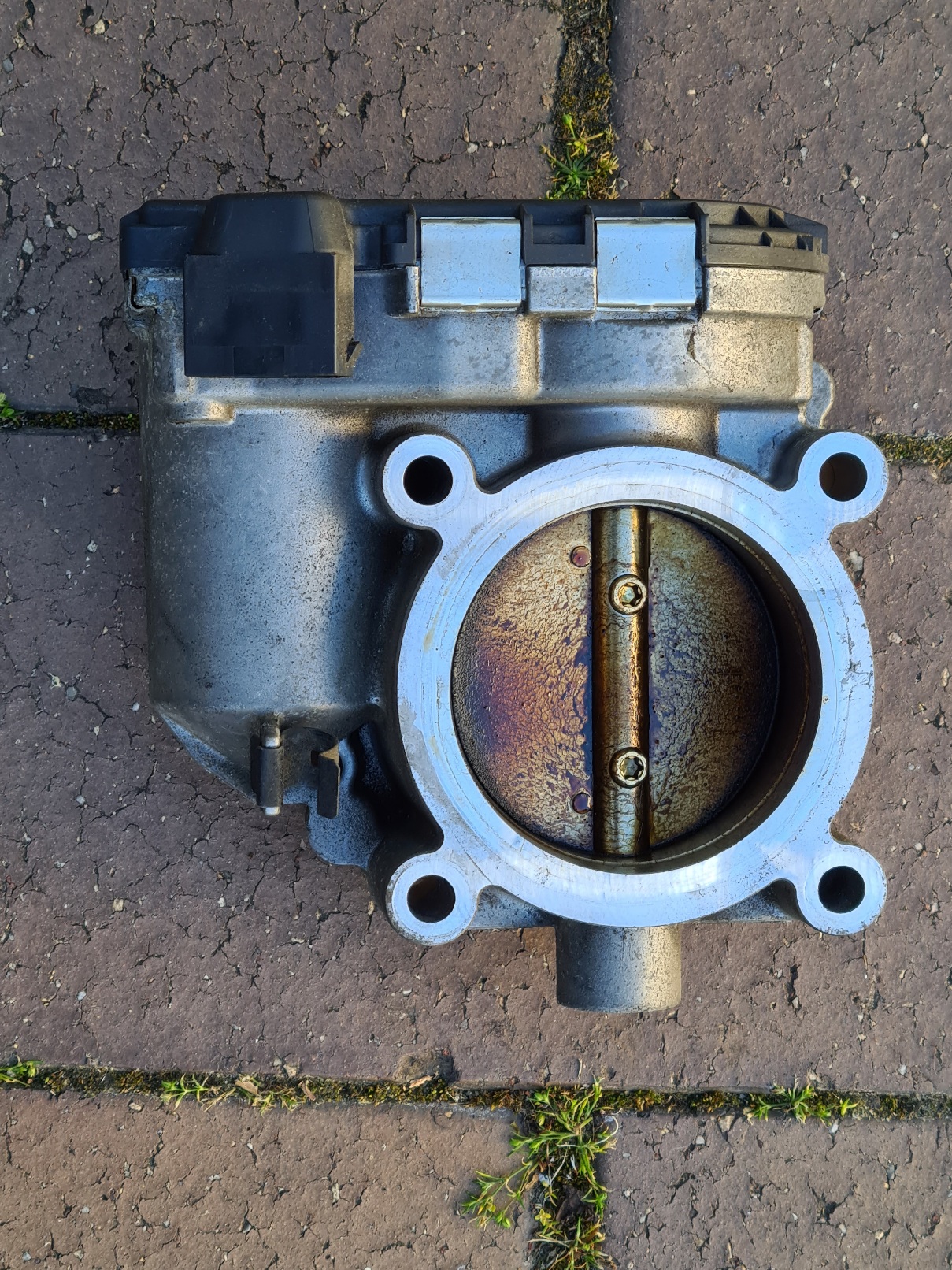

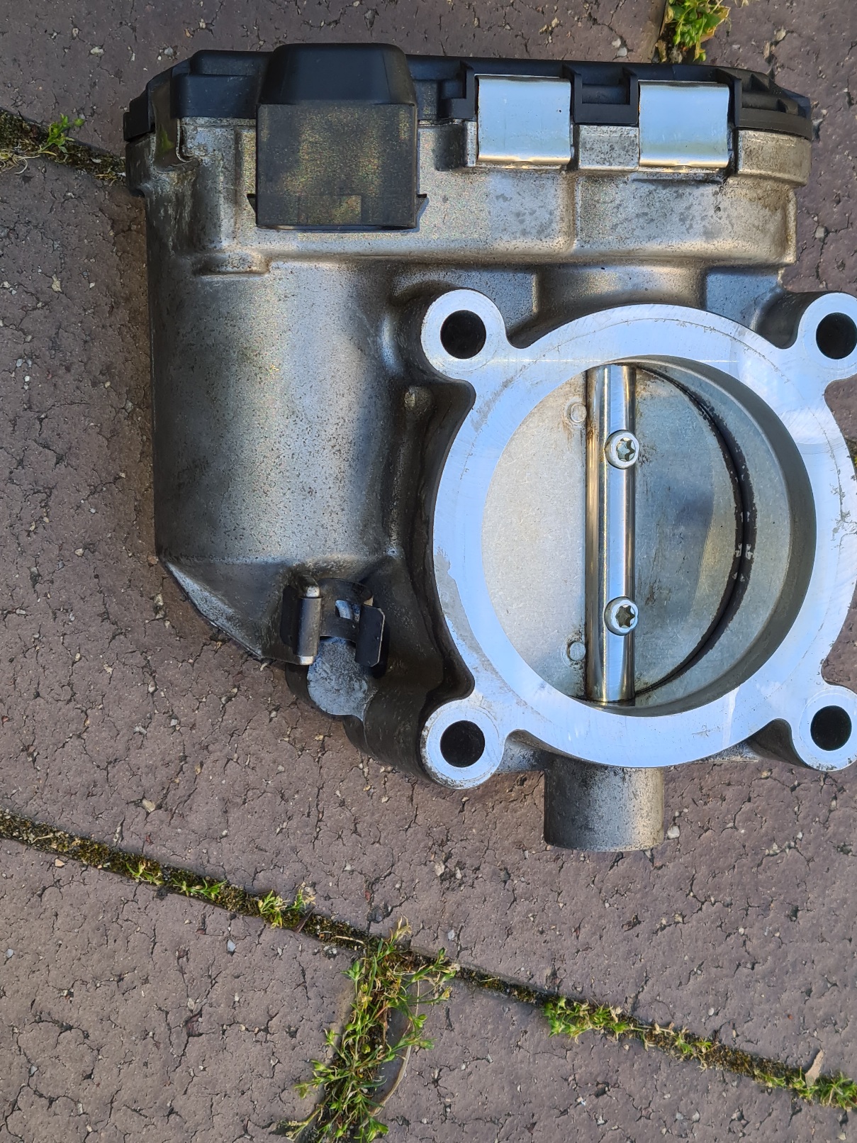

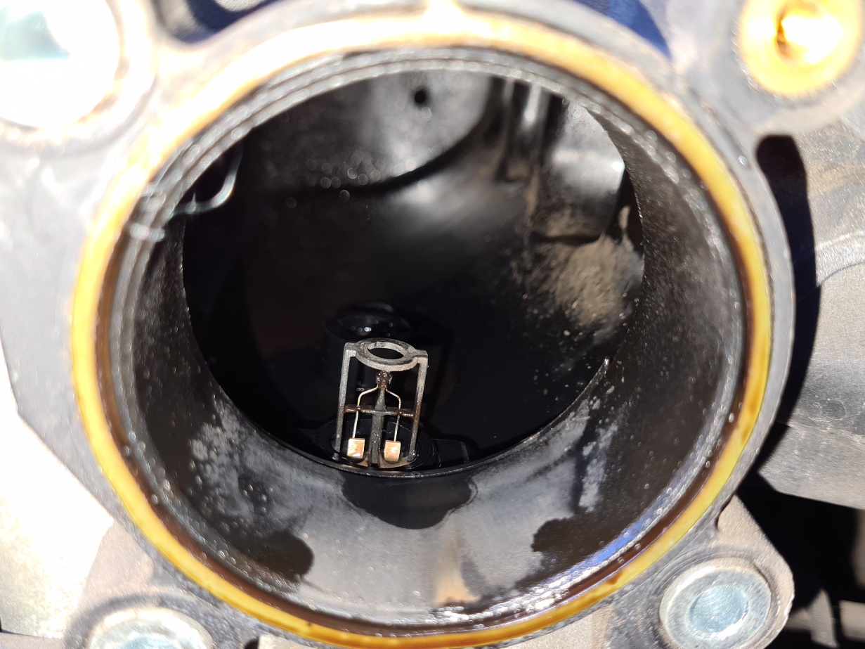

My wifes car. Engine light had been on more than off. Fault code suggested that the problem was map or mas airflow readings being out of wack.
Pulled off the throttle body which was gunked up as was a sensor just behind it. Cleaned with mas airflow sensor cleaner and cleared the codes and seems to be good now.
Seems a bit more responsive. Hopefully fuel economy should improve as well.
Tony.
Tony.
Thanks Mooly, from what I could find looking up the fault codes, many people have spent over $1000 getting sensors replaced and it still didn't fix the problem, and in the end a clean of the throttle body did. Apparently it is also a common dealer practice to replace the whole throttle body, which would be a rather expensive excercise I would think since it is a fly by wire type!
