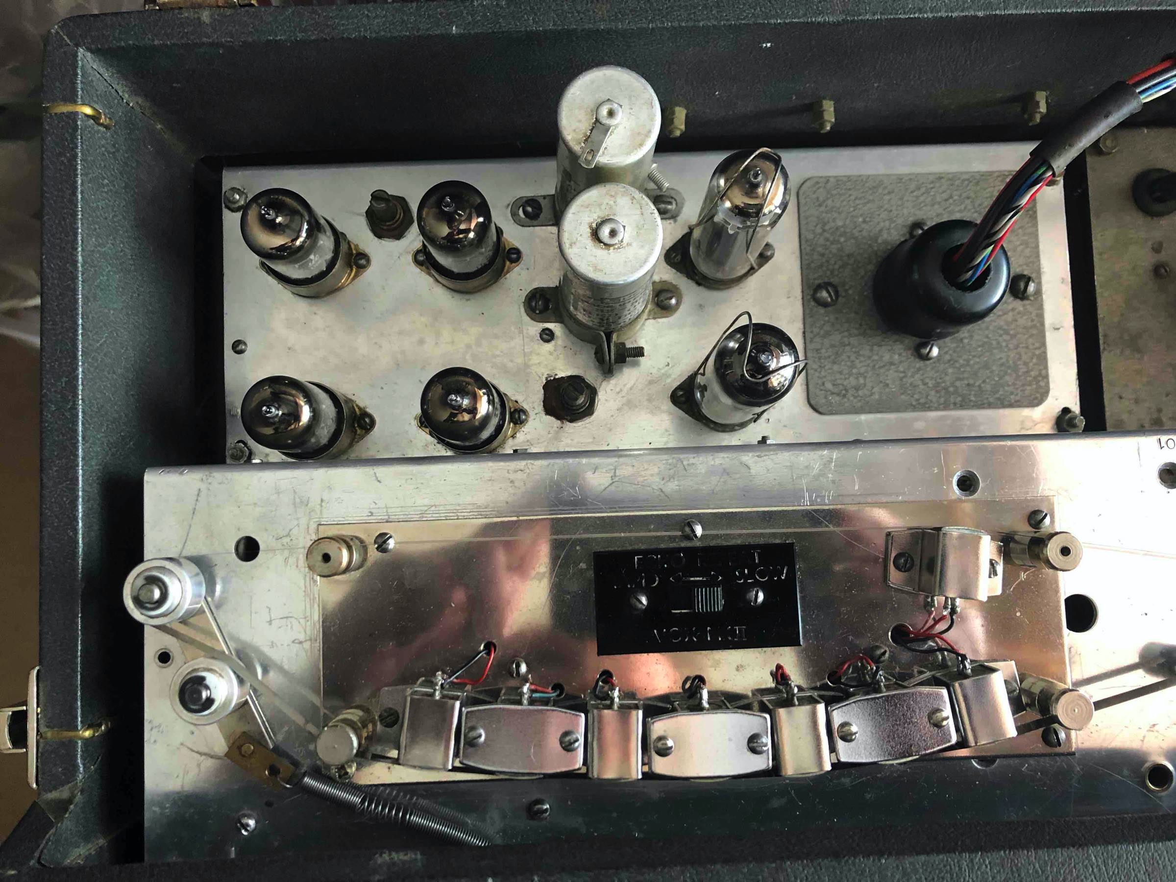

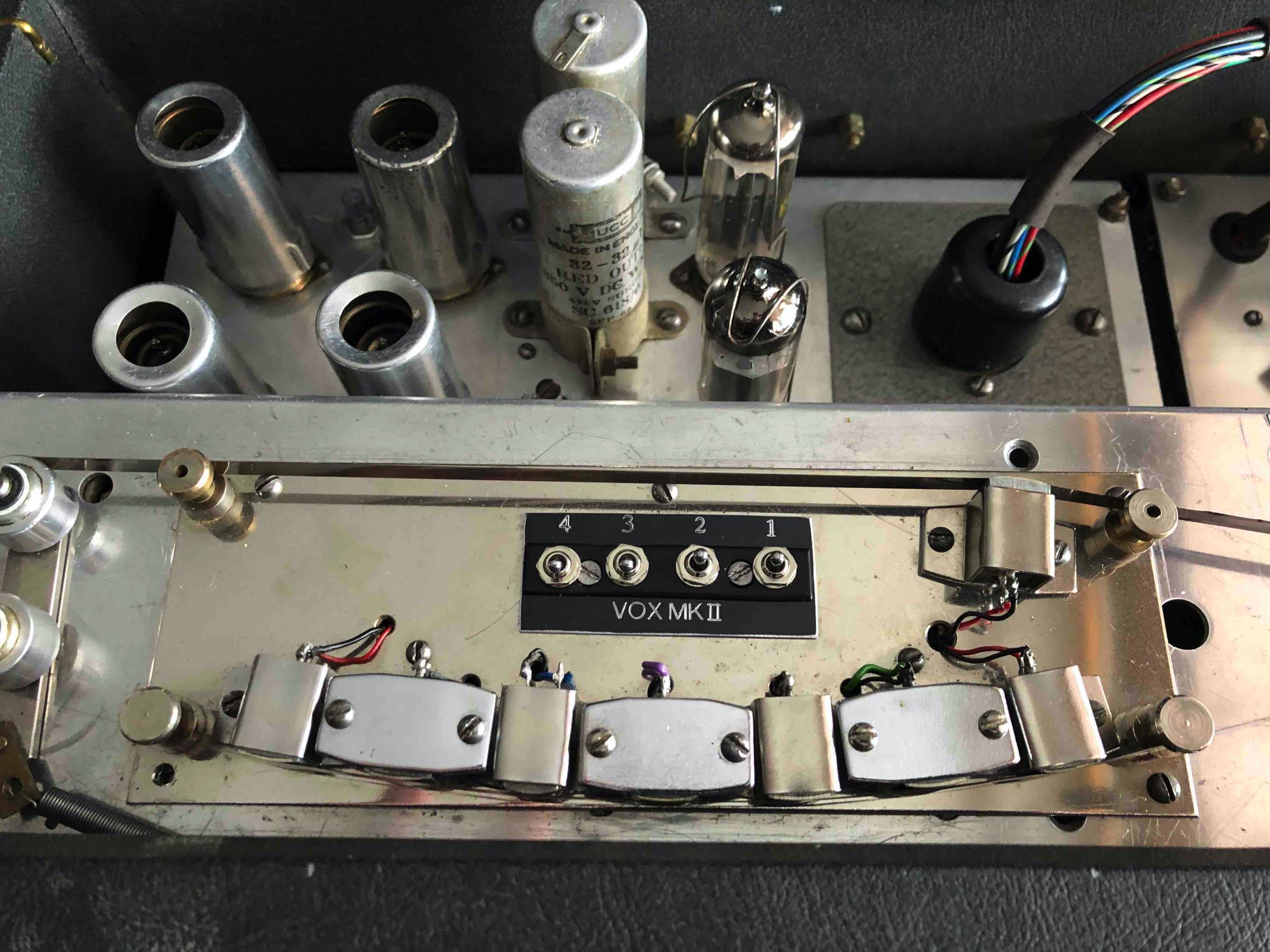

My last repair/refurb was this; my customer required the same configuration as the Shadows used in 1964 so I did as requested and added independently switched and adjustable regeneration controls for all four heads. The original had the slide switch for double speed, now any configuration is available including the original configuration.

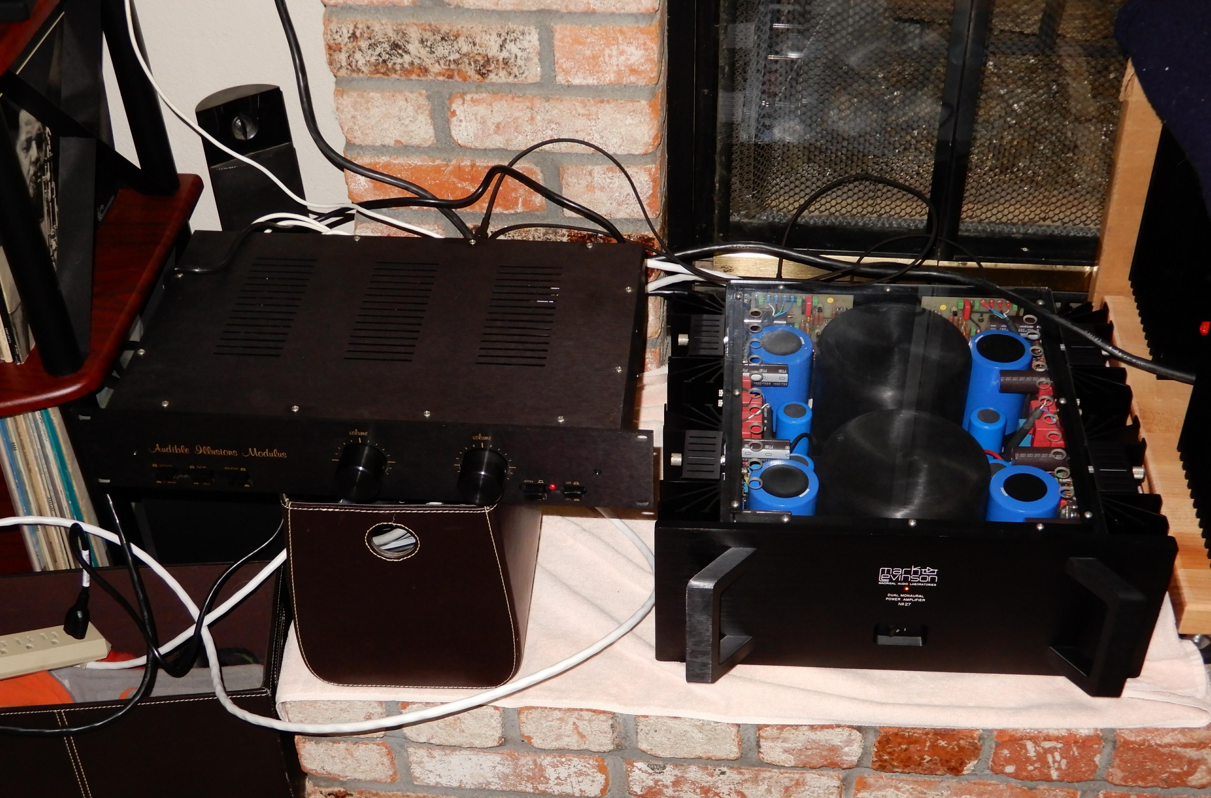

Rebuilt and improved a Marantz 2285B. It took about 16 hours of work, but now the unit exceeded the expectations of the owner that requested this work. Personally, I am very happy with it's performance.
The owner of this 2285B has another one. He is requesting that I do the same thing, but to go further with the improvements. Sadly, this is possible to do and I fear we have reached the point of diminishing returns. Another person brought in a Marantz 2265B and requested the same service. Because it is very close to the 2285B in design, I can do this.
-Chris

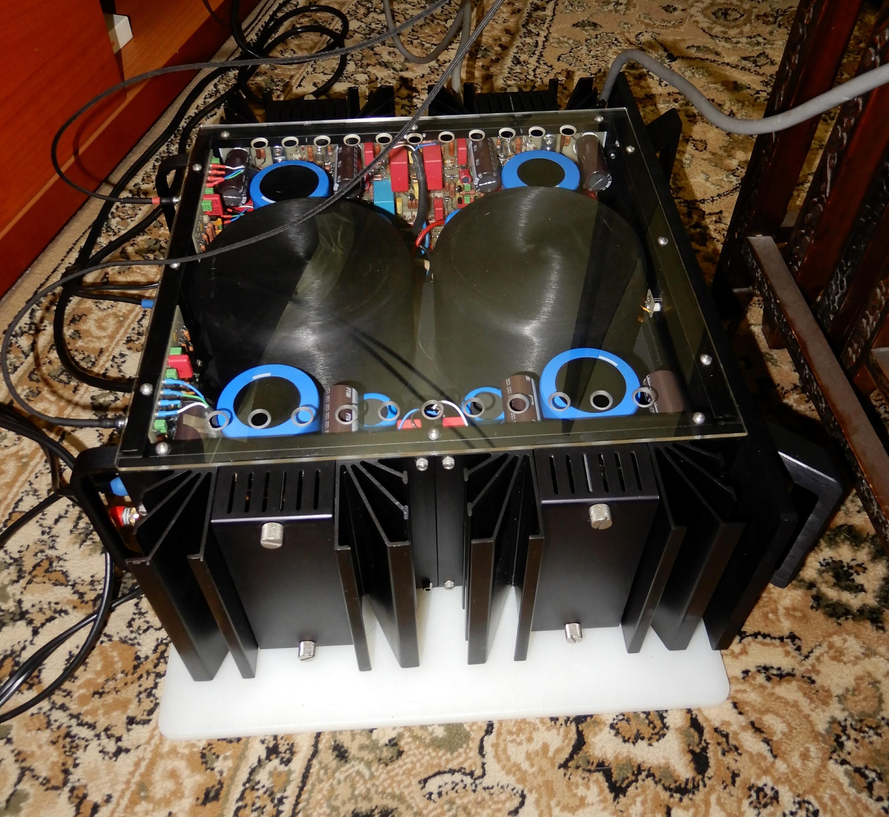

... Levinson No. 27 amp... got left channel working beautifully, but right channel was dead.
Got the Levinson finished up on New Year's Day, and have been using it almost continuously throughout each day since. Sounds fantastic; this was very satisfying, being complex to work on. The effect of different preamps is more pronounced with this amp than my other amps. I've found it sounds best with my preamps with more gain and a little more midrange, like the Audible Illusions tube pre in the photo.
