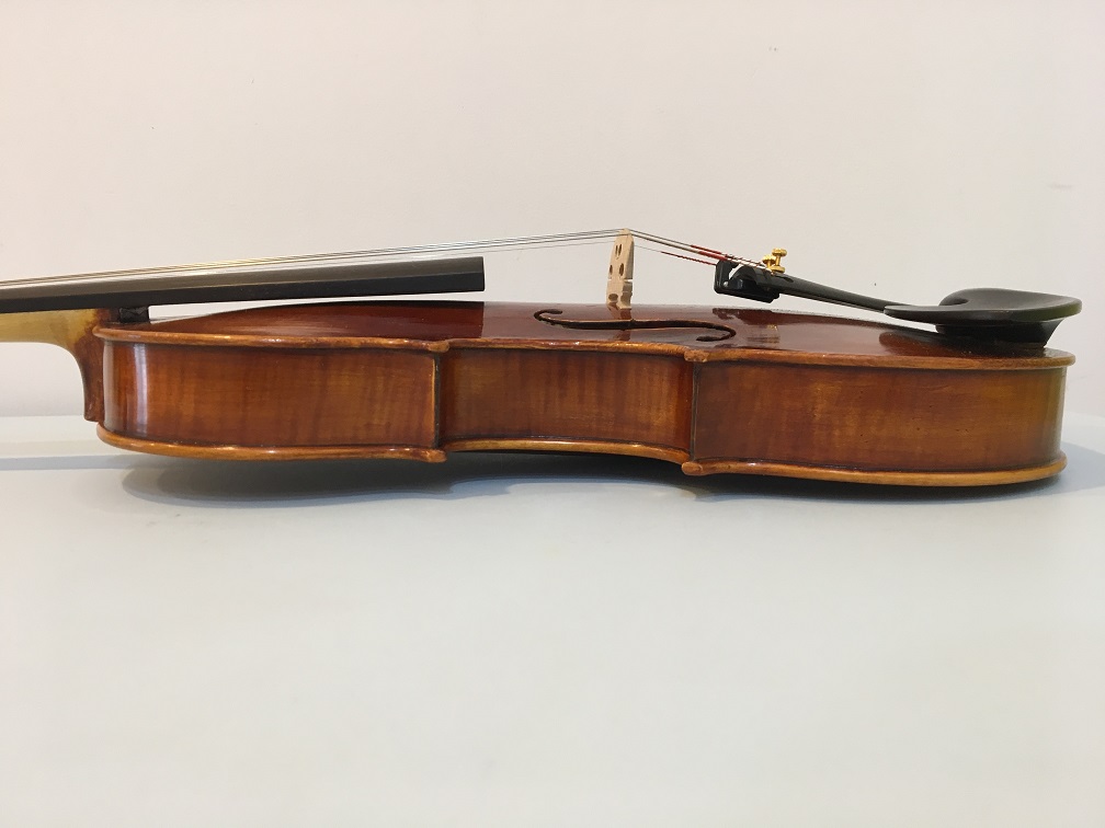

Is a repair to a musical instrument appropriate? I rarely repair audio electronics these days, though I build some from scratch.
A musician friend was given a Korean-made Epiphone Les Paul electric guitar that had spent many years slumbering in its case. I heard her play her "new" guitar at a jam, and it sounded harsh and out-of-tune. Tuning it made no difference; it still sounded harsh and out of tune, all over the fretboard, as well as for the open strings.
My friend is not the technical type, but has a very good musical ear, and the harsh out-of-tune sound was driving her nuts. I offered to take a look at the guitar for her, and brought it home.
Often this sort of problem is easily fixed by adjusting the individual string saddles on the bridge - what guitarists call adjusting the intonation of the instrument, so that's the first thing I looked into.
To my surprise, the bridge was already adjusted correctly. Every open string was in tune; every string was in tune (one octave higher) when pressed down on the 12th fret. And yet, the guitar had that harsh, out-of-tune sound, for every chord I played on it, at any position of the neck.
Looking more closely, the open strings were rather high above the fretboard at the 20th fret. And yet, when pressed down there, some buzzes appeared - the action was too low once the strings were fretted up here. Hmm.
This made me suspect the instrument had the wrong neck angle. If you haven't heard the term, the attached image shows the neck angle for a violin. As you can see, the fingerboard (fretboard on a guitar) is not parallel to the body of the instrument, but instead, is glued in at an angle.
This is routine for violins. When archtop guitars arrived, their design followed suit. And when Gibson Corp. designed their Les Paul guitar to mimic the look of their expensive archtop acoustic guitars, part of that involved setting the neck at an angle to the body.
(Leo Fender took a different approach, screwing his necks with four woodscrews onto a flat plank of a body, with zero neck angle. For reasons that continue to baffle me, everybody refers to these as "bolt on necks". They are not; they are screw-on necks!)
A Gibson Les Paul, however, has the neck glued to the body, and changing the neck angle on one requires specialized equipment and skills. Fortunately, an Epiphone Les Paul - the instrument my friend was given - is a different kettle of fish. The neck is a separate piece of wood, held onto the body with four woodscrews, just like crudely-made Fender guitars.
So I took off the neck, cleaned out the surprising amount of crud I found in the neck pocket, and re-installed the neck, with a thin shim placed between neck and body in such a way as to increase the neck angle of the instrument. I also polished the frets with some 0000 steel wool while I was at it, and used some fretboard conditioner on the rosewood fretboard. Finally I cleaned up the nut-slots with my shiny new set of fret-files, freeing up the strings to move smoothly when tuned. No more "ping!" sounds as the strings snagged in the too-tight nut slots.
With the instrument back together, I re-strung it, raised the bridge height to set the action (string height above the fretboard) now that the neck angle was steeper, and was very gratified to hear the instrument now sound in tune all over the fretboard.
The final tweak was to tighten the truss rod a little, to remove the slightly excessive bow in the neck. (There needs to be some bow, called "neck relief", but there was a bit too much.)
The story doesn't have the happy ending I was hoping for; while the guitar now sounded much better, and stayed in tune all over the fretboard, my friend decided it simply sounded too "electric" for her tastes, and decided to go back to her Gretsch electro-acoustic guitar. She will probably give the guitar back to the man who gave it to her, and it will probably go back to slumbering in its case, stuck in an unheated closet somewhere in a cold and draughty house...
But whatever the end of the story, it was immensely satisfying to take an instrument that sounded awful, and with just a few careful adjustments, turn it into one that sounded the way it was supposed to.
I still don't understand exactly why changing the neck angle fixed the harsh out-of-tune sound, though. I'm particularly baffled that the open strings all sounded out of tune when strummed together, even after all of them had been freshly tuned with an accurate tuner.
-Gnobuddy

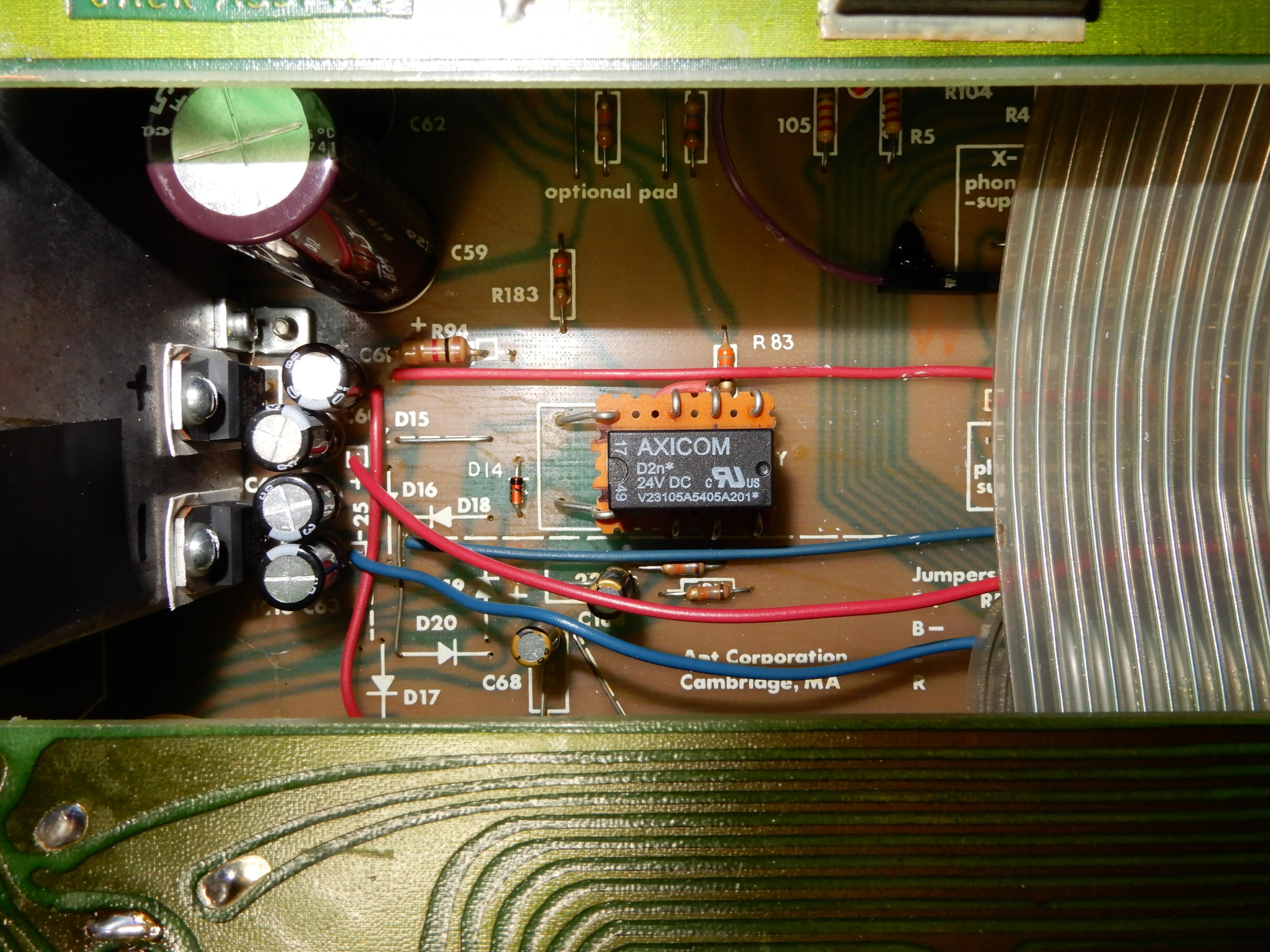

This weekend:
Replaced a bad relay in an Apt Holman preamp with a better quality small signal Axicom. Had to make a board to adapt the pinout. The bad relay was causing an intermittent complete dropout of the left channel, and when it worked, was distorted and lower in volume. I measured both channel signals with my 'scope before and after; noticeably poor even after cleaning/burnishing contacts, pristine after replacement. Used it all day yesterday, sounded beautiful.
Also built a replacement Adcom 555 Mk II input board, will test and install it today or tomorrow.
Finished building an experimental MC plug-in card for the Apt designed by another fellow and installed it same time as relay.
Got all of that done because my work on my Levinson 27 took a turn for the worse. I had replaced some bad parts on both channels (it's horrible working on this amp, with its construction!), and got left channel working beautifully, but right channel was dead. The test points are so inaccessible when the unit is assembled unless you make/use a jig to operate the amp with the modules separated from the rest of the chassis. Bottom line is I should have just done that. I slipped with my DMM probe about 1mm, and burned up half a trace. After pulling the module and repairing the trace, I discovered the problem was I had failed to solder one resistor lead, which was dead center in the pad making no contact, so dead circuit. After that I found I had blown out two 1N4148 diodes and TIP127 and possibly other parts in the bias circuit on that section of that side. I am now serving penance by waiting for delivery of more parts, and will have to separate the drivers and output transistors from the boards in order to pull the heat sinks to get access to the bottom of the board.
Why didn't I use the right clip probes??? Why does my wife always ask "are you having fun?" when I start swearing? Why can't I find better swear words than s__t and f__k???

This weekend:
Greg
On the Holman preamps - the pull-in voltage on the relay becomes weak due to the circuitry involved.
Bad caps, etc., contribute to the issue.
I've done those relay overhauls on them, and gave the relay a bit more "kick" to close.
The Adcom 555's, unless they have the cooling fan option, tend to overheat the driver board.
I had to custom build a small quiet fan system inside, after adding heatsinks to the drivers and doing a restoration on the amp.
