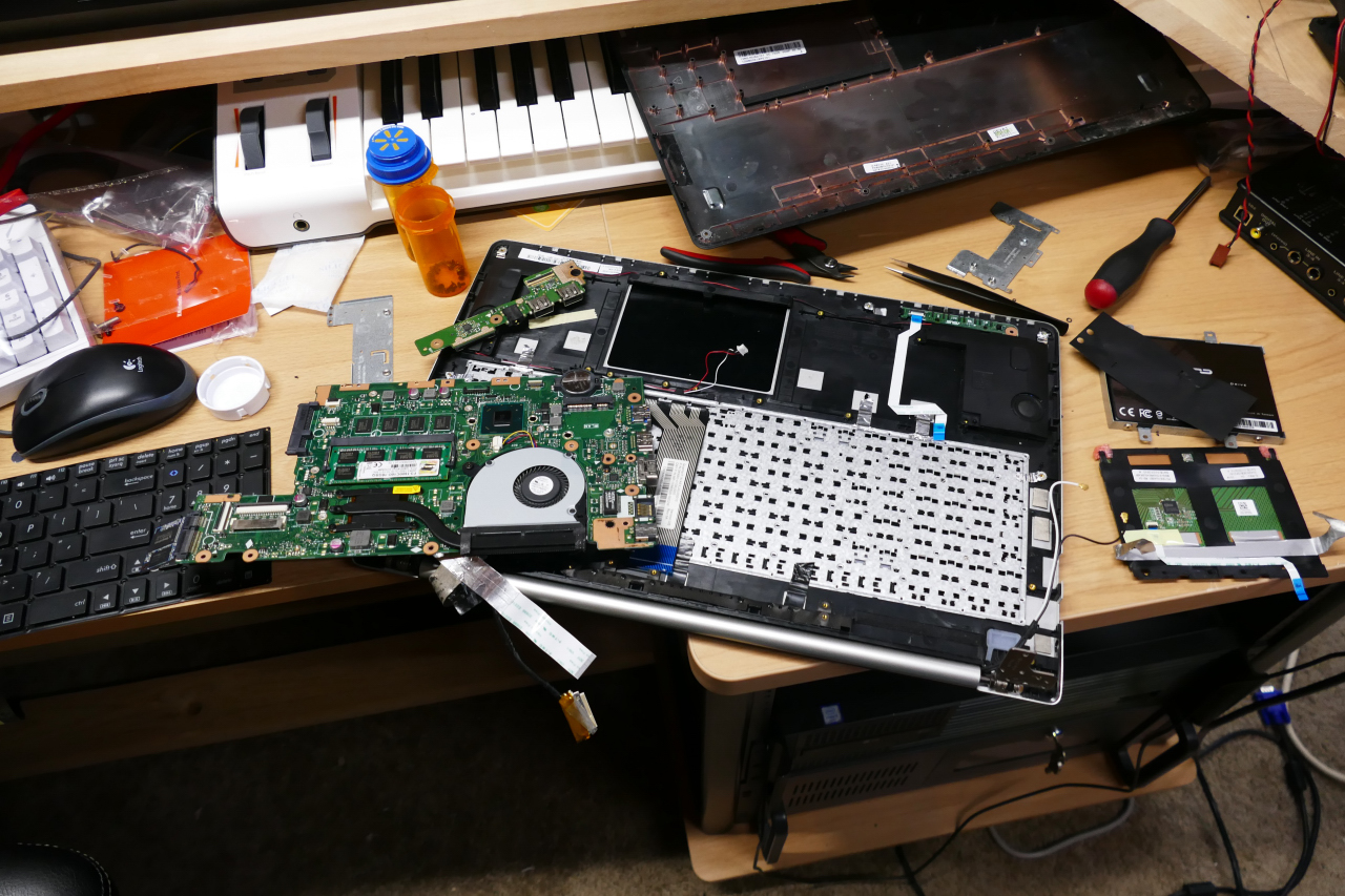

Here lies the remains of my Asus Craptop. It is now dead again. This time it was due to an attempt to improve it's performance with an SSD upgrade. The sharp laser cut steel frame for the hard drive had worn away much of the plastic tape and coating on the flex circuit for the keyboard during 5 years of intermittent use. It cut completely through the flex as I pulled the plug in hard drive from the computer.
I ordered a replacement keyboard from China and reassembled the computer so that I could use it on a recent trip with a wireless USB keyboard.
The new keyboard has arrived from China. It is a flimsy flexible thing as was the original. It is attached to the front panel by melting the edges of about 50 tiny plastic pins that protrude through the keyboard from the front panel. The only way to remove the original keyboard is to cut the heads off of each one of them. This leaves no way to mount the new keyboard other than tape and hot glue.
I give this unfinished repair about a 50% chance of success.

It would appear that the laptop surgery that was shown in post #582 was successful and it is working again....for now.
George -- where did you get the six pointed "star driver" to remove the screws of the laptop's bottom. I have nothing that tiny in my tool-kit.
I am going to redo the power supply connections which always seem to fail.
Mine has ordinary Phillips screws on the back cover and throughout the insides.
I did get a cheap set of "electronic tools" on Amazon some time ago that has the bits needed to crack open most electronics.
I recently got a Ryobi 100+ piece driver set at an outlet mall tool store, but I wouldn't recommend that junk to anyone. The first three small bits that I tried just twisted up when I tried to crack open a dead hard drive.
