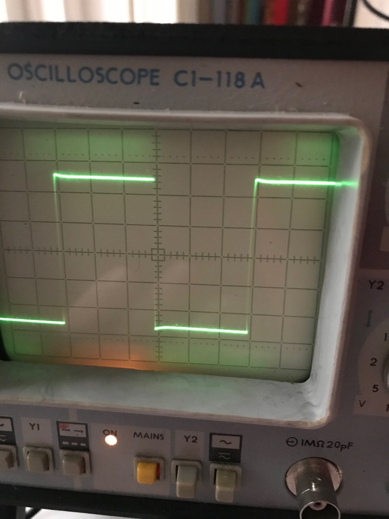

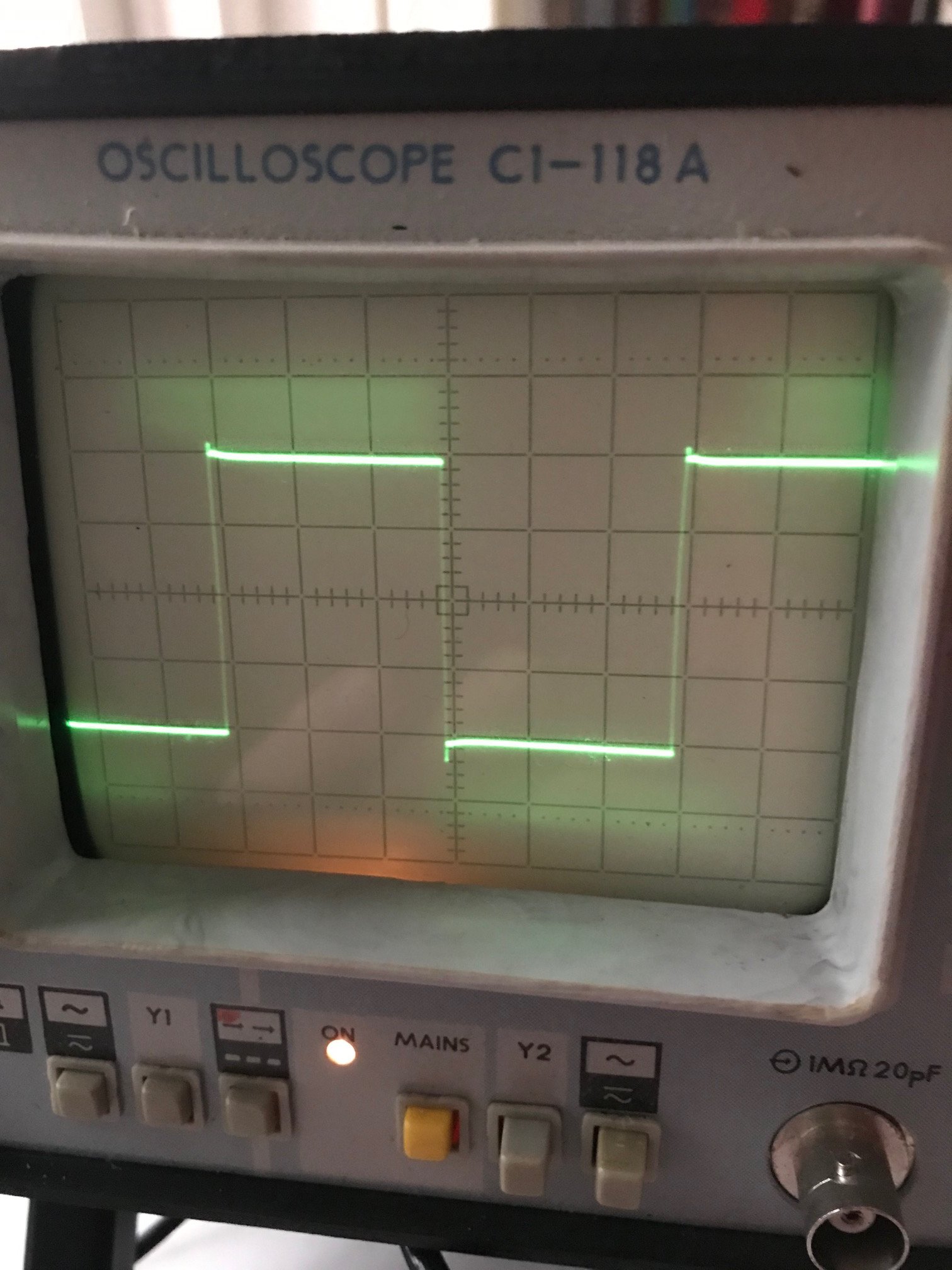

Today I was faffing around with my oscilloscope. I thought I would actually see how Whammy behaves.
I do not use C2/7 in the feedback loop. The more rounded edges are measured at the input of Whammy, the overshooting ones at the output.
As you can see it does overshoot a bit but then I do not see any wiggling afterwards.
Do you think it is worth adding these caps?
The signal is about 10kHz.
BTW I see that Burson V6 Classic was mentioned above. The scope pics above are with the same Burson.
I'd be curious to see how it compares if you run the same experiment but with a different opamp

Hi @Gregje ,
Keep in mind that those are widely zoomed transient response.
Looking at the complete 10kHz cycle, it definitely does not look slow:
https://www.diyaudio.com/community/attachments/scope_24-png.837240/
On this measurement, I scaled the pot to have unity gain, ie ~1.5Vp IN / OUT.
Yes indeed. Now I have found the scaling on the screenshots you have provided. I was dumb enough not to look for this info in the first place.
And I haven't noticed that there is a huge time scale change between your first screenshot and the subsequent ones.
I will try the bypass cap first. Not that it sounds bad now (far from it), but I want to see whether I will get similar response as you have.

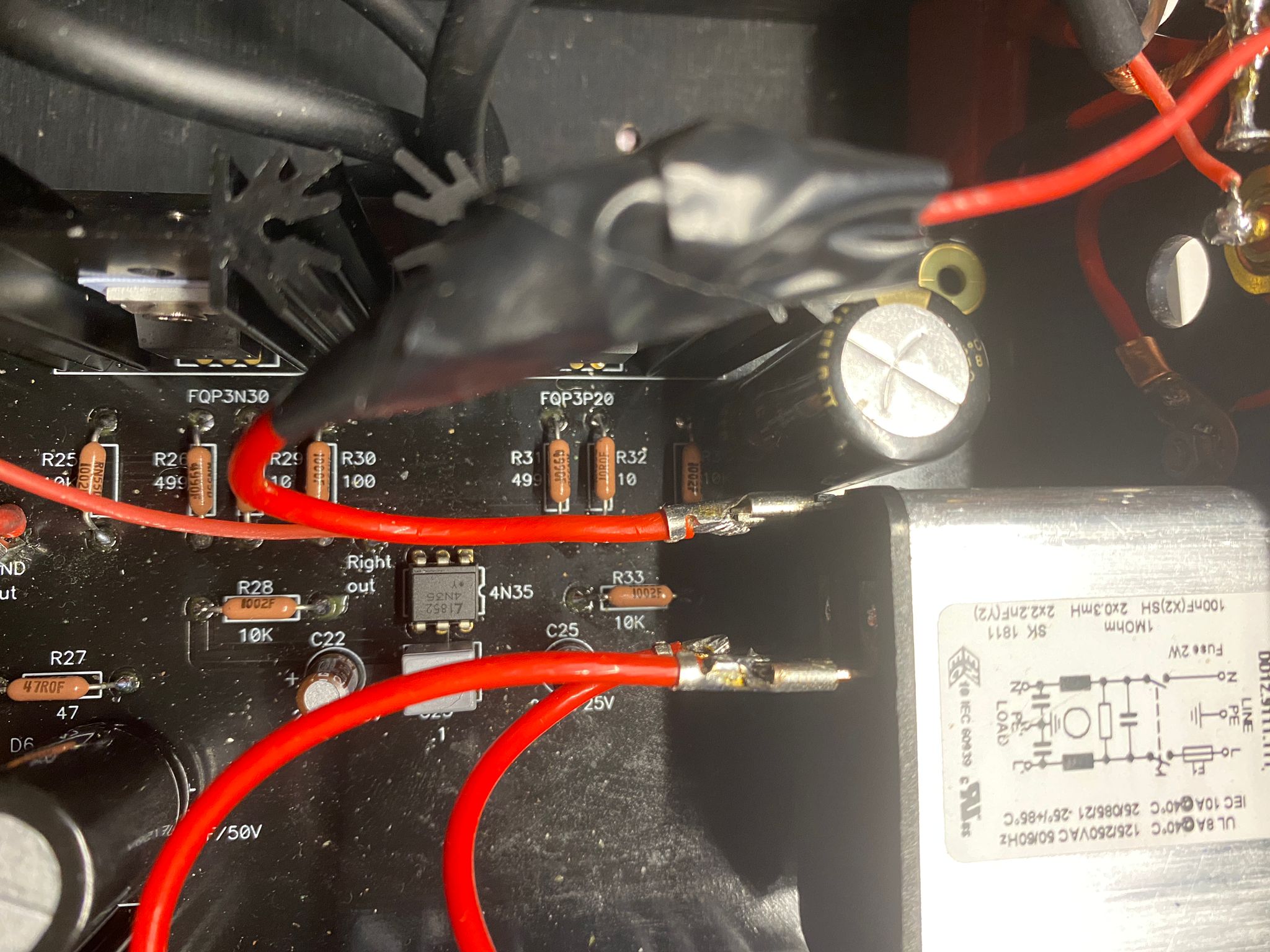

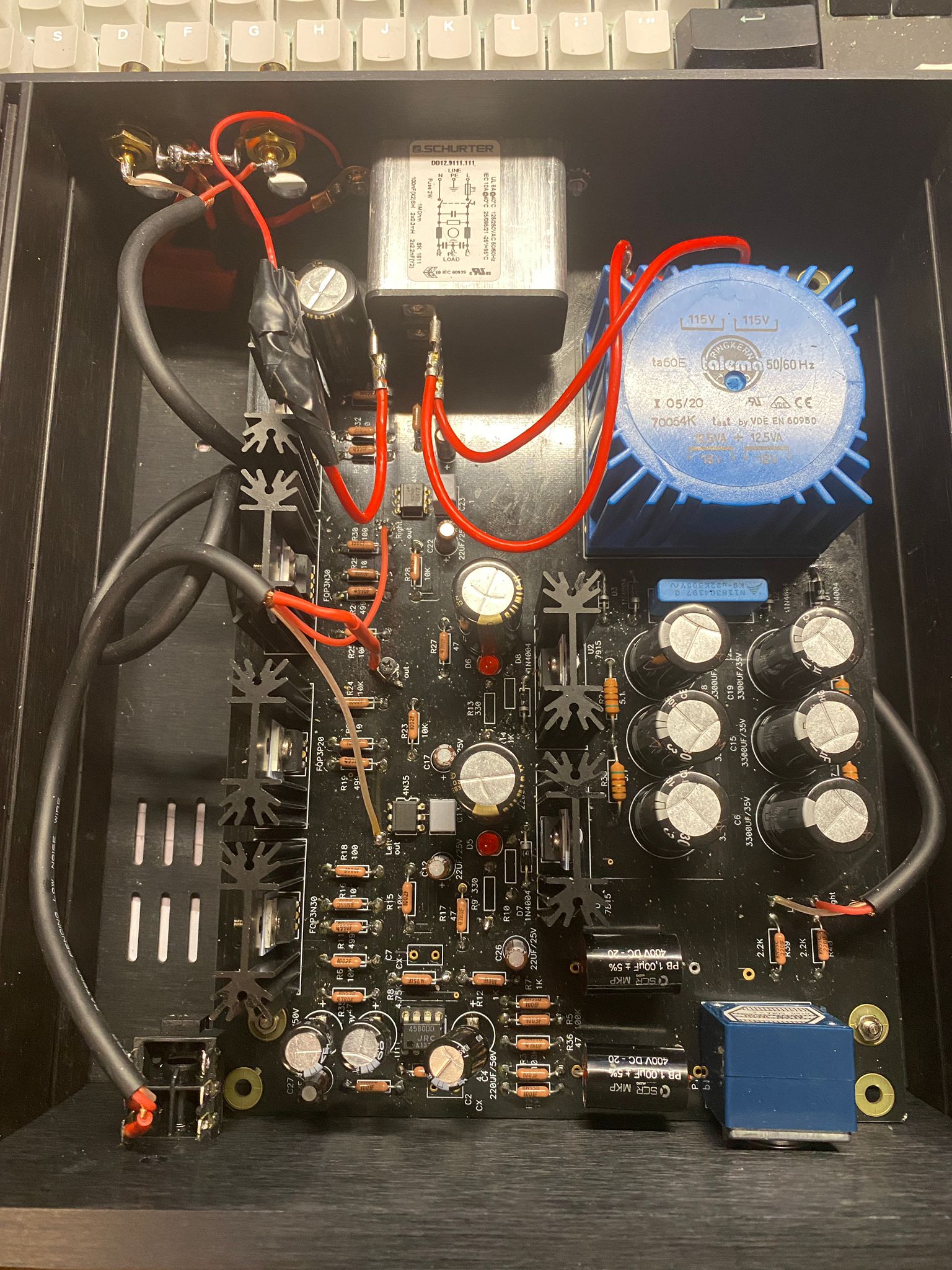

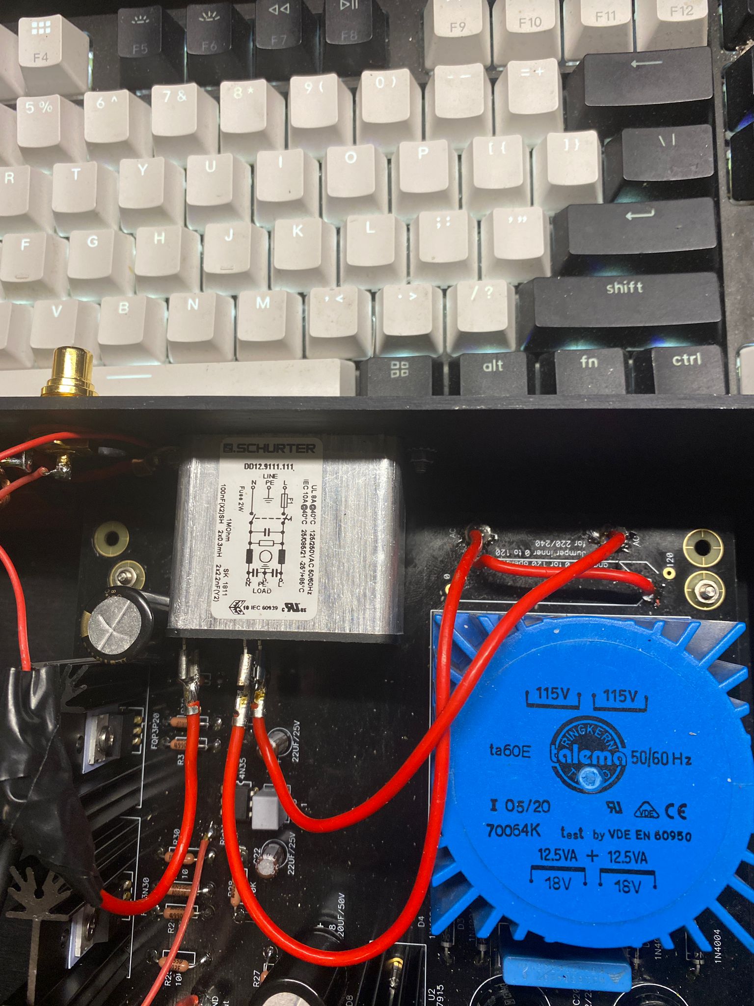

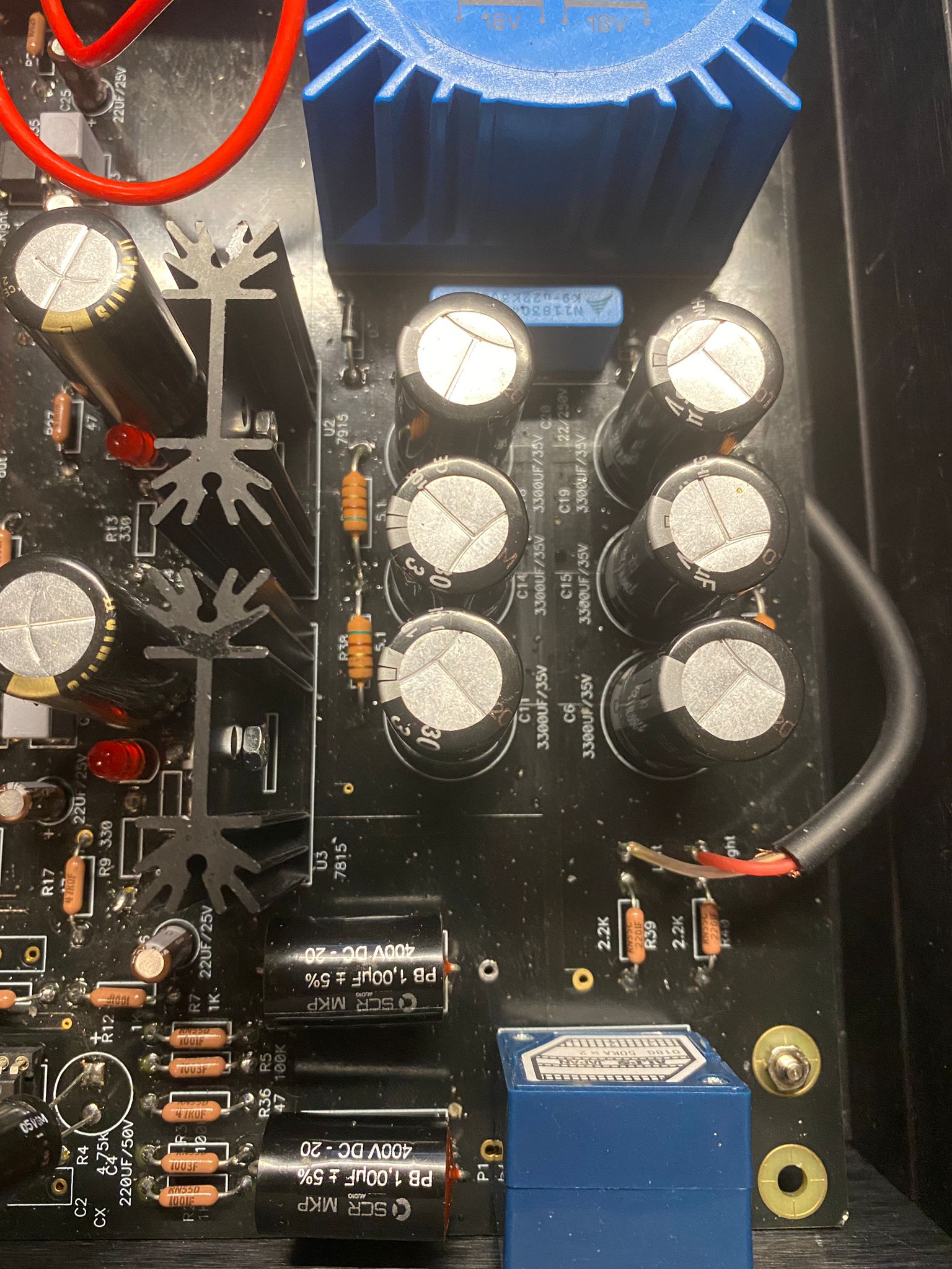

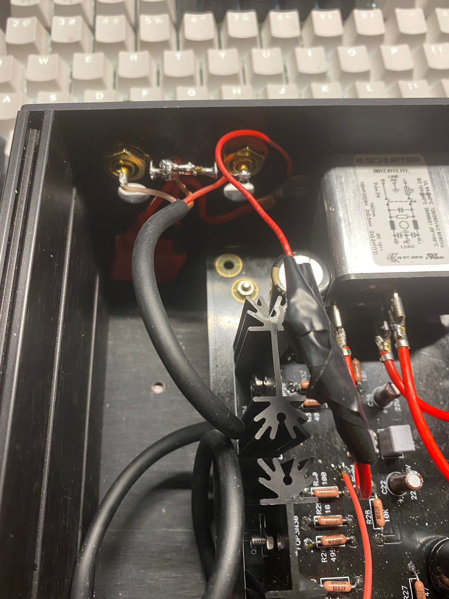

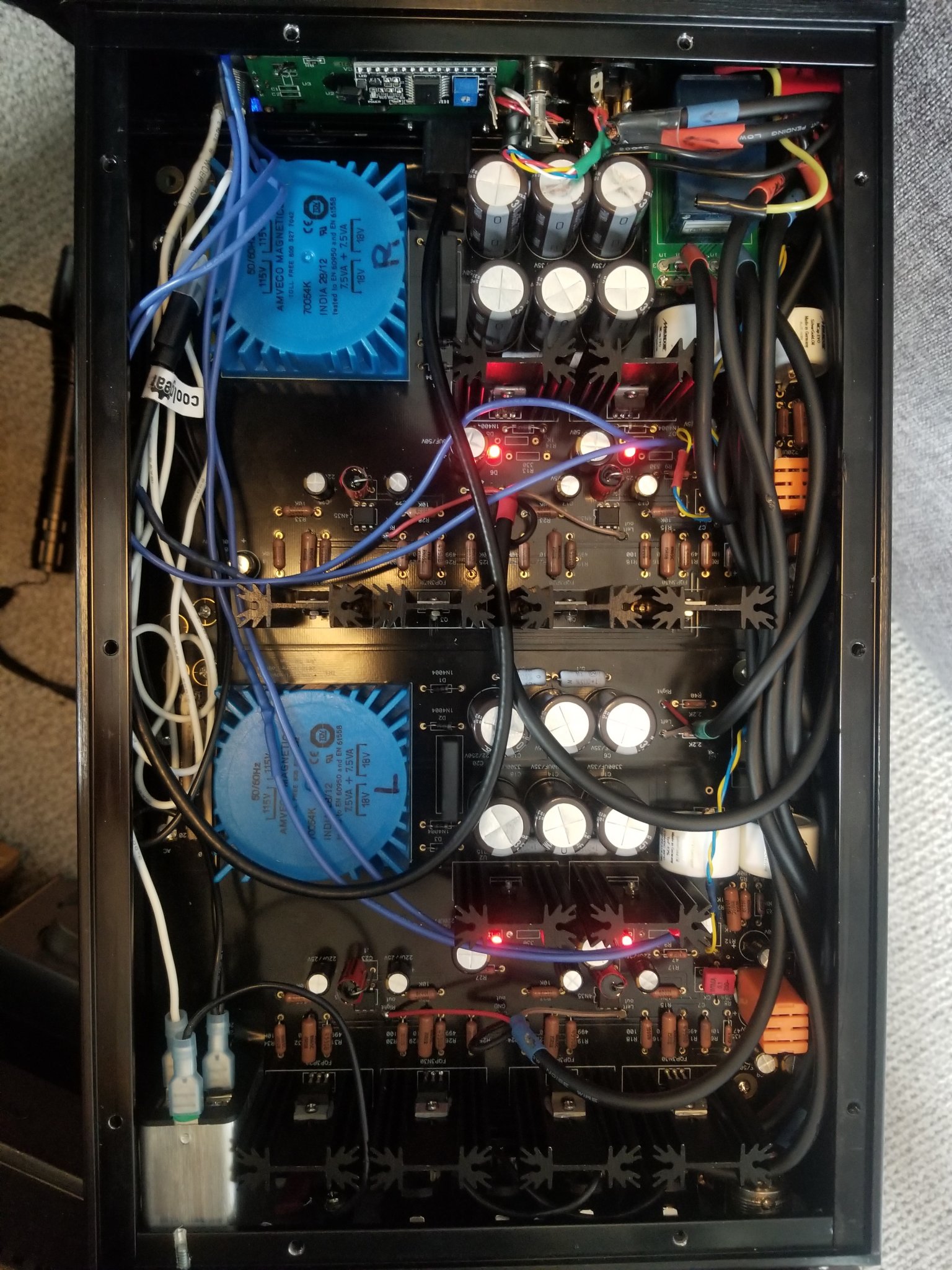

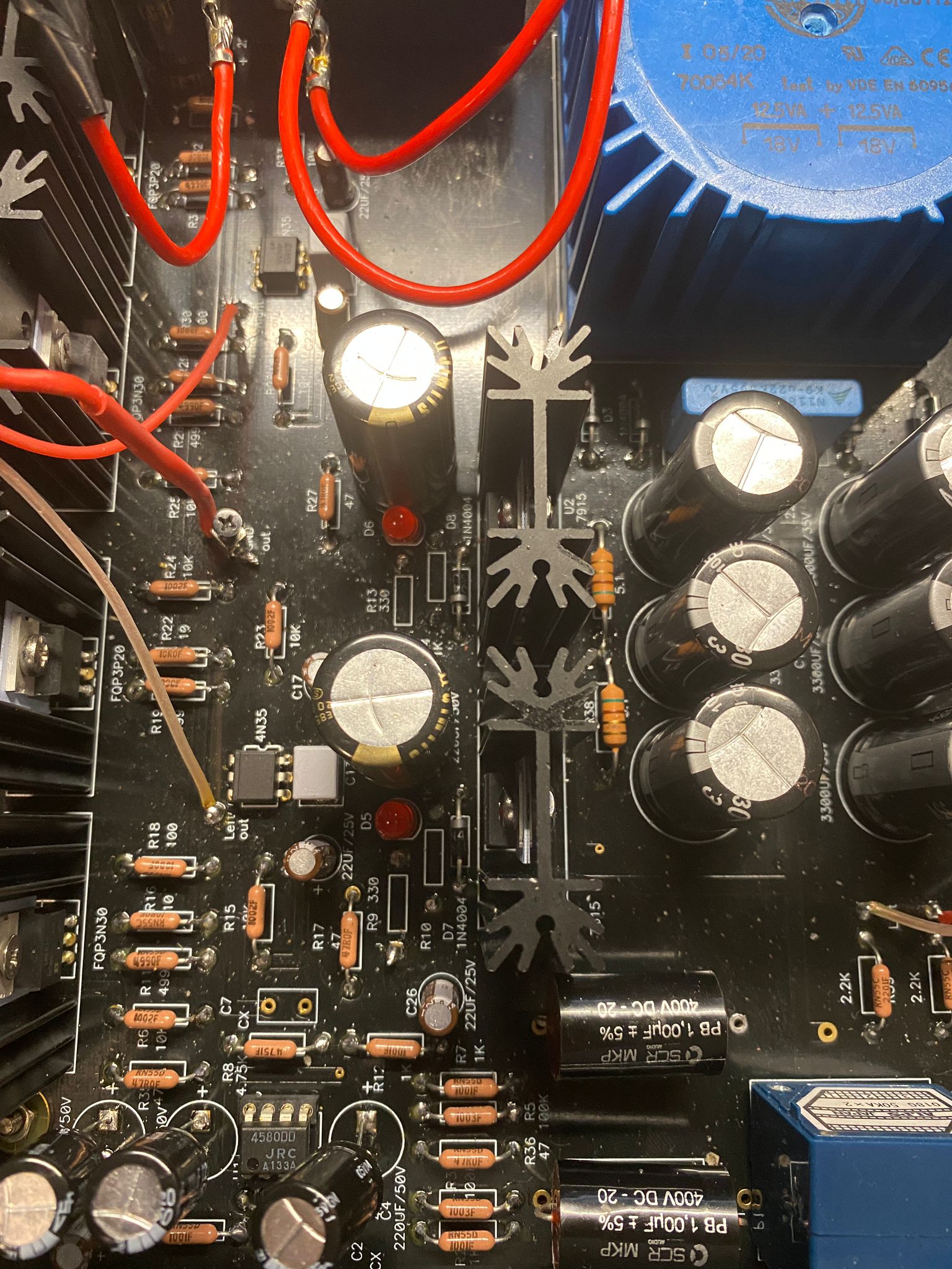

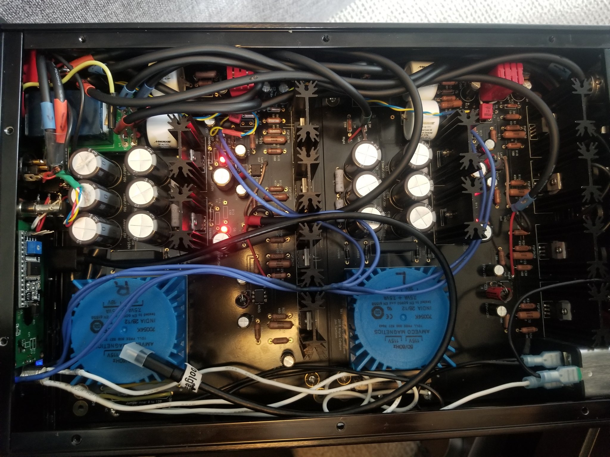

I am annoyed. I hate this kit. It just doesnt work. This is already the second set I bought from the store. Both set ends up in the problem which is all I can heard is 20% music and 80% noise. There was too many uncertainties in my first WHAMMY because I replaced all the component into expensive audiophile parts. It could be my own careless mistake messing thing up. For the second time, I used almost all the parts provided by the store and the result has no difference.
I have checked the +17 and -17 voltage test for both times.
I have spent over 1500USD hoping to build one working whammy.
I have spent all of my patient and confidence in DIY.
I hate seeking help when facing difficulties.
Can anyone just tell me what the F is going on here.

methodical approach is what you need
open dedicated thread, much easier to follow
post schematic with measured values in critical points

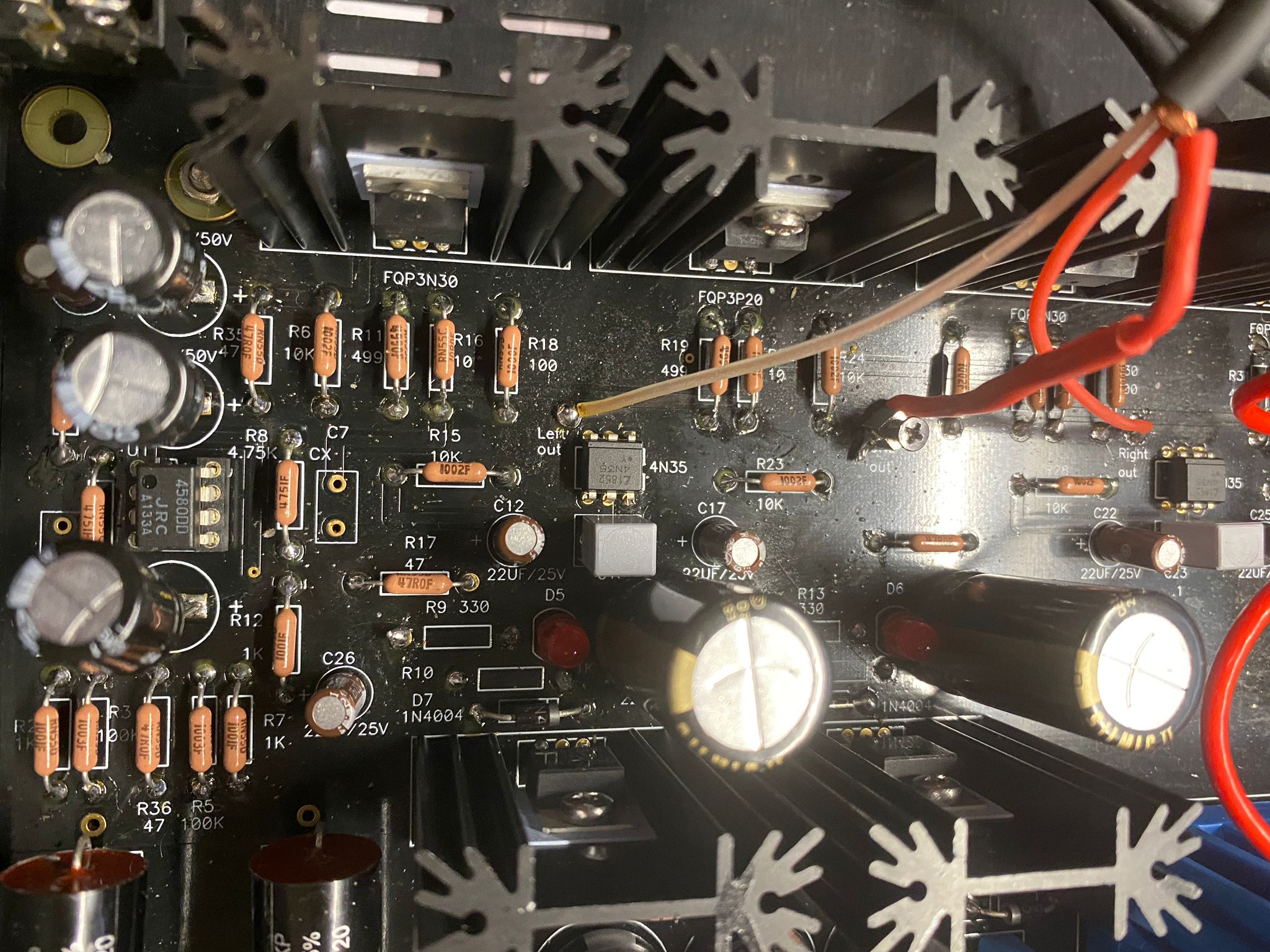

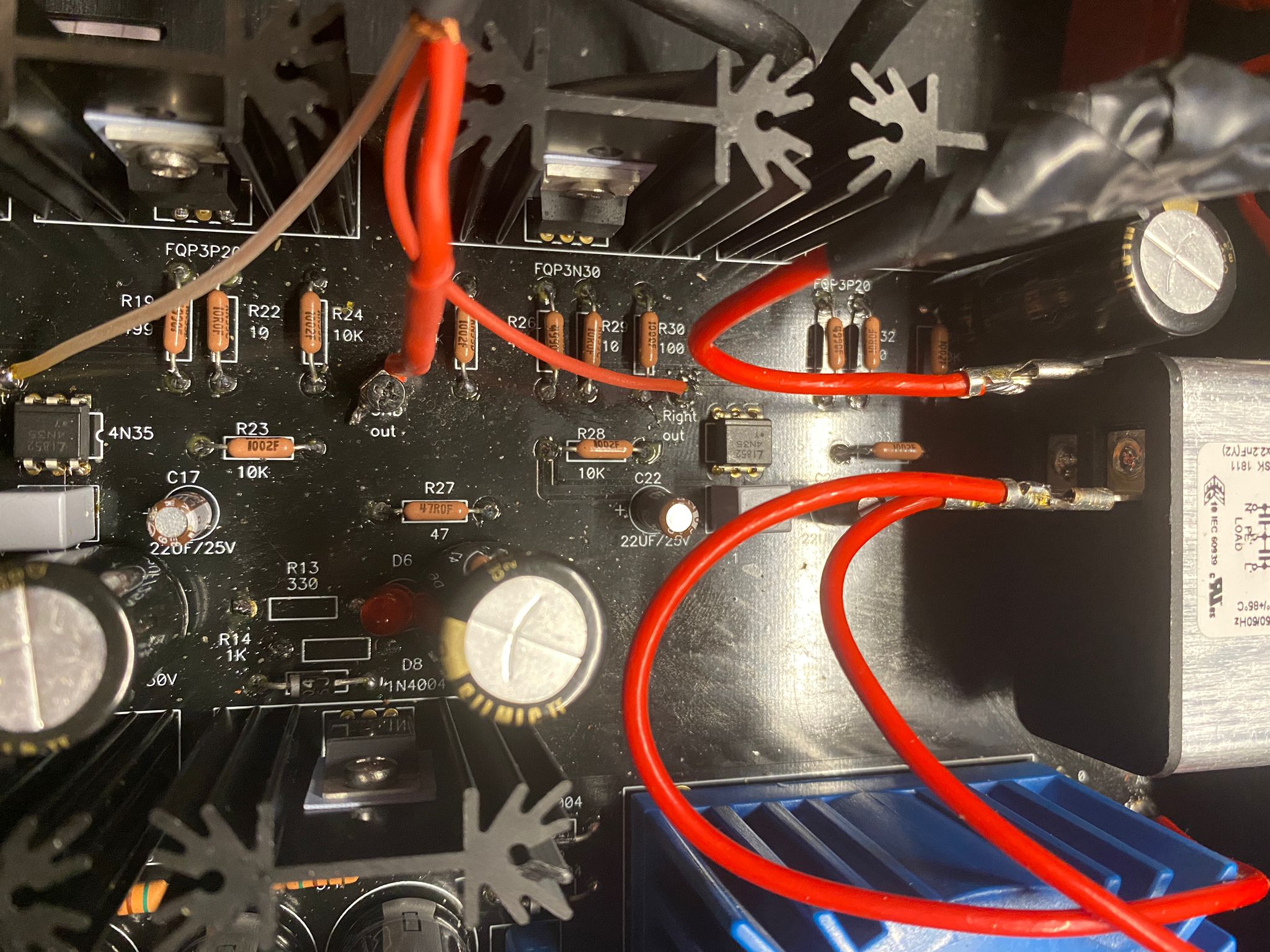

Hello 14071466d,
your Opamp JRC4580 has a maximum operating voltage of +-16V DC. This could be an issue.
You write, that your operating voltages are +-17V DC.
The screws through the Mosfets in the outputstage are not insulated from the heatsinks (no plastic
washers). But I think the solderpoints of the heatsinks are isolated from the rest of the pcb.
The Mosfets solderlegs could get a reflow with solder. Also the optocouplers (4N35) could need
a reflow?
This is what I see immediately.
Cheers
Dirk
a reflow?
Cheers
Dirk
