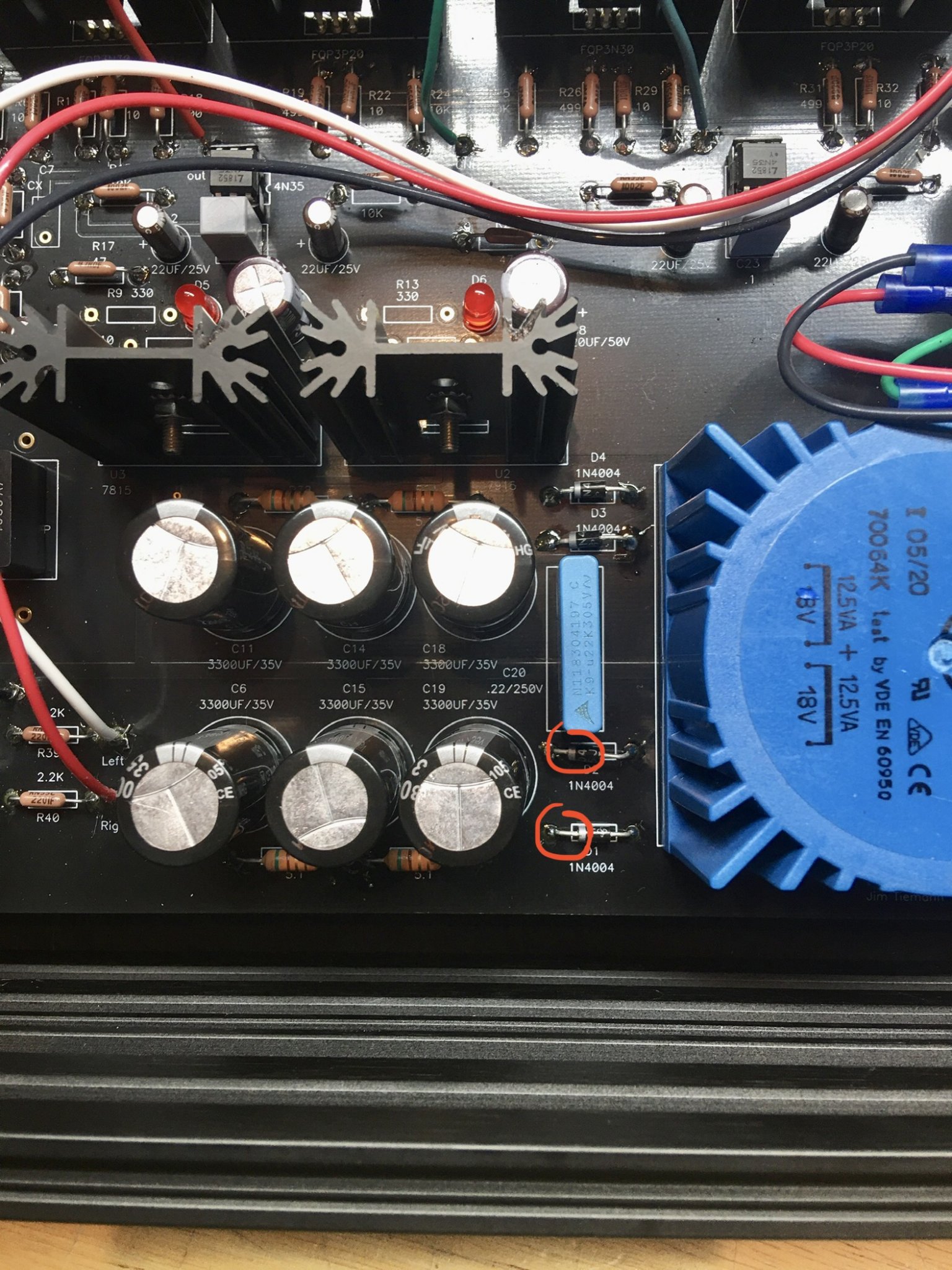

I jumpered R9/R13 and the power supply is now +-15vdc. Interesting after plugging in the OPA2134 only the right channel works. putting back the 4580DD and both channels work. I'll need to order a new OPA2134 incase the 2 I have are defective for some reason.

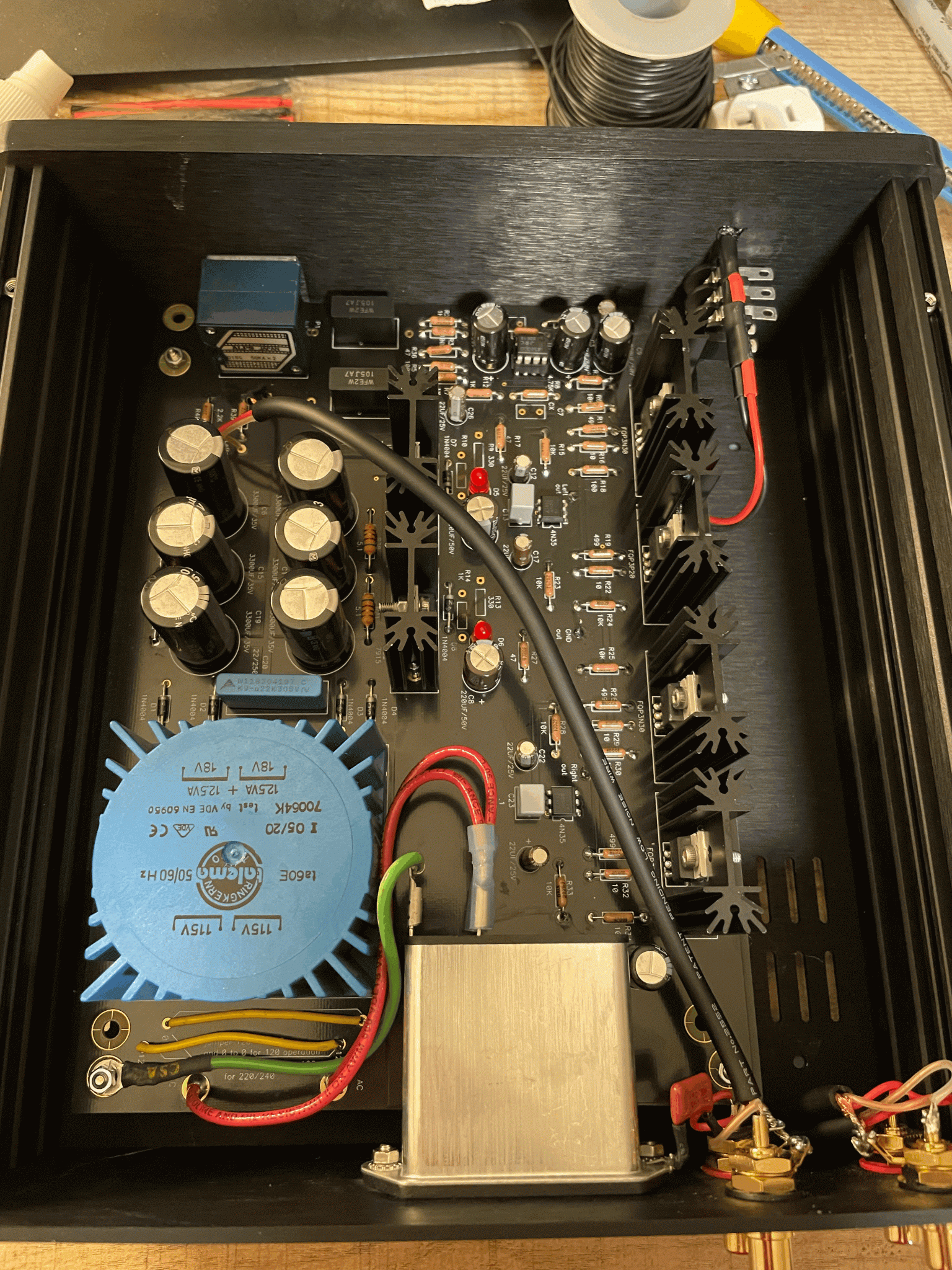

I have a bit off house keeping to do yet...like install the knob (can't find my metric allens wrenches), connect the LED, and close the lid. Which brings me to my question - where is the best place to take power for the front panel LED?
Appreciate any ideas.

I took mine from the junction of R37 & C6 from the underside of the power supply. Also used a 20K resistor in line with the LED encapsulated in red heat shrink tube. wire runs under the PCB looks neater.
In the end, as recommended in this thread, I connected the anode of the LED to R10 and the cathode to R9 (pads on both towards the front of the PCB). Seems to work fine…although not as tidy. I used a 10K resistor and a blue LED. Thanks for the suggestion though.
