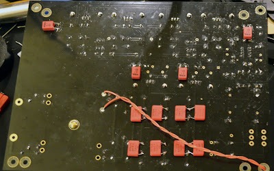

Hello everyone... i just saw the picture below and i would like your opinion.... is there any value in such a practice?
I quote the comment :
it's from here: http://www.diyaudioblog.com/2018/05/whammy-pass-labs-diy-headphone-amp.html
I hate this picture as it looks terrible from all the flux (this is before I cleaned it with some isopropyl alcohol and a toothbrush), but It shows where the film bypass caps are. The units in the audio section are polypropylene and the units in the power supply are polyester.
If you're asking whether or not it's beneficial to install all those bypass caps, YMMV. Lots and lots of discussions re: bypass caps in almost every application and for almost every project out there. I look at it this way... one of the most brilliant designers in audio didn't put them in, so who am I to second guess. But.... this is DIY, and we often go overboard, and we often just want to know if anything can be "better". I'd recommend building one and getting it functioning without them per the original design. Then if you're feeling adventurous, build another one with them and/or add them to your existing build. I am sure others would love to hear your thoughts re: before and after. More importantly, you'll know for yourself whether it had any value.
If you're asking about cleaning your boards... again, YMMV, and it largely depends on the type of flux being used. Most flux in most current solders intended for this use-case is "no clean" flux. Either way, I always clean my boards even when using no-clean flux. It makes it much easier for me to inspect my joints, and it makes me feel good.

As for my personal reference.... I can tell you that it has its right purpose in the PSU line. Right at the regulator or in some/most case very close to the opamp.
As for sound output I try to avoid this. I prefer a very good quality cap over the shunt version. Better to have a good Elna Cerafine or Silmic II then some simple cap with shunt.I still have a bunch of NOS Siemens B45178 tantalum caps which I fund very good for line in and output. or still use Tantalum for PSU.
Thank you for your answers! I will follow the advice of both of you. I am waiting some last things from mouser and i will start building the amp probably next week so i will try both versions and i will post my impressions.... but with caps only in the PSU line.... Funny thing is that i was about to try the exact opposite..... Also i will add a gain selector (hopefullly.... i believe i 've planned everything correctly) and pre-amp output so i will upload some photos of the process... Lastly i already have OPA1612, AD825 and AD746 and i will share my thoughts on them.....This kind of shunting was a big deal in 15 years ago.... Since then it has its pro and contra for success in sound quality.

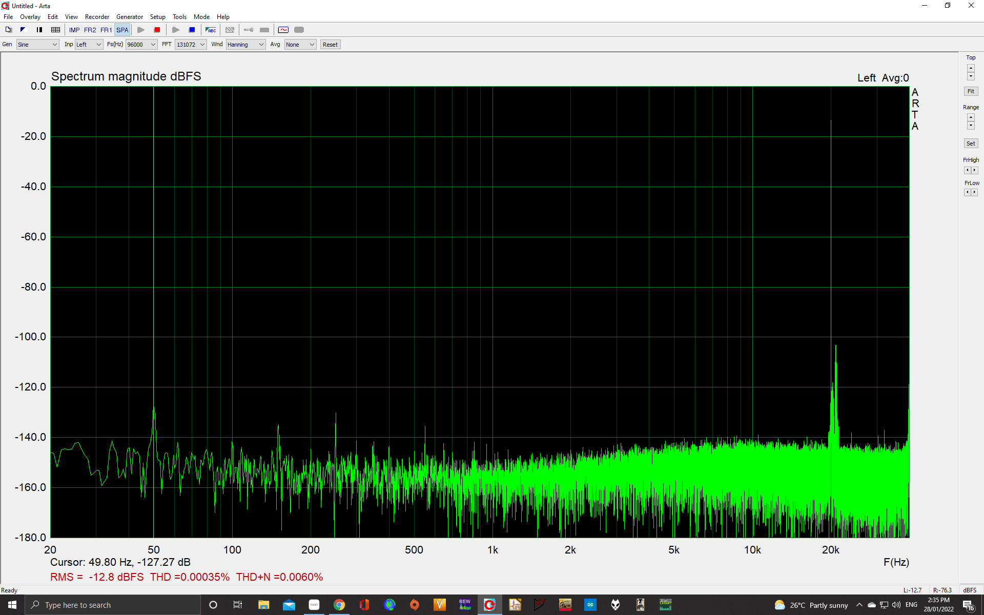

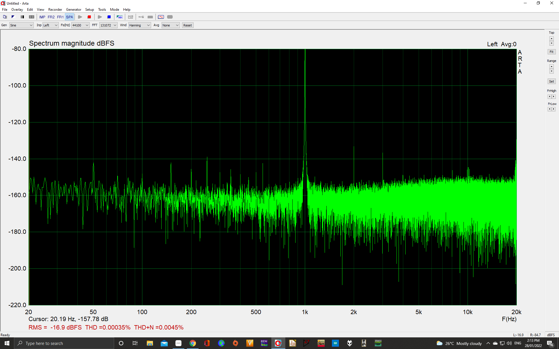

Hi All,
Completed my whammy a few days ago.
Tried the RC4580, OPA2134PA and Currently using the OPA1656.
Outputs are Fairchild FQP3N30, FQP3P30.
I took a quick THD measurement at 1 kHz and 20 kHz.
I did have some noise on my bench on the day.
This measurement was at approx 1 Vrms with a 32 Ohm load. ~30 mW.
Overall Wayne's design is really neat and it was a fun build.
Thanks for the design Wayne and thanks for the build guide Jim.
- Dan.

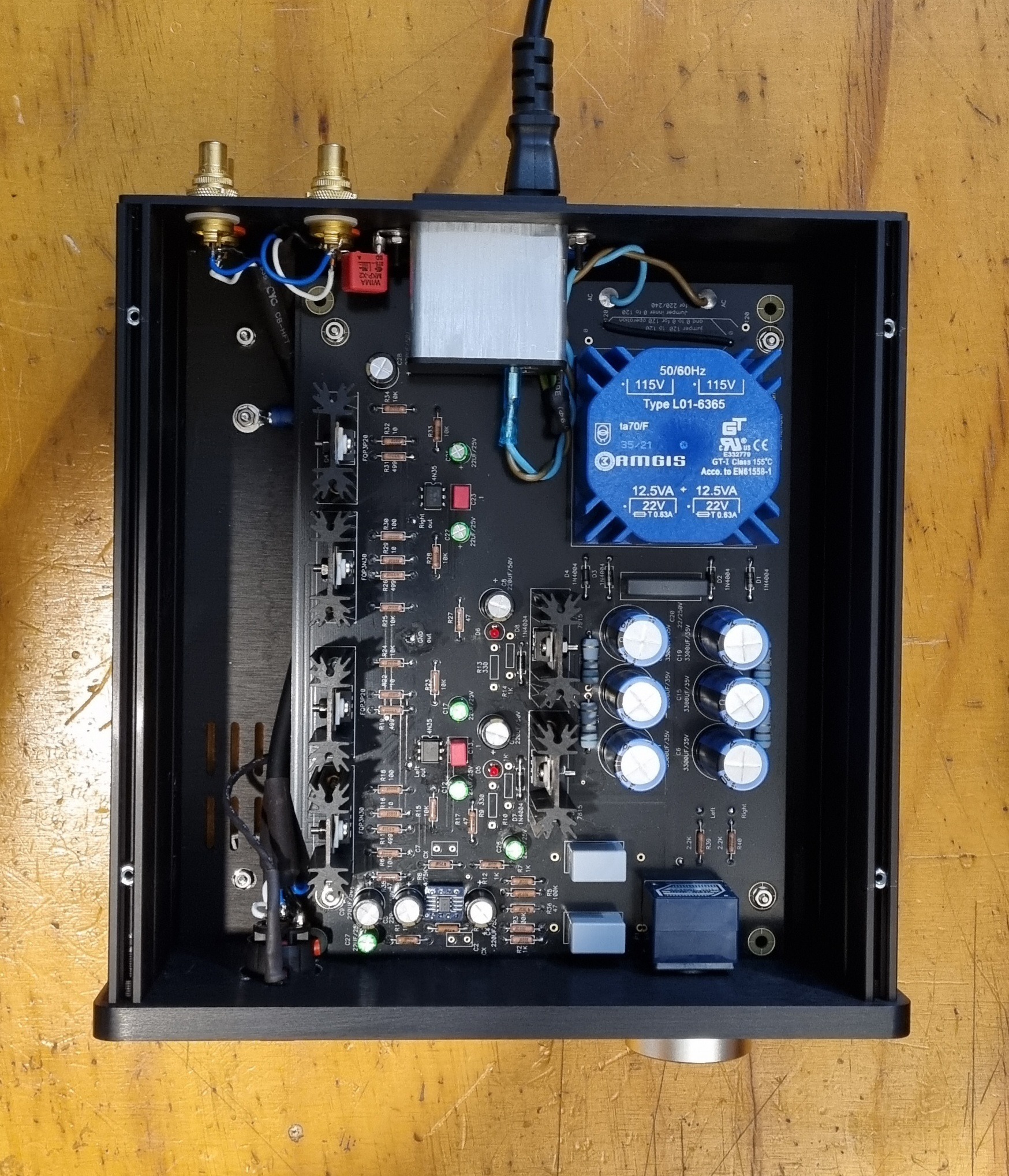

Where is the easiest/safest place to attach the power led, and how is the resistor attached? A good pic would be super helpful if anyone has one.
Also, a detailed pic of the wiring attached to both input RCAs and output RCAs with resistors would be helpful as well.
Perfect, thank you! I knew I’d seen it, but couldn’t find the post. Did you use a 10k resistor?How I did my power LED is in post #1525, located here:

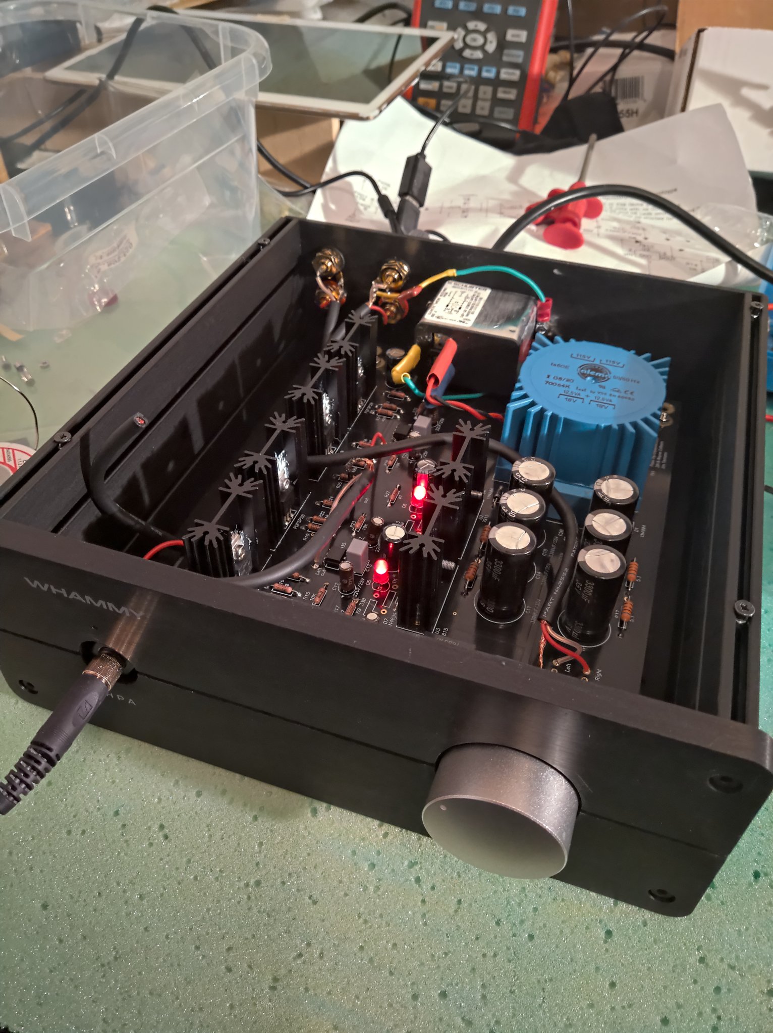

Got my Whammy ready for the first test today. Sounds amazing! Thanks to the society , diystore and Wayne! Just one strange thing I noticed at the end of the listening session, I had powered down my DAC and I noticed there appeared hum in the Whammy when I touch the volume knob. Also if i touch the metal parts at the front of the pot. Have I missed some grounding here or anyone else notice this? Perhaps remove some of the anodizing on the front panel of the chassis, where it touches the pot? Any similar observations or thoughts?
yup, improvise
pot metal body must be in contact with case, which must be in contact with safety GND
Yeah, I noticed I had to grind away the black anodizing from the stock black chassis to make a good saftey ground , so makes sense I have to do the same at the pot. I was a bit in a hurry there to get the hear the thing, and man was it worth it. Could not stand still in my shack with this thing plaing trough my Senn 650's and just a cheep Fiio DAC. Now to test with some better can's and some better DAC's. Much fun ahead 🙂
