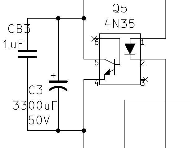

The M2x uses the same optoisolator for the same purpose. This fragment of its schematic may be helpful.
The little "X" on two of the pins is KiCad Schematic Editor's symbol for "NOT CONNECTED" -- they tell the software that pins 3 and 6 of the 4N35 device are not connected to any other pins on any other components. This is true for the M2x and also true for the Whammy.

Over Pin1 to Pin2 - the current adjusts the brightness of the LED inside the 4N35 and the brightness of the LED adjusts the BJT inside the 4N35 (from Pin5 to Pin4). This is how I understood it.

In some applications pin 6 (base) is connection to ground via a resistor and some times a small cap is added also.
I think reason could be EMC when optocoupler is used in switching applications to prevent a false trigger.

Hello Mr. Nut,
Pin6 of the 4N35 is not connected - if I remember right.

Thank you. That's the way it looked on the schematic, but I thought maybe I had misunderstood or something. Thanks for the clarification!

If I were to be experimenting with breadboarding that circuit should I connect pin 6 to ground via one of those methods or leave it floating? Will it harm anything to leave it floating? Which way would give the best performance?

If the purpose is for "auto bias" like in Whammy I would leave it floating. You could consider cutting the pin of totally 🙂 .....then less chance it will pickup some noise 🙂If I were to be experimenting with breadboarding that circuit should I connect pin 6 to ground via one of those methods or leave it floating? Will it harm anything to leave it floating? Which way would give the best performance?

If the optocoupler was the delay timer switch for a bomb I would consider grounding it via a resistor and small cap as you probably dont want a false trigger during power on.......
