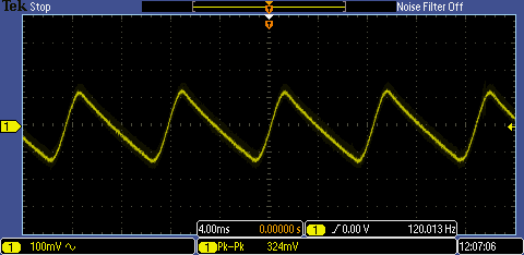

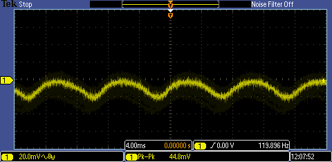

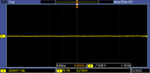

AC filtering is done in a big and effective way, utilizing a CRCRC filter with 3300uF capacitors and 5.1ohm resistors. You can use smaller resistors and caps if you like, it's a very effective filter and will work well with even 1/2 the values.
The regulators using 7815/7915 can be elevated a bit, using a red or green LED as the reference if you wish. Don’t use blue, they are noisy and they will set the regulators to too high of a voltage.

PSU ripple
Ripple after 1st caps.
Ripple after 2nd caps.
Ripple after 3rd caps, before the regulators. The lesson here? The “big and simple” approach of noise filtering using multiple CRC is extremely effective. 🙂

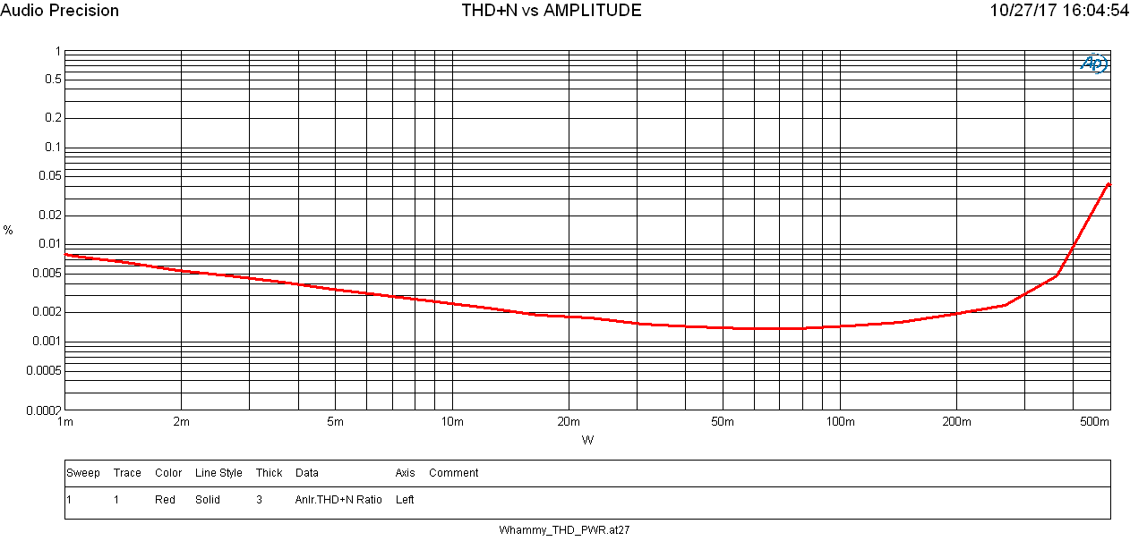

THD + noise vs. power output

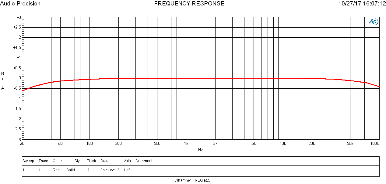

Frequency response

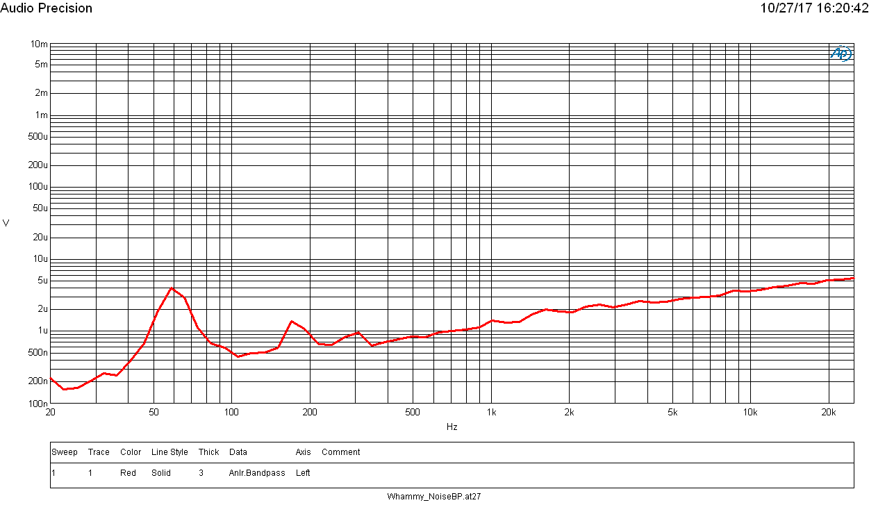

Noise floor.

PSU ripple

Frequency response
Noise floor.
