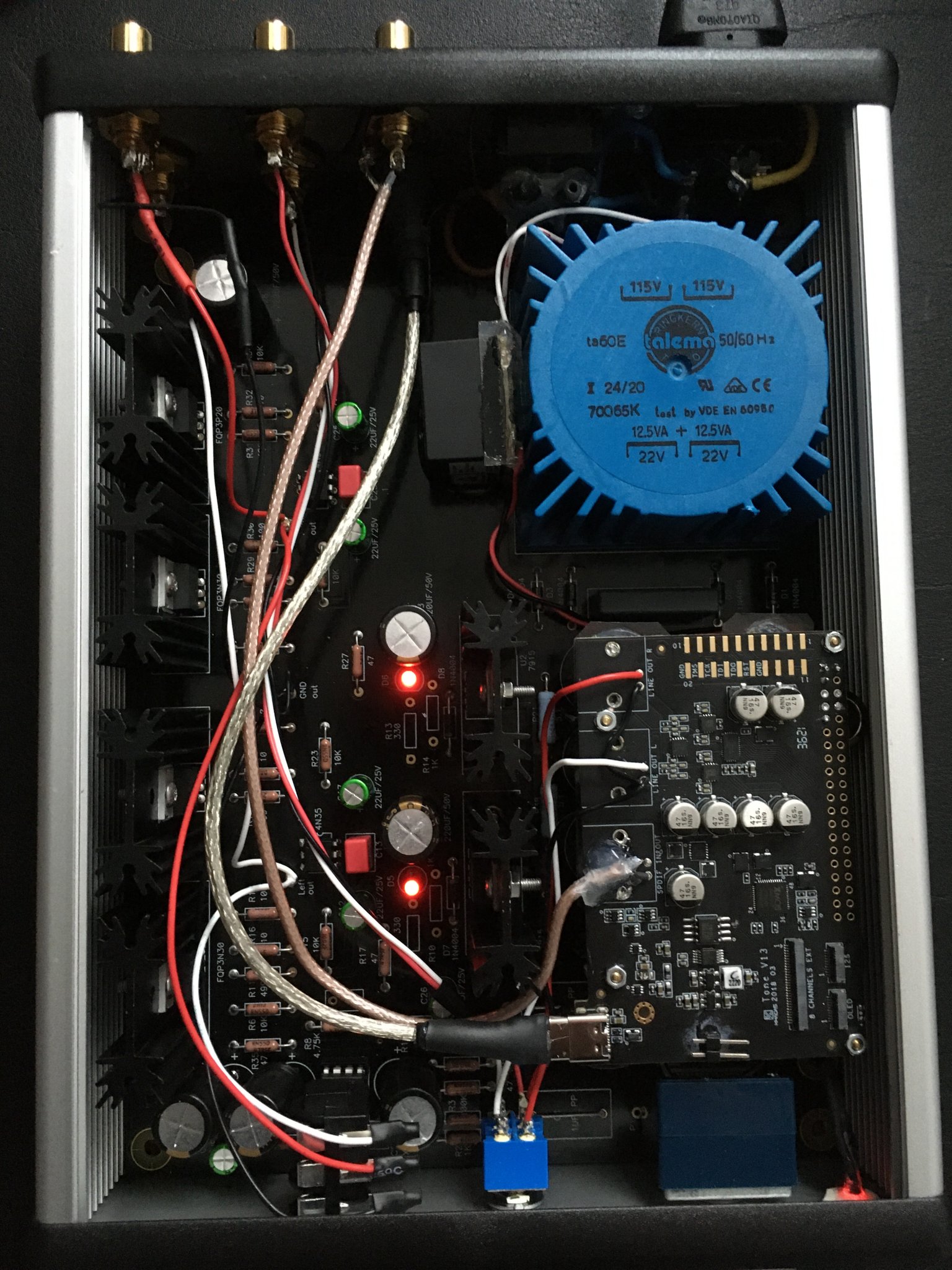

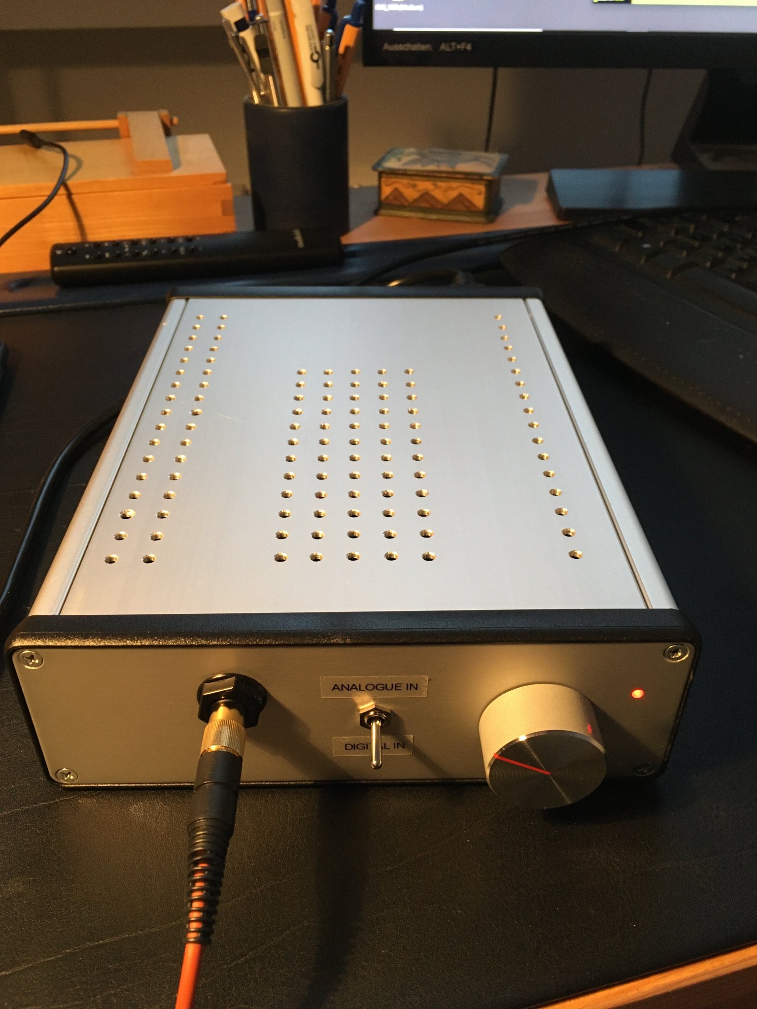

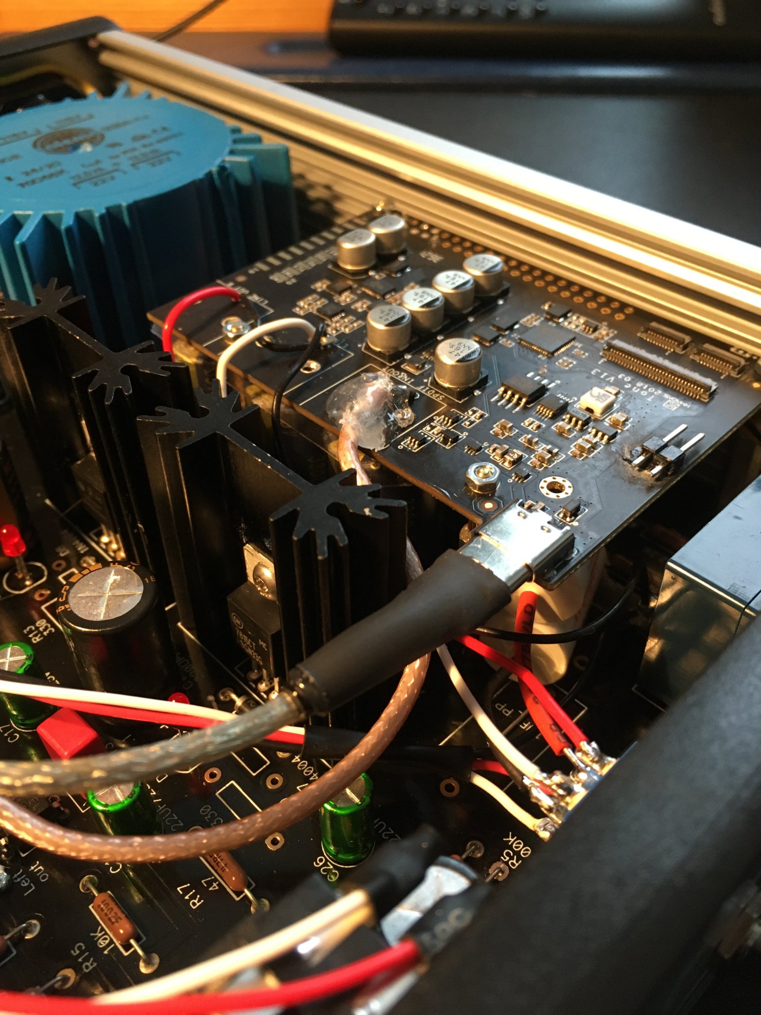

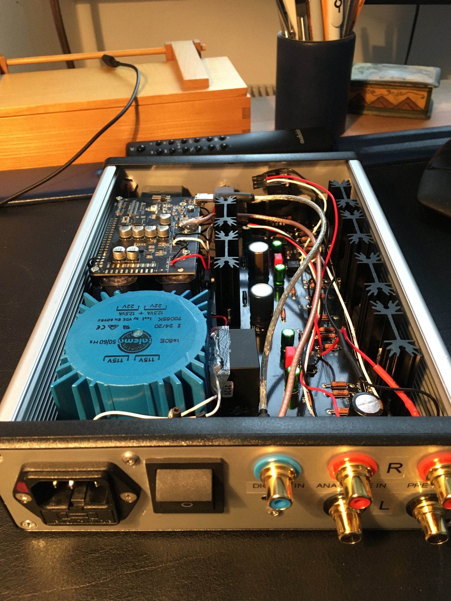

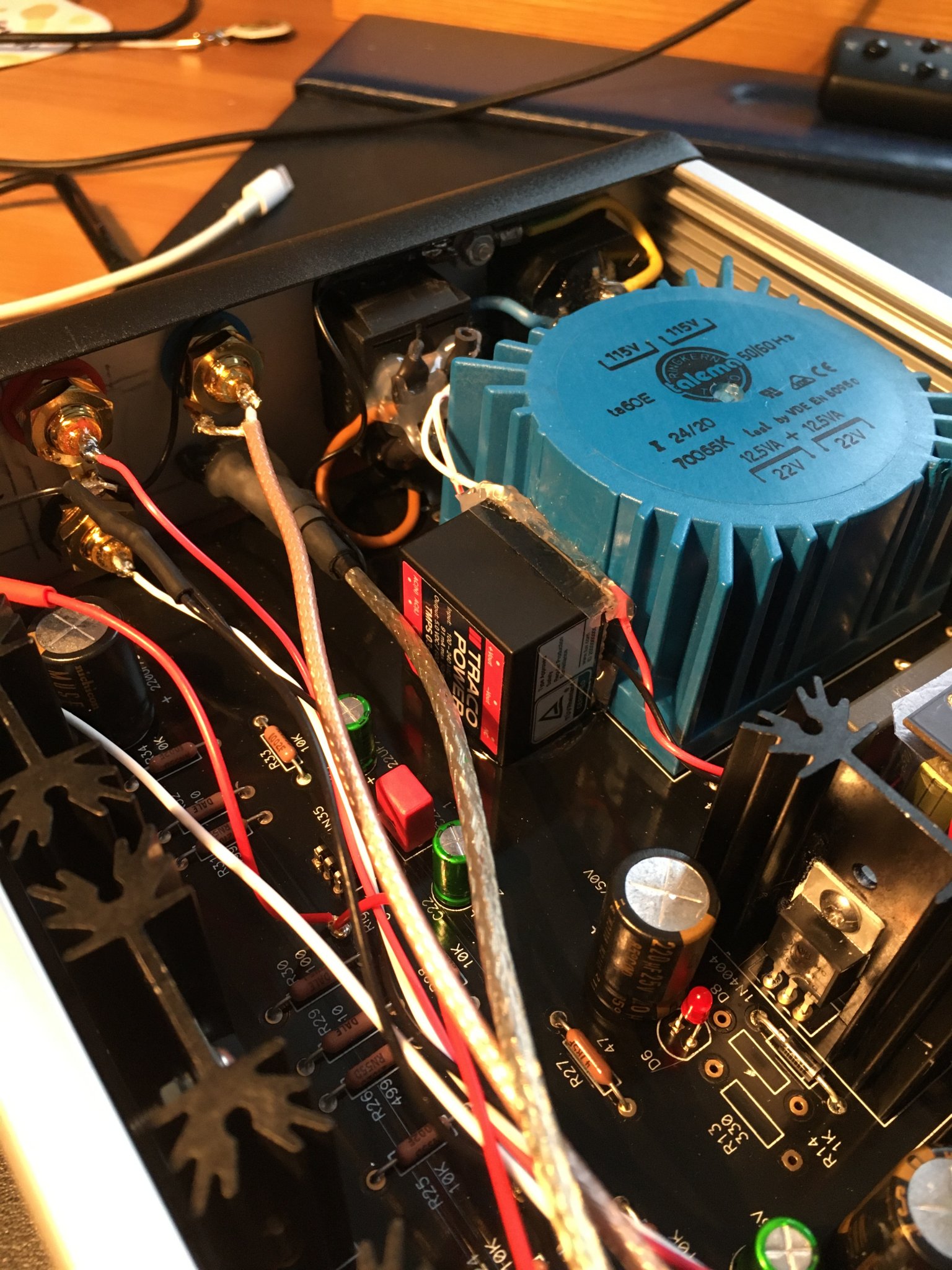

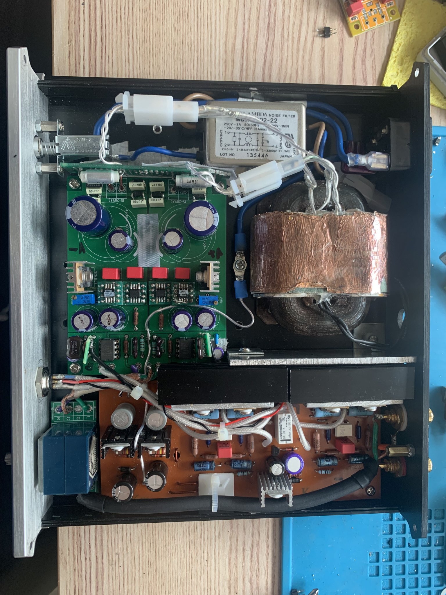

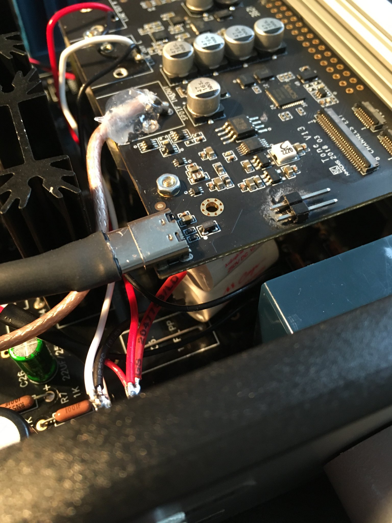

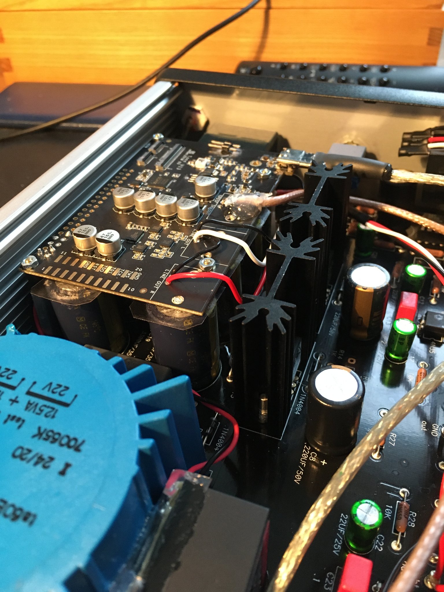

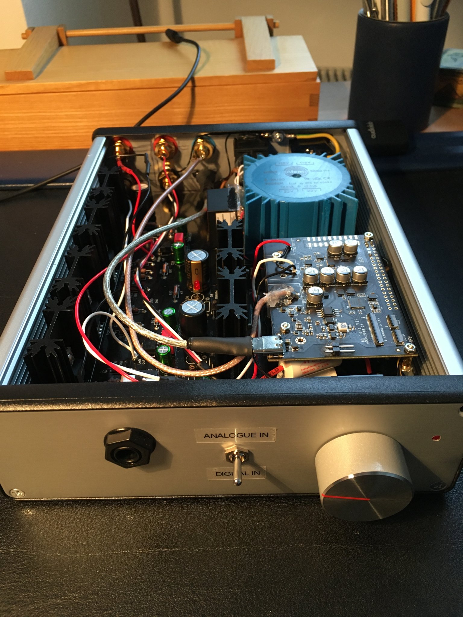

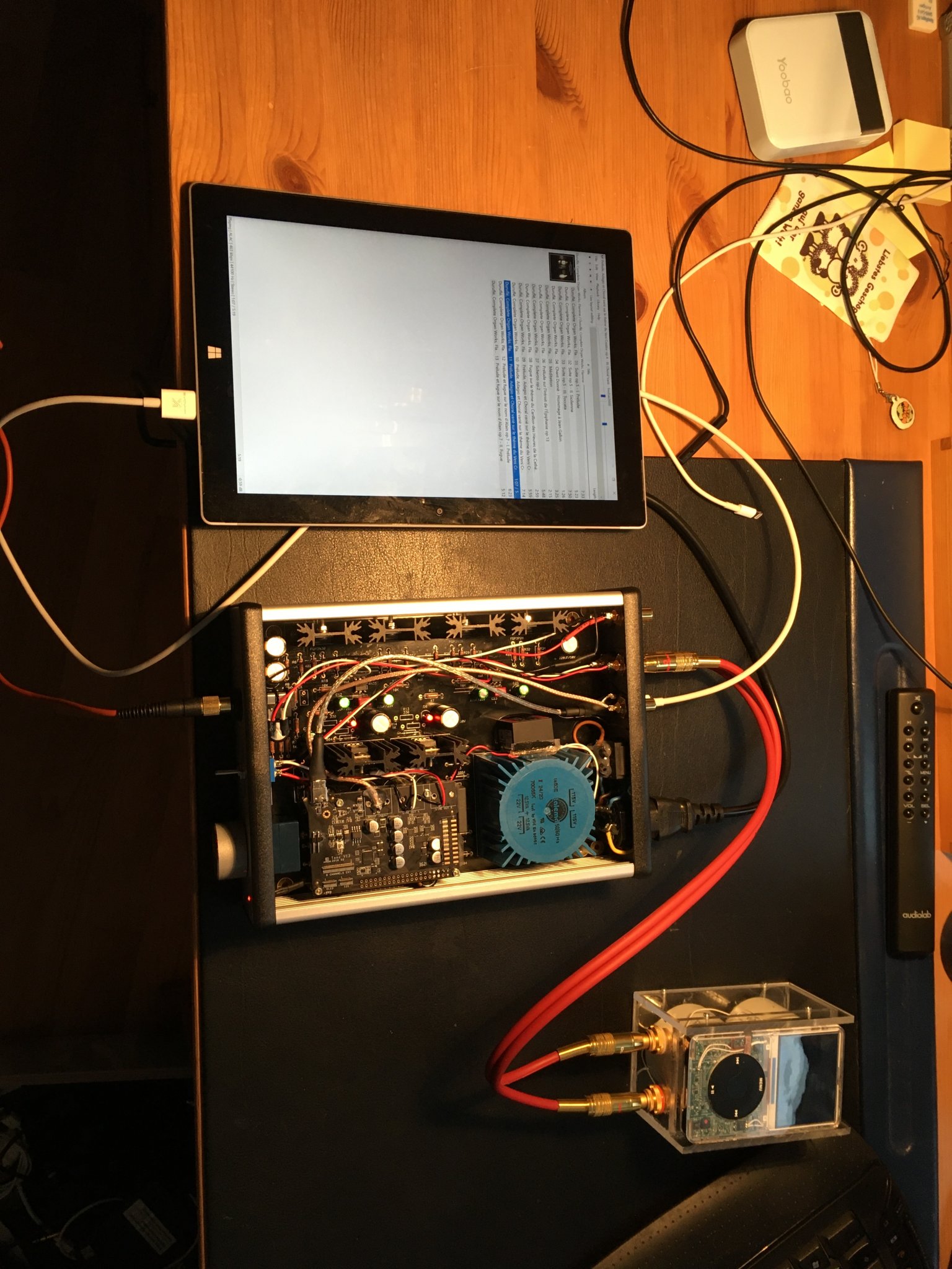

Hi all. I just finished my „experiment“ which was to add a DAC to my already existing whammy.
I share it with the community because it might be if some interest for others.
As DAC, I choose the Khadas Tone 1 because it has the size to mount it on top of the PSU caps. I wanted to keep the chassis as small as possible.
The Tone 1 is an excellent sounding DAC. As opamp I used the Muses 8920, in my opinion one of the best sounding opamps for a really reasonable price.
The Tone1 needs 5 V power supply. Normally it receives its power from the connected USB host. But if you use the spdif input, you would be required to connect a usb power supply. Not the best solution. So I added a mini high quality switched power supply. It is the black cube next to the transformer. I was curious if that would implement distortion. But everything is absolutely clean. No audible noise, hum or so and the measurements with the scope are also very good.
All in all an excellent sounding headamp, preamp and DAC

Nice work! I'm impressed you fit it all in the standard enclosure.Hi all. I just finished my „experiment“ which was to add a DAC to my already existing whammy.

I'm glad you're happy with the Toneboard, there doesn't seem to be many other compact board only DACs available.

Nice work.Hi all. I just finished my „experiment“ which was to add a DAC to my already existing whammy.
Nice way of implementing the DAC,
Removing the RCAs makes it much easier to accomodate.

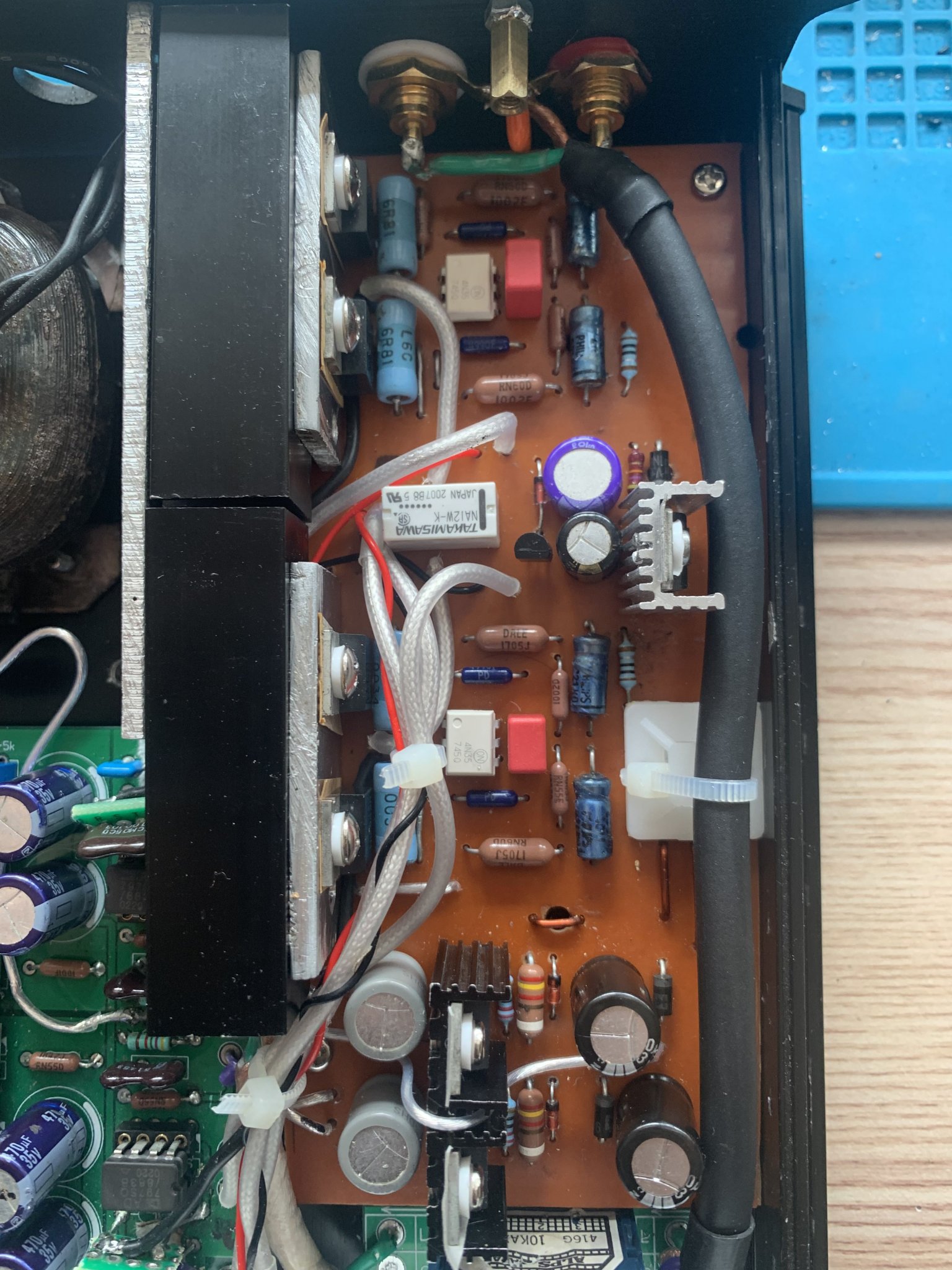

Hey guys I desperately need some help with the C26. I am not experienced in PCB soldering. I think it is very possible that I just damaged the PCB "little gold ring" of C26. Now the solder cannot be melted and stick to the C26 negative hole. I have seen people using a extra line to "bypass ( I guess)" some parts of the PCB. Cam I use similar method to solve my current situation. I really dont wanna start from the beginning to make a new whammy pcb.
Can you share two pictures:Hey guys I desperately need some help with the C26. I am not experienced in PCB soldering. I think it is very possible that I just damaged the PCB "little gold ring" of C26. Now the solder cannot be melted and stick to the C26 negative hole. I have seen people using a extra line to "bypass ( I guess)" some parts of the PCB. Cam I use similar method to solve my current situation. I really dont wanna start from the beginning to make a new whammy pcb.
One showing the top of C26 solder pads, and one showing showing the bottom side of those same pads

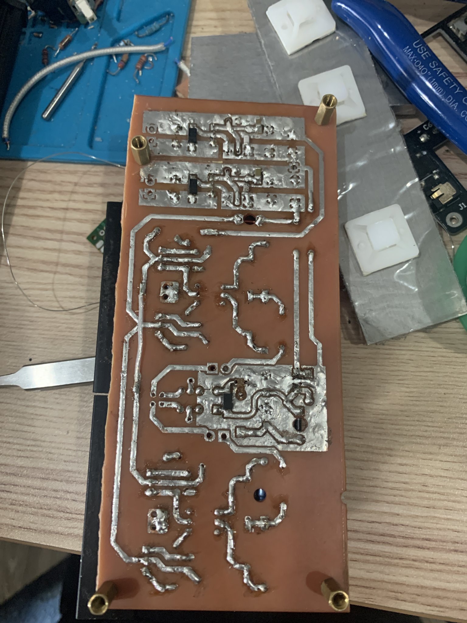

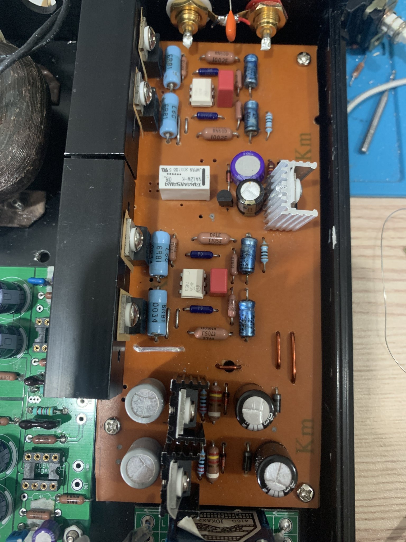

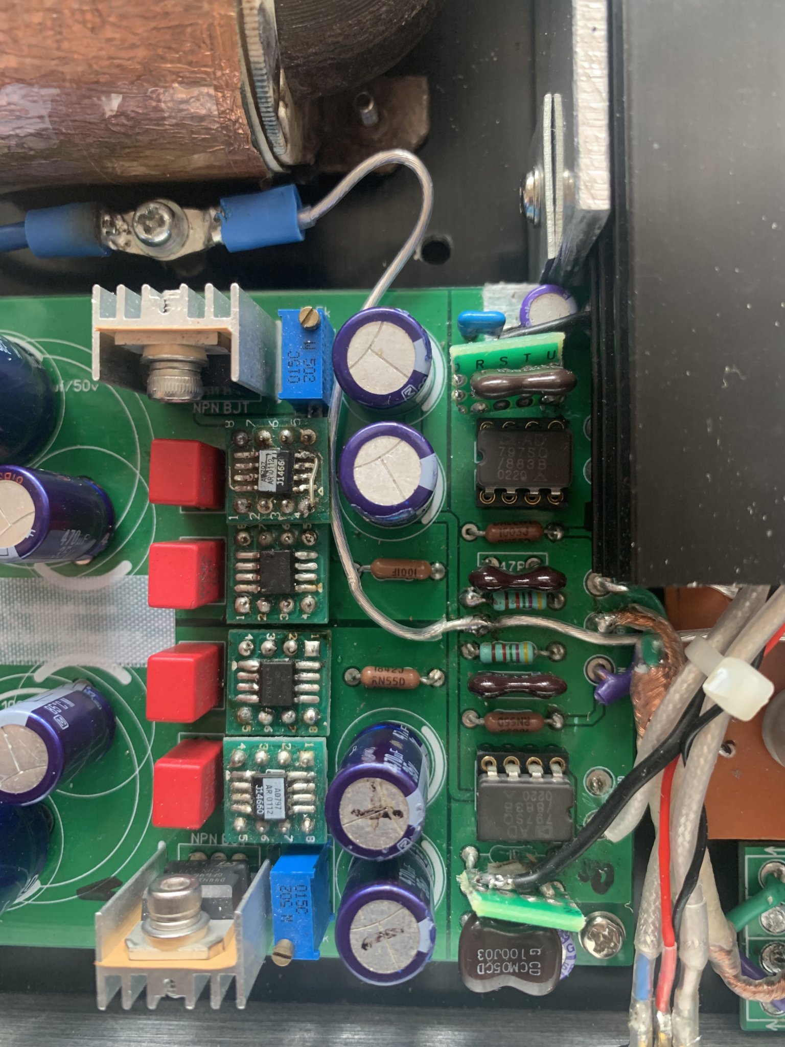

My diy pcb etching and building the Whammy amp. It started with a preamp board i bought from a local diy group, it use a clone GM regulator with AD797 and with AD586 voltage reference. I only need to build the buffer. The buffer then would be wire with the preamp board, including Input, wire for gain/feedback, voltage supply from the rectifier. The buffer has it own regulater with a pair of LM317/337, a relay protection circuit, Oyaide 102CCS as hookup from preamp to the buffer and used IRF540/9540 for output.
I tested it with AD797 and the result is pretty good.
I still have a bunch of 2SJ407/2SK2381 too but I'm not sure if they could be used for audio, so that's for future upgrade.

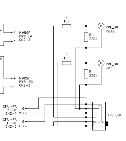

I have a question about using the whammy as a preamp. Does the (RCA) output need to be loaded with any resistance to when connected to a power amp? I thought I had seen photos with a resistor in series with the output somewhere in this thread.
@KevinHeem
Posted somewhere in this thread:
https://www.diyaudio.com/community/attachments/hpa-pre-out-jpg.986263/
I ran the Whammy as a preamp for several years without the output resistors. When the case was delivered and a lot of soldering was needed for installation there were resistors added to the output.
Haven't had any issue before or after.
Here you go:
https://www.diyaudio.com/community/threads/whammy-pass-diy-headphone-amp-guide.317803/post-6515594
