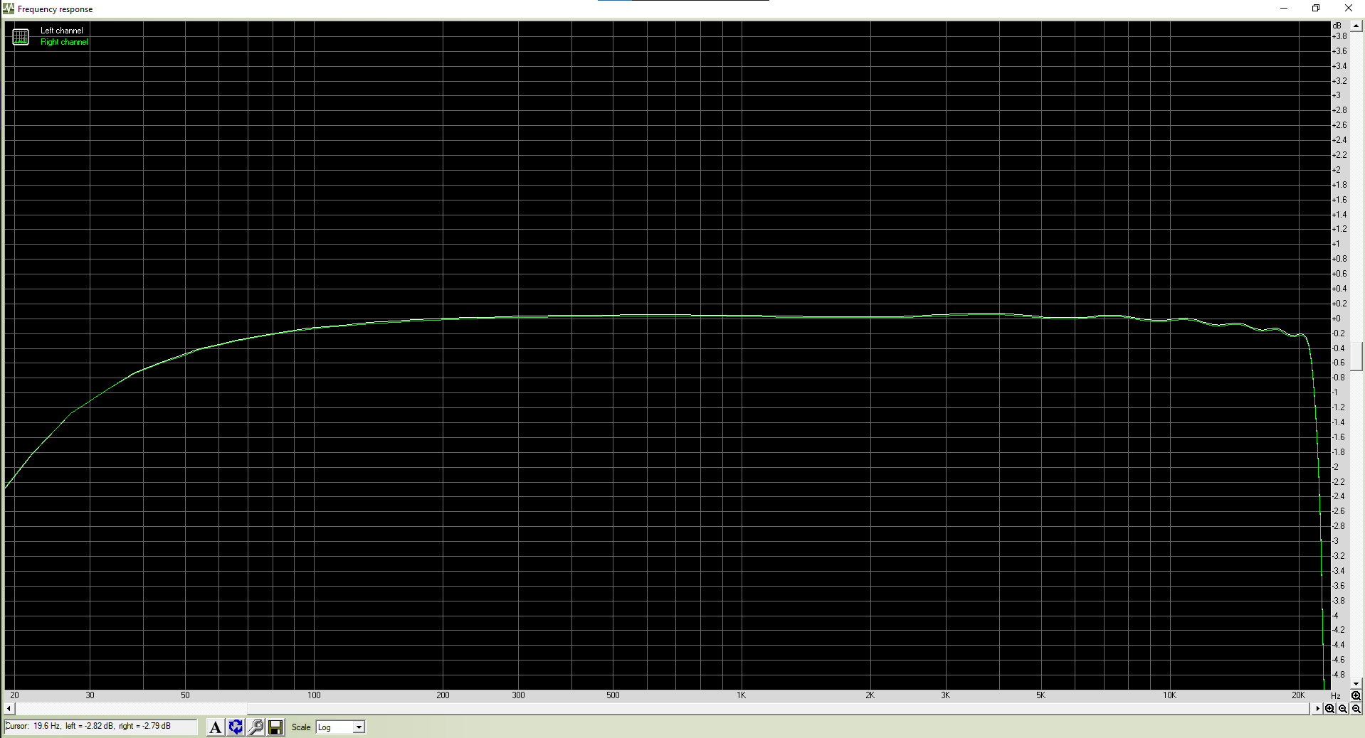

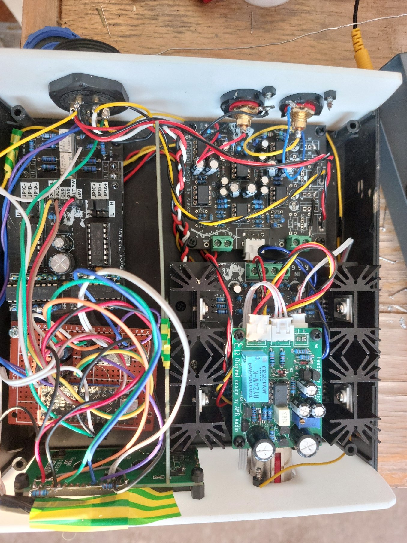

Not the most beautiful thing but it works for me. I used my spare muses8920 till the opa1656 arrives. DC offset on the right channel is 1-2mV and cannot measure the right one as it shows 0. Went with the basic gain config with no compensation caps and 20 ohm bias resistors. The positive mosfet gets a bit warmer as i used 4.7K instead of 10k but the optocoupler takes care of it.
As for initial listening experience the highs are back and bass is there more but only a tiny bit better. For context my current dac developed some bass distortion but a new one is coming.
I ordered a set of M3 screws and nuts but it never arrived so i had to improvise.

Its like the law of the universe that it works the day i build it but never after i screw the case together. Today i went to turn on the amp and no sound at all, the protection board never left protection. I measured the dc offset and it was oscilalting between +- 800mV on both channels. So i replaced the opamp with a NE5532, TL072 and LME49720 and the issue still presisted. I did every thing i could think of and as a last ditch effort i checked continuity between mains earth and power ground, yup 10ohm short.
The issue was right infront of me the whole time. The 1602 lcd displayed random garbage text rather than AMB Laboraties Lcduino VER... Opened up the psu and checked continuity between mains ground and power ground with the amp power cable disconnected and there it was. The cheap smps somehow shorted its ground to the mains ground overnight. Wrapped it up in tape and no more issues. The SMPS have its own metal enclosure.

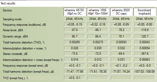

I honestly don't know what the hell is happening. My opa1656 arrived and i switched to it and that is when the shitshow started. I removed the DC caps and rolled the opa1656. Started up the amp, dc offset was 4.5mV and 1.8mV and it played music perfectly fine but the noise floor, dynamic range, THD, IMD, crosstalk worsened by a lot compared to muses. So i soldered 68pF comp caps and it improved drastically BUT with a massive caveat(forgot to save rmaa result). Now for the caveat, when i plugged in my heaphones there was only noise that did not change at all. So i added 100ohm+100nf to the input of the buffer board but nothing, added 10ohm+100nf zobel to the output, nope no luck. Added 220uf DC caps and nothing. So i installed a plain ne5532 and it was DEAD silent. As a piece of mind reinstalled the 1656 and insane amounts of noise again. I plugged it into my old amp and not a single issue with noise. My whammy really doesn't like the 1656 from the looks of it.
After 3 hours of trying to troubleshoot the 1656 i gave up. Tried all three 1656 i had, tried every single compensation cap value i had, soldering different supply decouplig caps and the noise wouldn't go away. I even reverted the amp how it was the first time i plugged it in but still no luck.
In the end i plugged in the lme47920 and gonna keep it in. It have less than 1mV DC offset on both channels without DC caps, exact same performance as the opa1656 without the headache.
