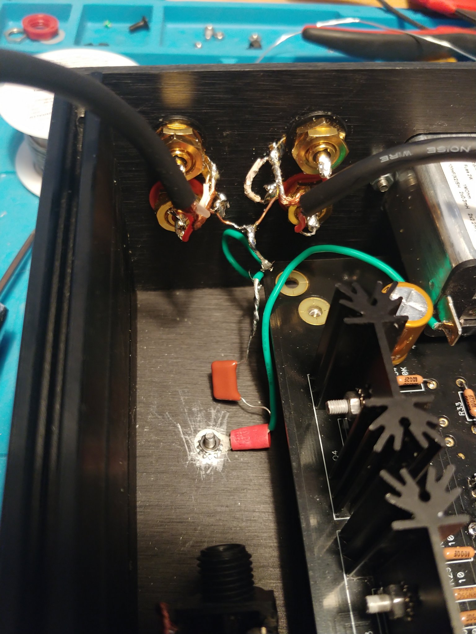

I confirmed the specs for old and new mosfets are the same. The TRS jack appears to be wired correctly. However, I am not sure about the signal ground. the photos from the build guide for the wiring was not clear to me. additionally, I connected my ground wire directly to the chassis without a star ring terminal. also, the signal inputs to PCB are soldered from the top of the PCB inadvertently.

Is your chassis ground connected directly with your IEC inlet GND on your ground lug (star washer is recommended)?
Then, is your signal ground connected to that with the 0.47uF (or similar) capacitor between them?
Uploaded a picture of mine. My wiring isn't nearly as clean, but this worked well for me (no noise, even at full volume) and may give you an idea on how I connected to GND (using pull down resistors for my pre-amp out).

Thanks, sp33ls! This is extremely helpful. I think this is where my issue may be.
The photo is a little dark. Did you connect your signal ground to both right and left RCAs? it does not look like the RCA GNDs are bent toward one another. did you connect the two with a small wire? also where (which RCA) did you connect the black GRN wire that runs to the GRN on the PCB?

RCA left & right ground are connected together with a wire and then that is connected to the capacitor.
That black wire connected behind the Alps pot on the PCB is also connected to both RCA left & right ground.
You essentially want to have all signal ground be the same, and then all chassis to be the same, and these are separated (lifted) by the capacitor, if that makes sense.

@sp33ls Thanks for the clarification. I tried to clean up my grounding on the input and added a terminal GRD (see attached). I also connected the pre-amp out (without resistors). I will not use the pre amp but wanted to wire it up in case it had some effect. Unfortunately, I damaged my silicone tip to my solder sucker, so I am in a holding pattern until a new one arrives.
Based on the clean-up I do not think it is a grounding issue as there is no hum. as I say the issue is in both channels and is best described as some sounds being muted, while others are not. Voices are often in the background while instruments are in the foreground. Sort of a reverse of what songs typically would sound like. It must have to do with the resistors or capacitors. I will go back through this thread to see if there are resistors that are miss labeled in this project. Unfortunately, I did not test them to verify value before I installed them.
