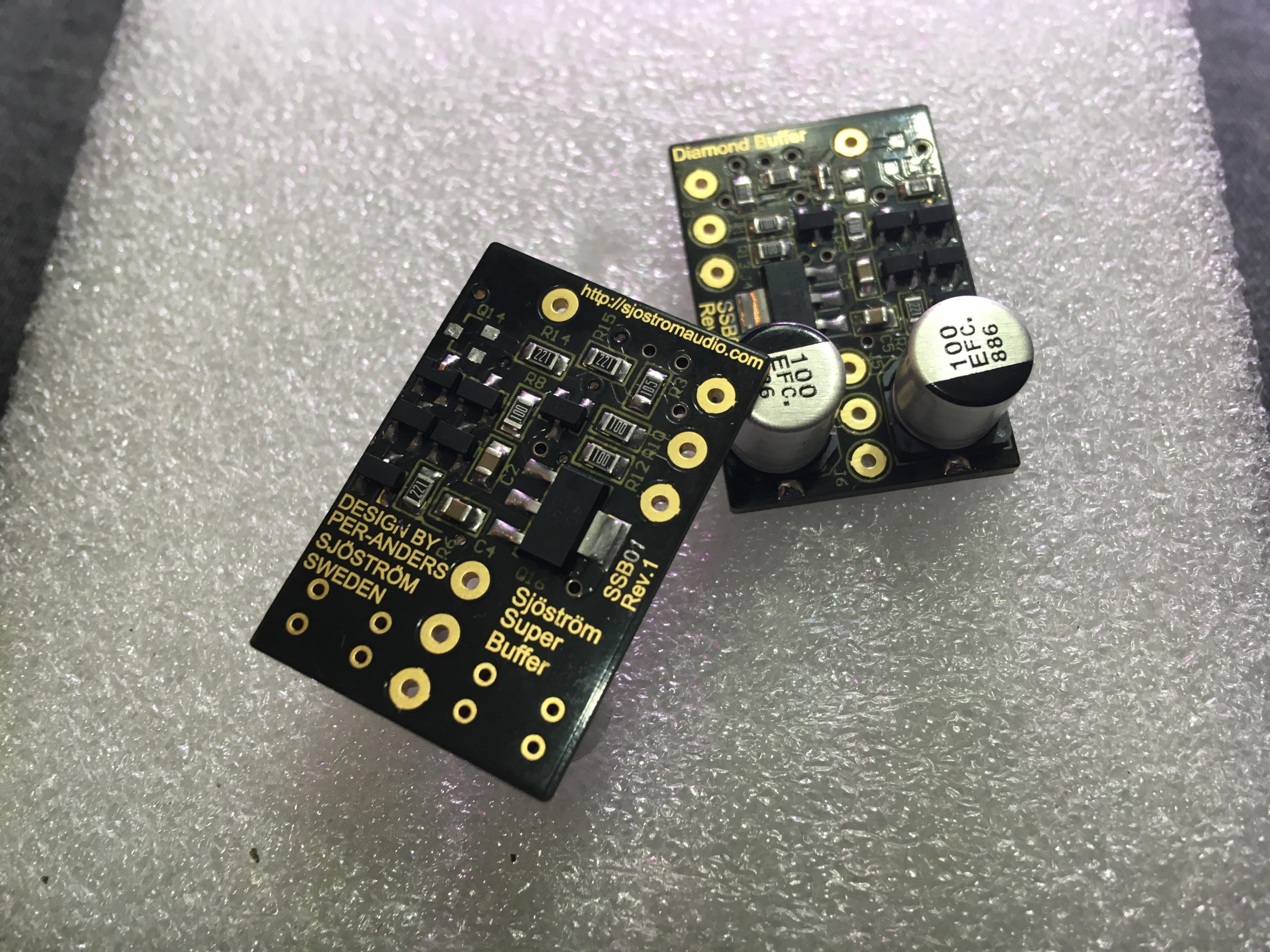

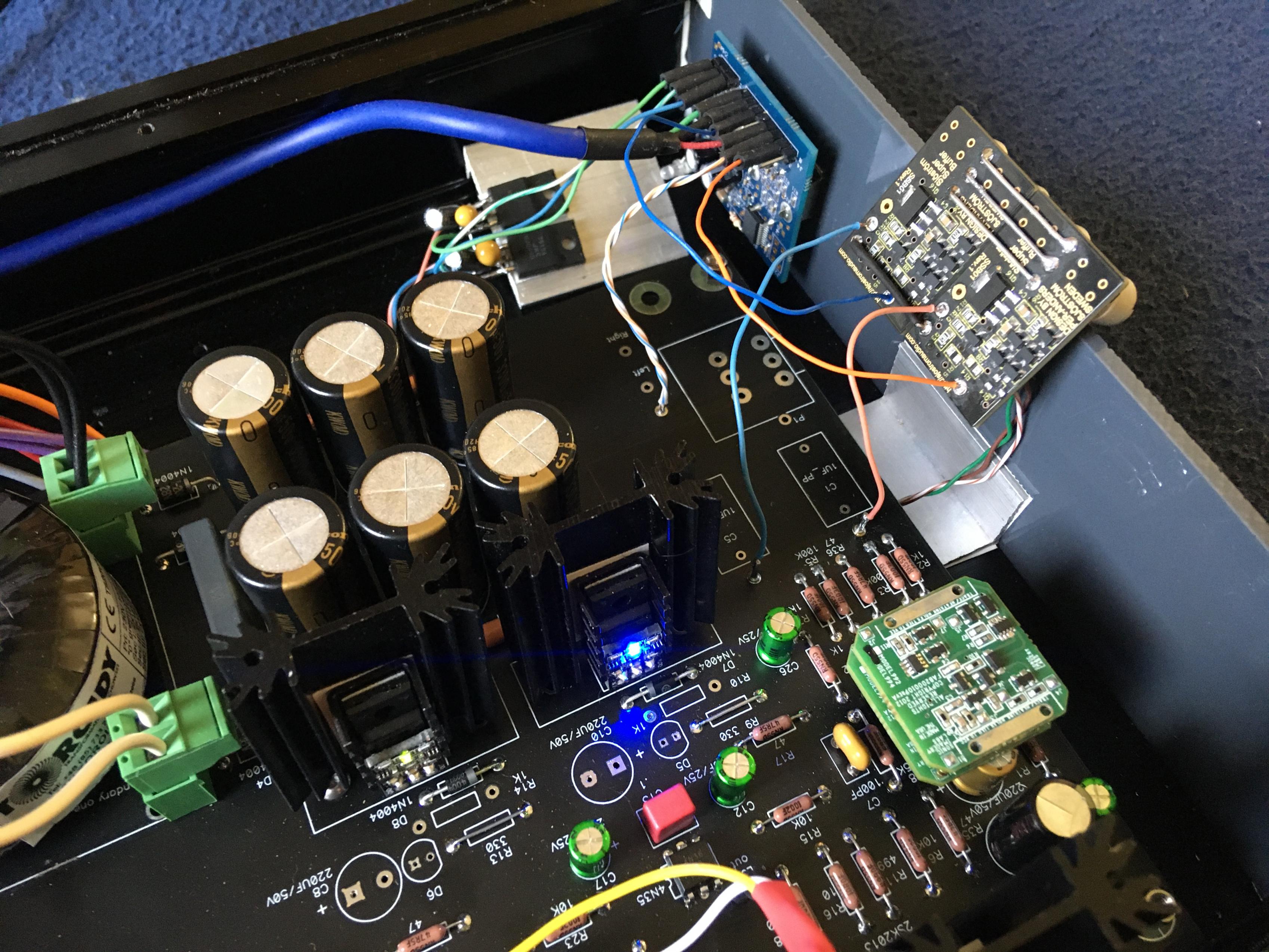

Here is my anniversary Whammy with a few toys. Dexa UWB regs, Muses Volume into Sjöström Super Buffers and the 994 Ticha op-amp.
The sound is remarkably good, the buffers are an experiment to practice using them, they will ultimately turn a power amp into an integrated and work very well. Perfect clear sound.
