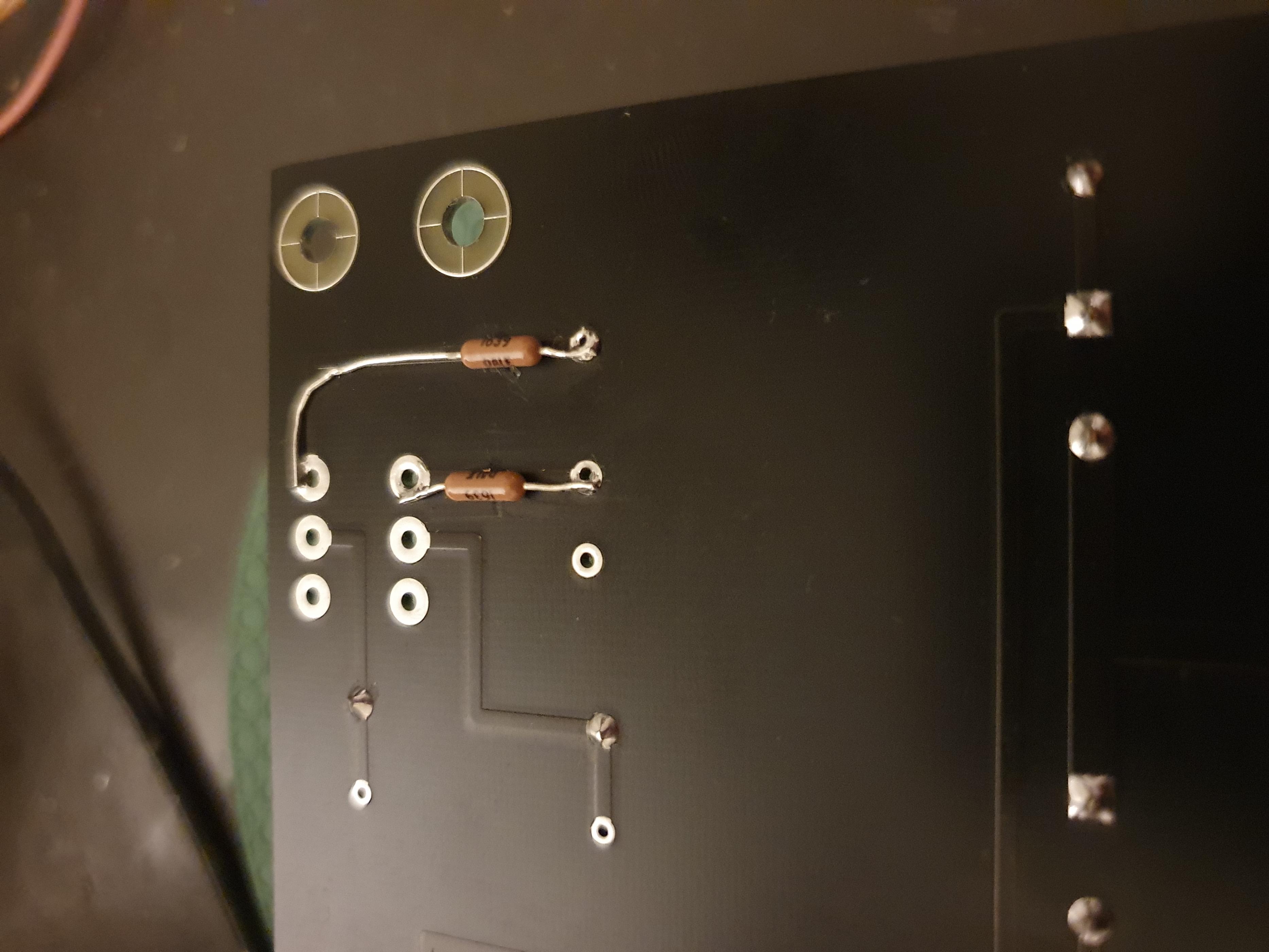

So, my board came in this week, and the parts are starting to trickle in as well. I am still waiting for a few parts, but the build is coming along slowly but surely.
The board is an old version, without a provision for the 2.2K output resistors. I decided to cut the traces on the underside of the PCB and install the resistors there, nicely out of sight. That will save me from fiddling with the cables later.
Speaking of cables: I intend to utilize some cat 6 pure copper s-ftp cables for input an output, to minimize crosstalk. Are there any downsides to using that?

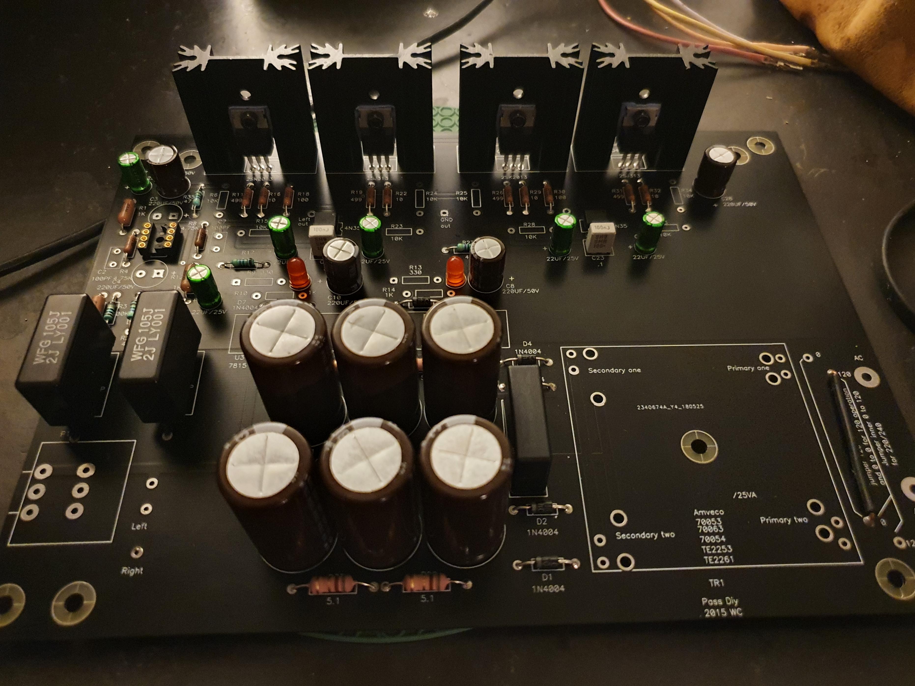

Man, I am not having luck building this thing. I'm at the test the psu step. i previously had gone the "LED reference route." When I first tested things, one LED lit up and one did not. I am a n00b and have no idea what I am doing so I pulled up the multimeter to try to figure it out. Eventually I got a spark and the other LED went out. After that I was getting about 37V on the rails for both +/-.
I have replaced the diodes in D7 and D8 after that. No luck, LEDs did not light up. Still getting about 37V. OK, I don't want to order anymore parts, let's see what happens when we at least try the "naked regulators" option. I should get 15V there too. But I'm not. I'm getting 29V in the attached.
The unshielded wire is a test of the naked regulators option. It isn't permanent.
Any ideas?
I recommend you stick with the LED method for now and make that work. It really is the simplest method. I've built 3 and tried the various options, and I'd strongly say to stick with that.
Did you check the polarity of the LED? I bet you have it in backwards. I did that on my first build. LEDs have an anode and a cathode so make sure they're in the right way. You can easily test this on your DVM by putting it into diode mode. When its on the right polarity, the DVM will make it light up. If you don't have a DVM as a last resort, check the data sheet for the LED. Also note that depending on the LED you used, you might have blown it by putting it in backwards. The diode test on the DVM will clearly indicate that. The diodes used in the kit are pretty cheap. If you really need one, goto mouser or digikey and get yourself 100 of them for ~$15 so you never are stuck without replacements.

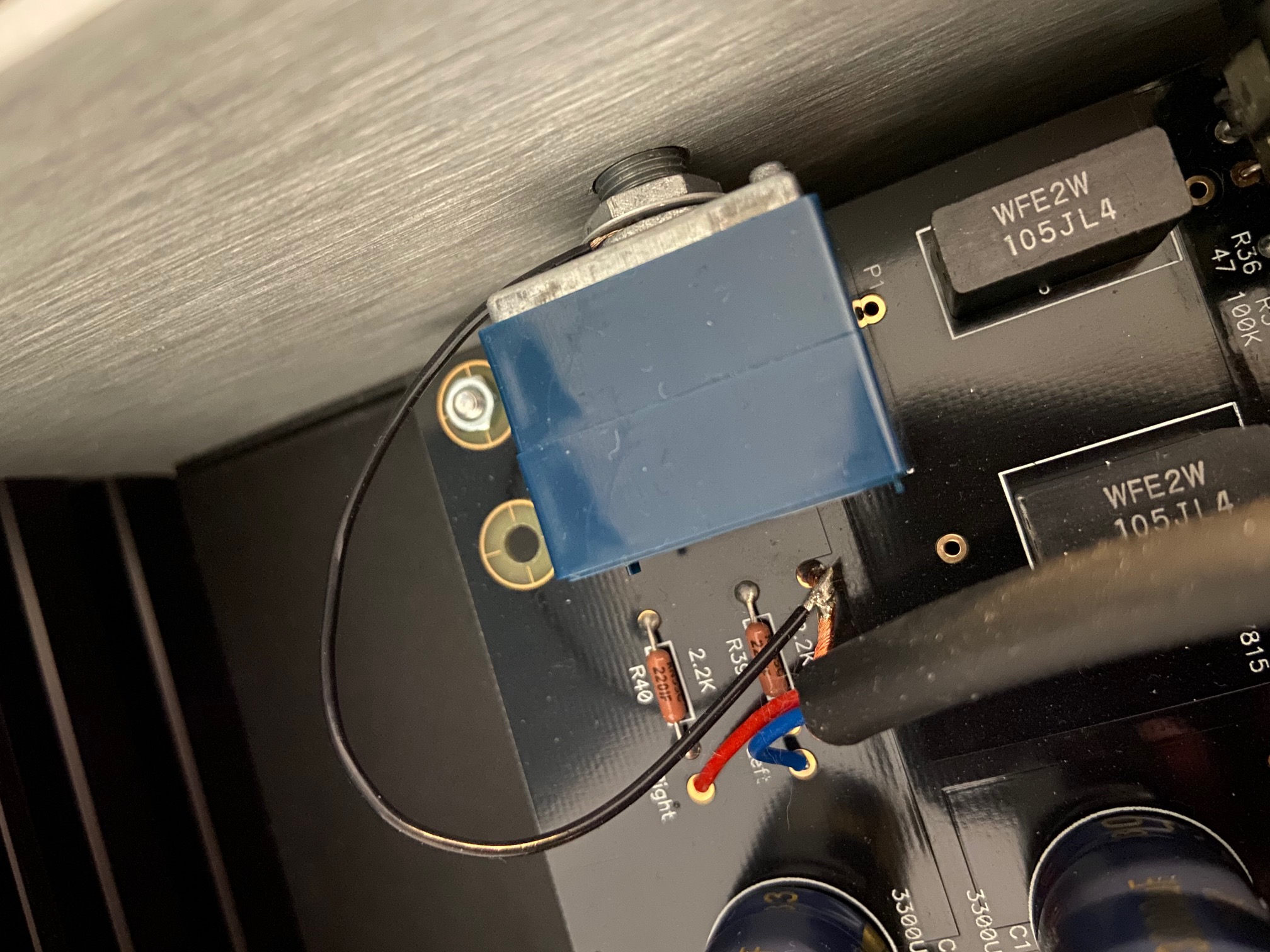

Hey Guys,
I have been building my Whammy a few months back and turn to you for help. I ordered the PCB plus parts kit and had a breeze building the amp. It works and produces wonderful sound. It however generates a significant amount of hiss, which ultimately turned me away from it. The amp has been collecting dust for a few months now and I want to fix the problem. Is there any obvious thing I am missing? I have been searching this thread and grounding the pot and RCA inputs helped with a hum, that I was having, but did not affect the noise floor. In the attached pictures you can see the current state of my Whammy. The RCA jacks currently have no ground connection, but that was for testing purposes alone (comparing ground noise with hiss etc). i am using a modushop aluminum case, if that helps.
Thanks a lot in advance!
It is hard to see but on your first photo you have a black wire connected to the ground/return. Where does that come from?
Does the hiss come/go when you touch the volume pot's case/knob or other parts of the chassis? One thing I've had to do with these anodized chassis is sand off the coating anywhere the chassis components touch so that we have solid continuity. You can simulate this by connecting the panels/etc... using alligator clips or probing around with your DVM too.

Hey guys,
thanks a lot for your kind answers and suggestions.
The black wire is for grounding the pot, which reduced a hum I was getting by a lot. The noise changed when wouching the pot and that issue is now gone.
However I am still hearing a hiss, which is not altered when increasing the volume (contrary to ground induced humming noises). I am using Meze Audio 99 Classics and with those headphones I can even hear the noise floor while listening to music.
With a loaner Focal Elear the noise is completely gone! Could it be, that my Meze pick up the amps noise floor due to their low impedance or lower sensitivity of some sorts? If so, is there any way to further reduce the noise (hiss), so I can use my Meze with the Whammy?
--Tom
The change in hiss/etc... is a sure sign you still do not have solid continuity between the POT's base and the rest of the chassis, including the chassis itself. You should have it to the point where touching the chassis anywhere including the POT doesn't change the current return path. It took me a good time to figure this out on my first Whammy but it is worth it; it should be completely silent.
--Tom
Do you have a earth/gnd lift or is the chassis connected to AC gnd (where your power inlet is)? You should tie the pot to chassis, not to audio gnd. Ideally, your chassis is tied to earth but not to audio gnd. Audio gnd should only be connected through a ground lift or ground loop breaker of some sort. In 6L6's build guide, he is using the film capacitor at the input to do this.
Looking at your picture - put an eyelet on the pot grounding wire and tie it to the board mounting bolt instead of audio input ground.
Ok, thanks a lot! I will try grounding the pot to the chassis and sand the anodizing from the parts of the chassis, that are in contact to each other.
While playing around with temporary wires from each chassis part to the ground, I noticed something: everytime i would turn the amp off the music keeps playing for a few seconds. Right in that moment the noise floor is completely gone, even with the sensitive Meze Audios. Could there be an issue with my power supply and how can I test it? Homework for me: sanding the chassis and proper grounding of the poti.
