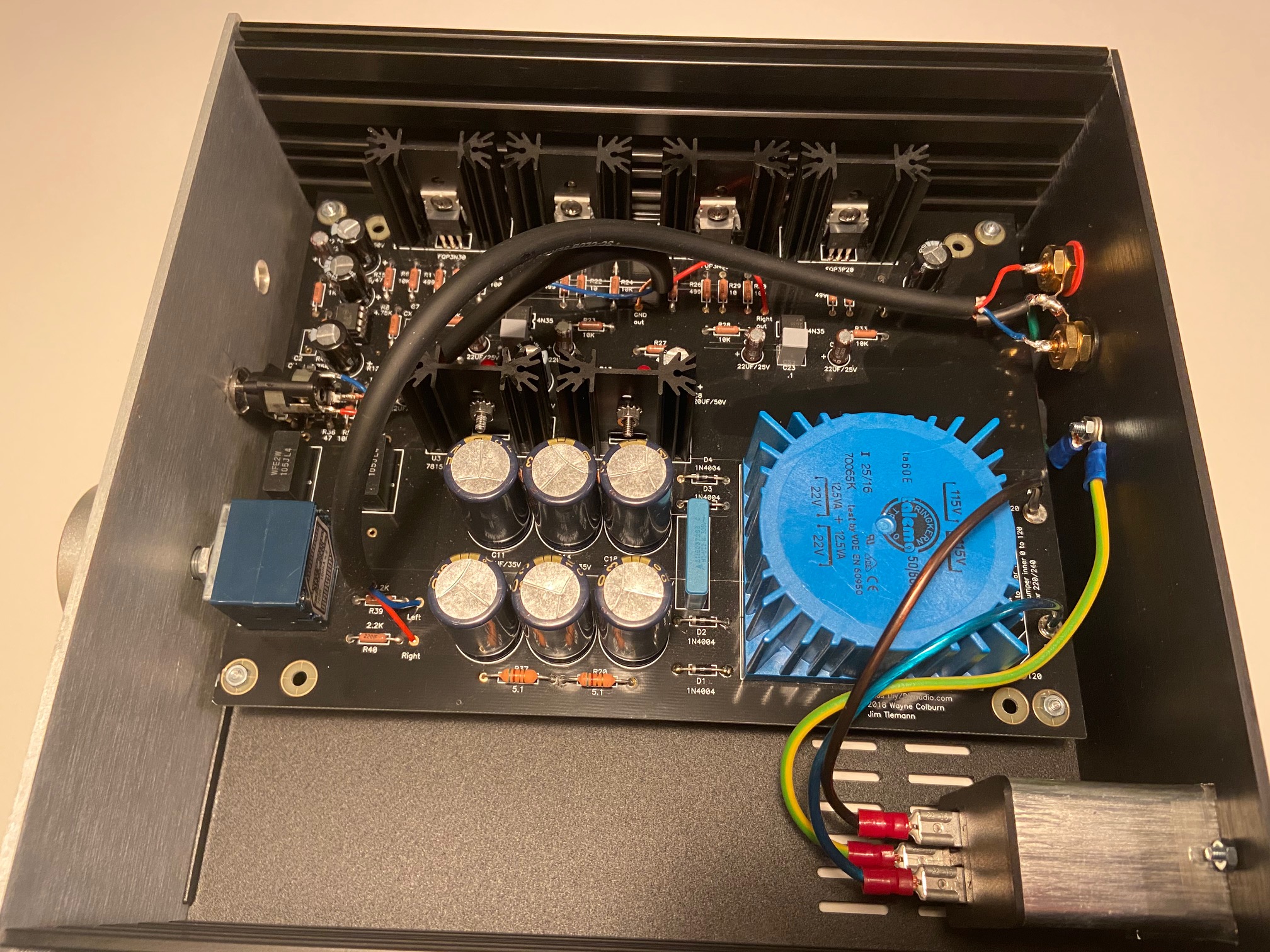

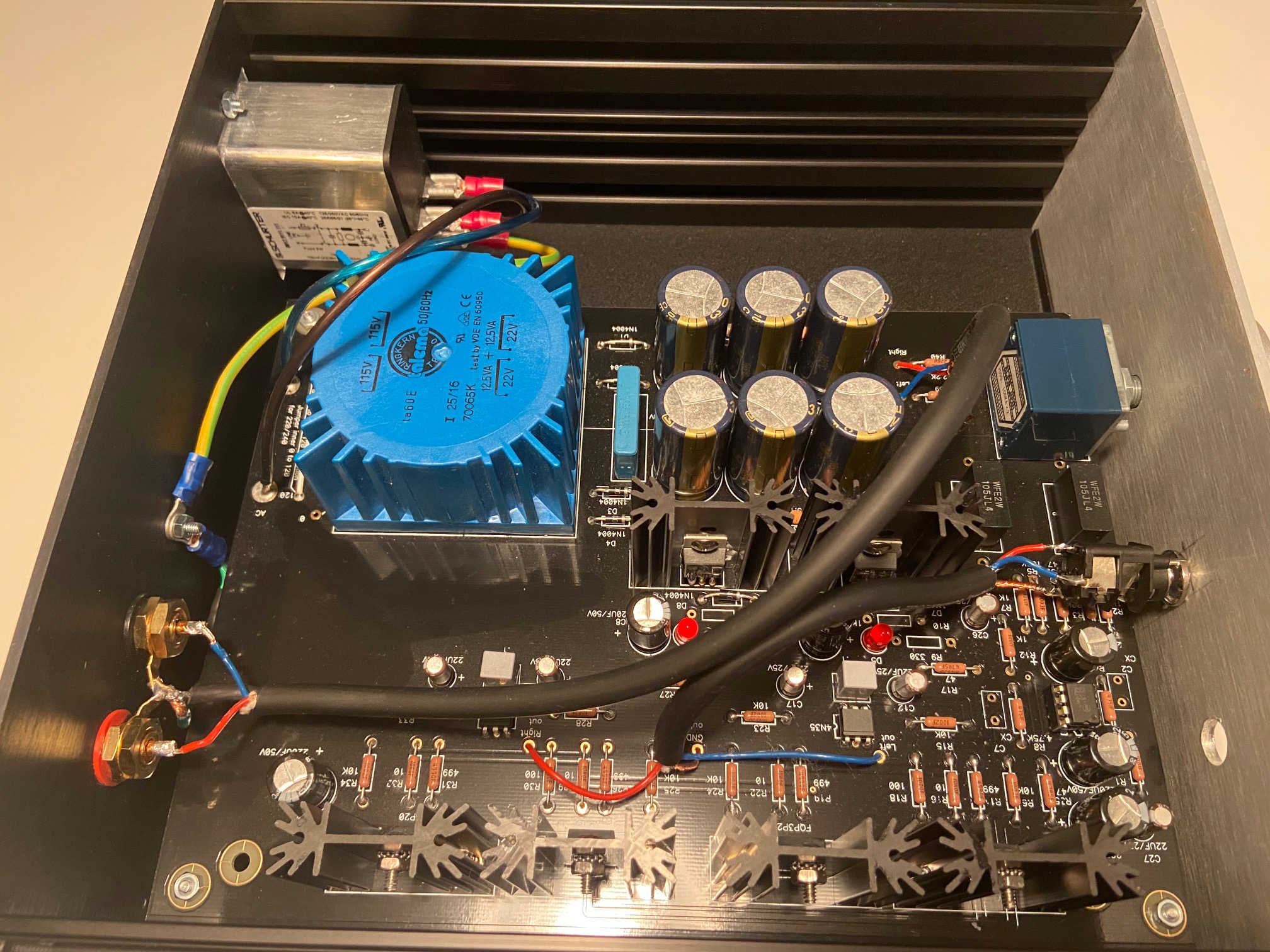

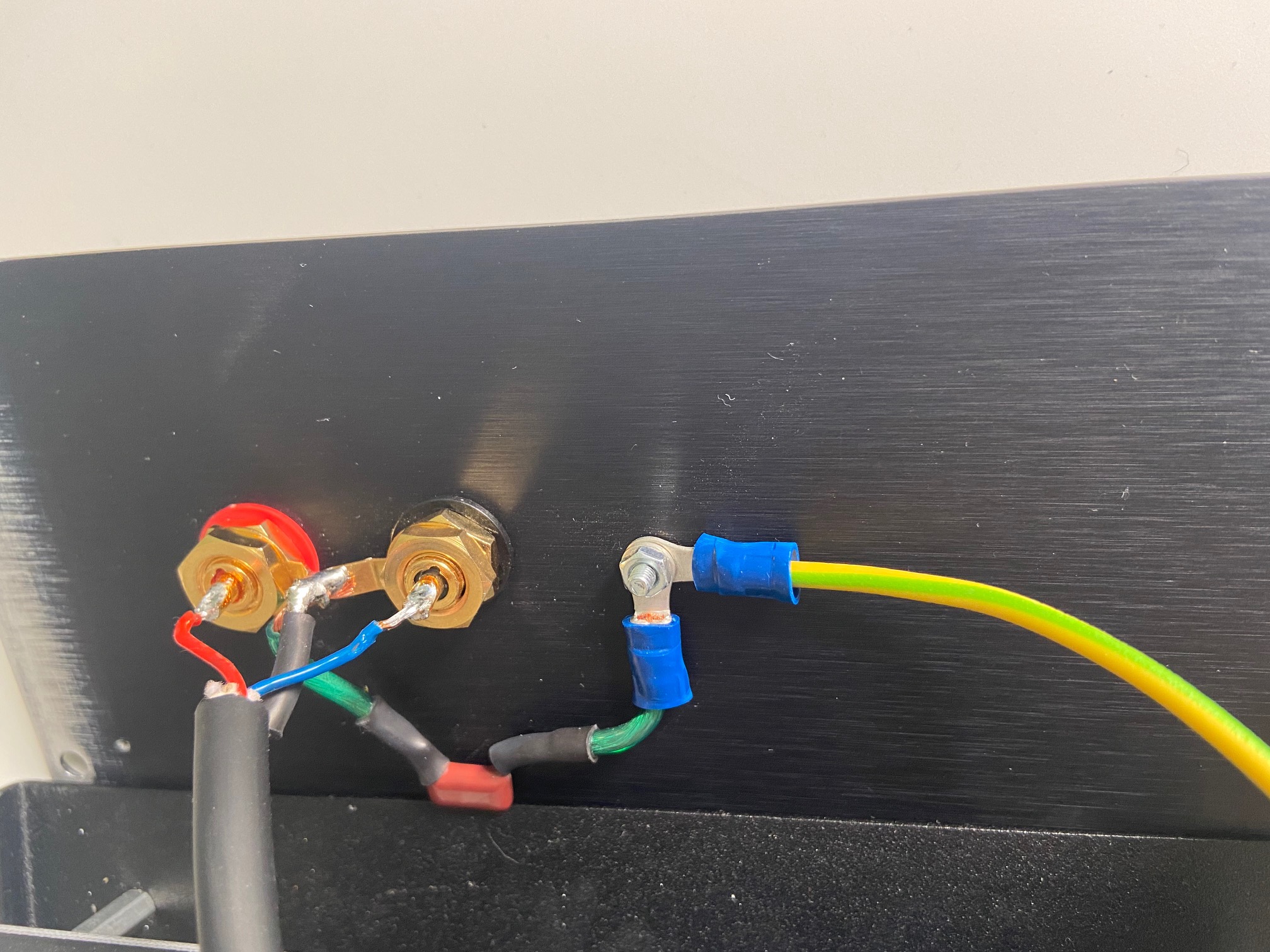

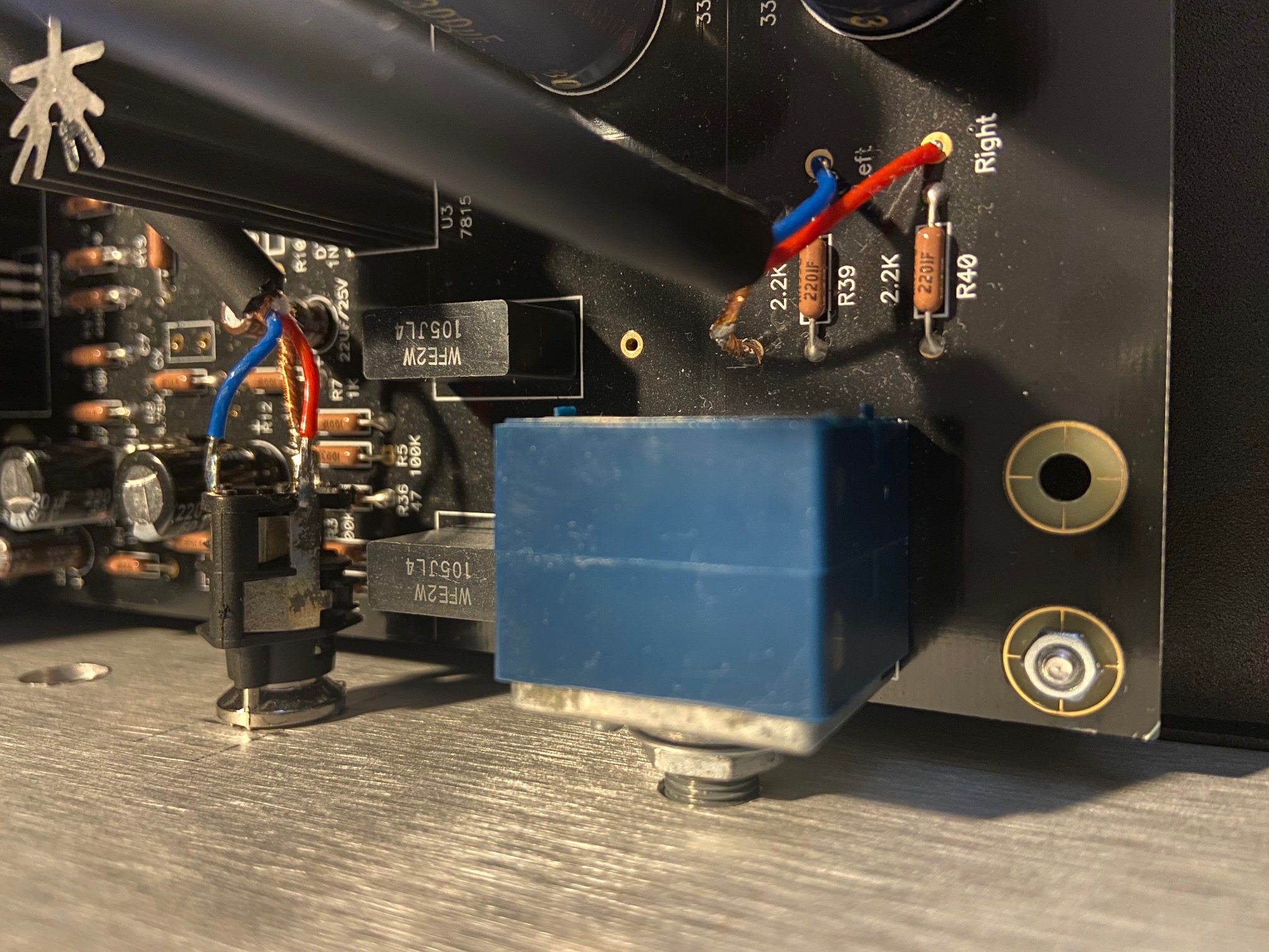

I finally got to sanding the parts of the chassis. I verified, that each individual part has a connection to gnd, but it did not alter the noise floor I described before.
With my K601s I cannot hear any noise, but with my old Apple buds a hiss is present and with my Meze Audios in addition to a very noticable hiss I can still observe a faint humming.
In the attached pictures you can see the ground lift, that twitchie described.
If you hear any difference or change in the hiss when you touch the pot it's because the body of the pot needs to be connected to chassis/earth. You could also test this with a probe wire to connect the fastening nut - which you have on the inside of the faceplate but others are using this to connect the pot body to chassis - this is the contact which you can use to ground the pot to earth.
If it's unrelated to the pot grounding then there might be something wrong elsewhere. Do you have any pictures of the entire amp?
I just noticed your headphone jack has a metal body - is the part touching the faceplate also connected to ground wire connection coming in? You could be poluting audio ground/output ground if it's actually grounded at the headphone jack to the chassis.
I could not recognize any difference when touching the pot, so i would think the problem is unrelated to it.
Regarding to your idea with the headphone jack: this is something I was asking myself. Having contact to the chassis and therefore to its ground I would pollute my audio ground, wouldn't I? Unfortunately it makes no audible difference when letting the headphone "dangle" off the chassis' side with no connection to its ground. Please let me know, if you need any close up pictures.
SelektaM - you need to attach the pot correctly to the front panel, it has no grounding / continuity to the case. In both your pics above you have forgotten this.
Tighten the pot shaft to the front panel with nut and washer then check continuity between pot and back panel.
