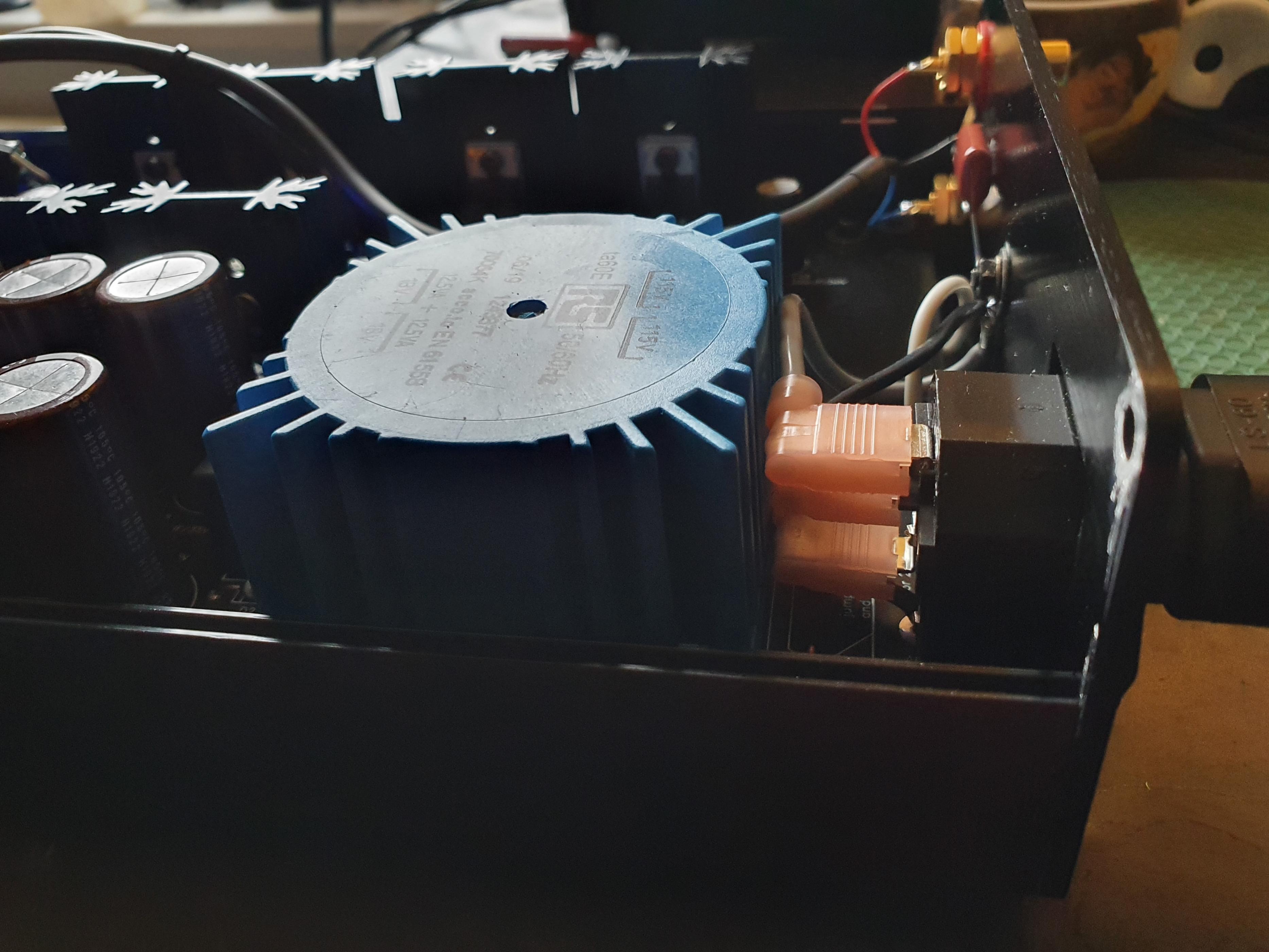

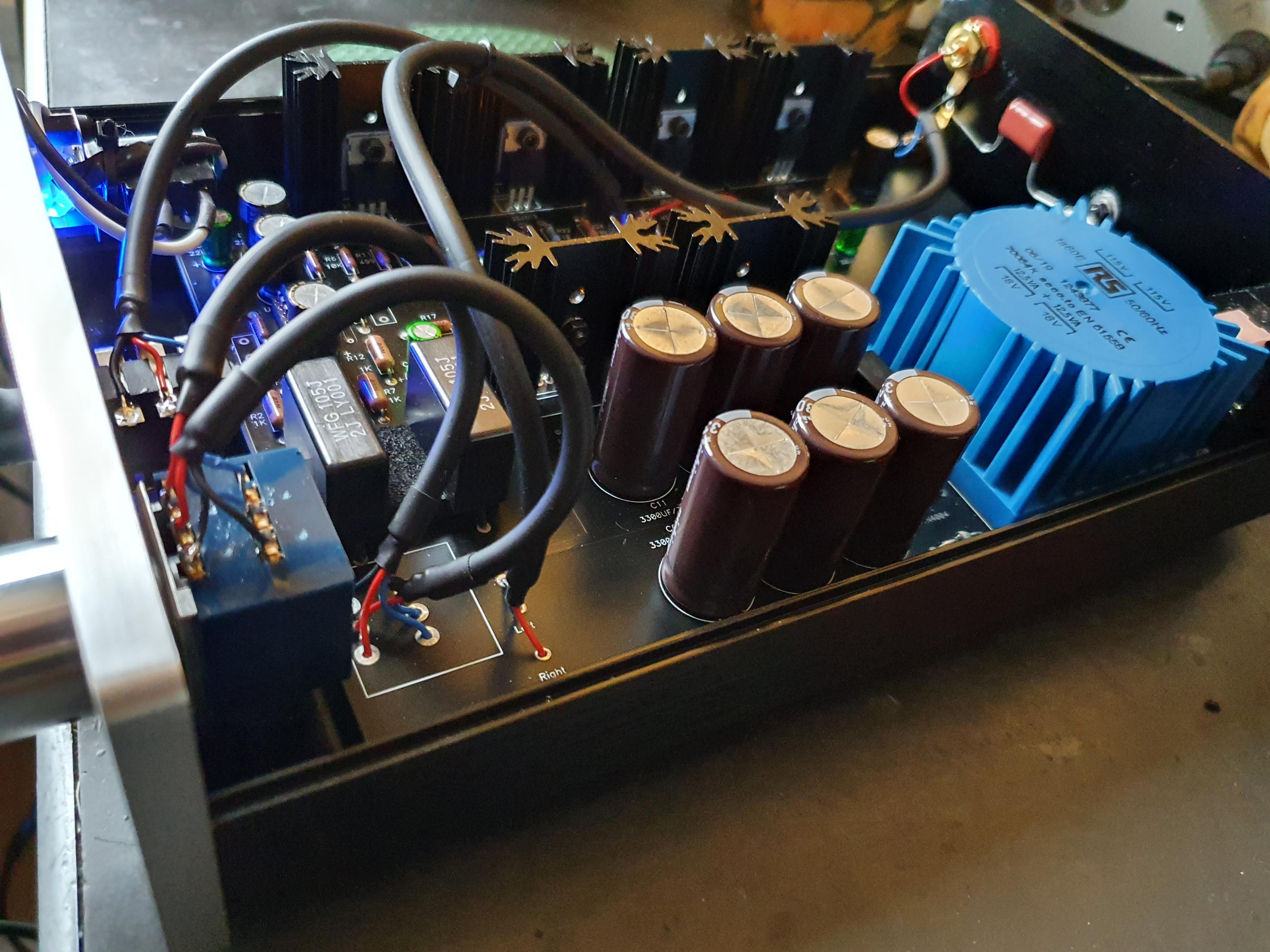

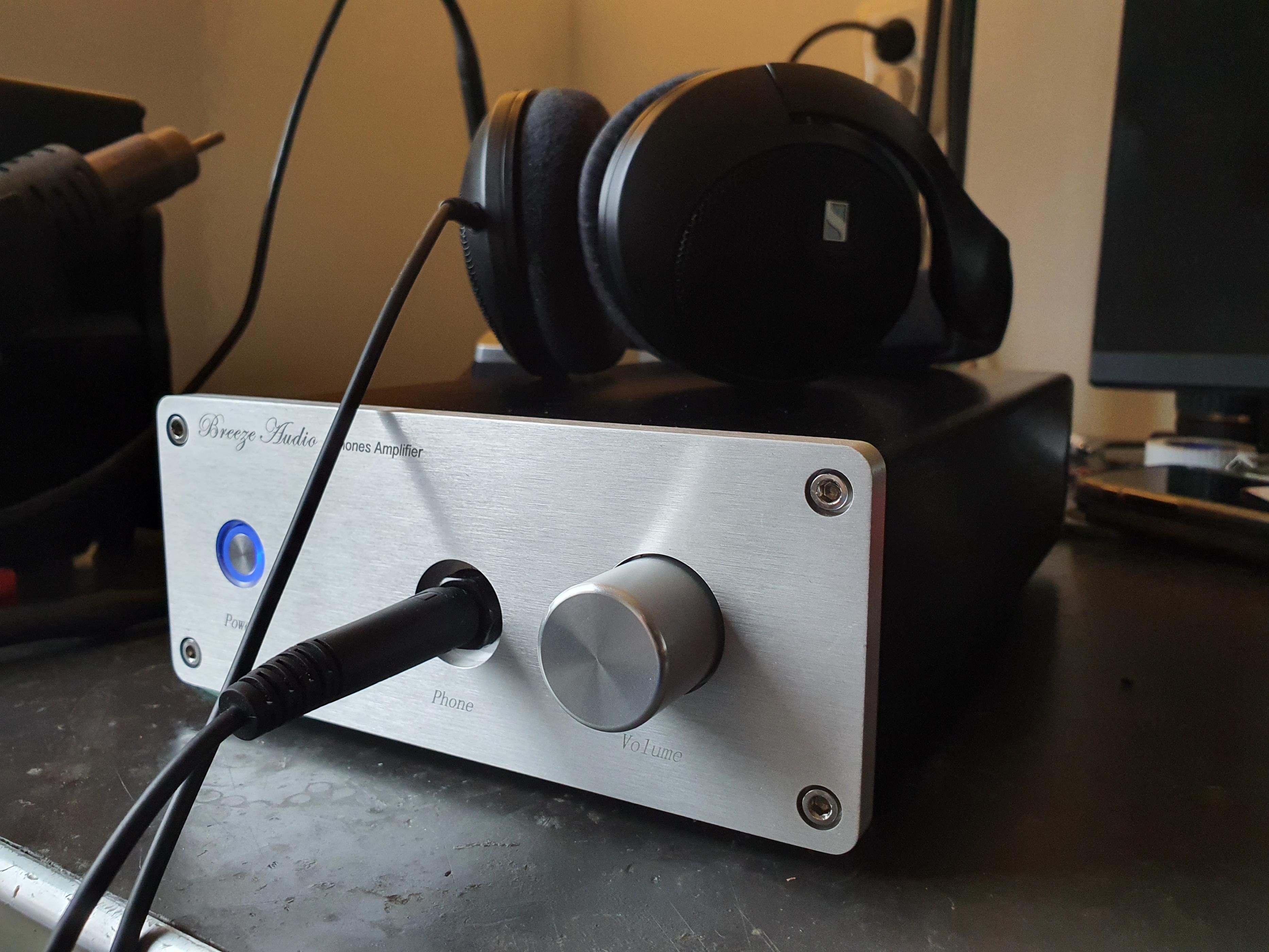

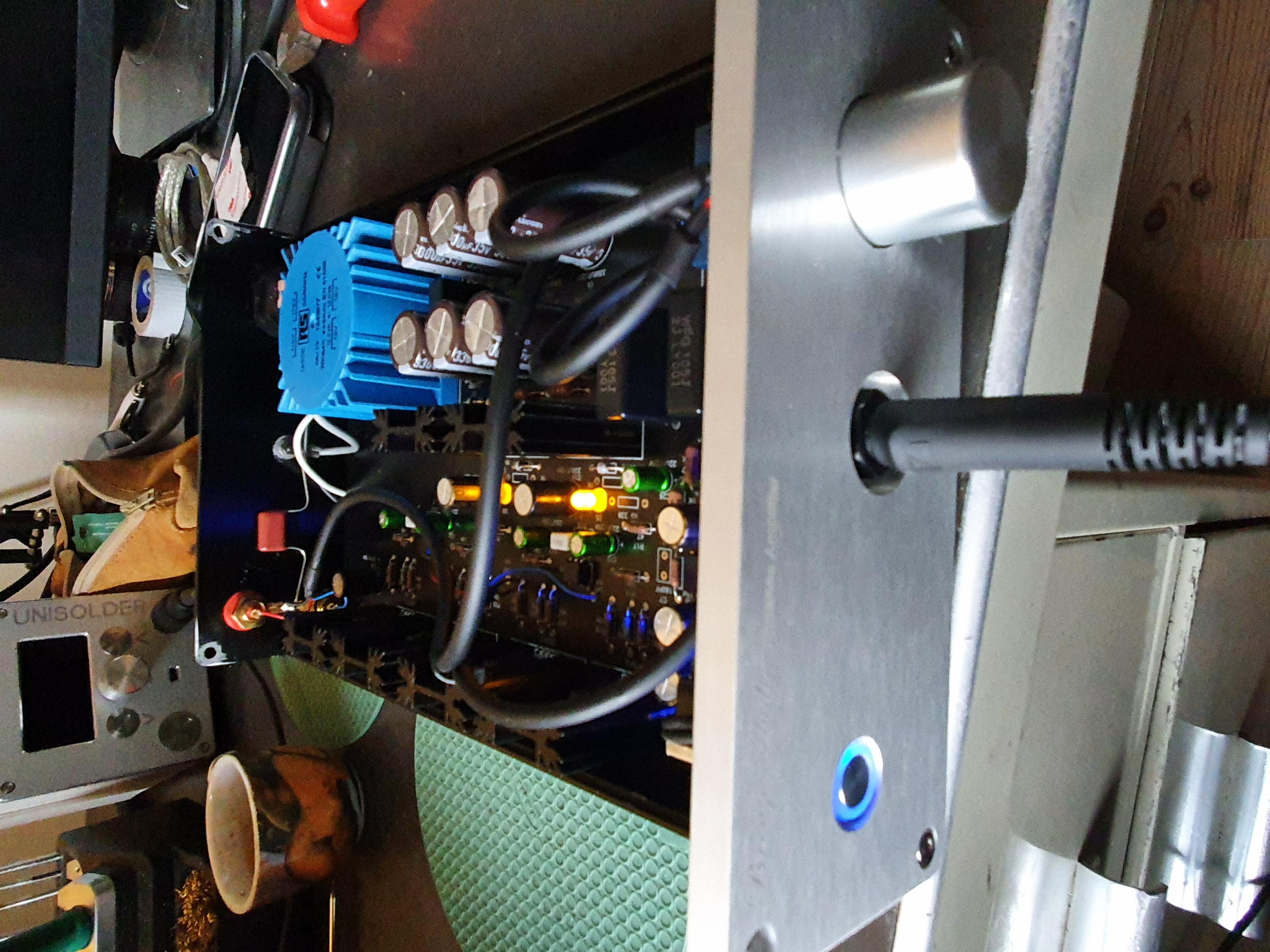

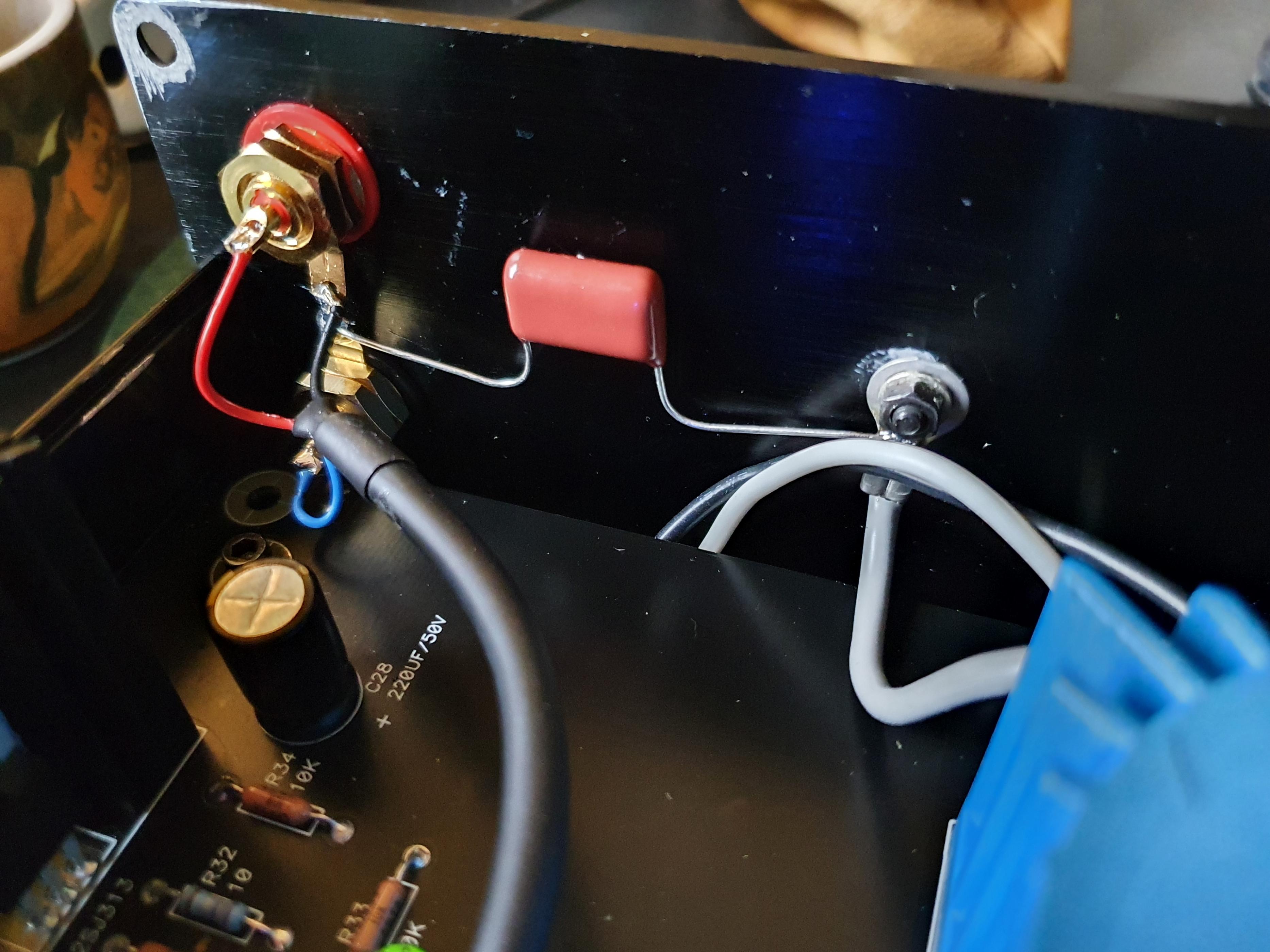

Here are some shots of my Whammy, currently with yellow leds, which gives 17V rails. I used 7,87 ohm resistors to give me 70mA bias current. Case is the somewhat higher version of the well known 1706 case from Aliexpress, the 1707 (70mm high instead of 60mm). Unfortunately, they sent the version with text, while I ordered without (i think the font is tacky, and I do not want Whammy to be Breeze Audio branded). Fortunately, the vendor immediately sent out a replacement front when I informed him.
Since this morning I have tidied up here and there, and now I only have a very very faint hiss that is not affected by input volume. Using OPA2134.
I will be having a great evening tonight listening to some fine tunes :)

Another question: I am tapping directly into the 18v secondary rails for the power led, with added diode, cap, and resistor to tone it down, protect and rectify it. I tried without a cap, but to me the 50hz flicker is noticable. I settled on a 10uf cap as this makes the led turn off pretty quick, but also gets rid of the flickering.
The AC voltage is 21.4V. Am I ok to use a 25Vcap? Or will I have to take into account voltage spikes larger than the measured voltage?

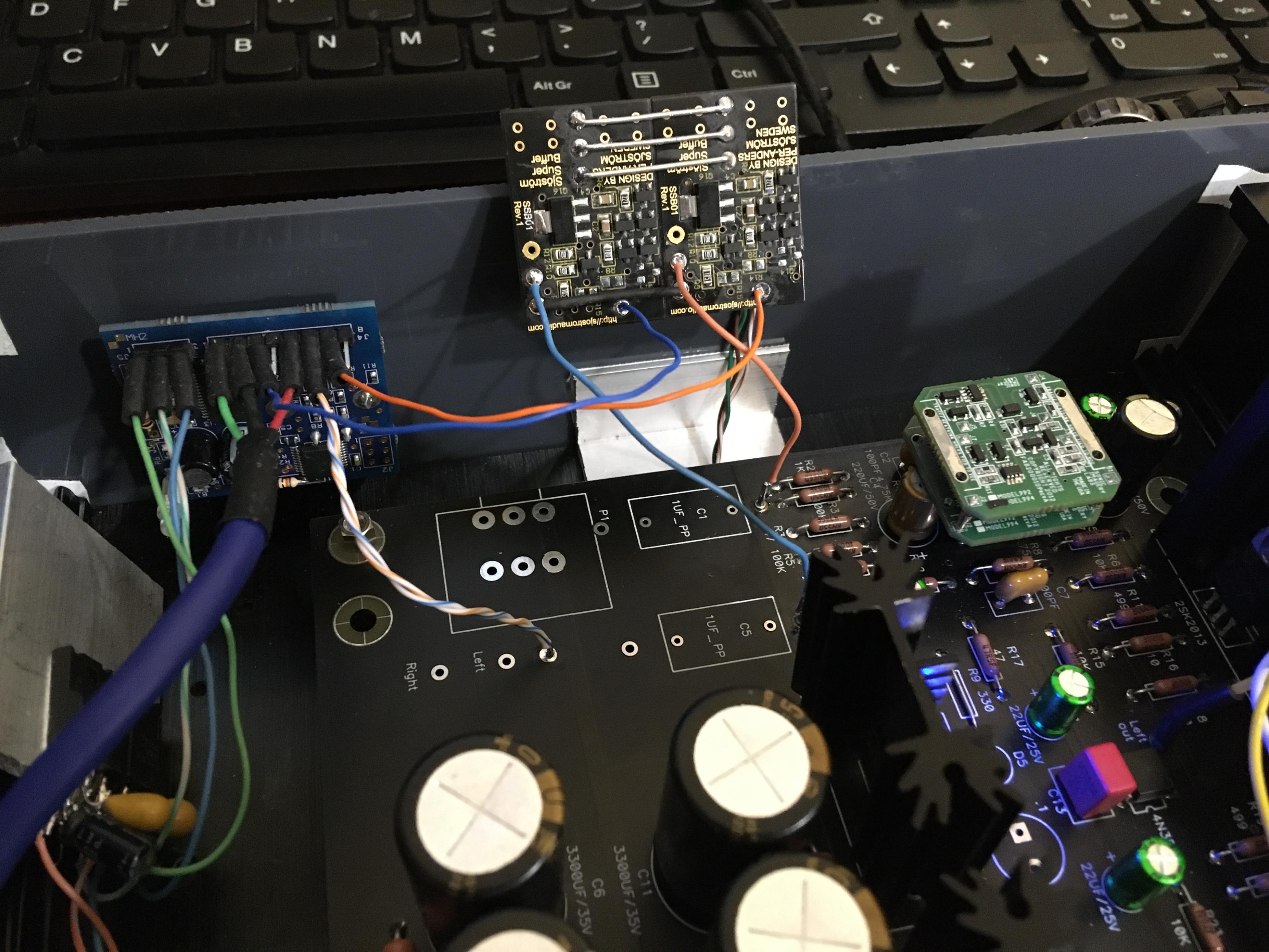

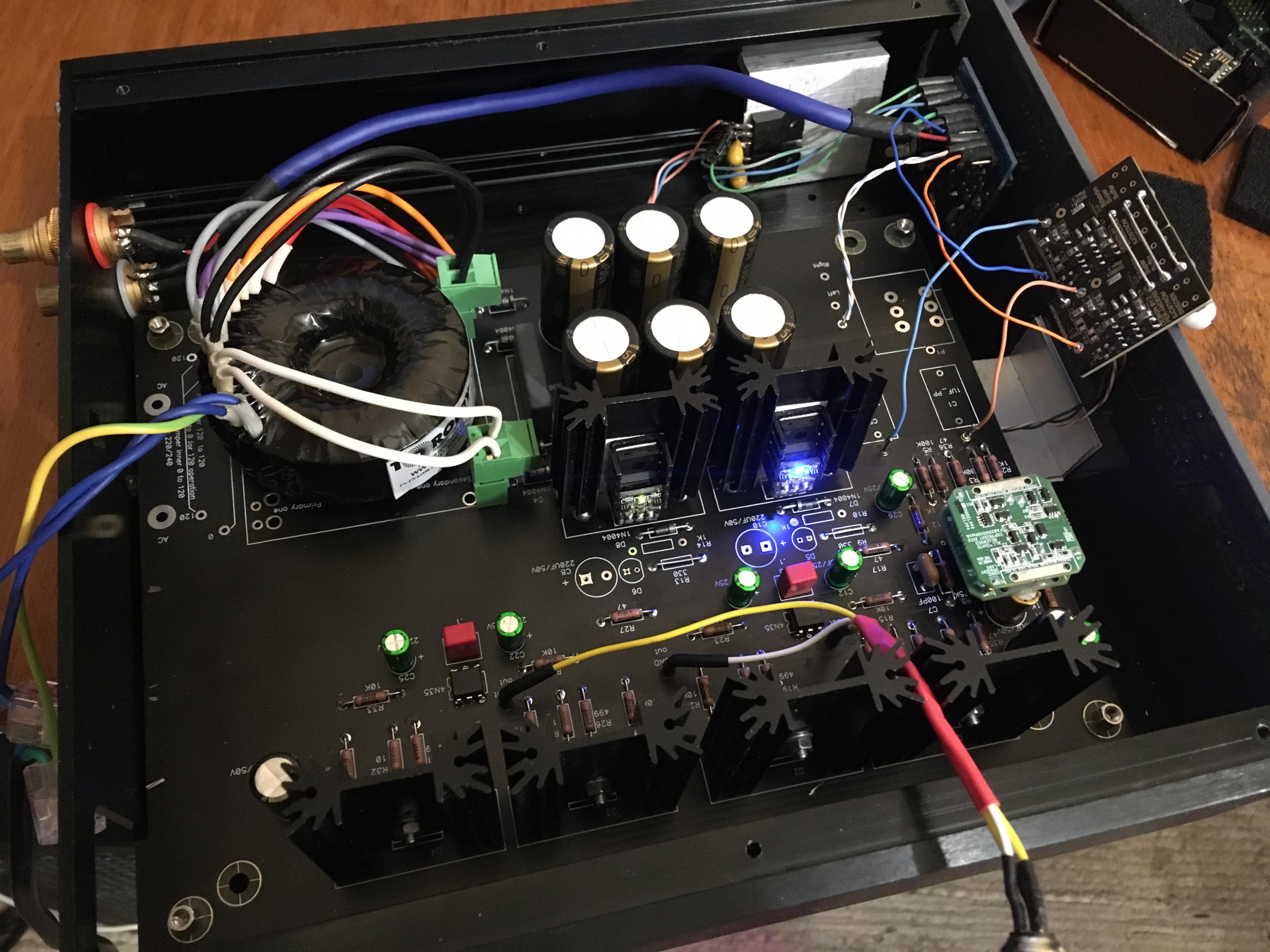

Here is my anniversary Whammy with a few toys. Dexa UWB regs, Muses Volume into Sjöström Super Buffers and the 994 Ticha op-amp.
The sound is remarkably good, the buffers are an experiment to practice using them, they will ultimately turn a power amp into an integrated and work very well. Perfect clear sound.

Ah the blue and green leds' are on the DEXA regulators themselves, blue for positive, green for neg. The board is configured for 'naked regs' without reference LED's.
In the pics the two black PCB's hanging off the front are the super buffers on the output of the Muses control, powered from the 15V DEXA's. The Muses has it's own +/-15V supply off the main 22V rails. The Toroid transformer actually has separate 12V windings for the Muses supply, just waiting for parts for the PCB's.
Unfortunately I do have a problem with finishing my projects nicely as I'm always fiddling but hopefully will put a lid over this one eventually maybe becoming a preamp. There is not much more I can squeeze out of this amp, it sounds bloody remarkable, I rolled a few op-amps again and the 994 Ticha is definitely the one I'm pleased to say, the BJT input has a very pleasing sound combined with the mosfet output stage.
Swifty - very nice job my man, a finished project is a pure win. If you ever get an opportunity try the Muses volume control, an easy upgrade and noticeable improvement in clarity but slight less boom in the low's possibly. I'm definitely converted.
