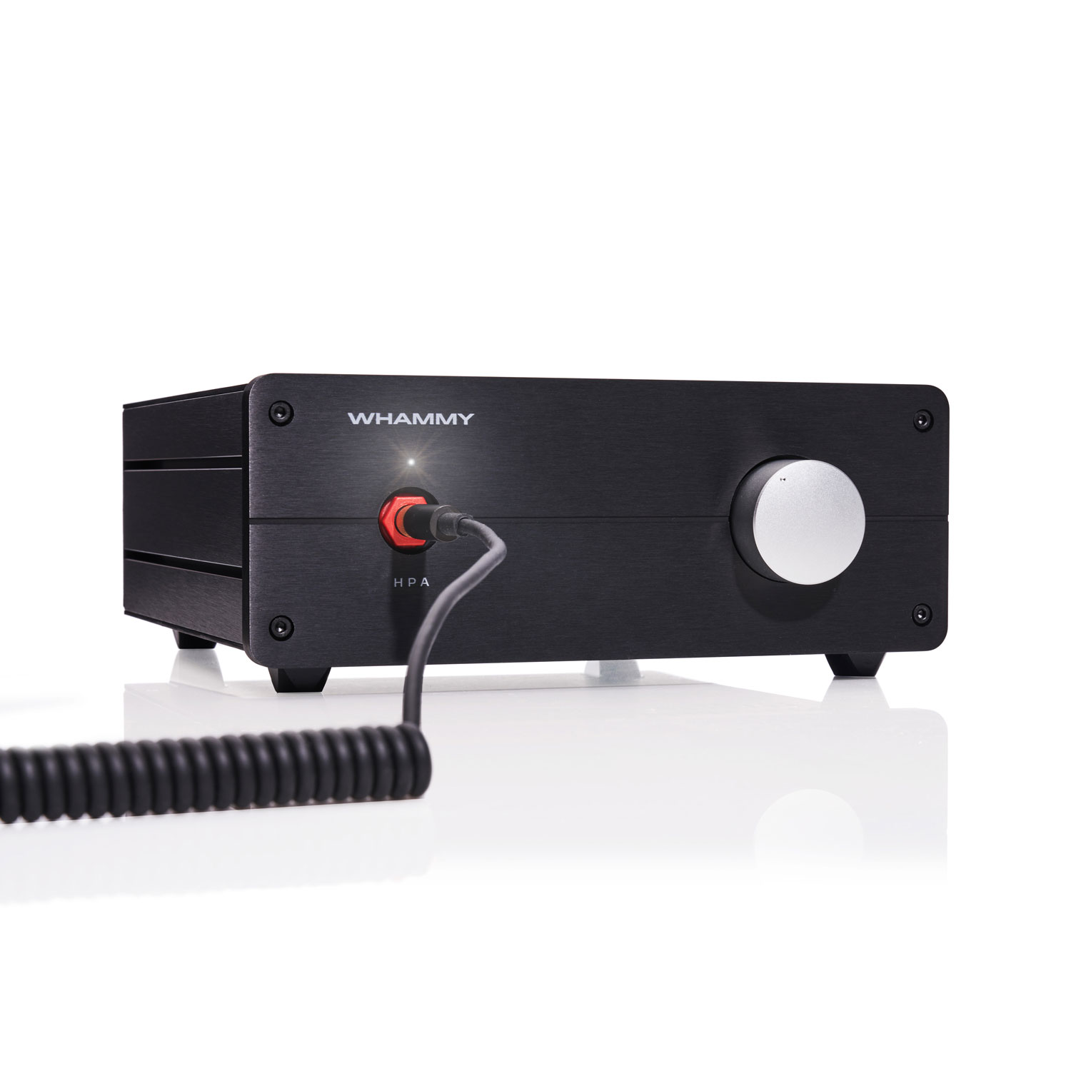

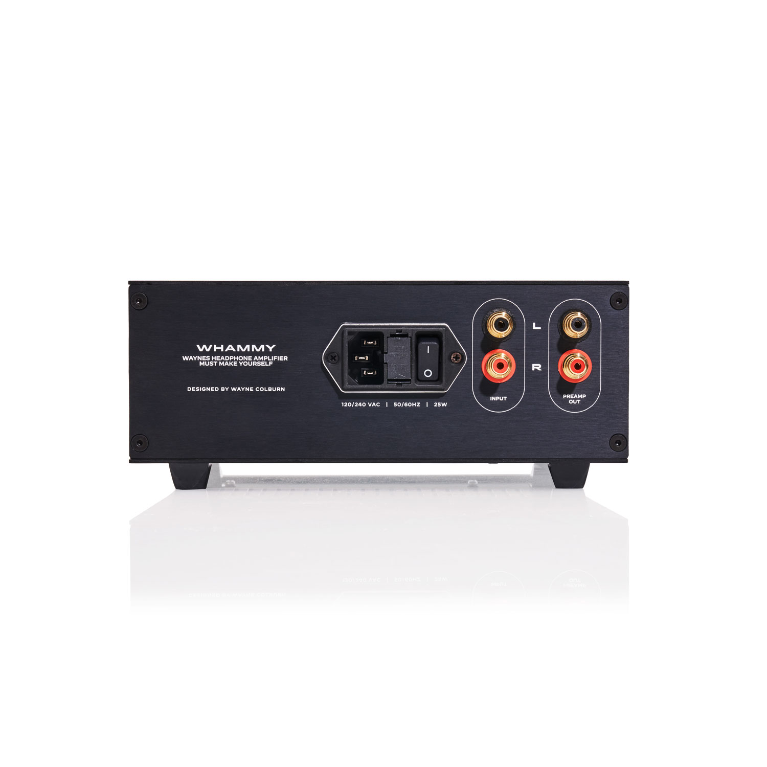

Absolutely beautiful!
Preorders will be arranged soon and all information will be divulged at that point. Until then, enjoy the teaser photos. :yes:
This chassis will be compatible with Whammys already built as well as new construction.

Hello. I am planning to use one of my whammy builds as a pre-amp. With that, I am also planning to use an i-select to select inputs. Where would be the best place to tap into the whammy power supply to get the V+ 17v to power the i-select?
Thanks in advance.
The i-select can take AC or 15-30V DC- just tap onto the whammy +/-15V reg outputs or the from the CRCRC filtered rails.
