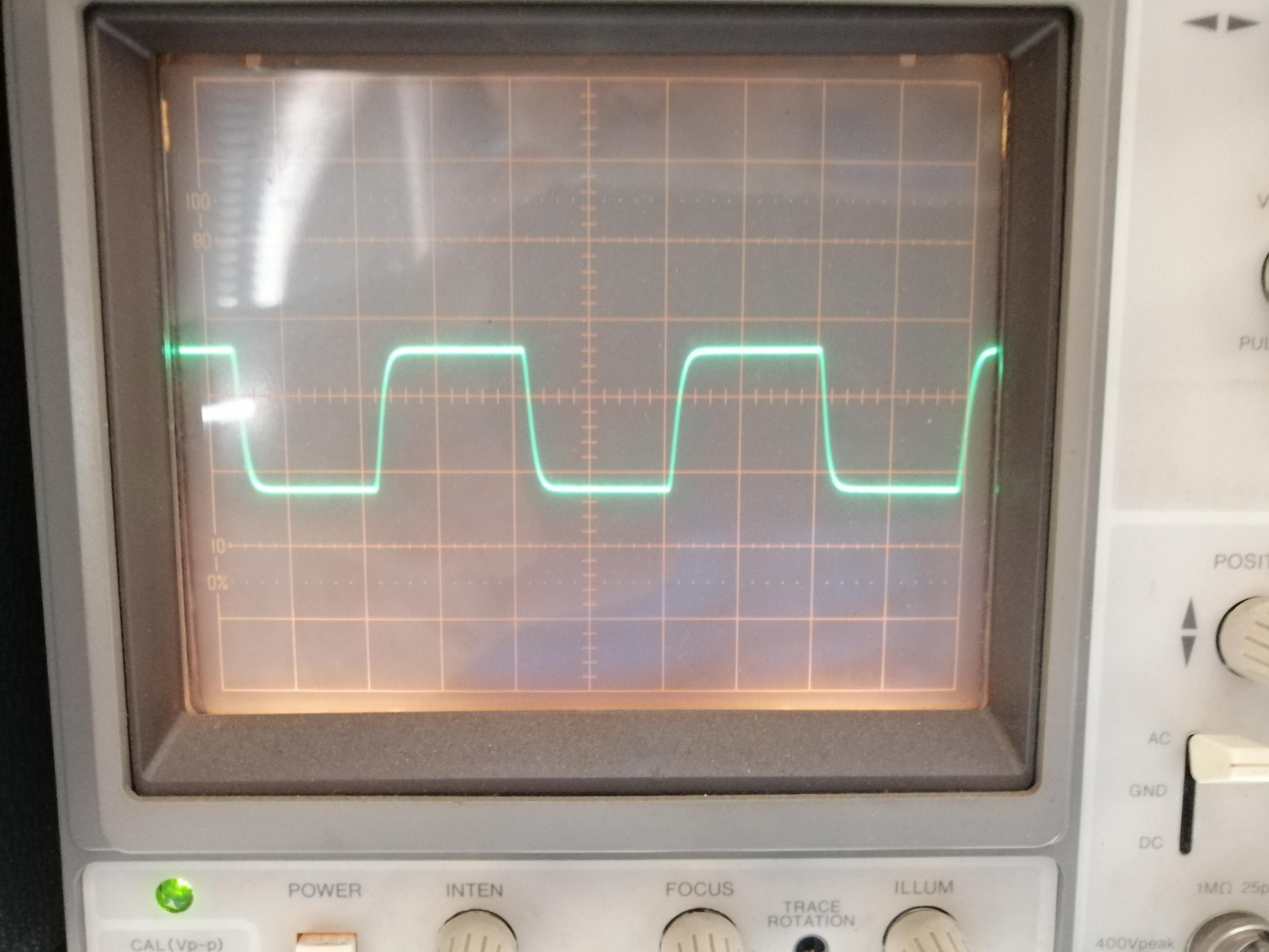

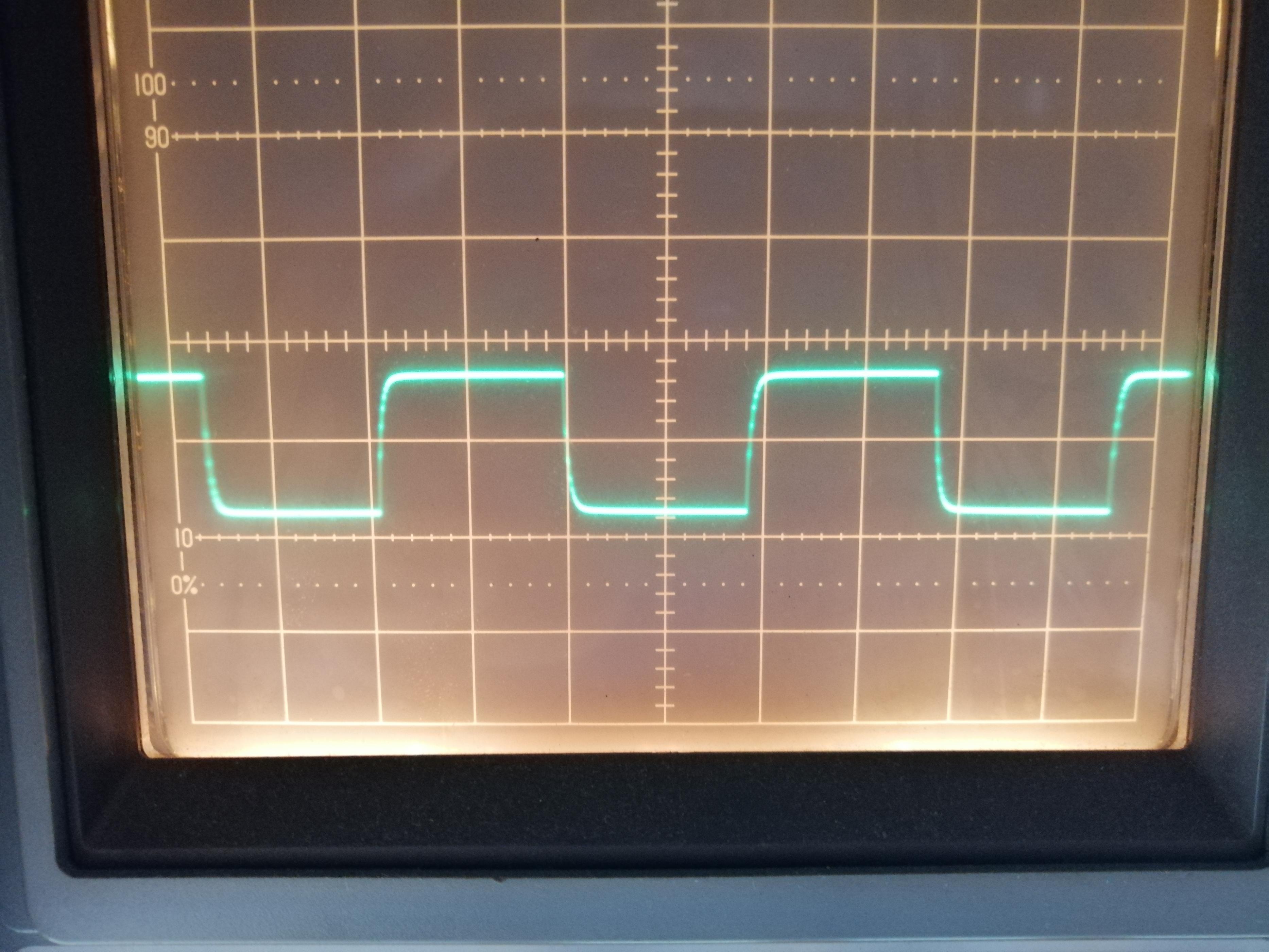

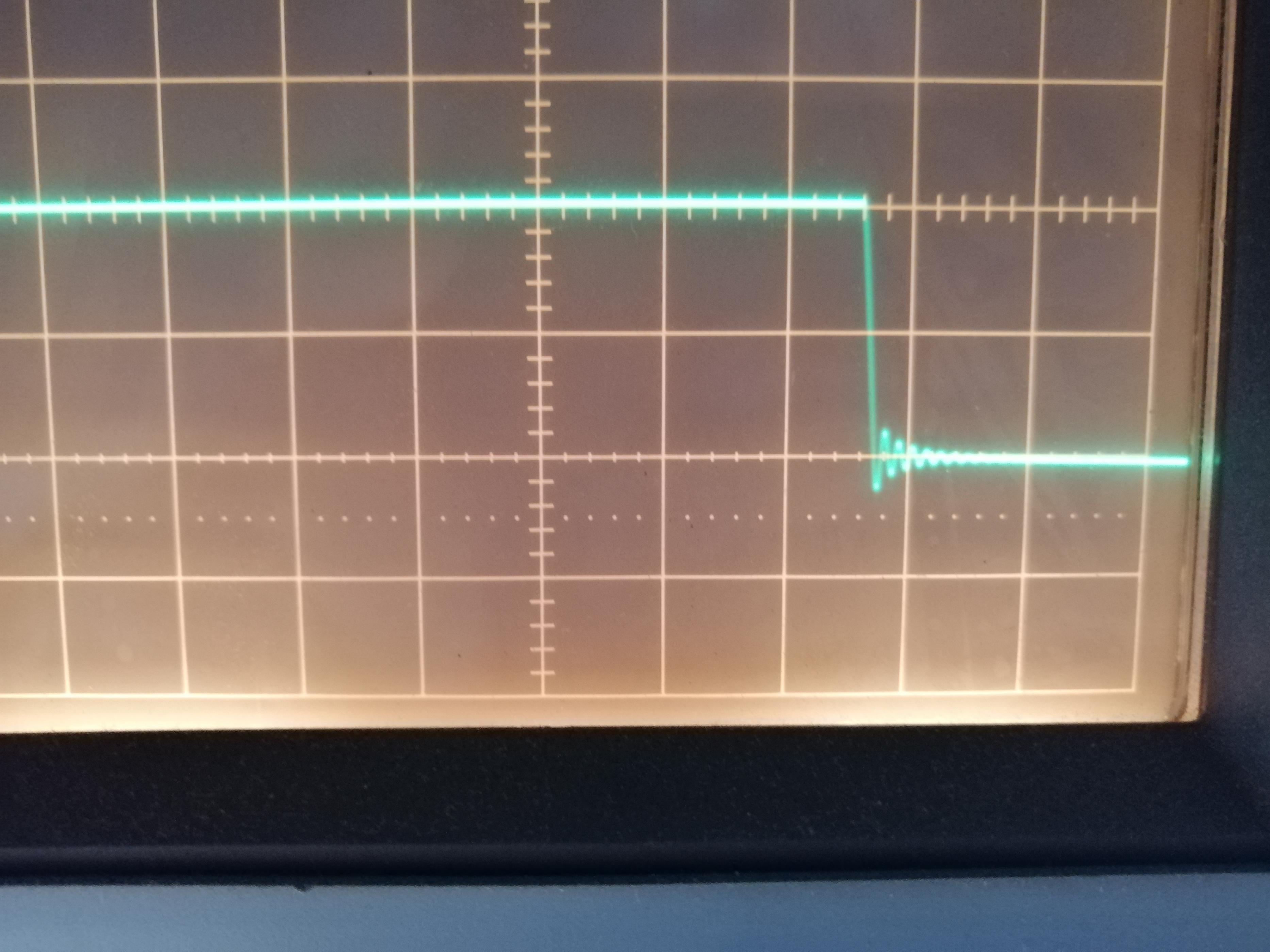

I had a chance to do some more testing today with different op amps.
1.MC1458 - 0.2mV DC offset and it sounds good.
2.KIA 4559 - 4.5mV DC offset and it has a very sharp sound, not good.
3.TL072ce - 2.5mV DC offset and it sounds good.
4.NE5532 - 22mV DC offset and it sounds good.
5. LM833 - 14mV DC offset and it sounds the best of all.
But with the LM833 I had some ringing, I added the 100pf caps and it kills the ringing but something looks a little funny on the rise and fall parts of the wave. This was at 20kHz. Maybe I must make the cap a little smaller..
Advice will be appreciated.
And now my scope seems to start with bad connections on the adjustment knobs, Have to fix that very soon.

I also saw some oscillation on lm833n without the feedback cap, and it was the only op amp doing that across the 8+ tested.
