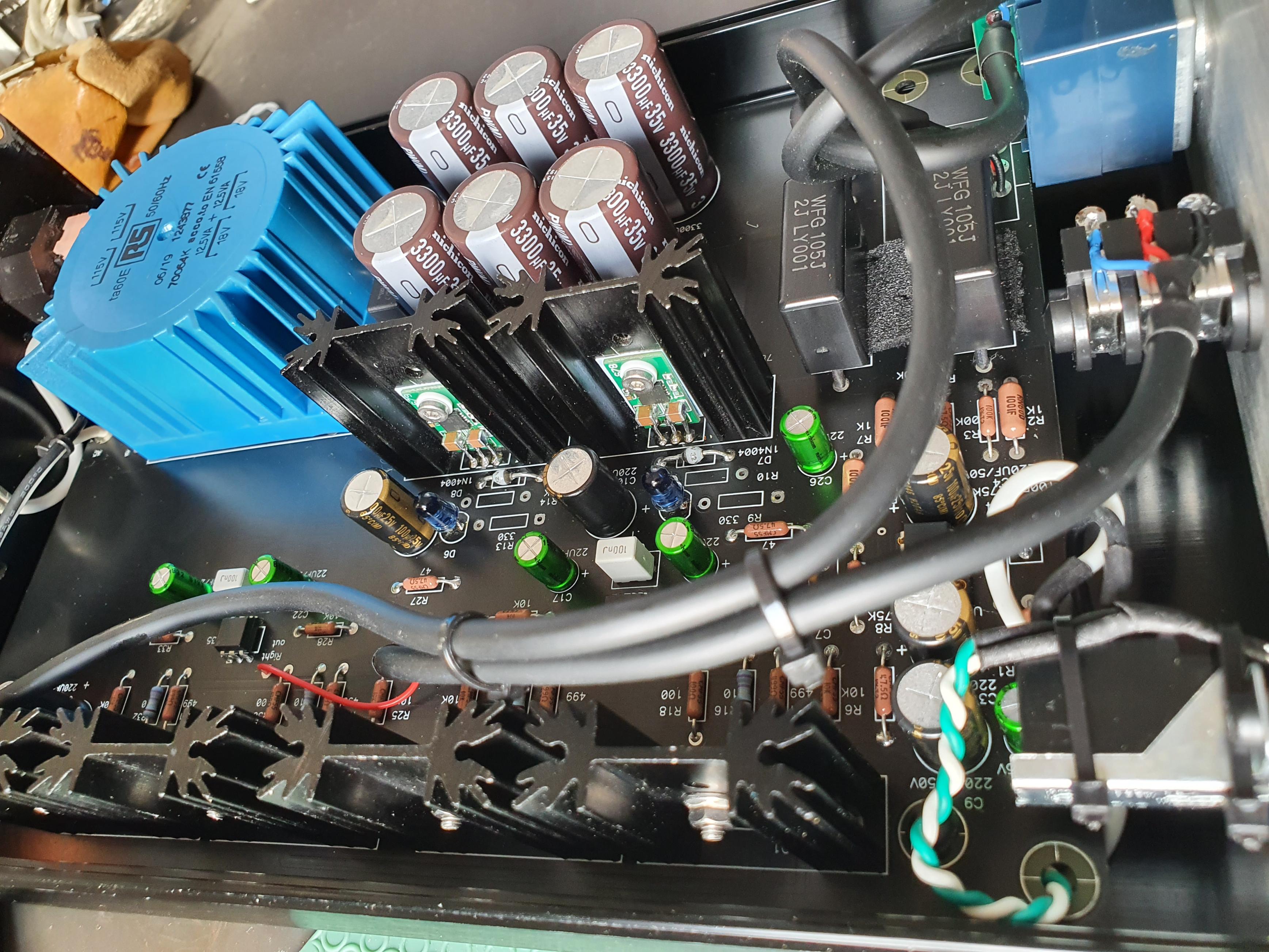

Hi Wayne, yes, it seems that having C2 an C7 in there is giving me a subtle but noticable improvement. It's surprising to me as the general advice is to leave them out. I wish I had a scope to see what I'm hearing.
(please ignore my totally professional and very accurate panel drilling)
My two wammies, one uses the vishay dale resistors (black chassis), and the other is running military surplus resistors, mostly pre-vishay dale. Both sound excellent and I thank whayne, 6L6, and diyaudio for supporting hobbyists in such a big way.
But here's my questions/issues:
The black chassis originally had LED regulator setup, but I was having issues so I went naked. Now, as my name suggests, I'm not the brightest bulb in the tool shed, and I messed up on the naked regulator by adding a 1kohm resistor and shorting the 330ohm... What this do?
Probably wise to just remove them but I went through a few tribulations on the build (hence all the flux still on the board) so I'm a bit reluctant to change things. Here's the biggest thing though: this particular whammy is super silent when unplugging and plugging in headphones. The vintage resistor/LED regulator build isn't noisy by any means but it definitely has a noticeable pop and scratch to it, where the naked-ish regulators contend with my balanced XLR stuff.
Another weird thing is that I currently have a opa2134 singing away nicely in the naked-ish regulator build, but with he LED regulators the left channel drops in and out and end sup being a fuzzy mess. Not sure if that's because of the regulators or other part choices, these aren't too different in terms of BOMs though.
Thanks everyone for the insights and sorry for the long post.
Hope you all have a good one

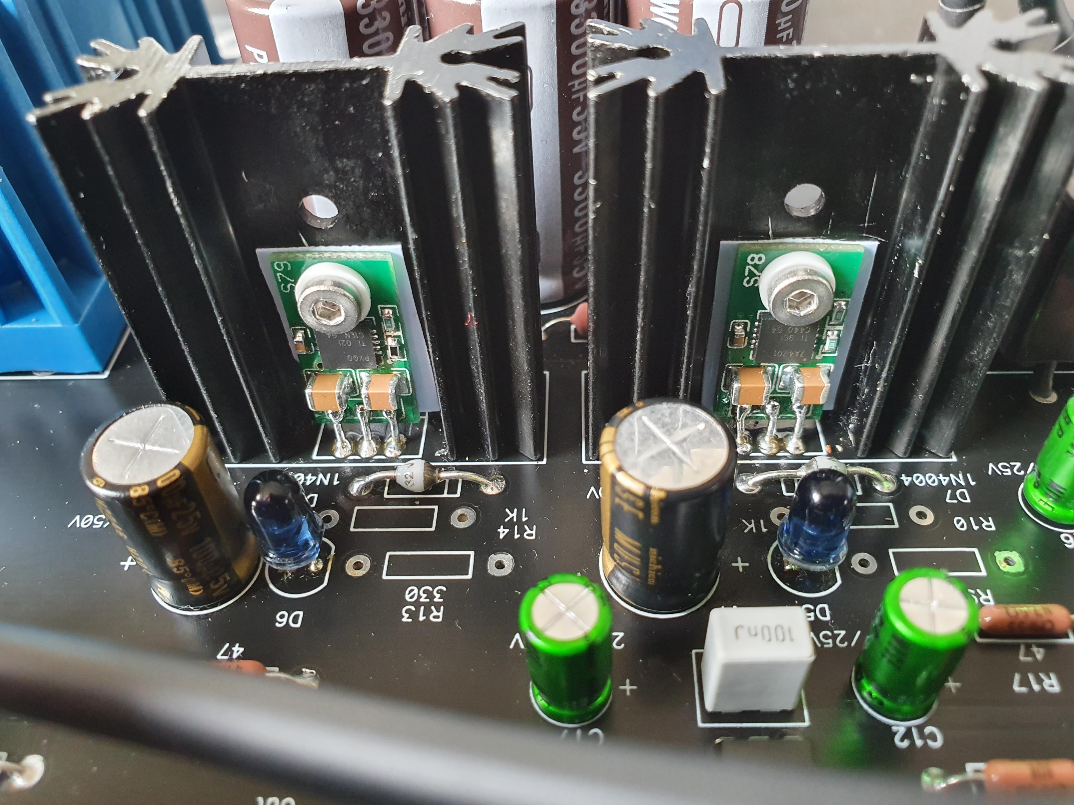

I installed the sigma 78 and 79 regulators today, resistor-tuned to 16 volts. This gives 17.3 volts paired with the IR LEDs I installed a week ago.
These tiny chips do run a lot hotter than the 7815 and 7915 to220 packages they replace, but we'll see how they hold up 🙂
Hi Gang,
Dose anyone have a BOM for the Whammy project from Mouser or a list of components, quantities, & manufactures. I have the PCB but DIYaudio was out of the components when I went to order.
Thanks for your help.
Here: Whammy-BOM - Google Docs
Nice: voltages measure -/- 17.25V and +/+ 17.26V respectively. Perfectly matched.
These are Aliexpress copies of the original design. They come with tantalum caps, but I changed them to X7R ceramics as per the original design. I used the formula on the AMB site to calculate the values of R1 and R2 to achieve a target voltage of 16V. All in all it turned out well.
The reduction in noise is probably measurable, but to be honest I cannot hear any difference in audio performance.
Other than that, I do like the fact that both rails are now exactly matched, at a nice voltage for 18v max speed opamps.
