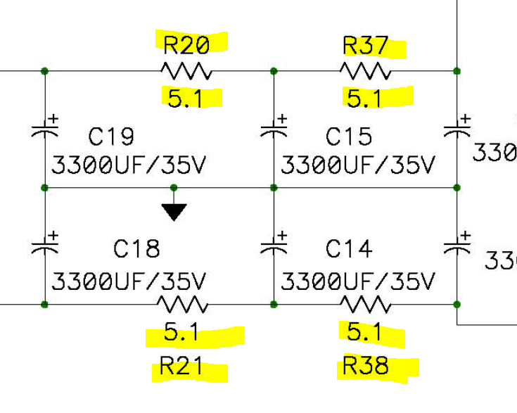

My Whammy has the 22V transformer with the LED reference and the opamp is seeing about 16V under load.
If I wanted to bring that down to 15V (or just under), is the recommendation to short R9 and R13? Or is there a preference to work out the math for the voltage divider via R9,R10 & R13,R14 (if that's even possible to hit with my transformer)?
If I did the "naked reg" config, I need to remove D5 & D6, but retain C8 & C10, correct?

Naked reg you leave the diodes in and just wire link for R9/R13 to connect gnd pin to gnd. Nothing else, do this if you want to use LDOVR or Sparkos regs etc.
Yeah, that would be preferable, if I could keep the led + caps for the most optimal build given my 22V transformer.
That would be R20,21,37,38, right? I wonder if 10R would work -- I'd need to see what I have on hand to even try out.

Dropping more voltage in the raw supply is not the answer - the regulators are going to attempt to regulate to their set voltage of 15V+Vfwd of the LED. Even if you drop 2-3 volts there, it’s still more than 16.5, and the regs will regulate.
“Naked regulators” is the answer. Remove parts and add jumper until it looks like this -
Thanks, 6L6. I'll give the naked regs a shot, and if the [inaudible] noise bothers me, I'll look into discrete regs to compensate. $$$
Working backwards from the LED build, it seems I'd only have to remove the LEDs, and add the jumpers, right? Or do I need to remove the capacitors as well (looking at your picture)?
