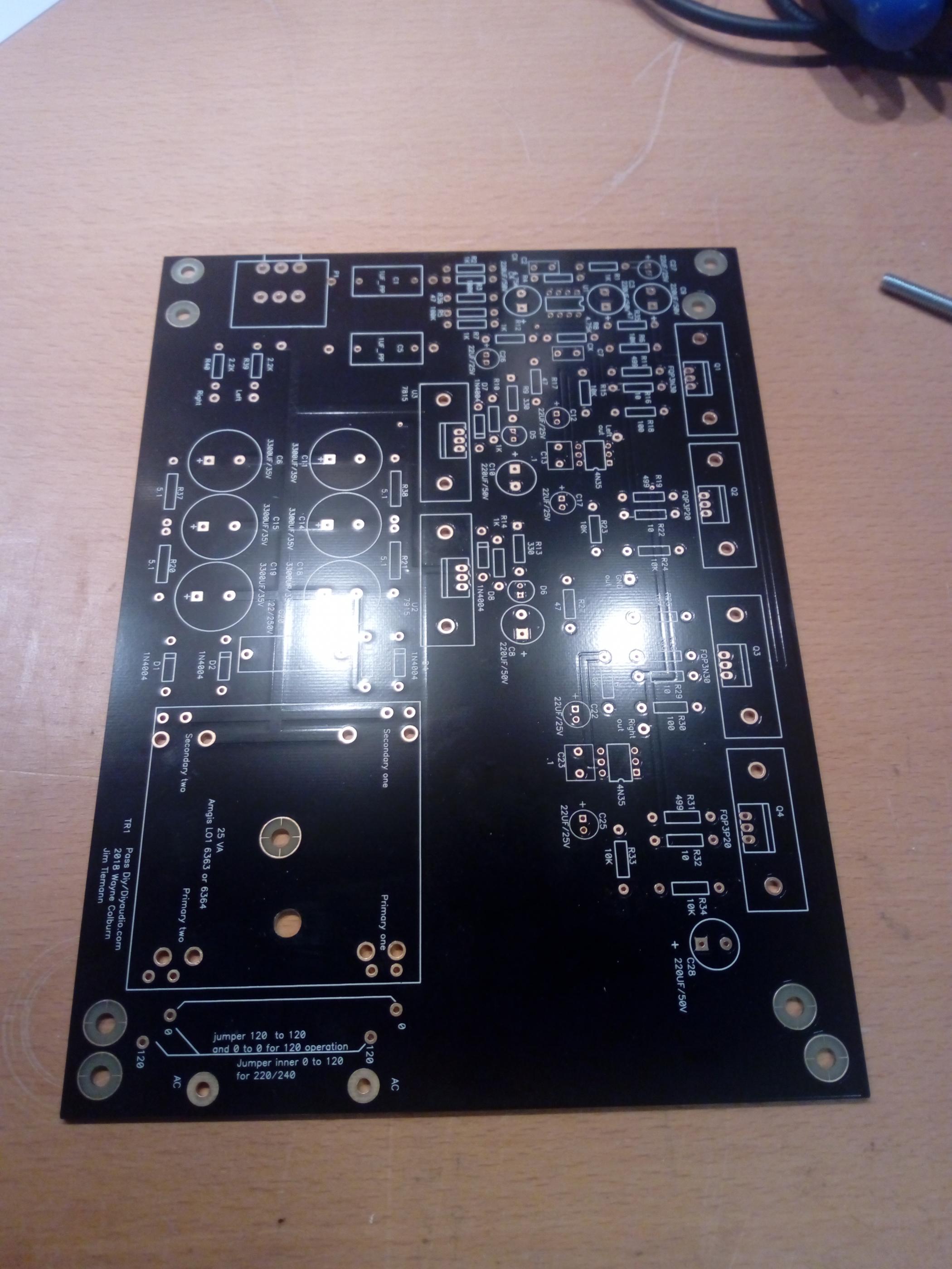

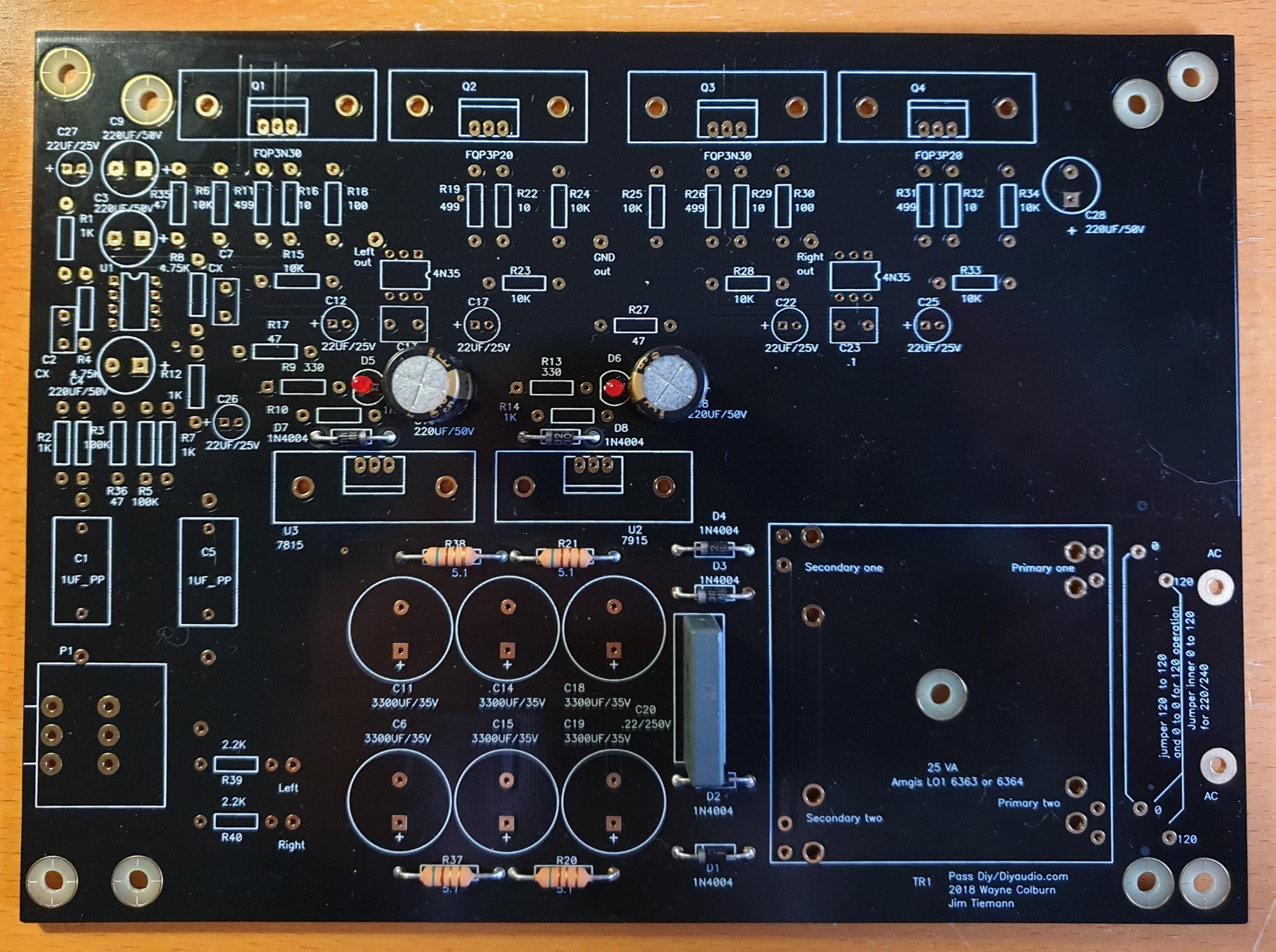

Wammy Transformer choices from Digikey are not available. is there a choice out there with out having to change the bias resistors ?
If you drill a 4mm hole in the PCB you can use any potted transformer you like.
30VA 2x15Vac or 2x18Vac,

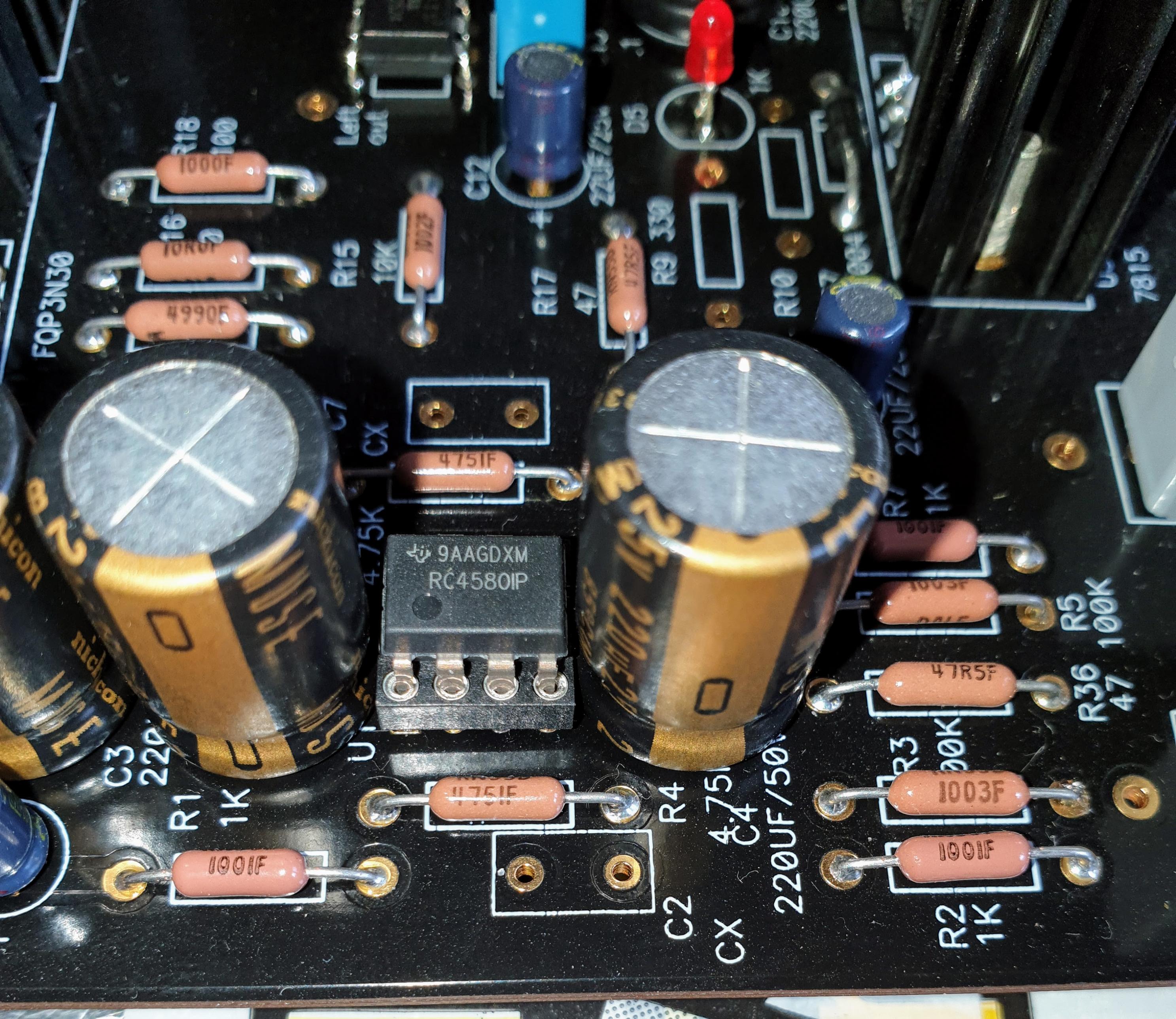

I stuffed the compleet pcb and it looks all-right by me.
I did buy several OpAmps; RC4580IP, AD823ANZ
For now I will start with the RC4580IP.
For now I stop, tomorrow I'll do some controles.
And hopefully some music.

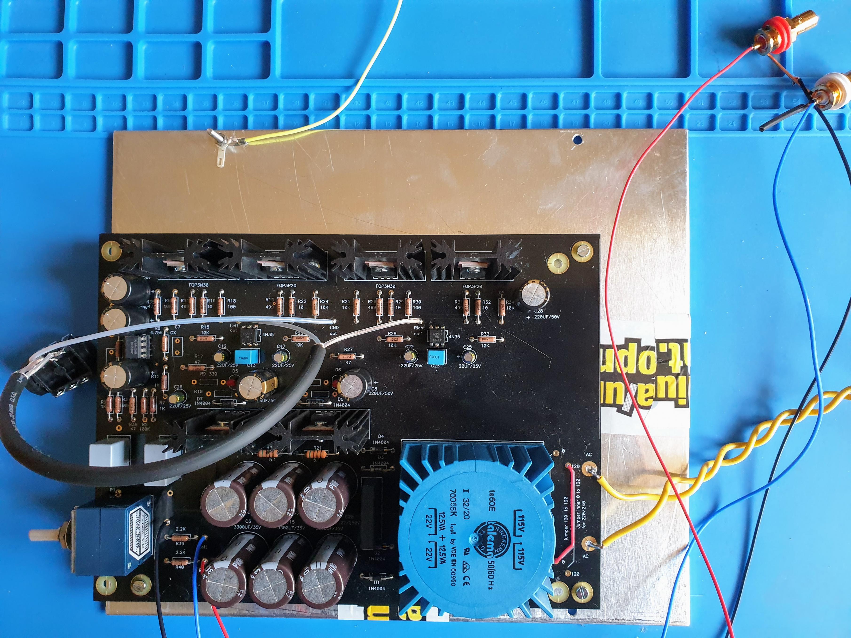

so I did my first listening session. And it was a pleasant surprise.
All the connections were professorial, no hum what so ever.
Just music.
I was surprised because it is not in an housing, just on an aluminium plate.
The music is from low to high nicely balanced.
Next on the list is the building of the housing.

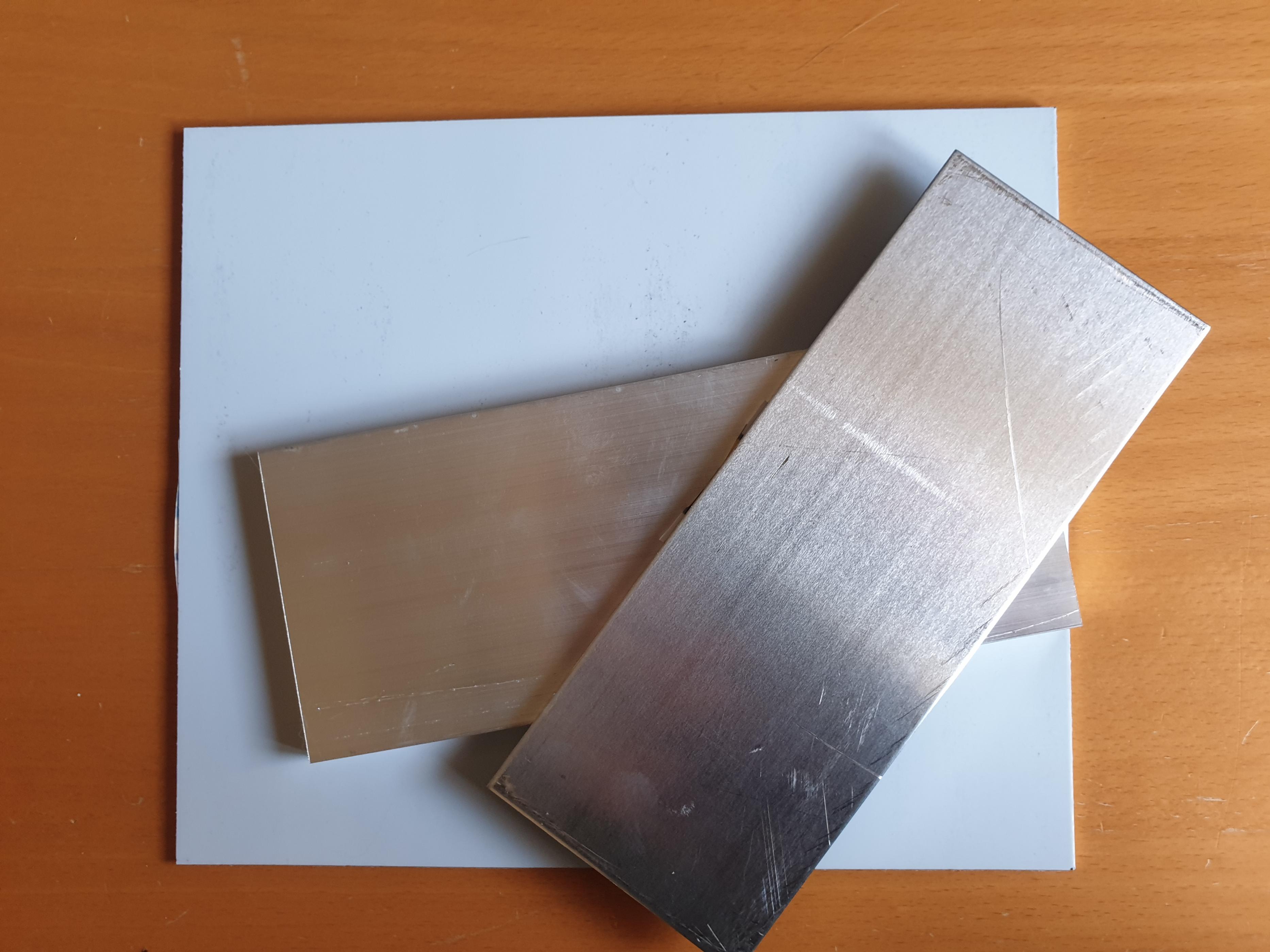

I am making the housing from scratch. Aluminium with wooden sides. it's probably going to be walnut. And of course I will keep you informed. Starting with these pictures.
