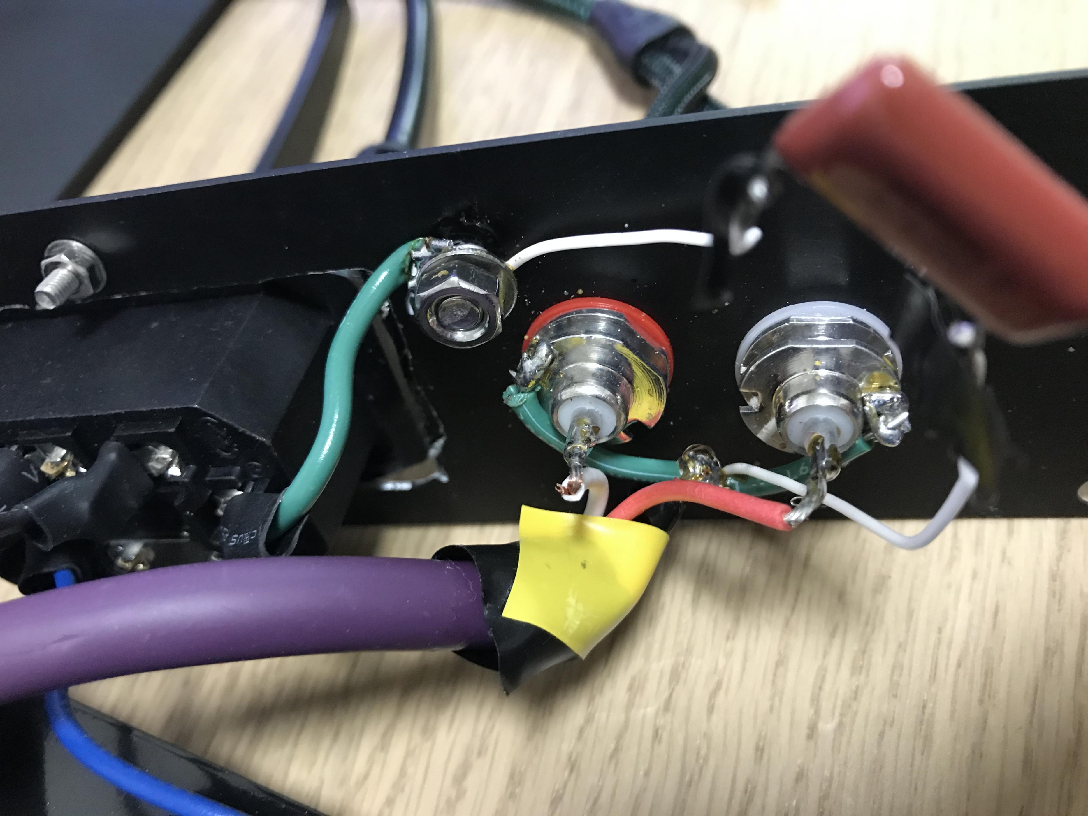

It looks like was a grounding issue of some sort, it keeps make this crackling noise when i poke the white wire attaching the capacitors. Im not sure if I have done this part right, I just made a circle with a piece of wire and solder the earth from IEC and one side of the cap, and sandwich the thing to nut and bolt onto the chassis... I re done that part, the imbalance still kinda there but lessen, just a hum noise which wasnt there before with volume past 1pm now.... am I doing this part correctly?

Your white wire / insulation is under the washer for your chassis/safety GND. Remove the nut and bolt. Scrape some of the anodization / paint / whatever from under the nut. Remove a bit more insulation from your white wire. Secure the safety GND and your white wire under the nut very well against the bare metal of the chassis. Check for very low resistance between all points intended to be at chassis gnd.
It looks like you've used Cardas (or similar) RCA jacks. From my own experience, those things are a royal B-yatch to solder properly and get a good joint. No disrespect to your technique, and it may be absolutely fine, but I'd give your AGND points a check with the meter and perhaps get your biggest iron tip just-a-scorching and retouch those. Honestly, those Cardas parts are really nice, but given how many bad joints I've made with them... I wonder if they're worth the hassle. I finally committed heresy and just used a tab for the GND vs. attempting to solder to the "notch".
Hope either or both of those may help. Enjoy! 🙂
Edited to add - make your pot shaft is grounded also (if appropriate) - that is a common issue.

Thanks, I attached a wire between the ground to the nut securing the HP jack , and the hum/mains noise completely gone. is this what u mean by pot shaft grounded?
still has imbalance every now and then i think i will replace the cardas jacks to normal ones with a ground lug so see if that problem goes away . thanks a lot
It looks correctly wired BUT I can see some frayed wires - esp on the positive of one of the inputs. I'd redo all of that and then test.

I've found that with those types of jacks that applying a dab of rosin to the inside of the "cup" on the positive and then dipping the stripped end of the wire that is to be connected into the same rosin creates a solid solder joint every time. I then slip shrink-wrap tubing over that which is more to help with the strain relief of the wire than for any insulating purposes.
