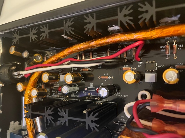

Hey guys, I recently swapped the caps (in the audio path) of my WHAMMY and now I have noise in the right channel. It's intermittent and I can only hear it on my more sensitive cans (Focal Elegia) but when it's there it's pretty loud. I reflowed all the connections but it made no difference. Also, I don't know if this was there previously as I was using a different op-amp that doesn't exhibit this noise (OPA2107). I'm now using the AD823 which I prefer. Any help in tracking down the issue would be appreciated. The noise is a "shhhhhhhhh".

Swap back to the previous caps and see if the noise goes away.
Minimize the variables. Go back to the original caps and try the different OpAmps. Check the data sheet too and ensure that the pinouts are compatible, as well as the parameters for caps/resistance around the opamp. For example, some of the higher-end OpAmps become unstable if you use low-ESR caps around them because they expect a certain amount of resistance, etc.... Some need certain value bypasses around them, etc...
Remember that OpAmps can be pretty complicated circuits that all have certain design assumptions and requirements that are listed in the data sheets/application notes, and as such are not %100 swap-compatible.

My immediate suggestion would be to give your solder job an extra touch with an iron.
Yeah I did that already with no change 🙁 .
Thanks everyone for the suggestions. Will take a look at the ESR of the caps (Audio Note) and perhaps swap the originals back in to see what happens.
Your caps, they're not by any chance som huge audiofile caps that is not even close to fit the fottprint on the PCB?
EIDT: i see now that it is Audionote. so answer: yes. The legs of those caps is som realy good antennas. Try the old caps.
Interesting! Will go back and shorten them and see what happens.

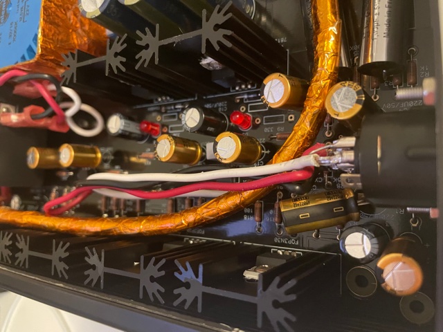

BTW, I noticed after shut-off, D5 stays lit for several minutes while D6 goes off almost immediately. Does this imply an issue with one of the regulators?
Attached is a pic of the caps (they're the 8 gold colored ones). Next to the opamp and XLR plug they're bent so as to be out of the way.
