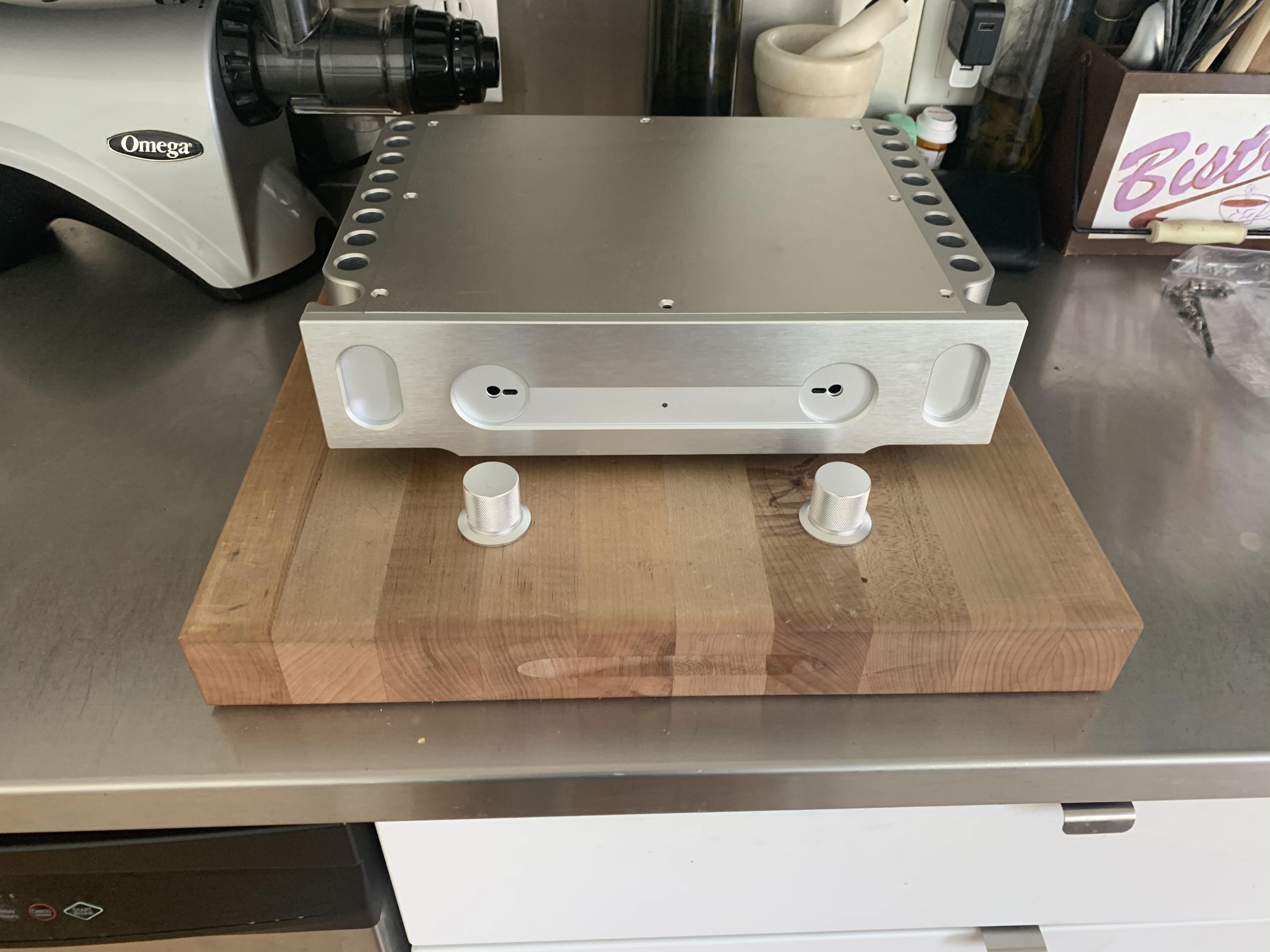

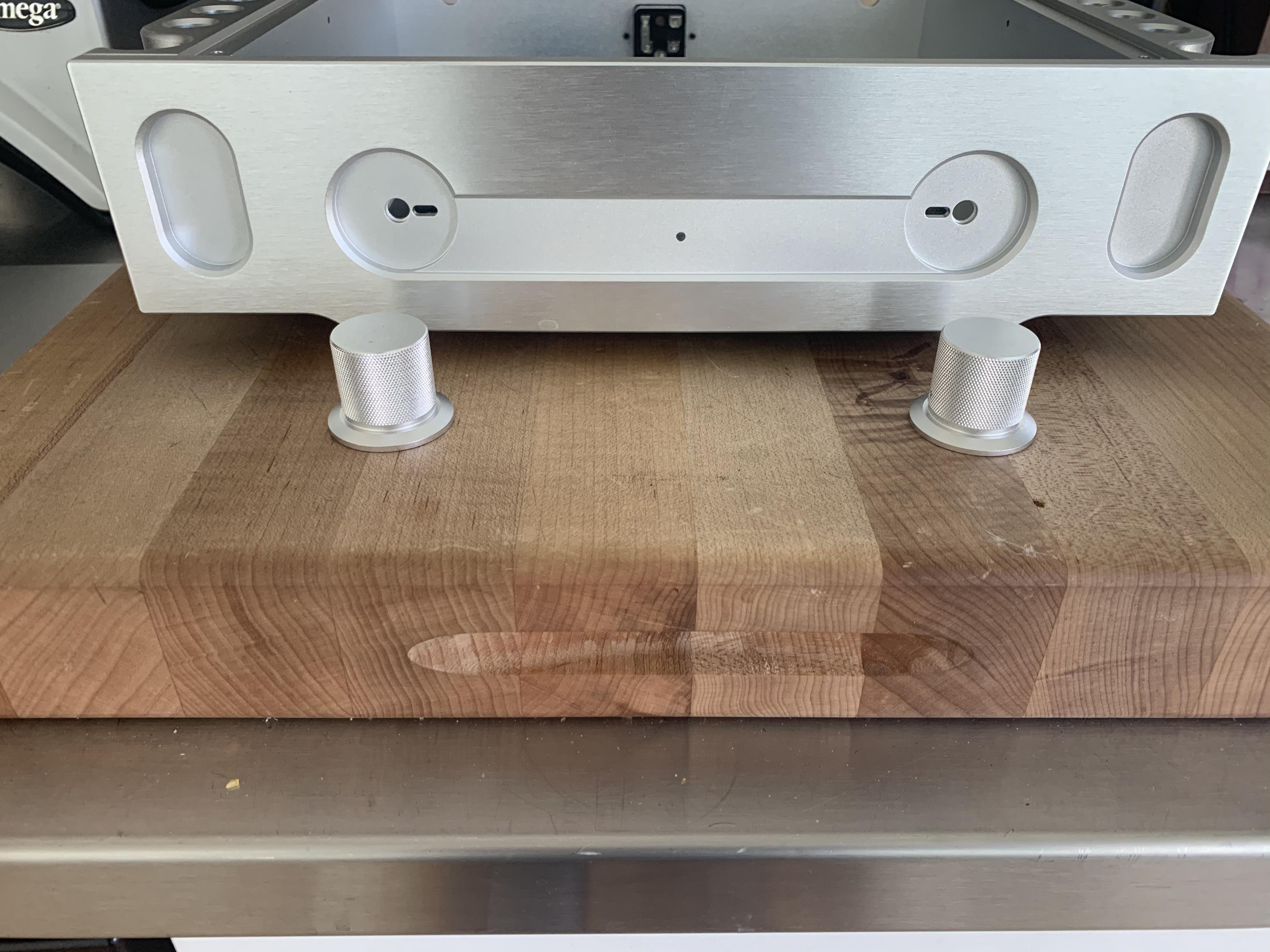

The Start of my Whammy!

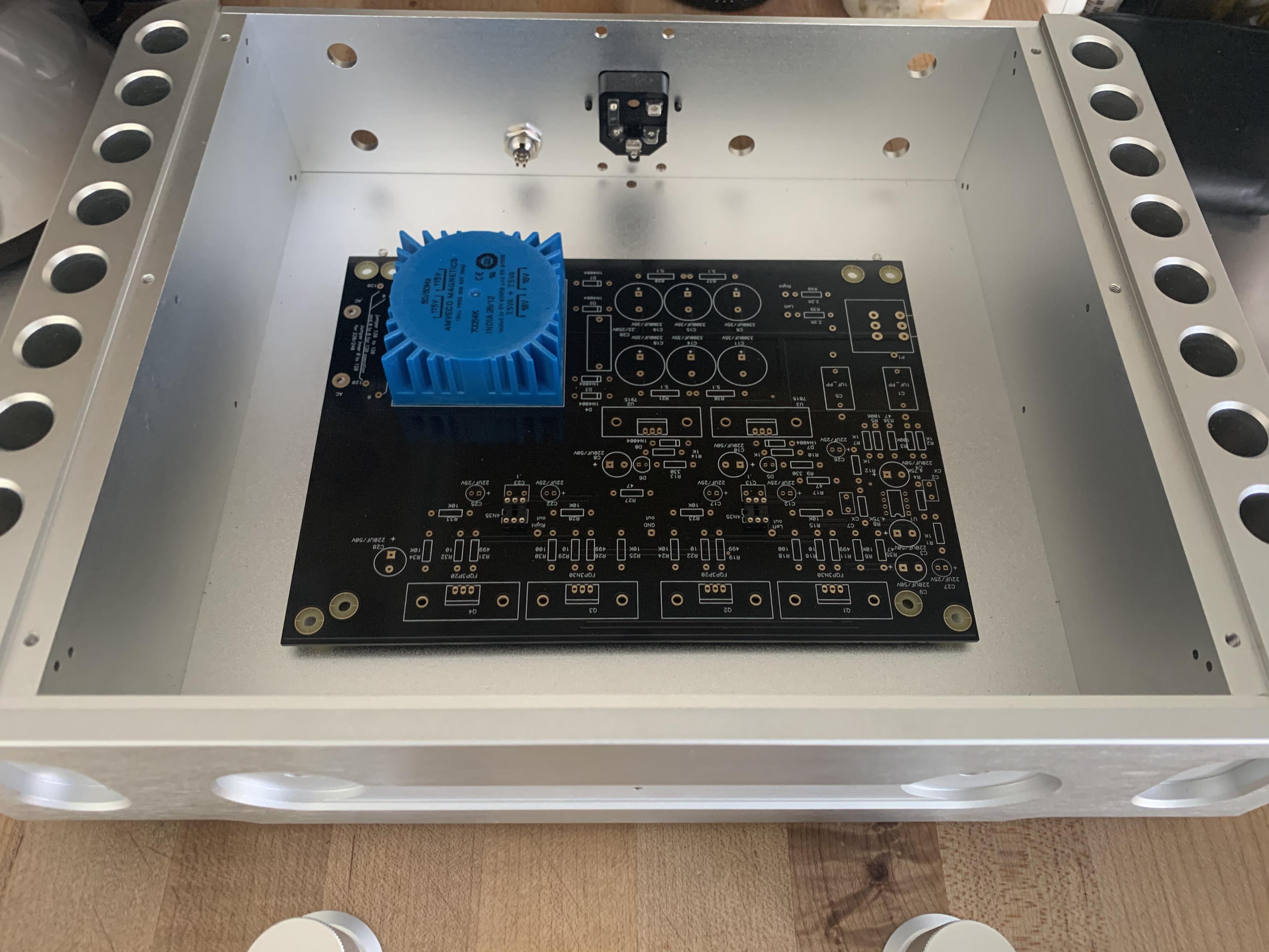

Those look great! As you, I had the option to orient the PCB in either direction (I actually designed the case from scratch with that in mind, nothing as good looking as yours, that's for sure!).
There were pros and cons for each orientation... in the end, I decided that having the Pot as close to it's original position with minimum wires (but I didn't solder it to the PCB) outweighed the pros of putting the PCB rotated 90°.
I'd be interesting in your reasonings to do it with the PCB "sideways".
Case looks incredible!

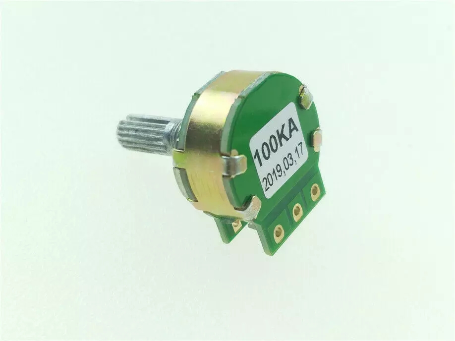

Which part are you supposed to grease? I tend to just put deoxit on the contacts themselves, and potentially a tiny bit around the little ball bearings (on the ones I've seen). Hope I've not been doing it wrong lol
Hi Zen,
I'm not sure we're talking about the same item?
See pictures attached. Where would you put grease?

Hi Zen,
Sorry, my bad

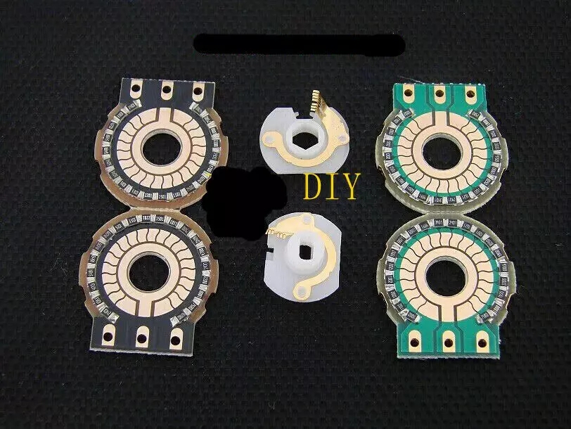

I meant that you bought those made of blue-white rotary switches, with smd resistors soldered on tabs around
you're good with these

So far I have found 2 versions of these resistance pots, one in a blue housing like the Alps pots, and one that looks like the cheap pots, without plastic, which I also like better.
