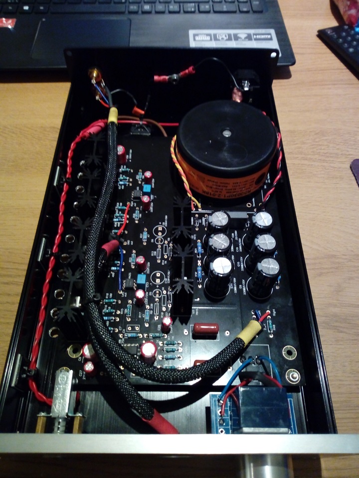

So, I am wanting to make sure my build can accomodate this brunson op amp. I don't plan to buy it, but I envision my buddy getting his whammy gift and finding out how good it is and then finding out he could try a Burson op amp and possibly make it sound better and wanting to persue that.
Since I stumbled on some of thus Burson talk, I have tried to search and am worried I might be missing some info as to what changes I should do in making sure my build is prepared for this op amp. I saw the "MKP cap modification, which is a polyester 0.1 cap across the + and - supply rails". Is that a Burson opamp only mod or would it be ok to have in there for other op amps? Anything else I'm missing that needs to be considered?

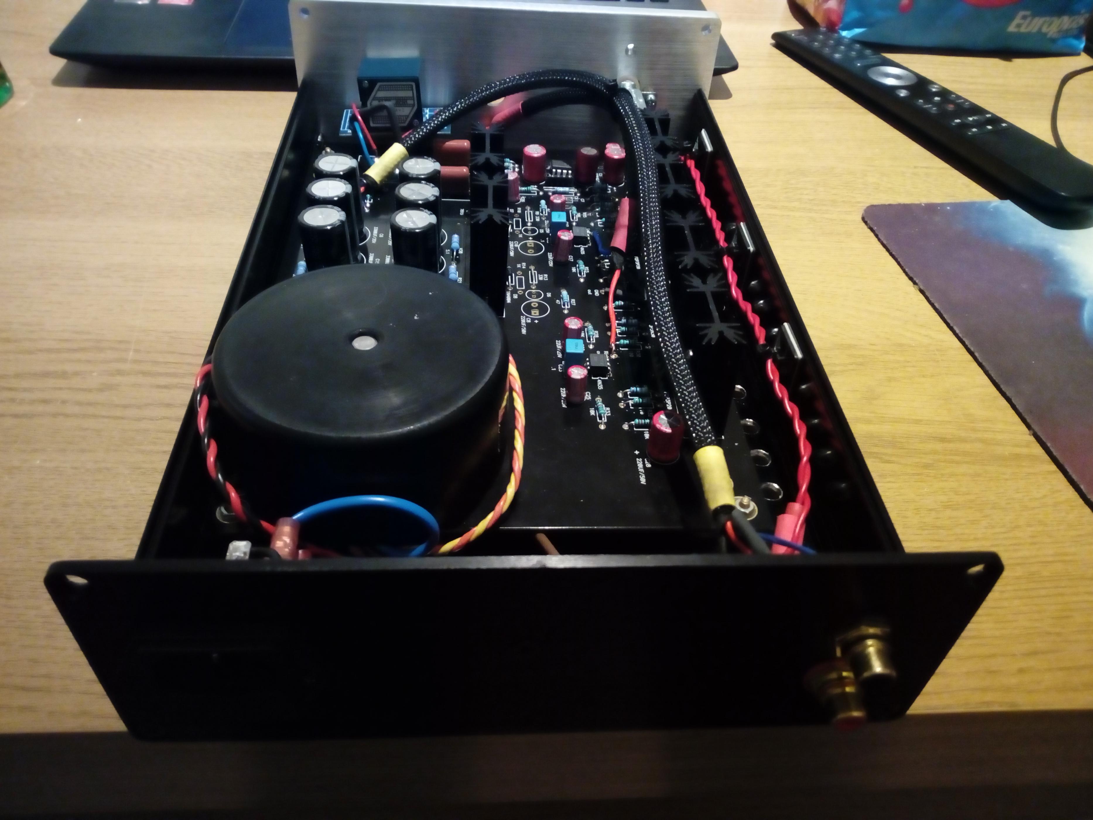

I too ran across that. I was fortunate to receive some demo parts from Burson. I am definitely not an expert, but a kind person walked me through how to do it earlier in the thread. It's fairly easy. There are manufacturers that even sell DIP sockets with caps already in place. I found that pretty cool. I can't say whether/if that mod applies to other opamps, but I've got mine on the socket, so it's not permanent. I'm also one of "those" people that stacked sockets. FWIW, I did my primary listening before I knew of the recommended and proper way to do it. Mine worked and sounded wonderful even before adding the cap.
One key is to ensure that you have space between the electrolytic caps to the side and the OpAmp. The Burson OpAmps take up more space, and won't wedge in there w/o some help or some mods with the "normal" diameter caps in the kit. See the board placement. I believe I heard that the next kit will use either smaller diameter caps and/or the board placement might be different. Also... in a very tight chassis, height might be a consideration.

I saw the pics from thomasnadeau (many helpful posts, thanks!) "WHAMMY" Pass DIY headphone amp guide
I could look to try and get a couple similar caps but smaller or just use his technique and not put the legs in a deep so you can angle them away.
