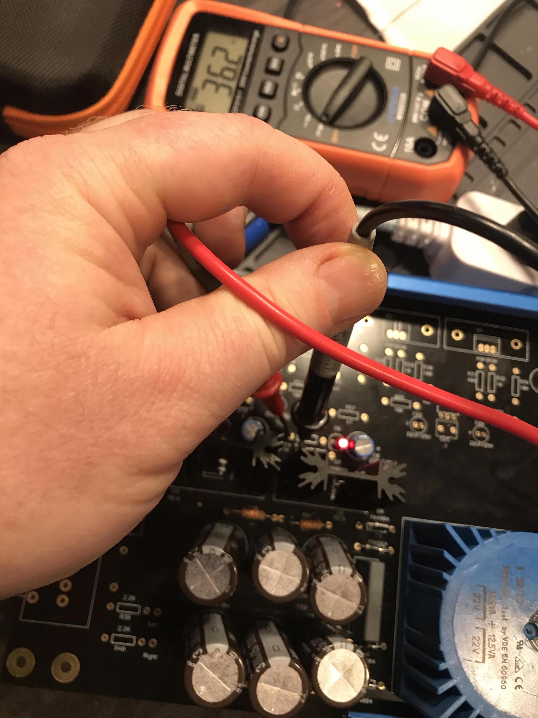

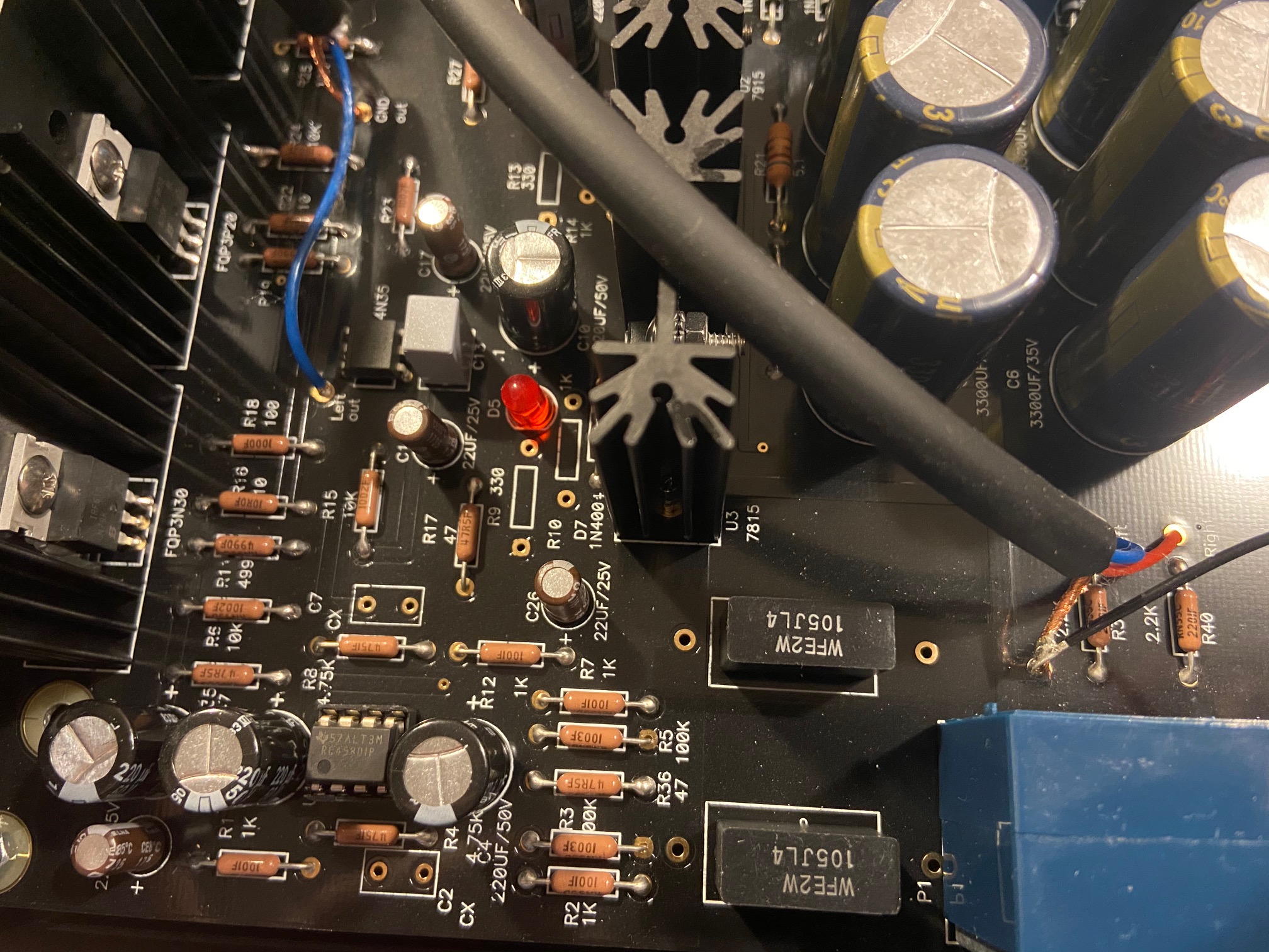

Man, I am not having luck building this thing. I'm at the test the psu step. i previously had gone the "LED reference route." When I first tested things, one LED lit up and one did not. I am a n00b and have no idea what I am doing so I pulled up the multimeter to try to figure it out. Eventually I got a spark and the other LED went out. After that I was getting about 37V on the rails for both +/-.
I have replaced the diodes in D7 and D8 after that. No luck, LEDs did not light up. Still getting about 37V. OK, I don't want to order anymore parts, let's see what happens when we at least try the "naked regulators" option. I should get 15V there too. But I'm not. I'm getting 29V in the attached.
The unshielded wire is a test of the naked regulators option. It isn't permanent.
Any ideas?

Have you tried meassuring the rail voltage with a load on it? Regulators can give some funny readings without a load. A 1Kohm 3W resistor should do the job.
Also, you can try meassuring the raw rail voltage before the regulators.

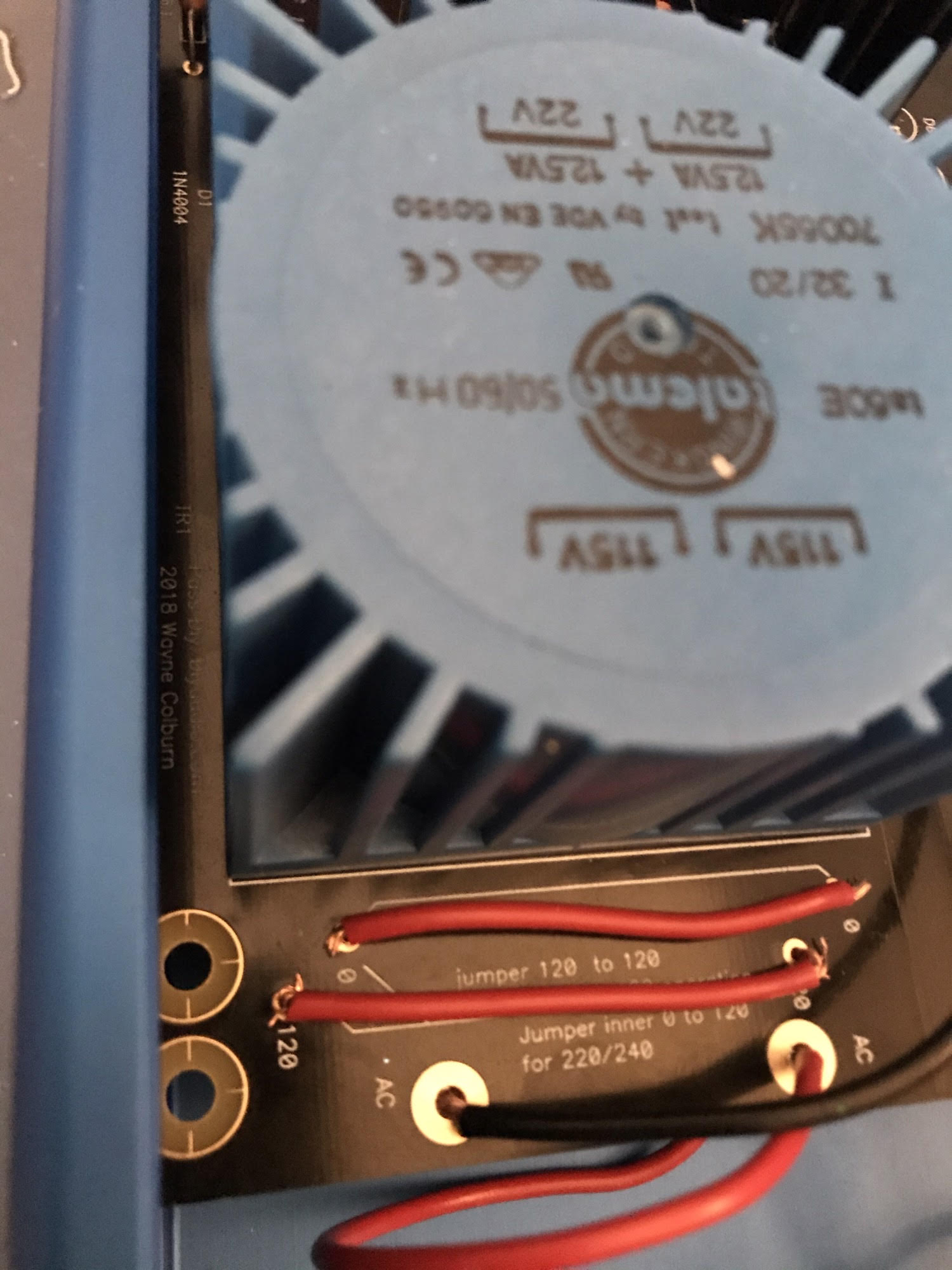

@PastorOfMuppets - how do you have the mains connected? You should only be able to get 31V out of that 22VAC transformer after rectification. There are 2 ways to connect mains voltage in depending on whether you are 120V or 240V
Check 6L6's build guide in post#1 if you are not sure:

These transformers have 15 or 20% regulation so without a load, one can expect
to see voltage somewhat higher than the theoretical 31VDC. Also, the input AC
may be higher than the nominal 115/230 VAC of the transformer.

Clearly Dennis is the smarter one from Toronto 🙂 if you wired it for 240 by mistake instead of 120 you'd see 1/2 the voltage, not double. Ignore what I said 😀😀 (my excuse is that I was up really late for the past few nights)
Do you have any pictures of what the underside of the board looks like? All solder joints clean with no shorts?

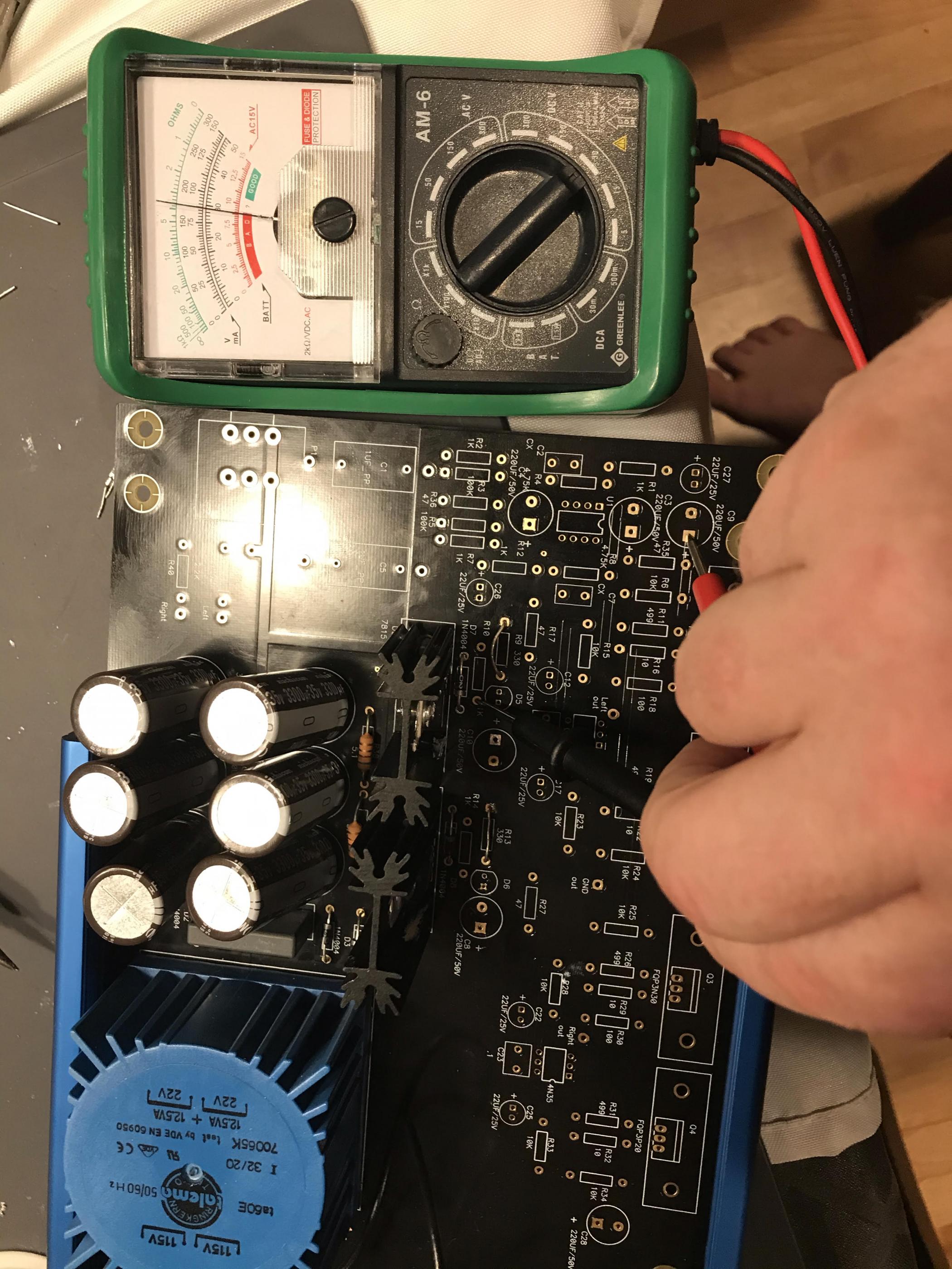

Looking at the meter it shows 17.5 Volts. The meter is set to 30 Volts scaleMan, I am not having luck building this thing. I'm at the test the psu step. i previously had gone the "LED reference route." When I first tested things, one LED lit up and one did not. I am a n00b and have no idea what I am doing so I pulled up the multimeter to try to figure it out. Eventually I got a spark and the other LED went out. After that I was getting about 37V on the rails for both +/-.

So the top scale should be used. Am I wrong or anyone else see this?
i have a digital one on order. i would like to think i can get by with my older than dirt multimeter but i don't know what i'm doing and need to admit that.

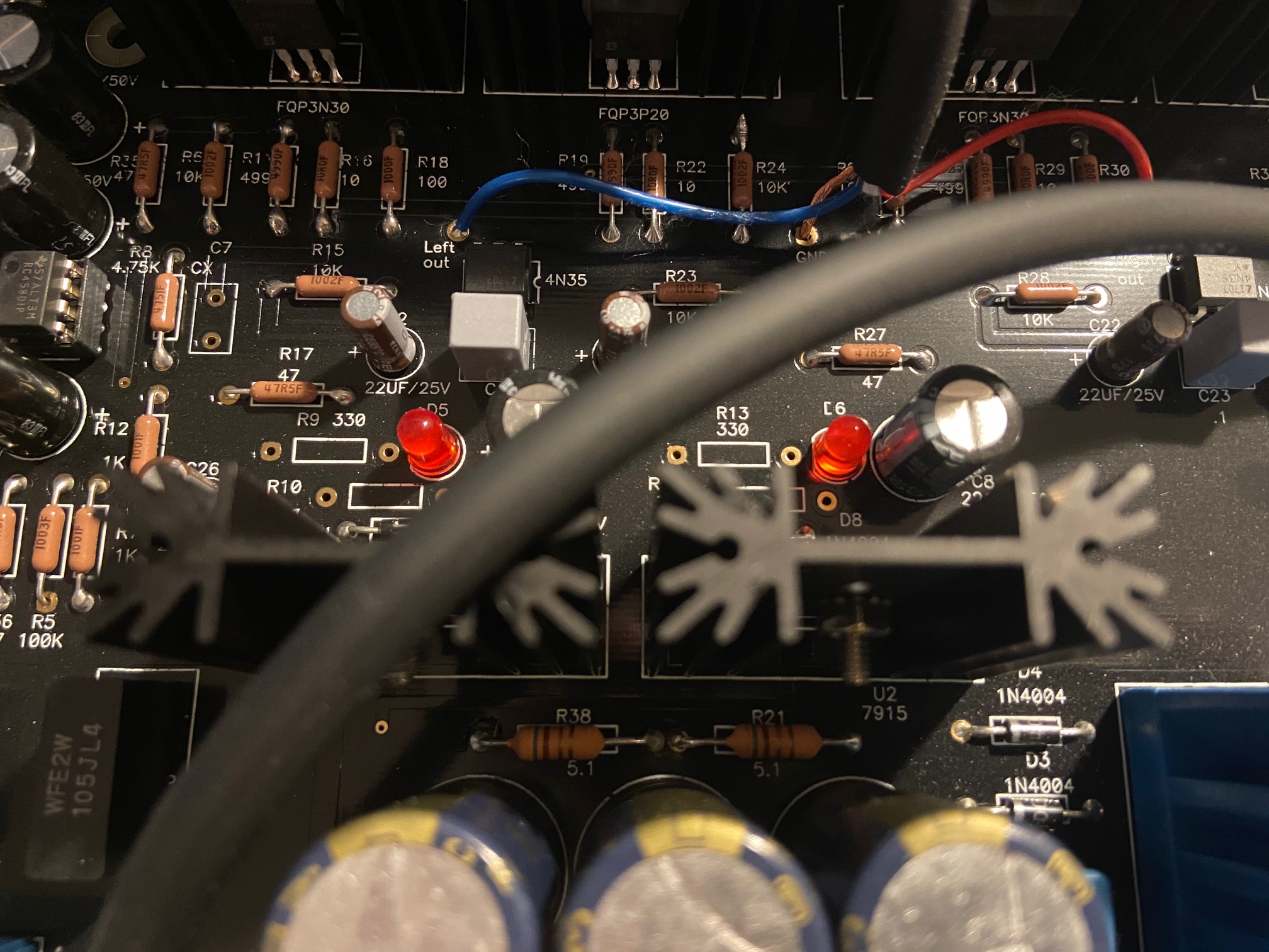

Yeah super weird. I redid the cap and LED. When I plugged it in, Of course this focused on my hand, but I'm getting 36V across R13 and R14, and 37V across R9 and R10. D5 isn't working, and didn't work after plugging it in after sitting there for another half hour or hour. Bought extras of those. I have some time tonight to really look into it. And make sure I bought the right parts.

Did you stuff R37 and R38 behind the caps?

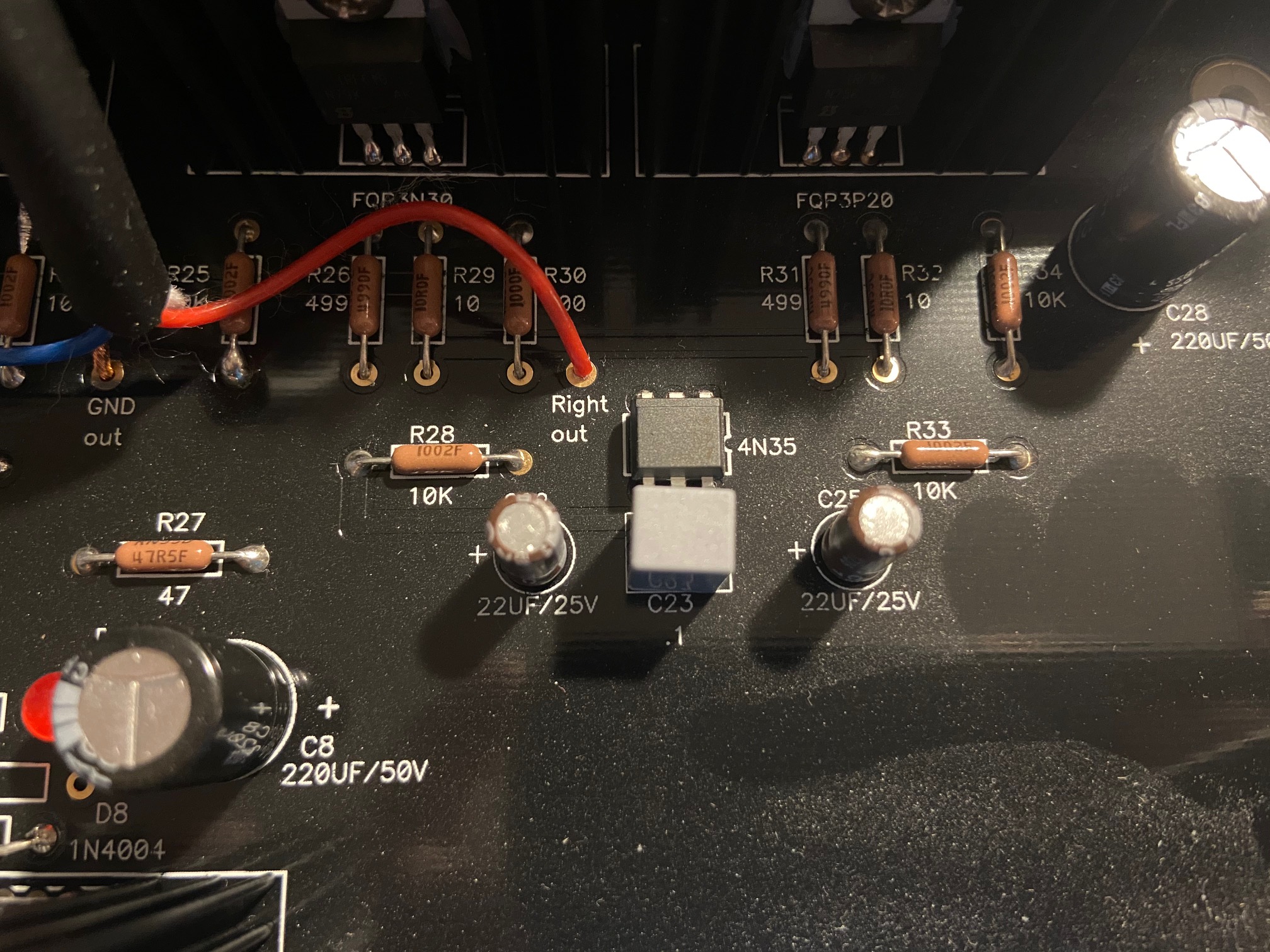

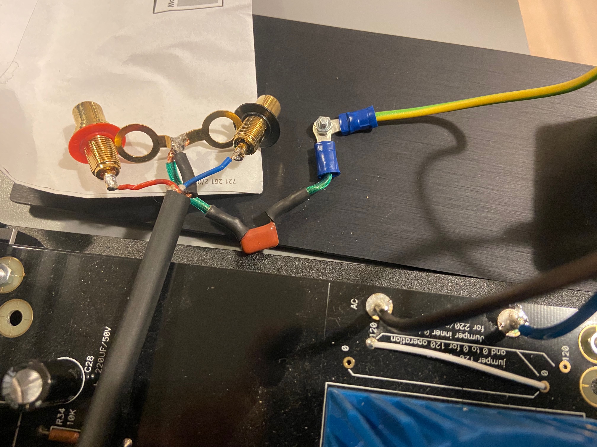

Hey Guys,
I have been building my Whammy a few months back and turn to you for help. I ordered the PCB plus parts kit and had a breeze building the amp. It works and produces wonderful sound. It however generates a significant amount of hiss, which ultimately turned me away from it. The amp has been collecting dust for a few months now and I want to fix the problem. Is there any obvious thing I am missing? I have been searching this thread and grounding the pot and RCA inputs helped with a hum, that I was having, but did not affect the noise floor. In the attached pictures you can see the current state of my Whammy. The RCA jacks currently have no ground connection, but that was for testing purposes alone (comparing ground noise with hiss etc). i am using a modushop aluminum case, if that helps.
Thanks a lot in advance!
