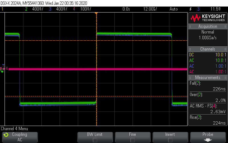

Looking at IRF610 and IRF9610, I found In/Out/Reverse transfert capacitances to be quite close:
What improvement would you expect then?
While measuring 10kHz square via scope, I did not see any asymmetry issue on the rising/falling edges, consistent across levels:
- N - IRF610 140 / 53 / 15 pF
- P - IRF9610 170 / 50 / 15 pF
