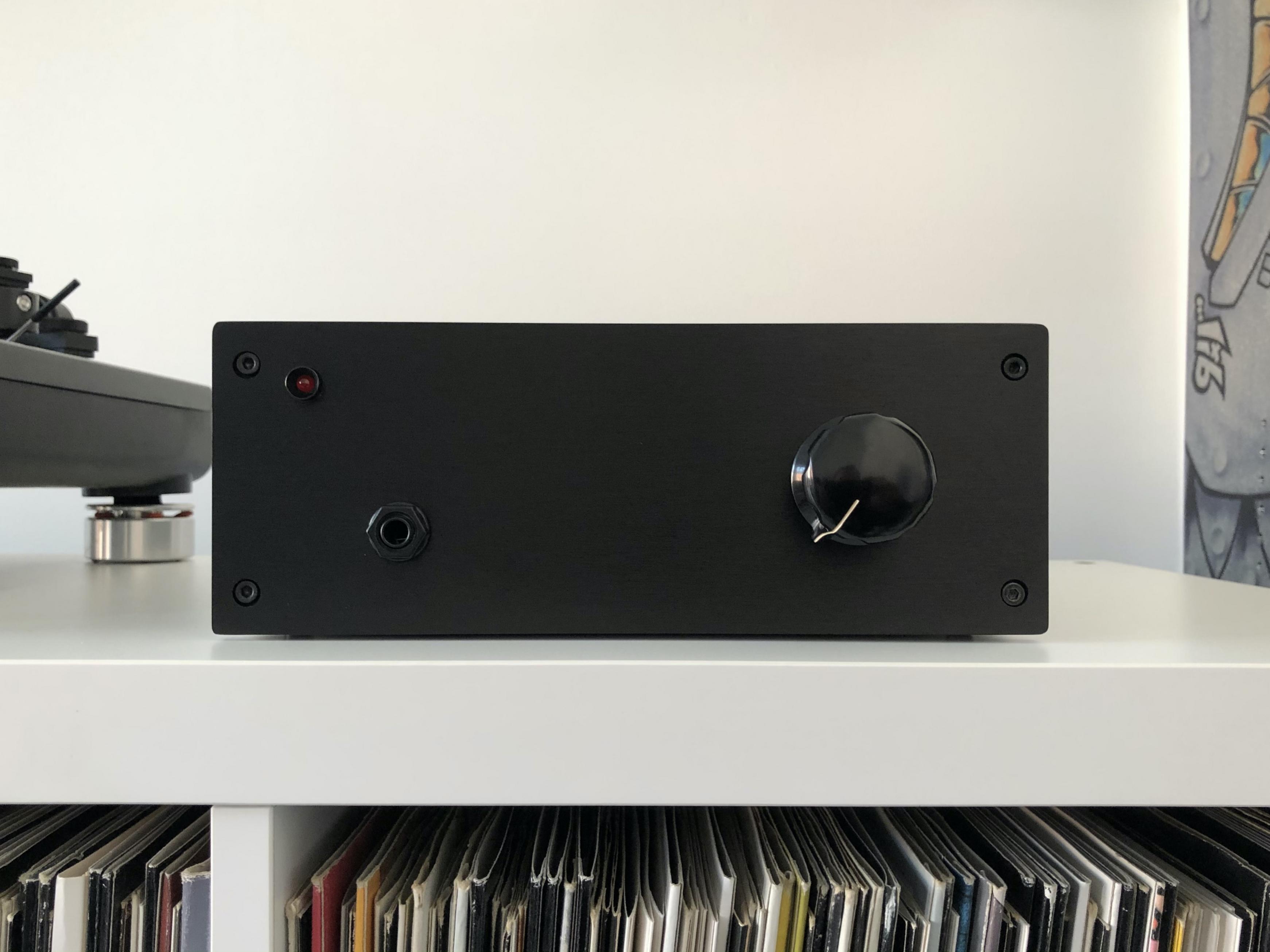

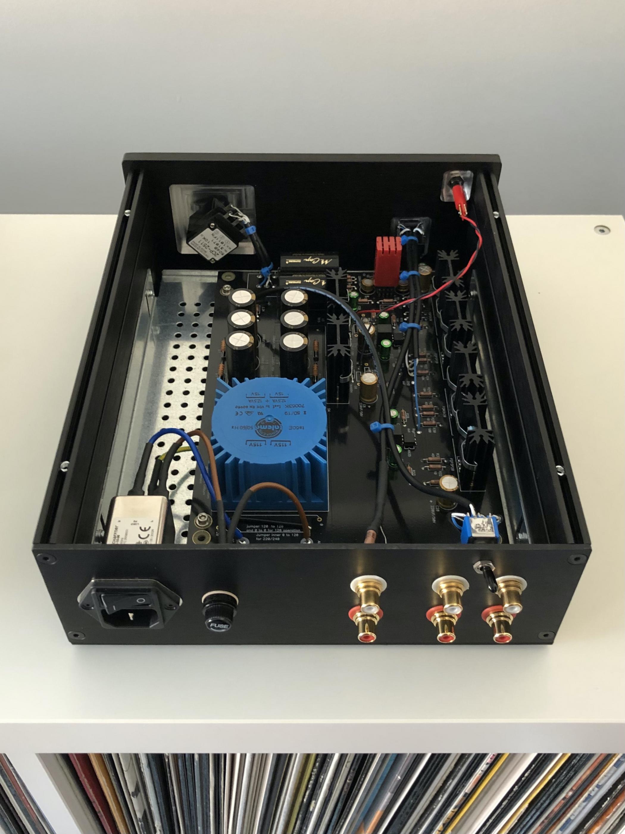

The Whammy is the first diyAudio project that I've completed, I'm definitely hooked! I built two, one with a 15v supply for my friend who wanted to run the Muses01 opamp risk free, and this one for my self with the 17v supply. Please could someone with more experience provide some knowledge in a couple of areas?
1: After building my Whammy I have since read a couple of posts that suggest that the 25va, 2x15v transformer that I selected may not have been the correct choice for the LED supply configuration. The part looks pretty difficult to desolder with the equipment I have on hand, could anyone offer some guidance on this? I would really like my amp to perform at it's best, Is there any point in swapping the transformer out?
2: If I connect headphones to the switched jack with the preamp outs connected to my amp i get some noise coming through the speakers. I have tested this on a couple of friends systems and it is has been inaudible, however on my 101dB speakers you can definitely hear it. Is there anything obvious from the photos that I could do to fix this?
Thanks!

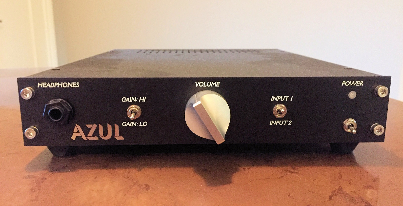

For what it's worth, one of the headphone amplifiers I exhibited at Burning Amp 2019, had two gain settings: +16.3dB and +8.0dB ; or, if you prefer, 6.5X and 2.5X. With these choices, the HPA paired quite well with a large number of different sources and different source signal amplitudes.
Gain switching in this particular unit was performed with relays, whose coils are activated by a front panel toggle. Of course other implementations would work quite well, too.
It was a great pleasure to hand over the headphones to Wayne C. for a demo and listening evaluation of Azul, at the end of the B.A.F. He was very kind.
