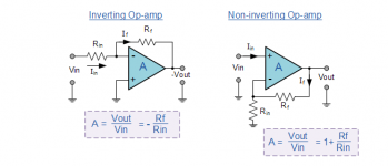

I was curious about this and went back to the first post here and under the heading called CIRCUIT, the 3rd line says
Gain is set by R8/R12. Lower gain, make R12 bigger, unity gain, R12=10K
The standard circuit diagram shown has R8 = 4k7r and the R12 = 1kR so this gives gain of 4.7 - do you need any more?
The formula is R8/R12 (On both channels)? If so, all I need is that and a switch recommendation and a little wiring diagram. Like I said in my original post, I have little in the way of DIY skills and can't seem to make much sense of a schematic but can follow pictorial diagrams, as I have building the Dynaco, Hafler and Van Alstine kits, all of which worked from power-on. Thanks for directing me to the math which I jumped past.

Gain is set by R8 and R12. The numerical value of gain is, however, not equal to the ratio "R8/R12".
Wua!... i thought non inverting opamp couldnt have a negative gain? I honestly did not know it was otherwise
Sooo...what values would I need to get, say, 1x and 3x? Repeating myself, I have no EE experience... just enough direction-following ability to follow directions ("make R12 xxxx ohms for a gain of Xx") and such.

so, with equal resistors, gain is 2V/V , which is exactly 6db
can't have less with this arrangement

For unity gain, remove R1 & R12, fit links in place of R4 & R8; C2 & C7 and C26 & C27 are redundant and can be removed.
I haven't tried it, be careful, some opamps aren't unity gain stable.
