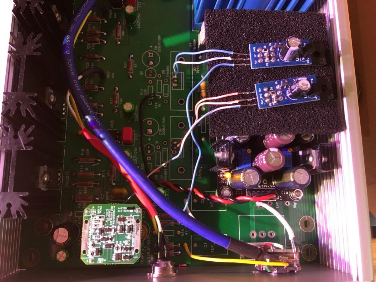

Franken-Whammy. Still here. Poor thing.
Couldn't resist whipping in the XEN discrete regs again, this time just supplying the op-amp. The XEN regs are giving out stable +20.11 / -20.13. Input is around 21.5 so a small dropout.
Definitely yes, this works a treat. For once I actually heard a noticeable difference, I think the 994Enh likes a higher supply voltage, certainly things have opened up.
The CapMX is still knocking out a steady +/-18.5 V for the rest of the circuit, so running the regs and MX at the limit of their operating voltage.
Probably the big part of the improvement comes from having separate supplies for the opamp and the "power" stage?
For this op-amp, yes for sure. It has definitely opened up the sound, I think the 994Enh comes alive with a bit more juice. This op-amp is a monster, blows anything else I have heard away. Hard to know what to write without the usual blah, blah but everything is better.
Very impressed with all the ancillary upgrades, CapMX, op-amp and regs are all excellent additions. This Whammy is a lot of fun and sounds lovely. The XEN regs might be one of the slickest little DIY audio designs ever. Brilliant things, should have asked for 20 boards.
