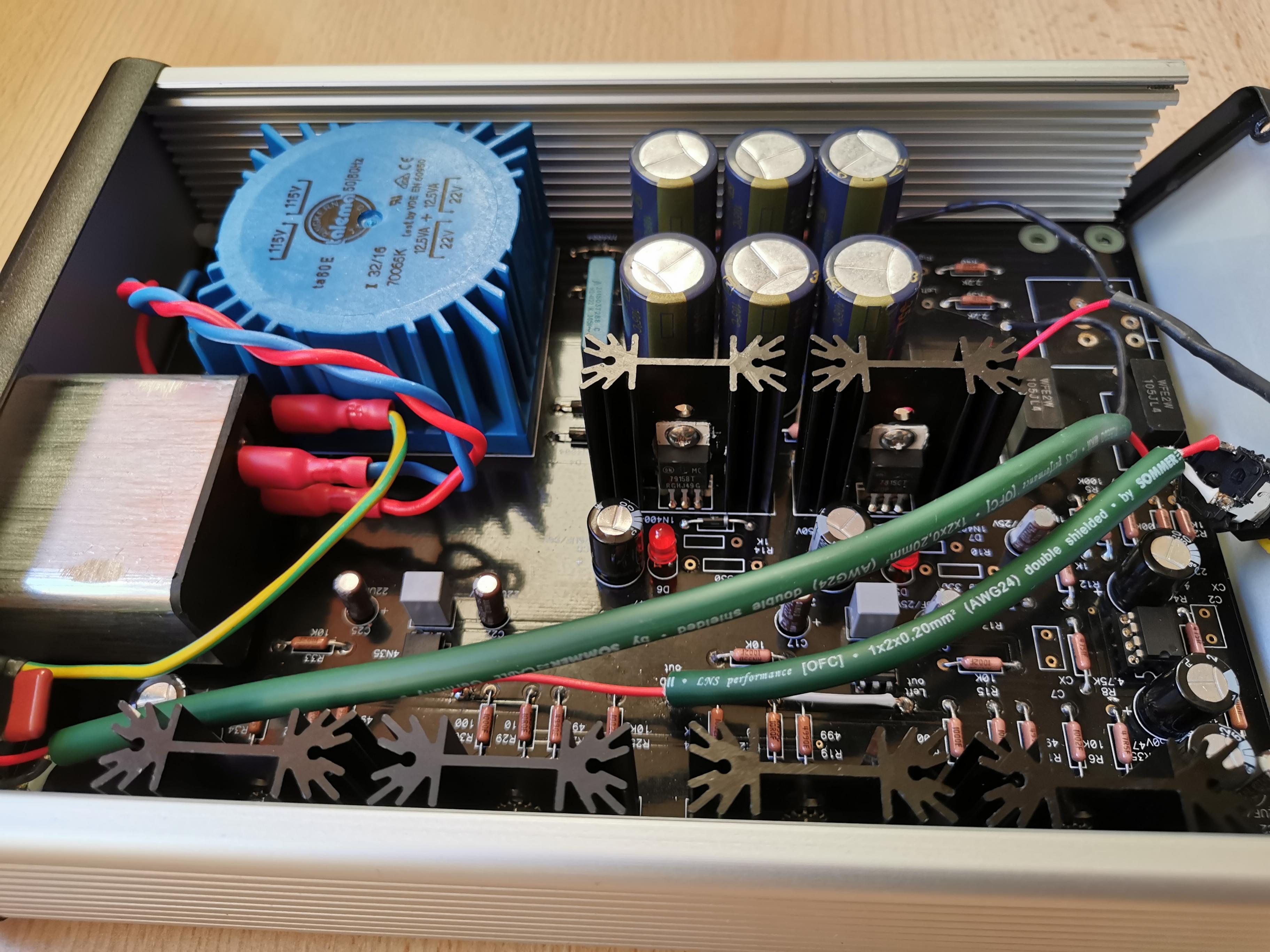

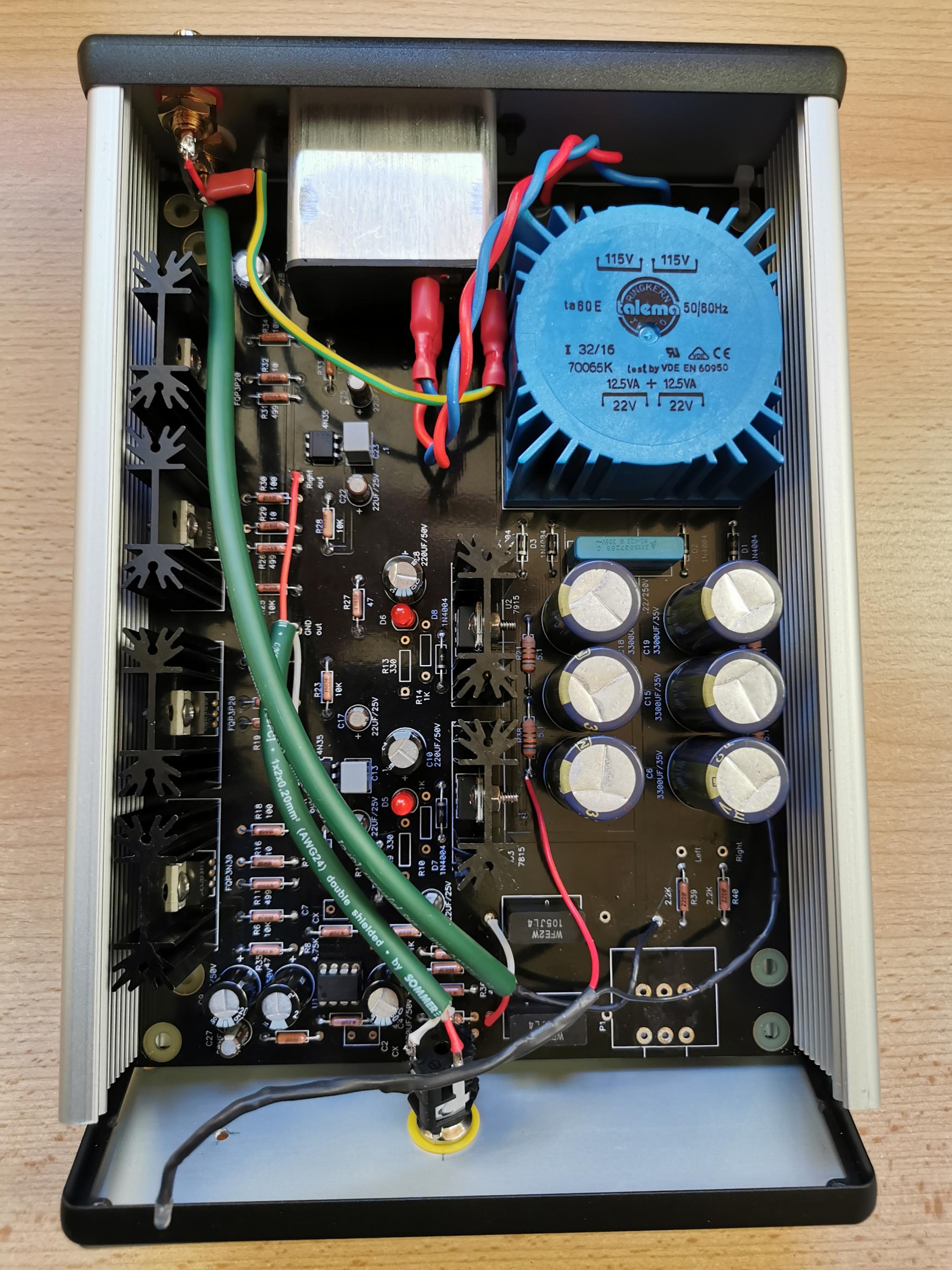

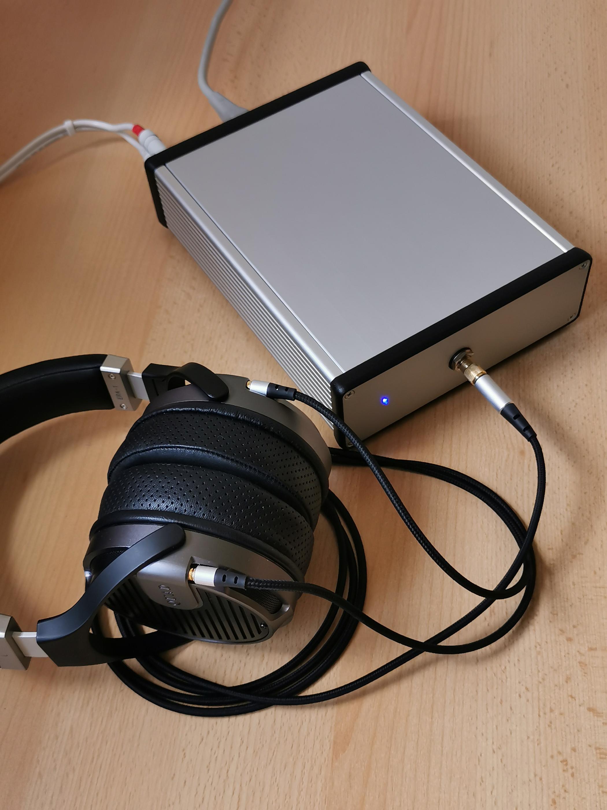

Another Whammy is assembled!
First of all, many thanks to Wayne and 6L6 for this Whammy project. Such a great HPA and support for building it!
But also to the others in this thread (... have read every post ...) for valuable input on assembly and parts decision.
This has been so much fun (especially during the lockdown). I have used the full kit and the Hammond chassis - so not much of a special design. But the result is simply outstanding. The Quad Era-1 (20 ohm) is working extremely well with Whammy, never heard something similar before. Full sound, clear and detailed, feels like directly being drawn into the music and forgetting to have an HP on.
First, I assembled the full kit including volume control. Initially, one channel was a litte lounder as the other, but after re-soldering few parts all was fine. In the final version, the Alps pot, R39/R40 and C1/C5 are omitted (although partly left on the board), and of course a blue power-on LED. Signal is coming from a DAC with volume control, going into the Whammy after the coupling caps. FQP3N30/3P20 are used for Q1-4 and the OPamp is OPA2107AP. This was chosen based on the feedback on OPamp rolling in this thread, and I can confirm its great sound in my setup. DC offset is below 0.2 mV for both channels. Only question is that the OPamp voltage of 1-out is higher (~80 mV) than 2-out (~30 mV). Not sure whether this is something to worry about, while the sound is fully fine.

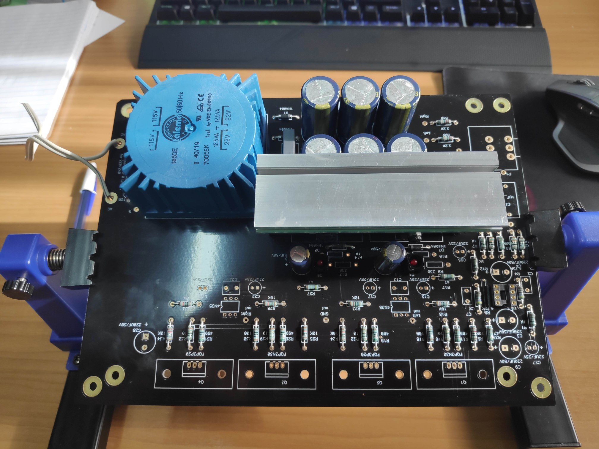

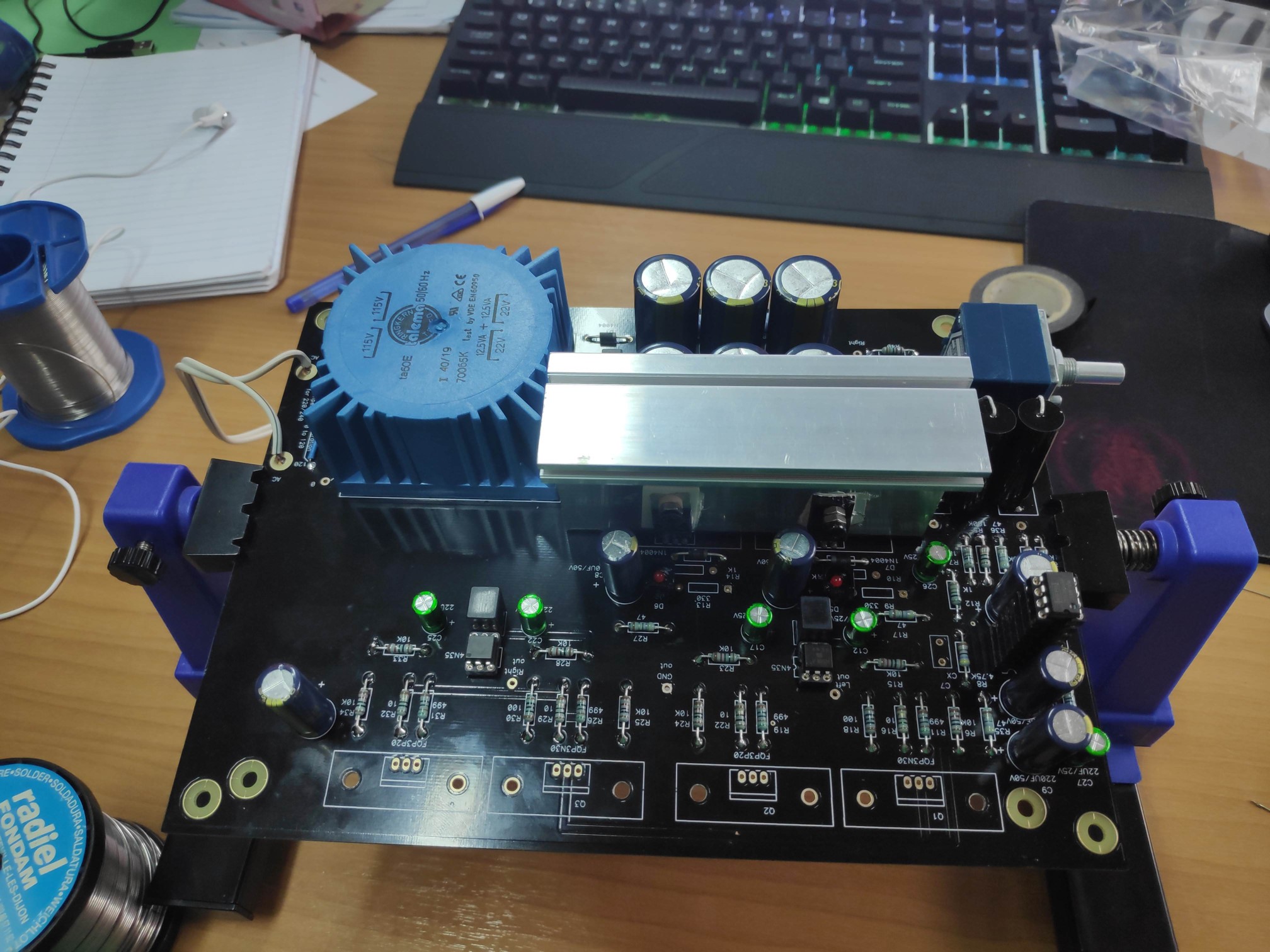

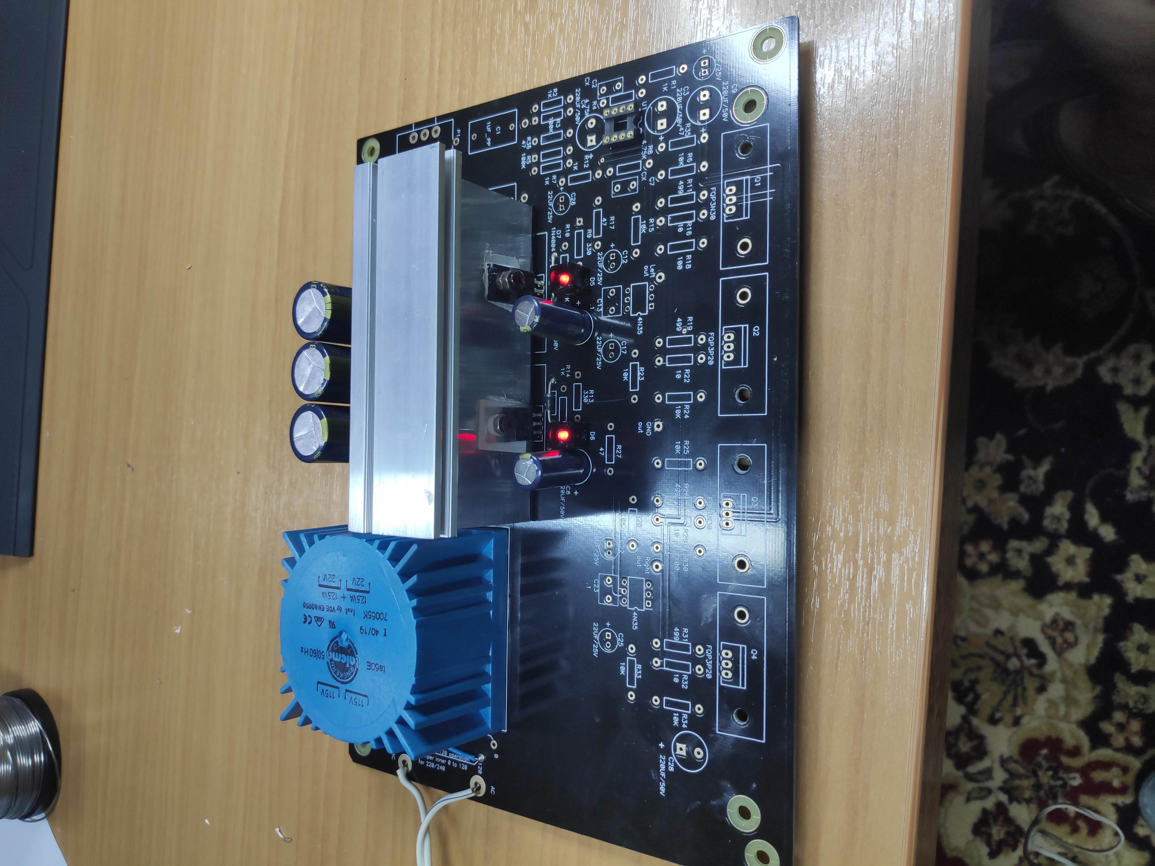

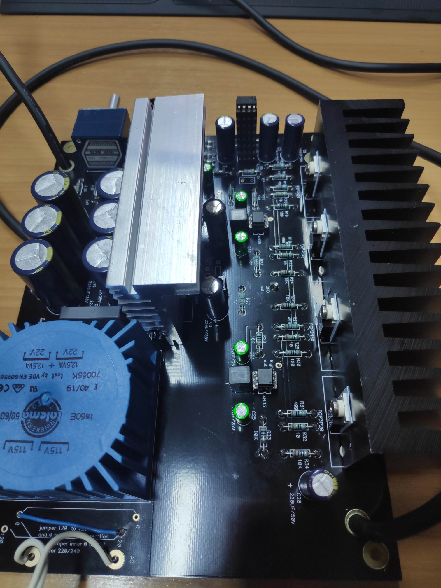

Finished my WHAMMY about 3 weeks ago and have been hammering it since, I invested in a pair of planar headphones and haven't looked back. I don't have a case for it yet as I'm looking for a new DAC project and then will box up the full stack.
Clean, crisp, plenty of power and silent. Took around 3 hours in total to put together and is worth every single penny x3. Love it.
