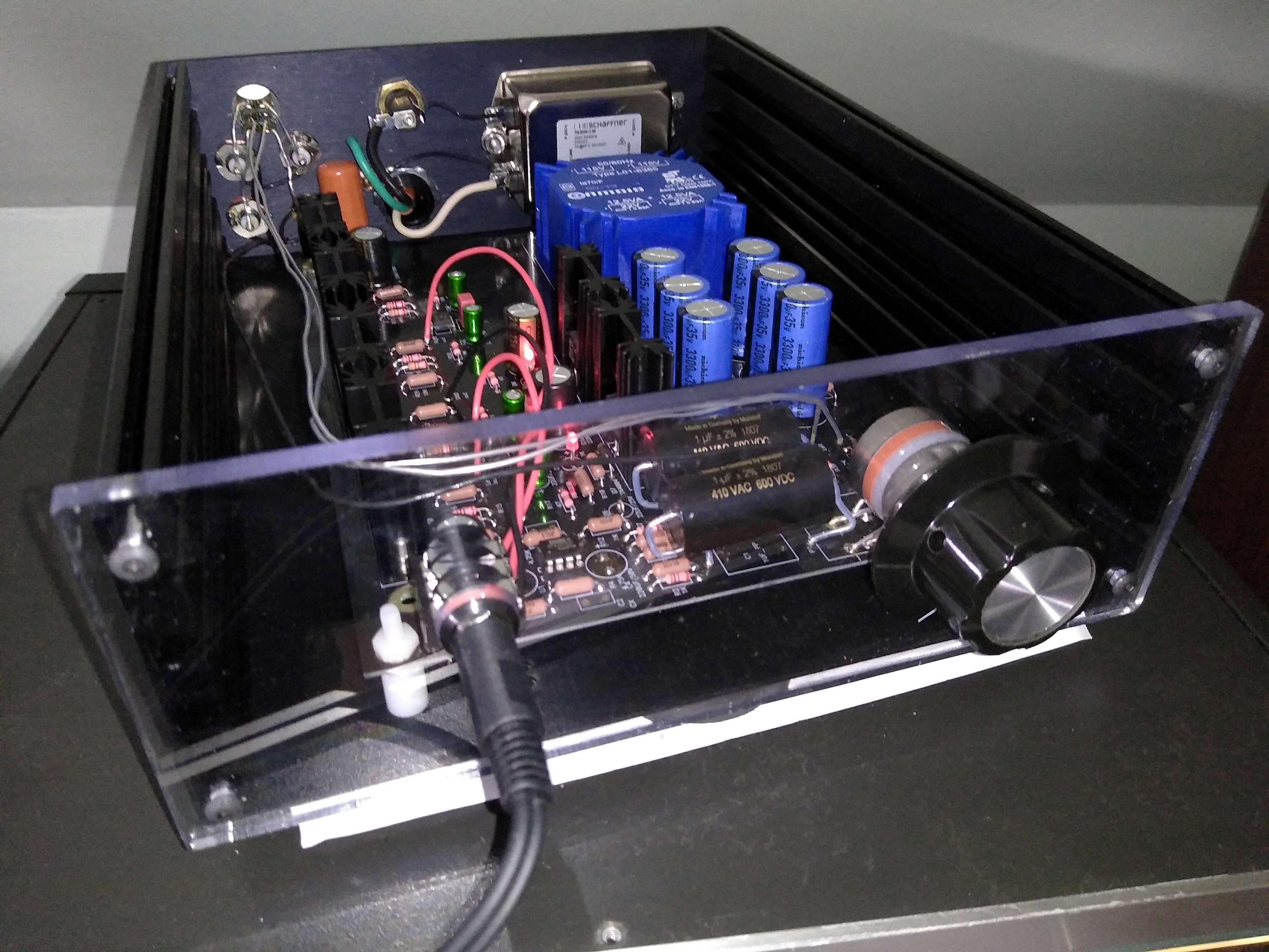

Got the cosmetics and chassis finished on #2 WHAMMY...I like the look of the polycarbonate front panel. Now to start plans on the 3rd and slowly research and gather parts over the next few weeks.

I am using bi-polar Nichicon UES caps in the C26 and C27 positions. C2 and C7 are not used, with the positions left open. I am using the specified input coupling caps.
The caps are Mundorf MCap Supreme polypropylene..not crazy money compared to some. The filter is a Schaffner FN2090-3/06..a 3 amp model..could have used lower rating, but wasn't available at the time. Everything fits nicely into the Galaxy 2U chassis with room to spare.
