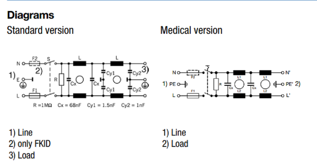

It does seem to have everything in one neat package though, which helps to fit into a smaller chassis. I would have used an IEC panel mount socket myself, but I'm cutting all holes by hand in the 3mm thick panel. Round is way easier to cut without the right tools. But with a die grinder, the IEC units would be easy. Man, I wish I had a drill press.John I was looking to use a switched fused filter in a project and was recommended the FKID 2 stage type as being the one, damned expensive though -
4304.5022 | Schurter,2A,250 V ac Male Panel Mount Filtered IEC Connector 4304.5022 | RS Components
Yes John, square holes are the bain of my life too. Hence using a Neutrik PowerCon Connector in my Whammy.
Here is another two stage filtered IEC inlet that is cheaper, DD14 series -
3-103-777 | Schurter,2A,250 V ac Screw Mount Filtered IEC Connector 3-103-777 | RS Components
We could try and make out own filters with the values in the spec sheets. Nice to have everything in one tidy unit though.

Re: line filters:
For pre-amps, I am using a 0.6 A version. It helps to be on 230V mains; that way, the 0.6 A version is also still sufficient for small tube power amps ...
I second what avdesignguru said about the lower-rated filters having better filtering capability ... it's actually in the data sheet 😀
Here's a link to the 0.6 A version of the Schurter line filter for reference:

You can mount that on a small perf board, solder the AC wires to the pins of the filter, and mount the perf board with stand-offs ...

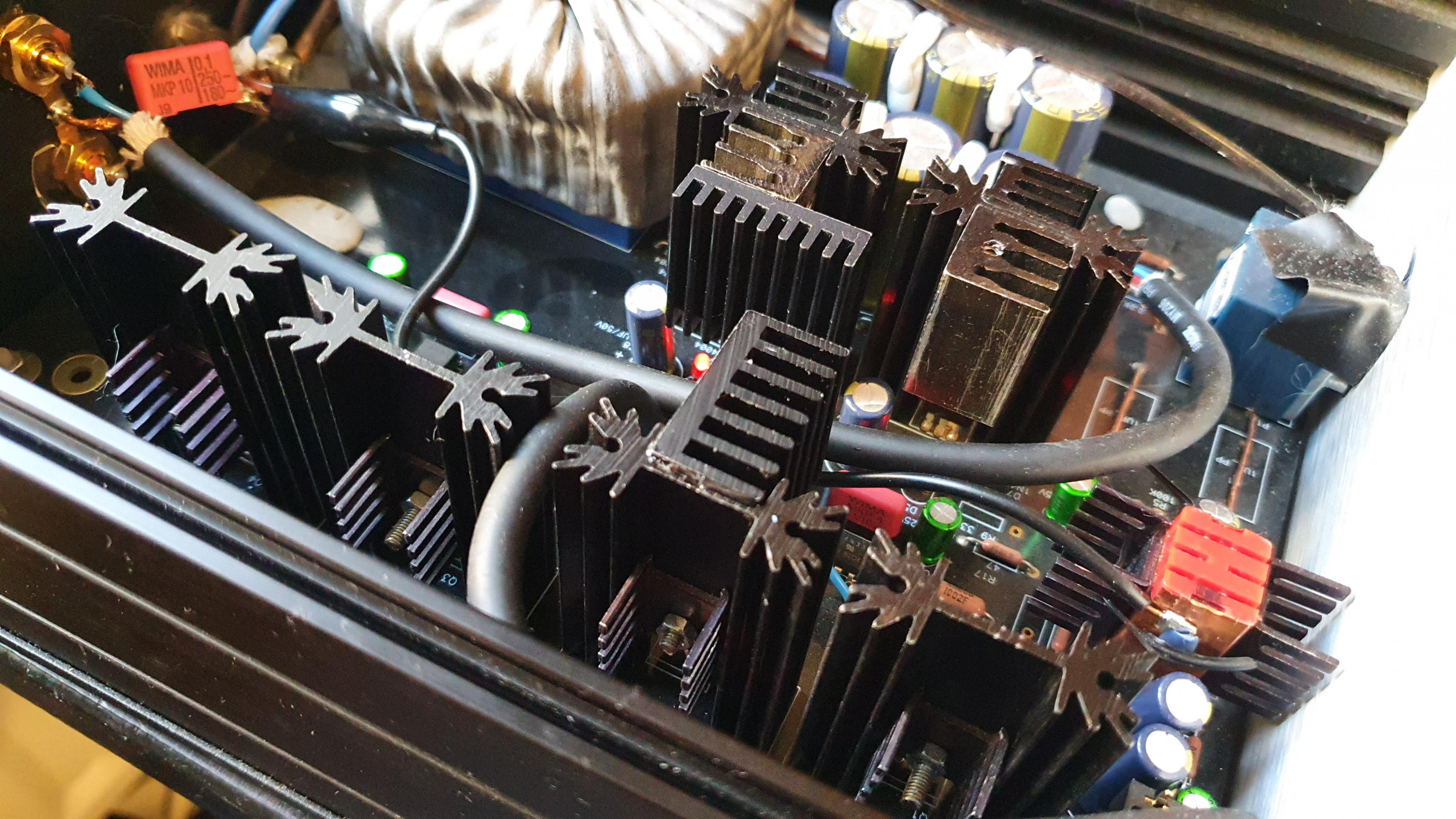

I know one mod that I'll take care of very soon...taller heatsinks for the regulators. Ohmite has equivalent units in stock at Mouser that are another 13mm taller...can't hurt any. The 38mm ones get pretty warm...warm enough that you can only touch for a couple seconds.
What is your output bias?
I bought the 80mm tall heatsinks version instead of the 53mm one. It was even cheaper at mouser, go figure.

The output transistors are actually fine at the stock bias. They run warm, but not uncomfortably hot. On the other hand, the regulators run very warm...too hot I think. You can't touch the tops of the heatsinks for more about 2 seconds. And in the Galaxy 2U chassis I'm using, there's enough room to go taller, even though I've elevated the board by 3/4" to accommodate putting the 2 caps near the opamp underneath the board. They're just too close to have access to the opamp.What is your output bias?

John what is your transformer secondary voltage? If it's 18 - 22V then you are dissipating too many volts through the regs. If you're using 15V regs with 22V secondary, then you are wasting around 13V in the regs. Don't waste volts.
It would be healthier for the parts to replace the transformer with lower secondaries or find a way to eat some volts before the 78/79XX regs such as a pre-reg or multiplier circuit .
Or, find an op-amp that will operate with higher voltages and run on higher rails.
Or, split the supply and run the output stage at 20V and the op-amp at 15V with separate regs

Same here, got a 22v transformer, and i dropped the output resistors from 10 to 6.8ohms. The regs are very hot indeed.
I pondered increasing the resistances or the CRCRC network to have less voltage sweat on the regs and have better mains filtering.
I checked the rail voltages before regs, and there is virtually no voltage drop when goign extremely loud on 150ohms cans.
So I think this option is the easiest one if you don't want to change too much on your existing build.

So it sounds like the 15v transformer would be a better choice. I understand what passive420 is saying about wasting voltage. But I thought I was safe going with the original recommendations. So between the lower voltage and slightly bigger heatsinks, the regulators should be in better shape.
John, depending on your op-amp, a cheaper option is to try 18V regs, with no LED. Quite a few OPA op-amps will go to 18V rails - it will eat 3V or so, which will help. Then just strap some more metal to the regs.
