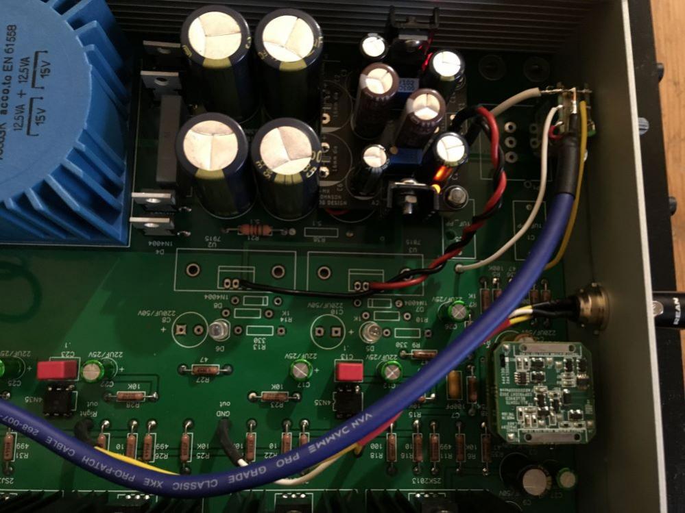

Yes. This Whammy ran with standard 15V regs and LED circuit for a while plus other types of regulators have been tried. The one type I did like were the rare Xen discrete regulators from EUVL, very neat and didn't break a sweat.
It could have been here that I read, 'if you can hear a difference in a change to your power supply, there is something wrong with your power supply'. It's a fair point and Wayne has already given us a great linear supply that eats up ripple nicely, as the measurements show on the first page here.
So it's nit picking to try and do better... but what the else we gonna do? 🙂
A USB scope is really needed to see any ripple improvement so at this stage I will say that it works very well indeed and has the benefit of adjustable output. In terms of effect to the sound, all I can say everything sounds brilliant. I tell you this amp can take a tweak or two.
Also on the table for people with 18 or 22V transformers, is the option to run the output stage with the MX at higher voltage and a separate 15V regulated supply to the op-amp. Sod it, why not. Push the envelope...
So, this 994Enh discrete op-amp jobbie is a beast. Kind of left the amp on overnight and today things opened up for sure even with the Xfeed. But the xfeed does indeed veil some music, so out it came and back in with the DACT stepped ebay attenuator, they are very clear neutral pots IMO.
Had a little swap between the 994 and OPA627BM's and those 30 year old Burr Brown op-amps actually hold their own, still damned good. The 994 has all the clarity, space and scale of the 627's but a sweeter more musical tone it has less sibilance on female vocals but all the texture of the sound. Plenty of depth and control to the bass, lovely mids. The Focals are loving it man.

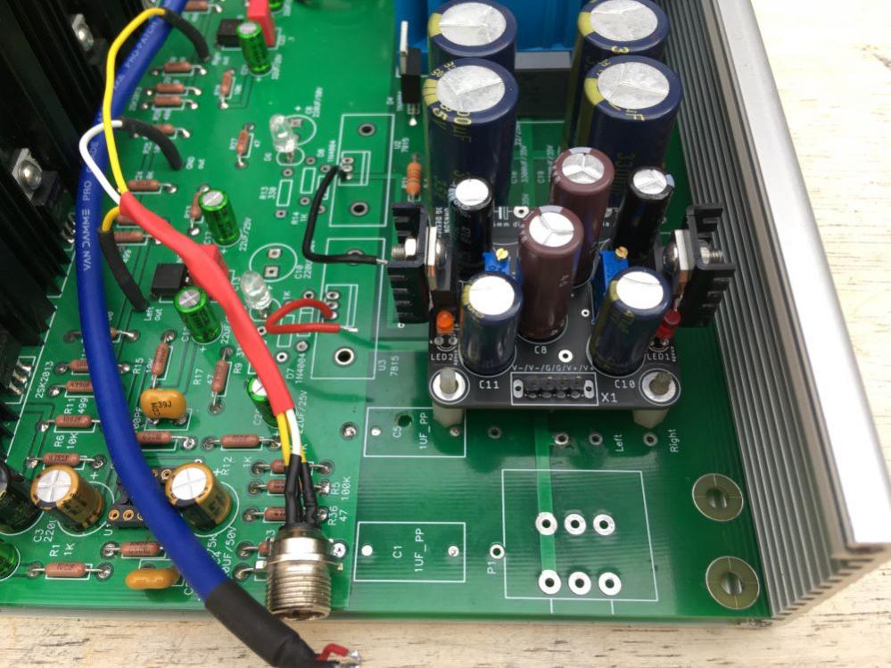

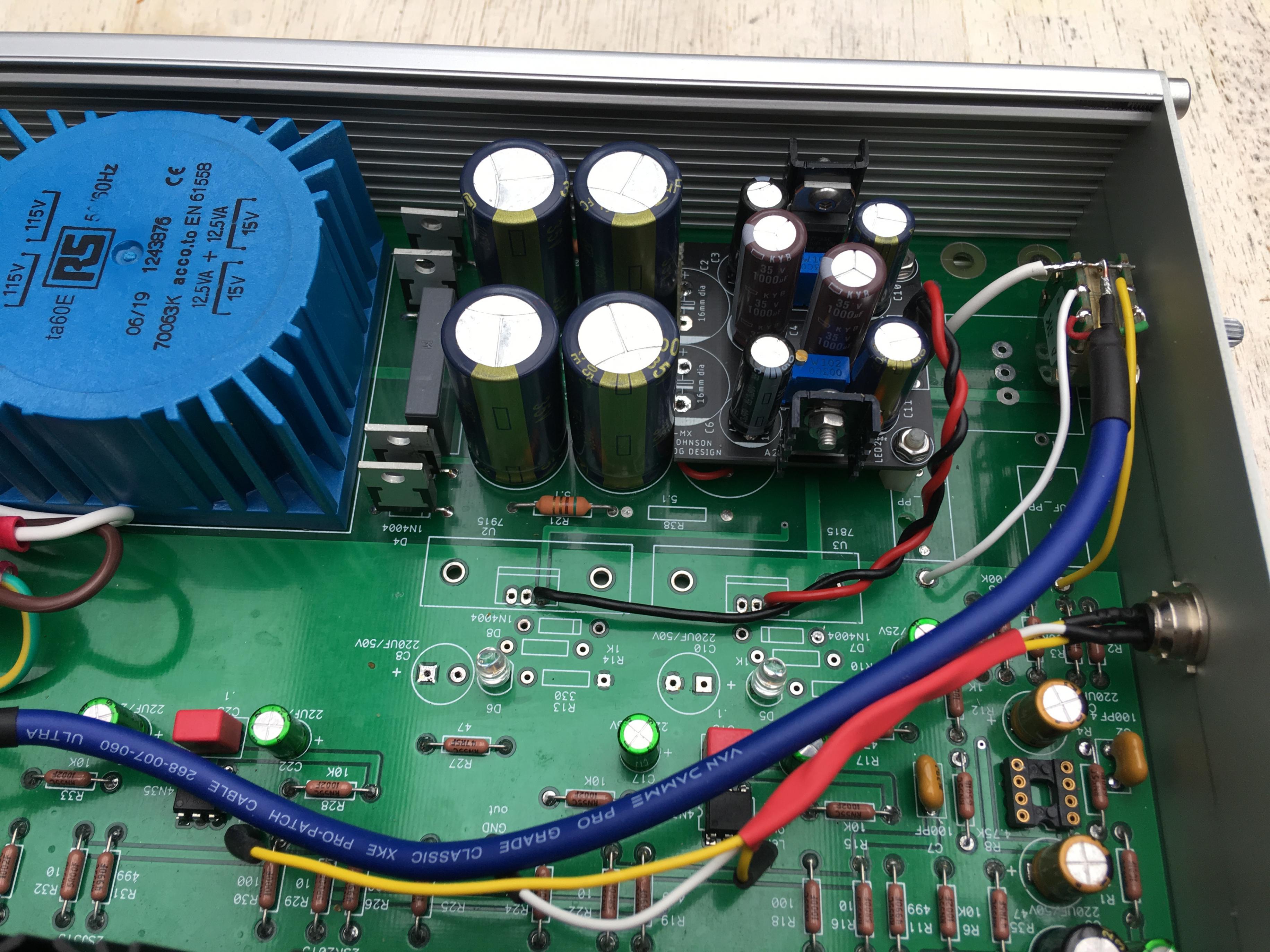

For what it's worth I spent far too much time tinkering again and improved the first Cap MX layout. This time to give more space around the TO-220 transistors I hacked the end off a board and turned it 90 degrees, sneaking it in front of the main filter caps. The supply is now just CRC before the MX, the last 5.1R resistors replaced by wire.
DC Voltage after CRC into the MX is +/-20.5V - Running the amp at +/-18V, leaving just over 2V dropout for the MX. So far so good, wish I had a few extra volts to play with. Will probably try some low noise regs to the op-amp at some point knowing me...

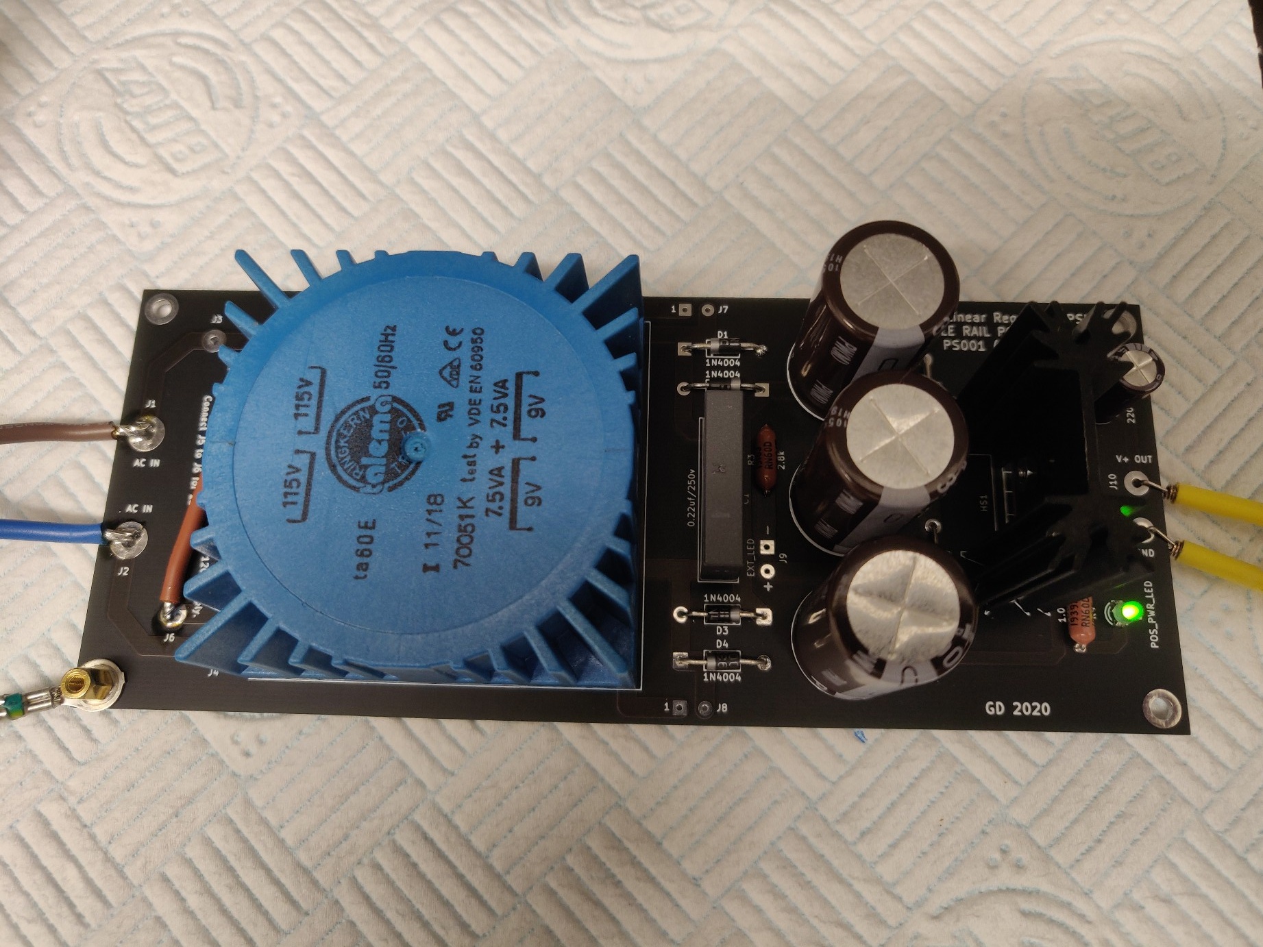

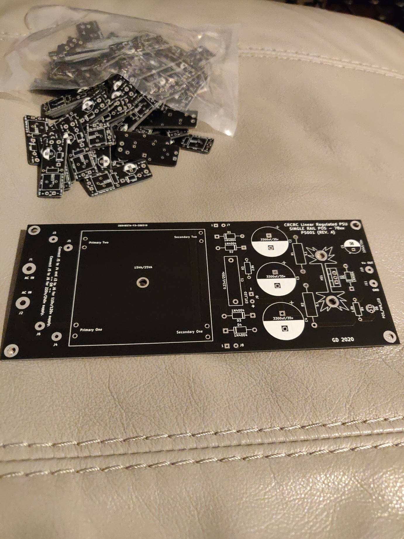

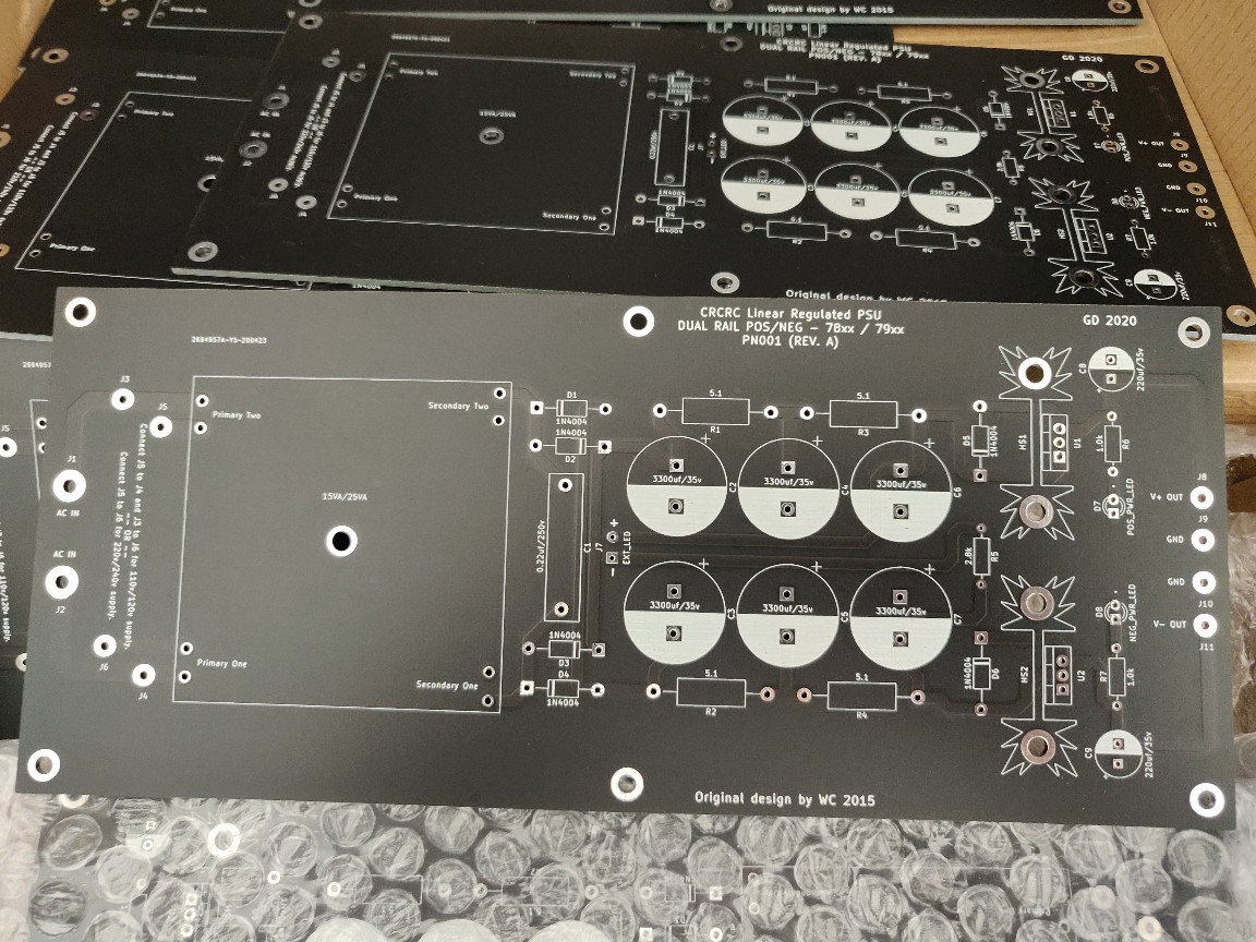

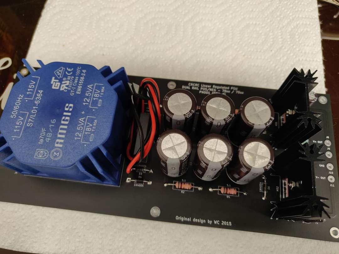

Basically the same as the whammy PSU but without the config options. LEDs near output are for dummy load. Single rail one makes my NuHybrid sound insane! I paid £180 for my scope second hand it's a 2 channel GW-Instek not a bad bit of kit.

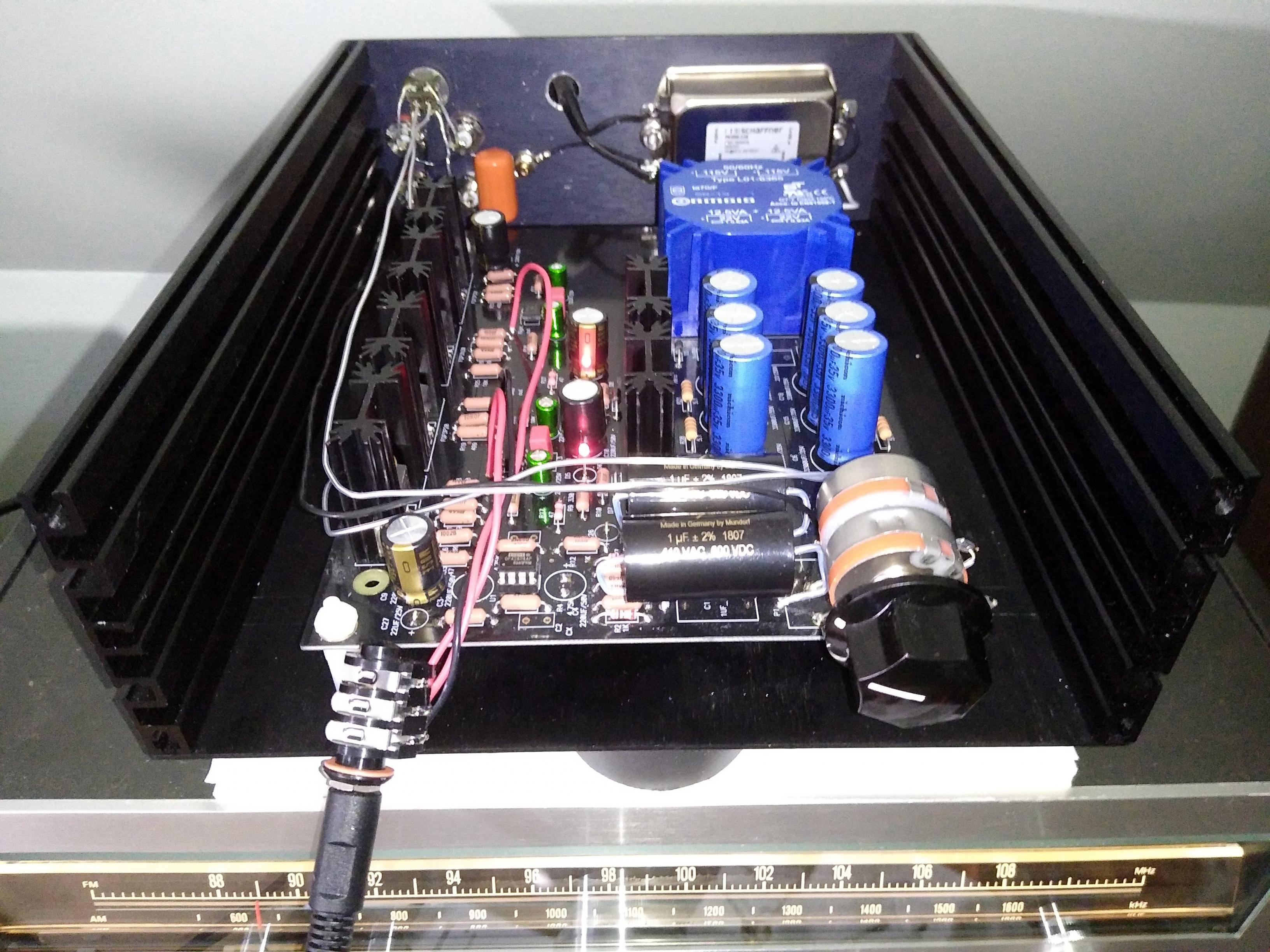

Getting there...good weekend to get some stuff done
Got some of the chassis work done...rear panel contains Cardas jacks, NKK toggle switch, and 2 stage line filter. The hole where the temporary cord goes through will be for the fuse holder and the gland/nut ingress will go below that. A 1/4" polycarbonate front panel is on the way...may institute more of the "Swatch" approach. The 2 caps guarding the OPA2604 are underneath the board to make it easier to change. Nice to be able to accommodate 2 sources without manually unplugging. Was getting a little sick of that. Can also think of a couple other cosmetic touches...like wooden sides. Have a nice piece of cocobolla that would make some nice sides...stained and highly polished maybe.Too busy listening now.
