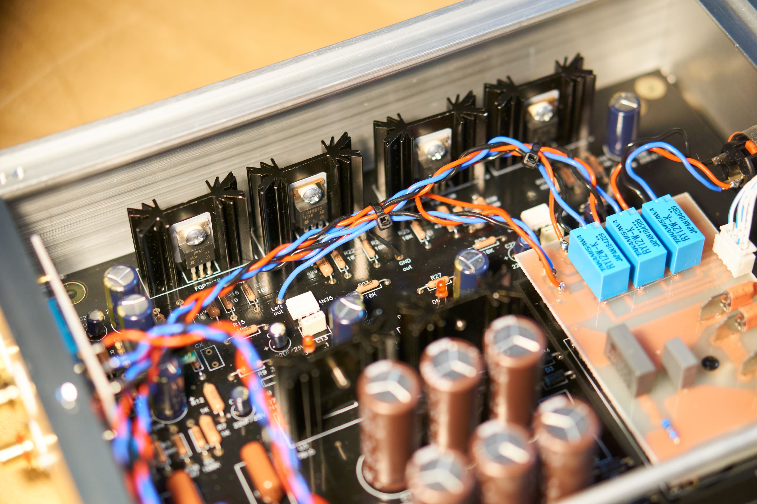

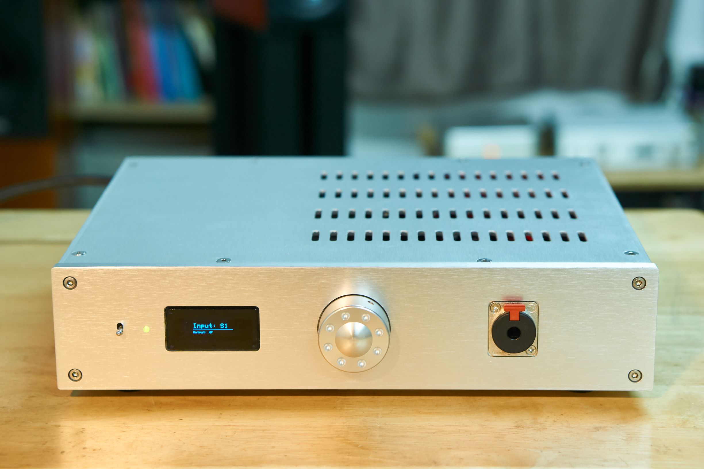

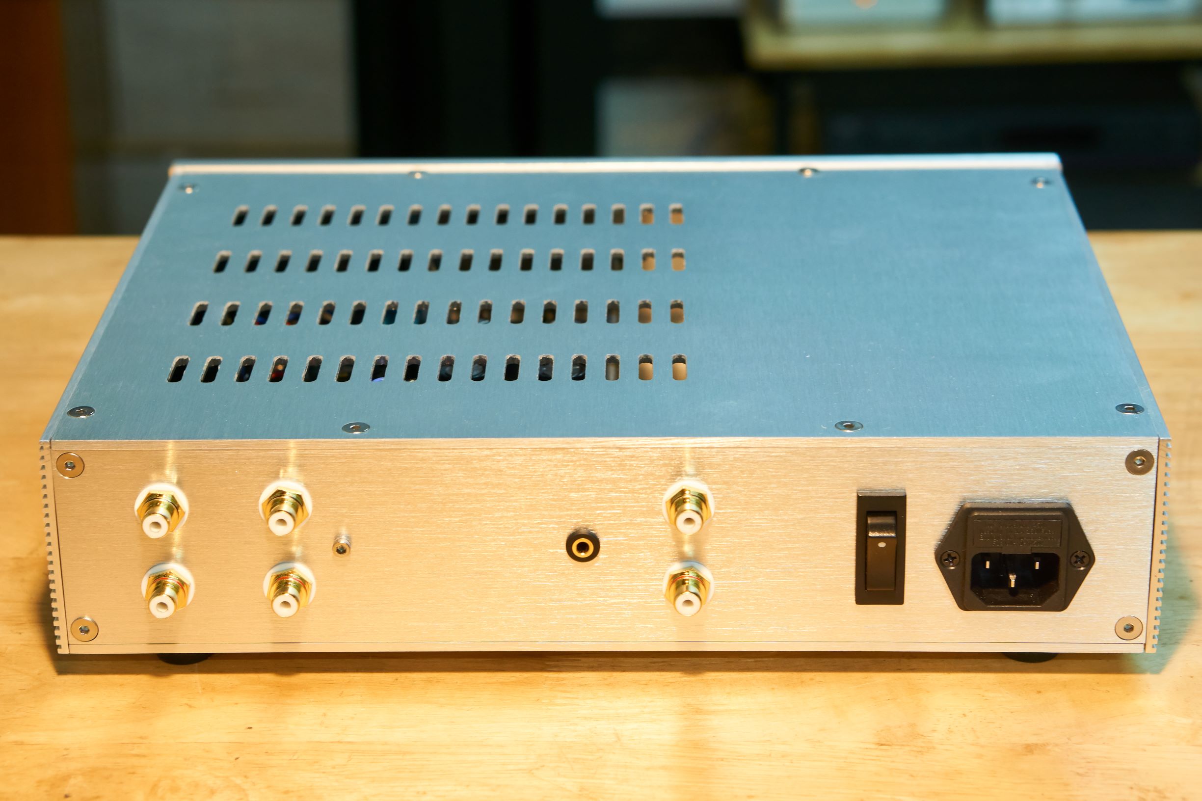

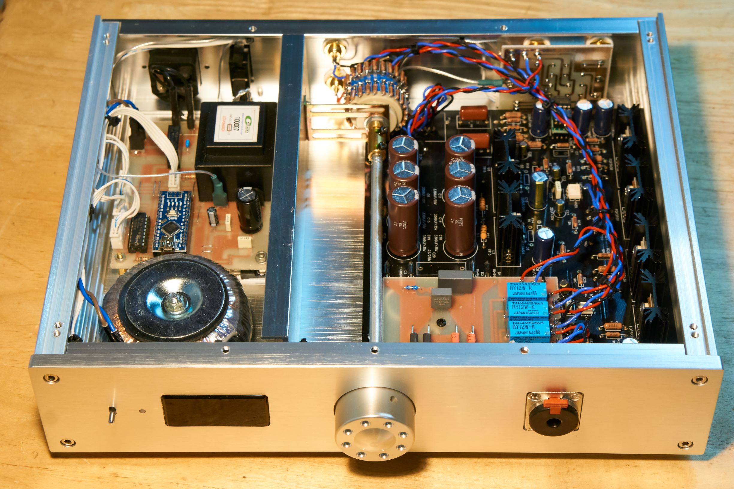

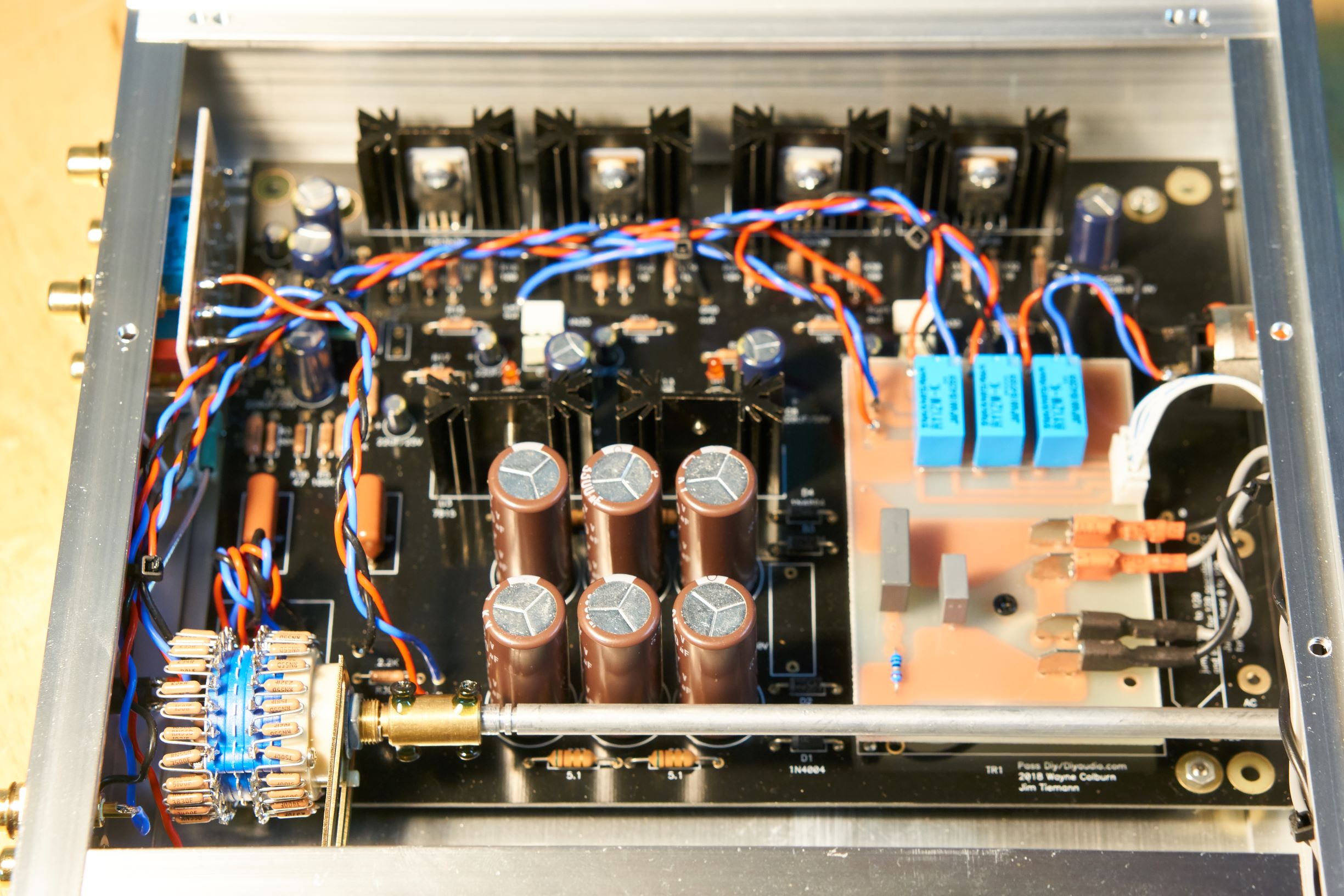

I have just finished WHAMMY with additional functions E.g. input/output selector,OLED display controlled by micro controller. It's sound wonderful, actually the sonic performance is really depends on the opamp I put in the circuit. So, I would like to put some pictures here.😛

That's excellent. You did all the things I wanted to do with mine, but have been too lazy to actually begin 😀. Specifically, a micro-controller to select 2 different inputs via relays, with auto-selection if one channel is silent and a manual override. Maybe I will get to work on it one day, but currently I am using a separate switch box. The OLED display is taking even further than I had planned. Great work!
By far the best of the 5 different headphone amps I have built. I also think the OPA2134PA is the best sounding standard DIP, reasonably priced opamp. You may never feel the need to change it.
If you eventually get adventurous, want to test your soldering skills and are willing to experiment with SOIC adapters, the OPA1612AID is my favorite for sheer listening pleasure. The OPA6156ID a close second if you prefer a more "studio monitor" analytical type of sound.
Can't agree more. I've been through 14 other opamps in the WHAMMY with long listening sessions and checklists; the OPA2134PA is the best monolithic I've tried. Some of the more expensive ones are close and some, but usually a greater price. The Burson and Sparkos Labs are worth checking out, as they are both easily a step above IMHO what you get in ANY of the monoliths.

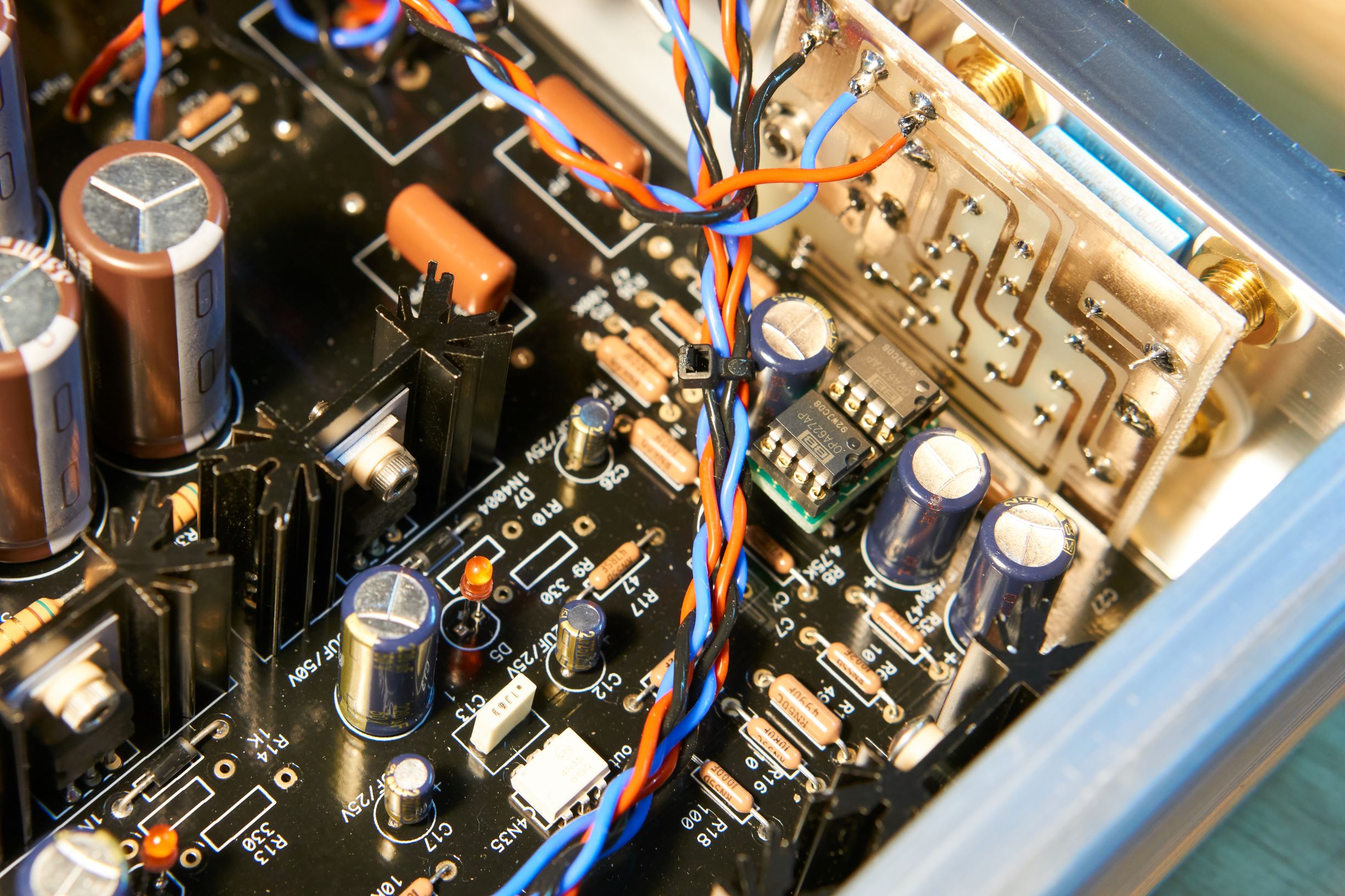

Yes, I have tried OPA627 and use it for now with WHAMMY. You can see in the picture. the sonic performance is very good.
Anyway, in my opinion, we can use a lot cheaper opa2134 to get the same sonic character with tiny down side.

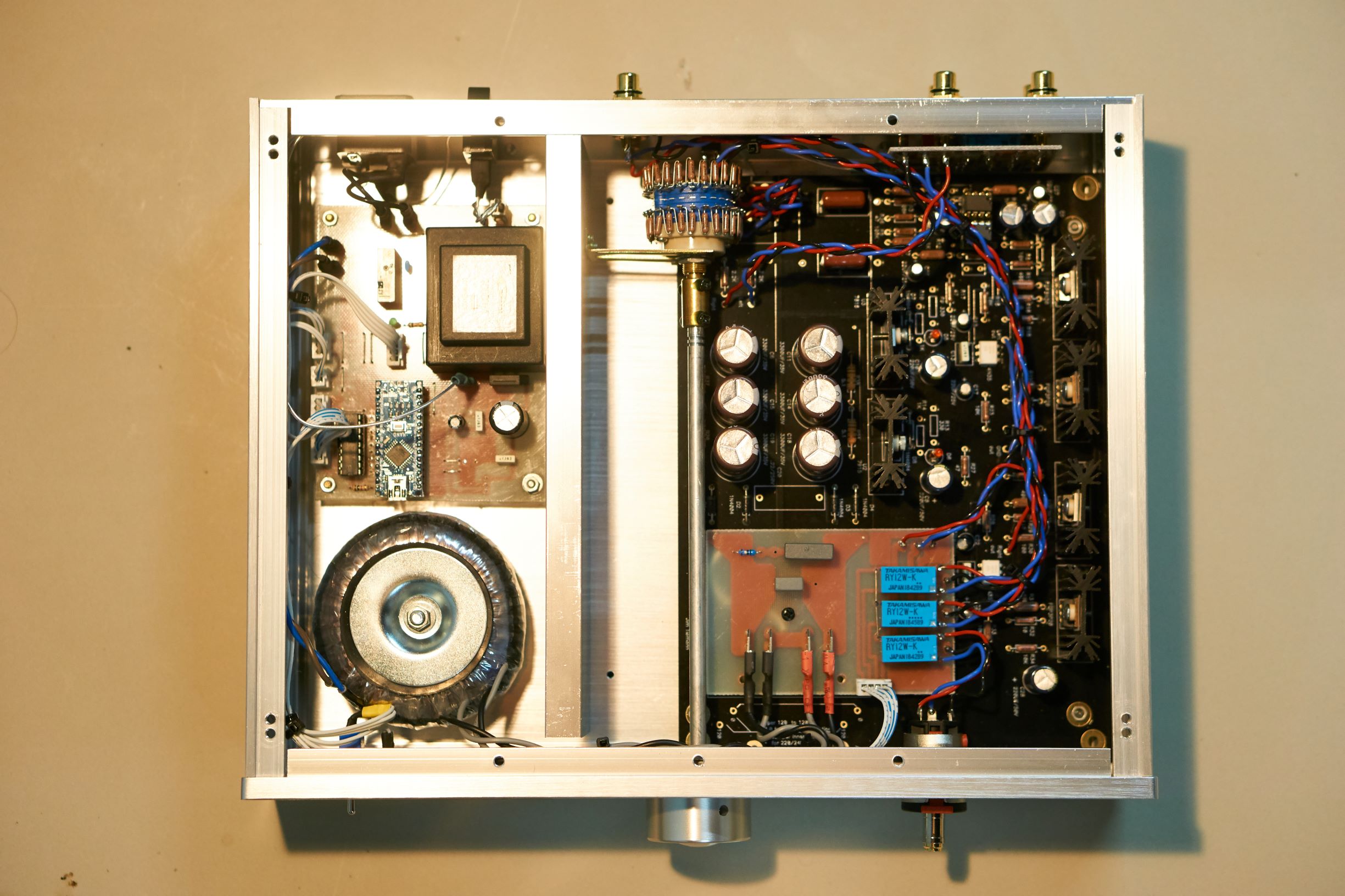

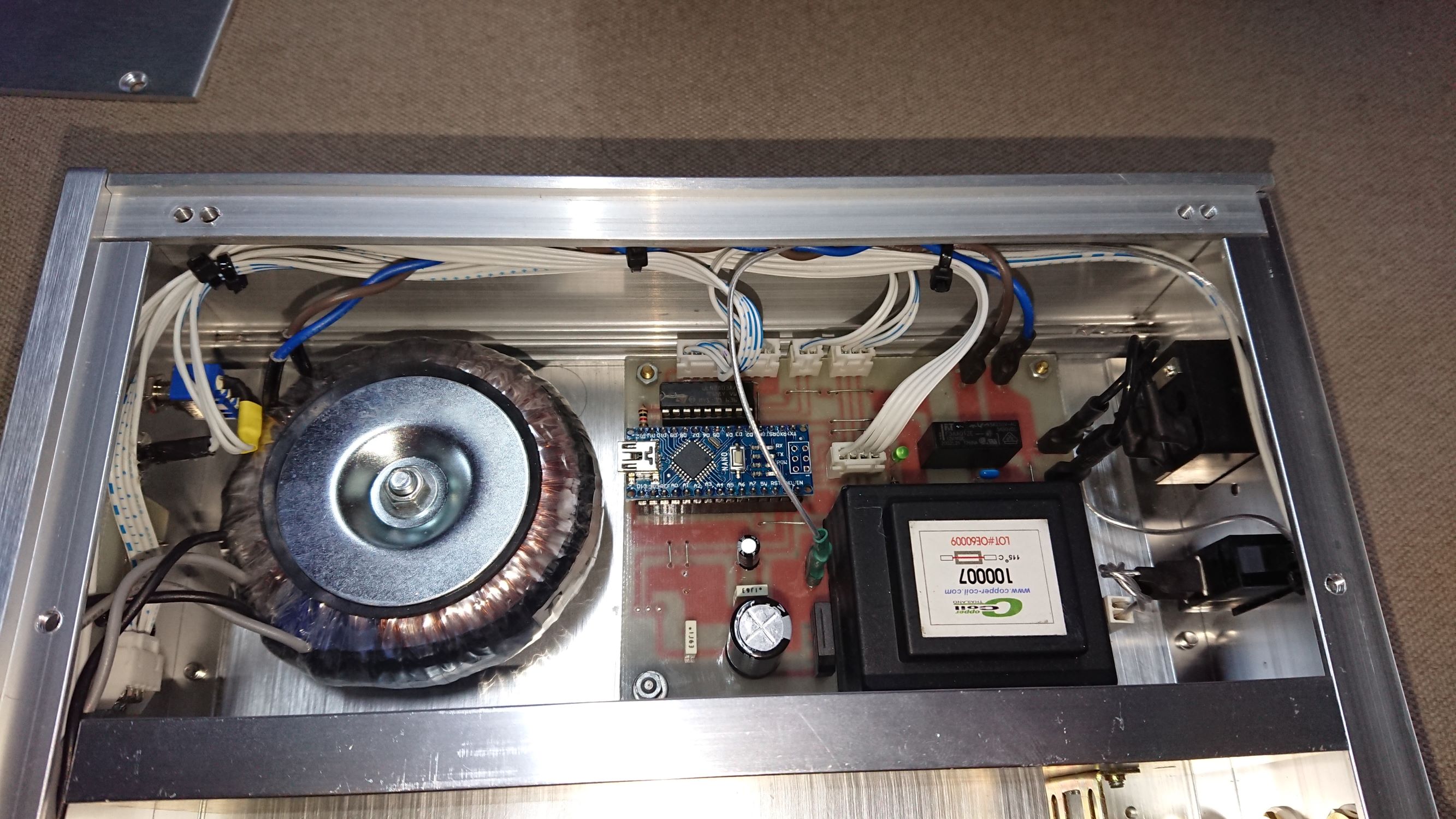

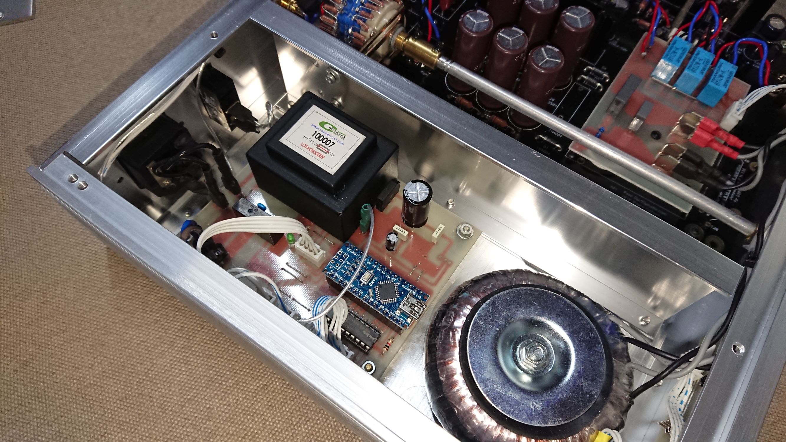

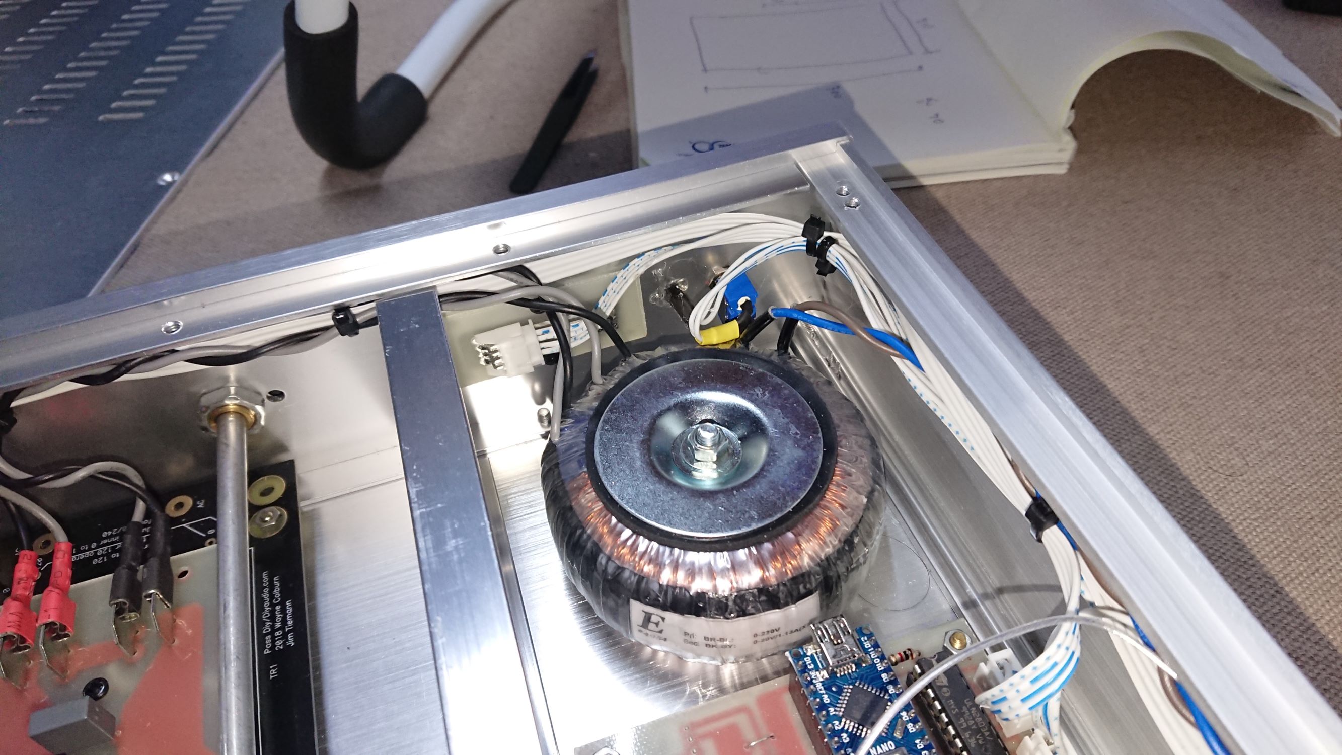

For the toroid on the side, what else are you using there? I've been contemplating a similar mode but putting the transformer in a separate enclosure (basically 2 of the same Galaxy boxes that are the standard Whammy build).
I'd love to hear about how you put together the switching relays and the front panel display too.
...but OPA627 is a single opamp and WHAMMY needs a dual opamp, right??
Do you use 2xOPA627 on some sort of adapter? On your photo it looks like standard DIP8 opamp...
TWO standard DIP-8 single op amps on an adapter board.
Ahh thanks! I haven't noticed them and was missleaded by the optocoupler... 😱

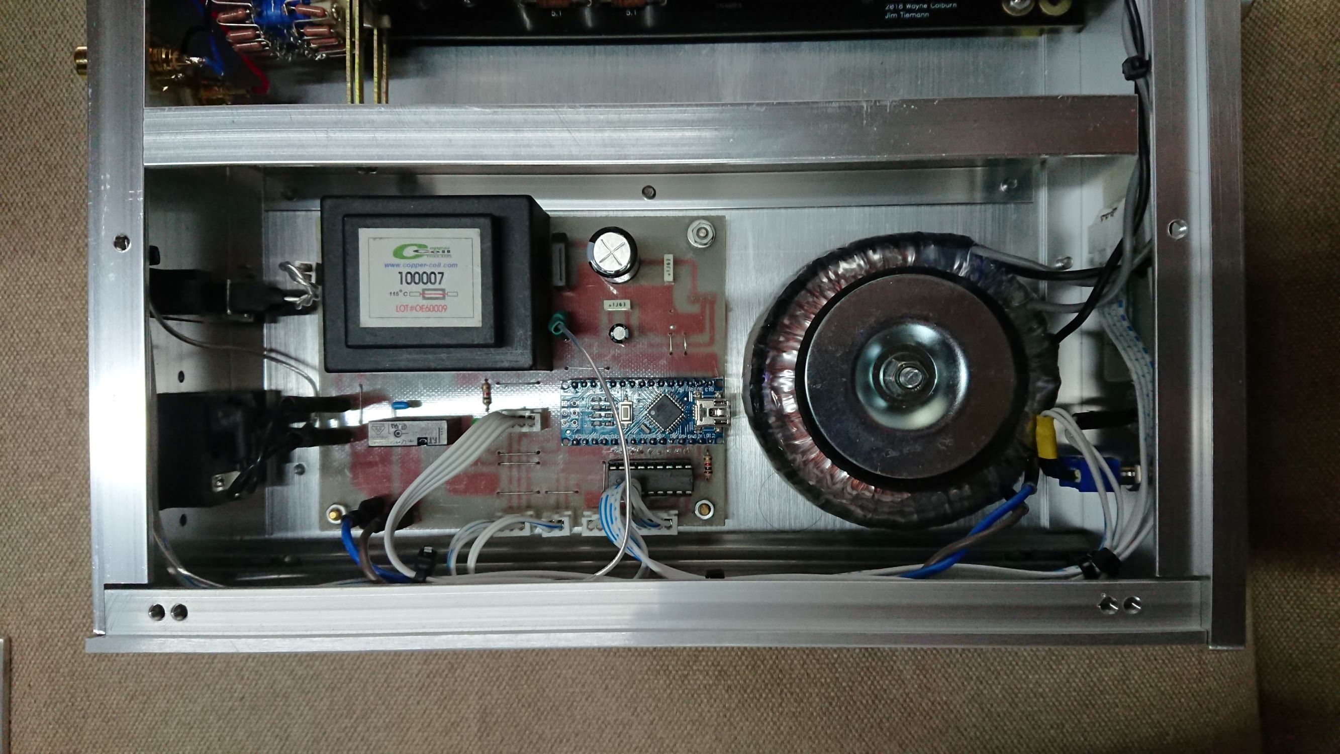

In the control compartment I put the main tranny and the control board.
Control board include the small PSU for controlling circuit, the micro-controller which is Arduino nano. and power relay for on/off the main transformer. from control board is wired to display, relay output and input board and front panel switch.
I put some pictures for you. cheers 🙂
