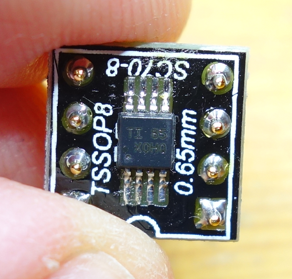

If you eventually get adventurous, want to test your soldering skills and are willing to experiment with SOIC adapters, the OPA1612AID is my favorite for sheer listening pleasure. The OPA6156ID a close second if you prefer a more "studio monitor" analytical type of sound.

I am almost finished building my WHAMMY. I expect to try an OPA1612 as well as OPA2134.
Did you guys mount C2/C7 for these two opamps?
This was the reply I get from farnell 🙁 oh wells... I'll just re-order another one I guess. Perhaps there was indeed some fault of mine in soldering? Oh wells..
"Based on the provided information, the part has undergo assembly and is not considered “fault found during 1st time usage”. Solder and assembly process exposes the part to many possibilities that may cause fault. (The part was 100% tested in factory and packed in controlled condition). Even if the part is faulty, it is very hard to proof to manufacturer it is manufacturing fault.
Additionally, the provided information does not show measured value that shows the component itself is faulty. The circuit was designed for a different opamp (OPA2604), there is a possibility of it to be unfit."

The parallel feedback caps are there for stability to prevent oscillation (extreme unexpected heat) for certain fast op-amps. It appears from experience that most op-amps are stable in the circuit, however please do take the time to find out yourself if you can.
For my own part I have used the amp for a while with no caps for C2/C7 and everything worked well. The only time I ever had an issue was when I rasised R4/R8 to 10K and used 100pF in C2/C7, my LT1028's did not like that at all!
The advice from mighty Zen Mod was to reduce C2/C7 value if R4/R8 was raised, the values are relative to each other. Right now I have 39Pf and 6.5K for R4/R8 and everything is still fine.
The only true way to see what is happening is with a scope, which I'm keeping an eye out for.
Assuming the 1612 is installed properly and it wasn’t damaged attacking it to the adaptor, if you replace the opamp with a different one, and the whammy works properly, then it’s a pretty good chance that it’s faulty.
I had similar issues when I used the SOIC adapter, and again when I used the Sparkos discrete OpAmp. Basically I hadn't seated things properly and not only saw fluctuating measurements, I also could hear the channel cutting in/out. Try reseating everything (with the power off and caps drained) and see where you are.
