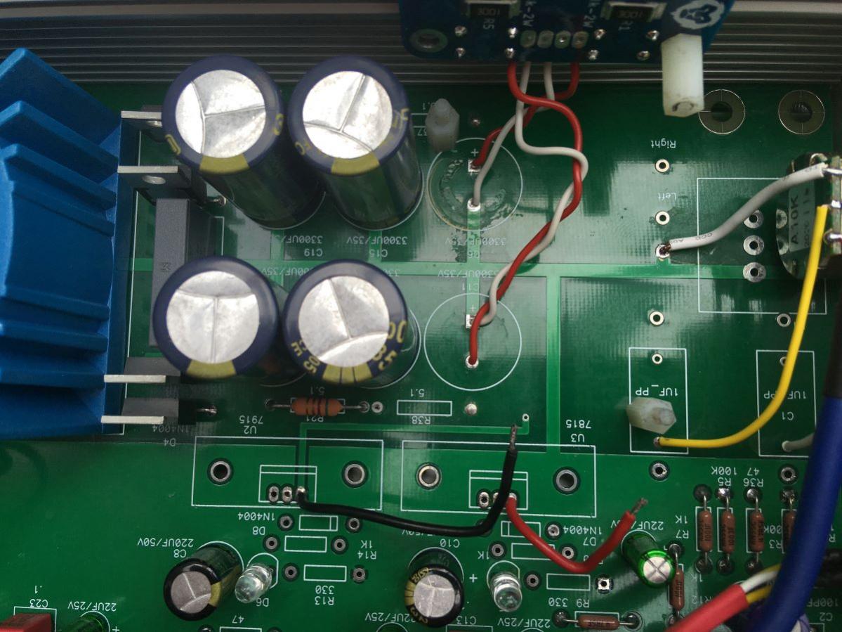

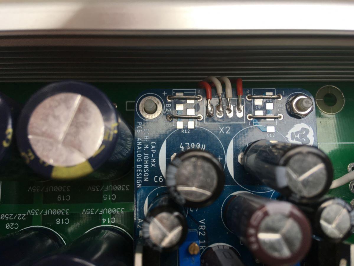

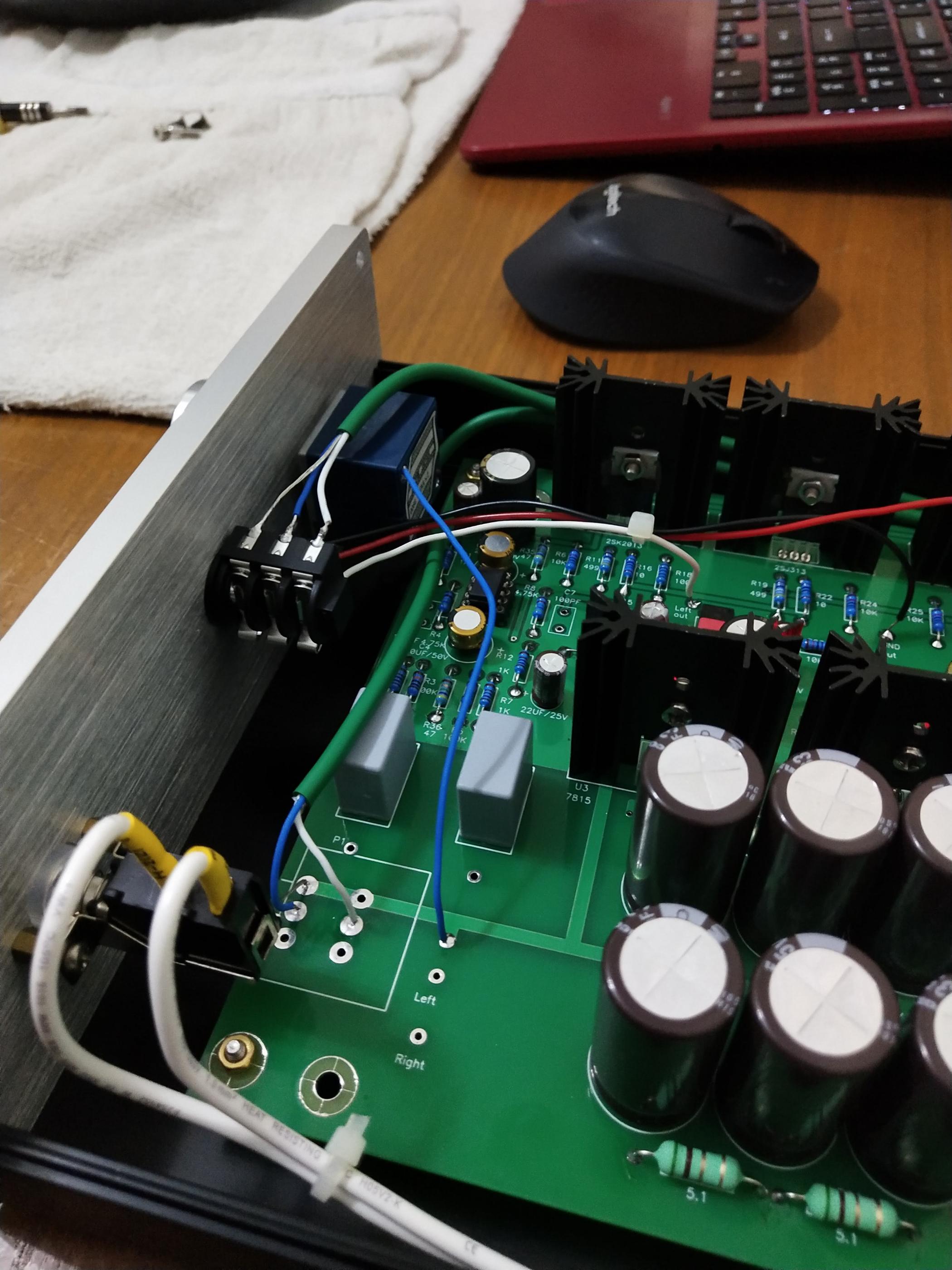

A few people have asked for Cap MX boards so I thought I would post some pics and advice regarding installation.
Before you populate the large components, remove Whammy last filter caps and resistors, solder 5.1R's back under the whammy board. Then place your CapMX board in position and mark holes in appropriate location. In the first pic you will see only two holes are required for pillars, one in each corner.
Only three wires are really needed to the capMX, pos/neg and ground.
Please note in second pic that the rectifiers have to be linked out with four resistor wires as shown, then run the DC output straight to the CapMX.
If you wanted to wire the LED's to the front panel, that is fine. They are for indication and not part of the business end.
The only critical caps are the C4/C8 1000Uf multiplier caps (will be included with boards), for the rest use what you have that will fit with correct 25V - 35V rating. Some of you are using 22V transformers will give around 30VDC into the MX board so some heatsinks on the BJT's are required maybe.
BJT's can be anything with correct pinout - TIP41/42 or BD139/140 for instance.
Hope that helps 😉

Yes I'd say so Thomas, you could run the CapMX and the standard regs from the CRC supply, the regs could power the back end while the MX board powers the op-amp for instance.

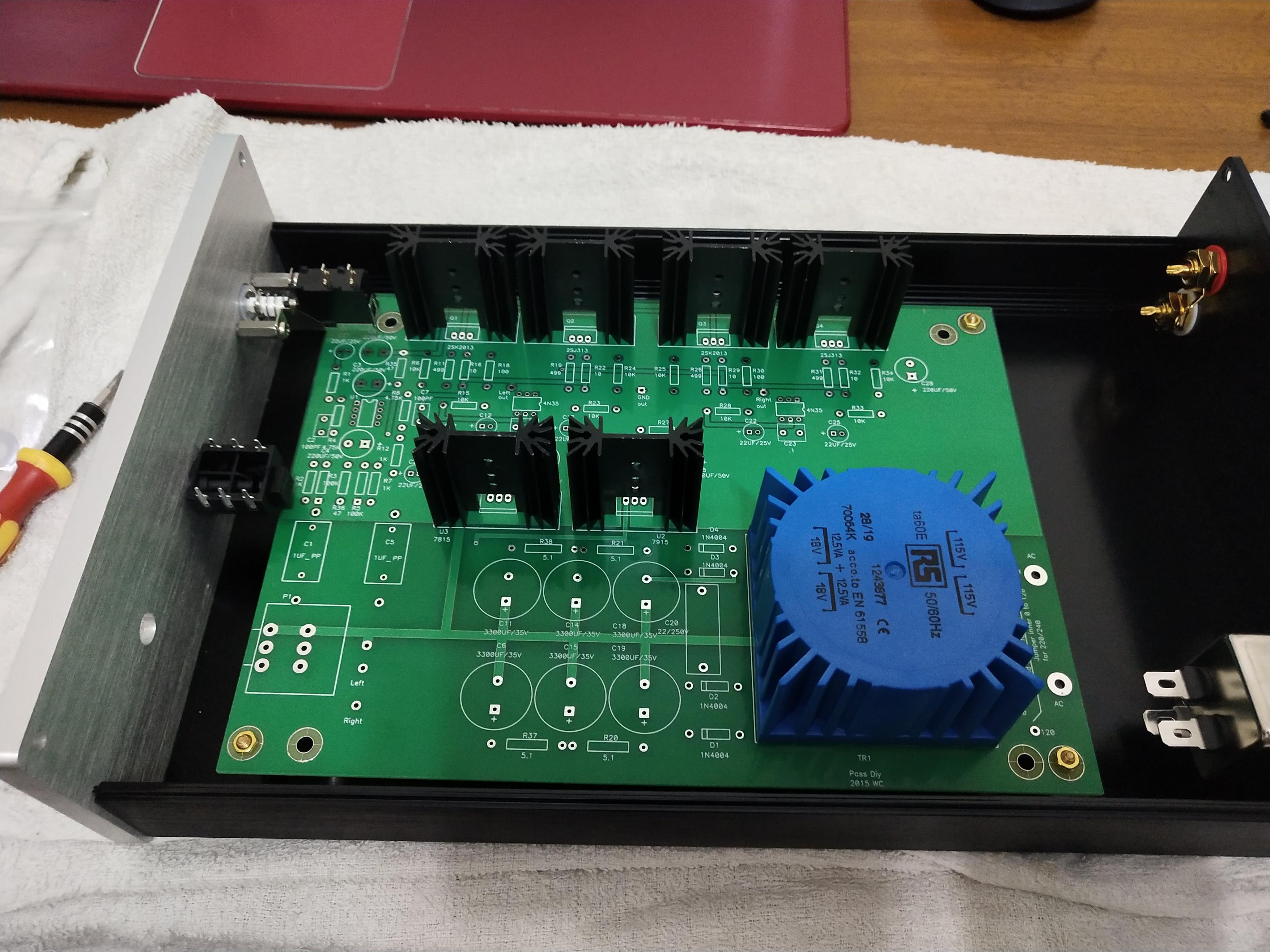

Hello Folks,
Im trying to decide if to do this build but I don't have the experience.
I built the Pearl 2 with a lot of help from Jim (thanks again Jim).
Can you guys comment on the sound quality of the amp? What is it comparable to?
What do you guys recommend?
Thank you.
-Cheers,
Fabricio

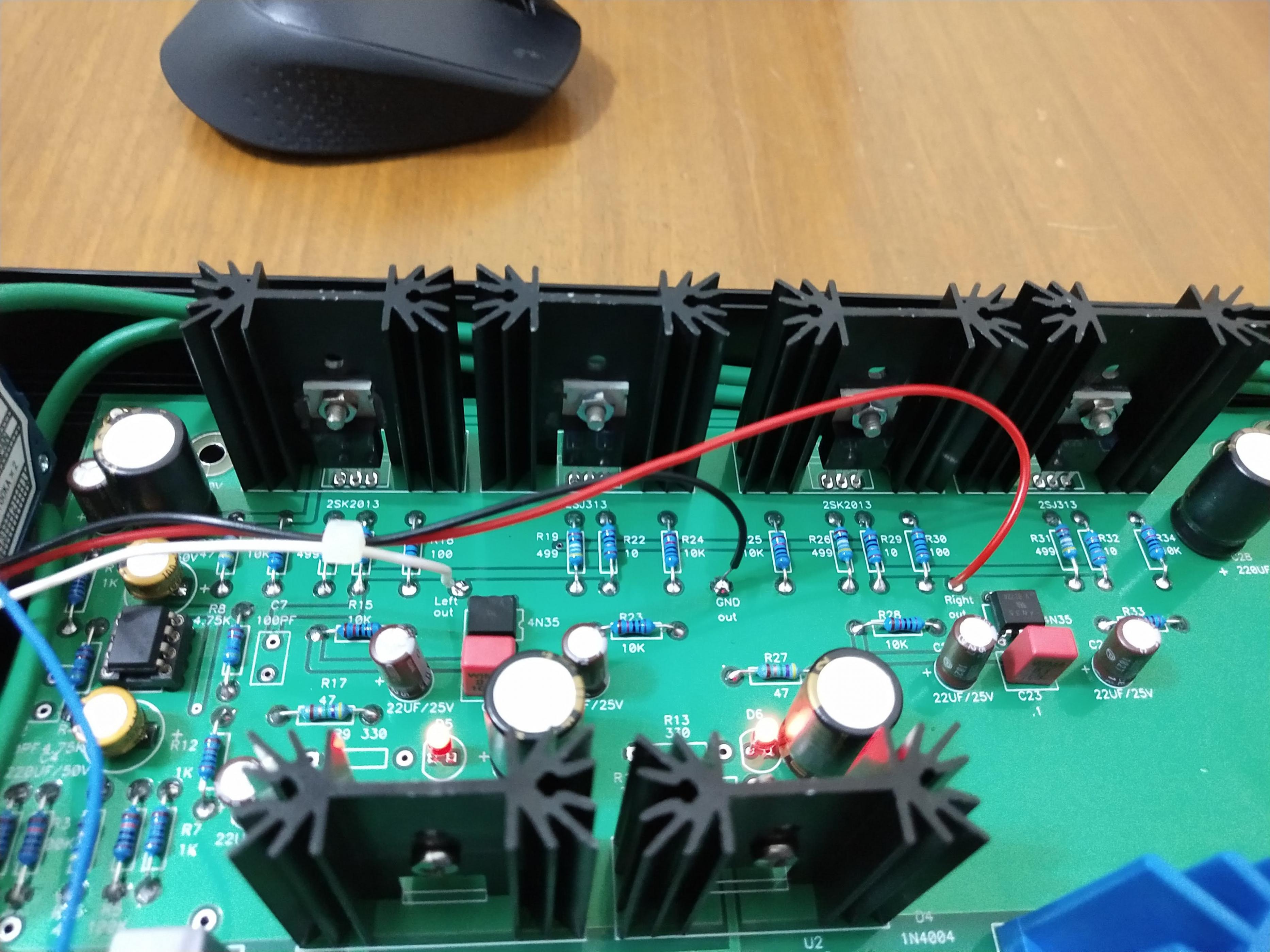

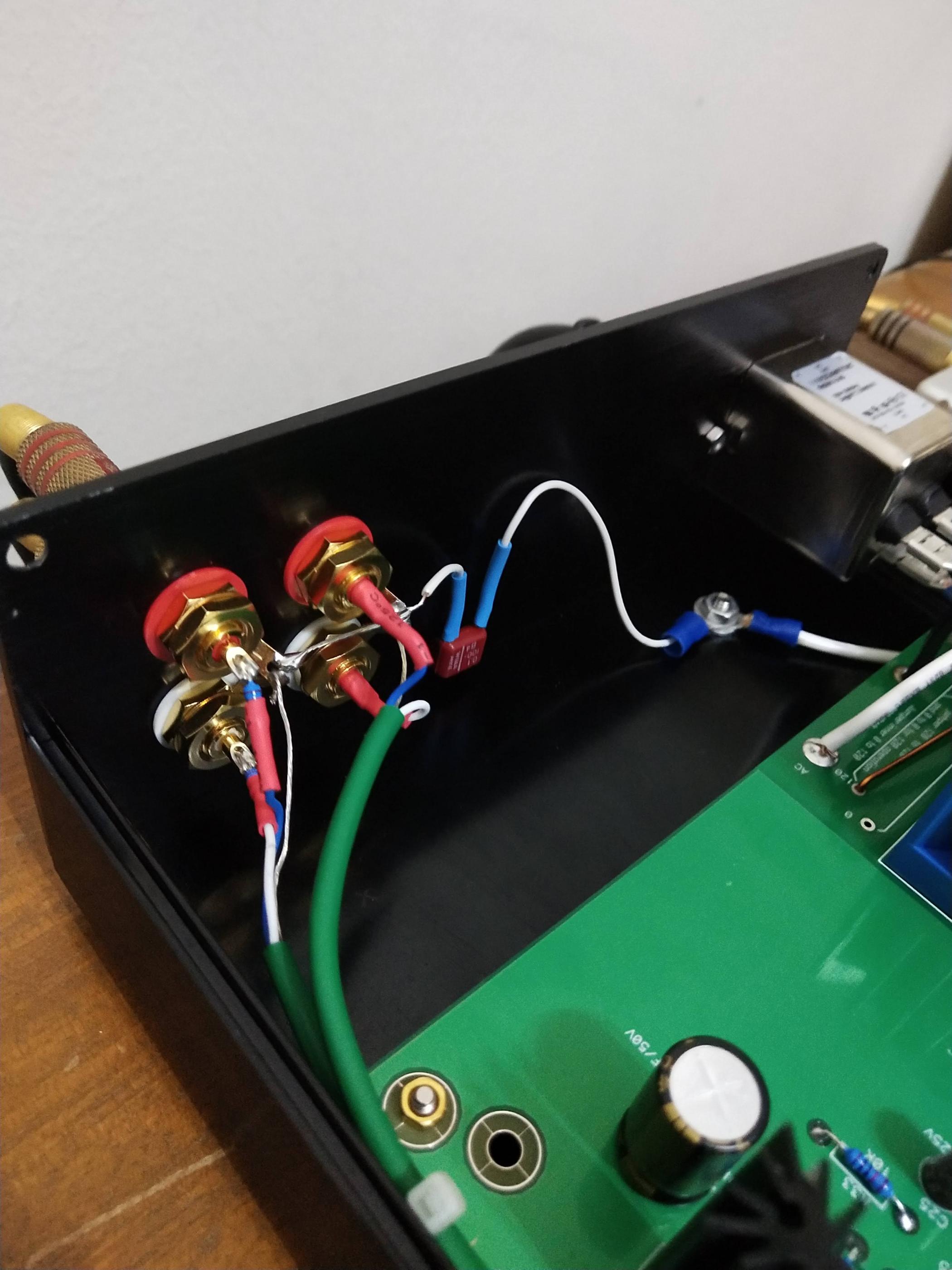

Just connect both L-/R- (pins 2 and 4) on the 4 pin XLR socket to output ground.
Out of curiosity, usually the 'ground' is actually an inverted signal. Would that ever be a problem? I assume not if this is being used as a headphone amp, but unsure if it is being used as a preamp.
For preamp out you can, (I'll need someone to correct me if I'm wrong, this is what I did with a previous headphone amp) short the -ve output to the ground. That's also what RCA to XLR cables do.

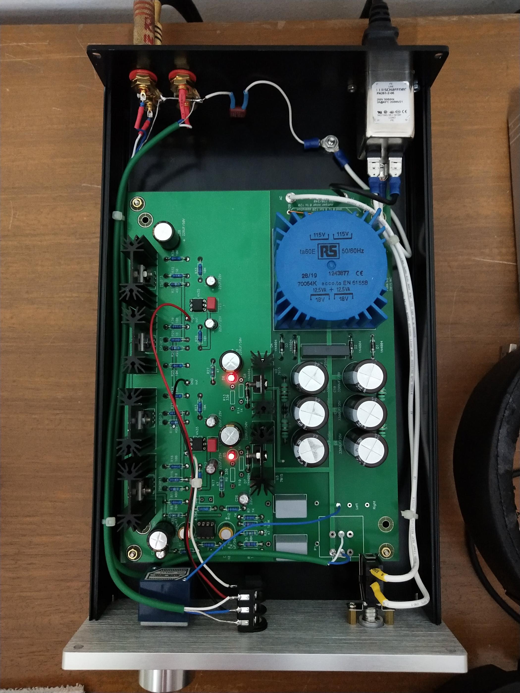

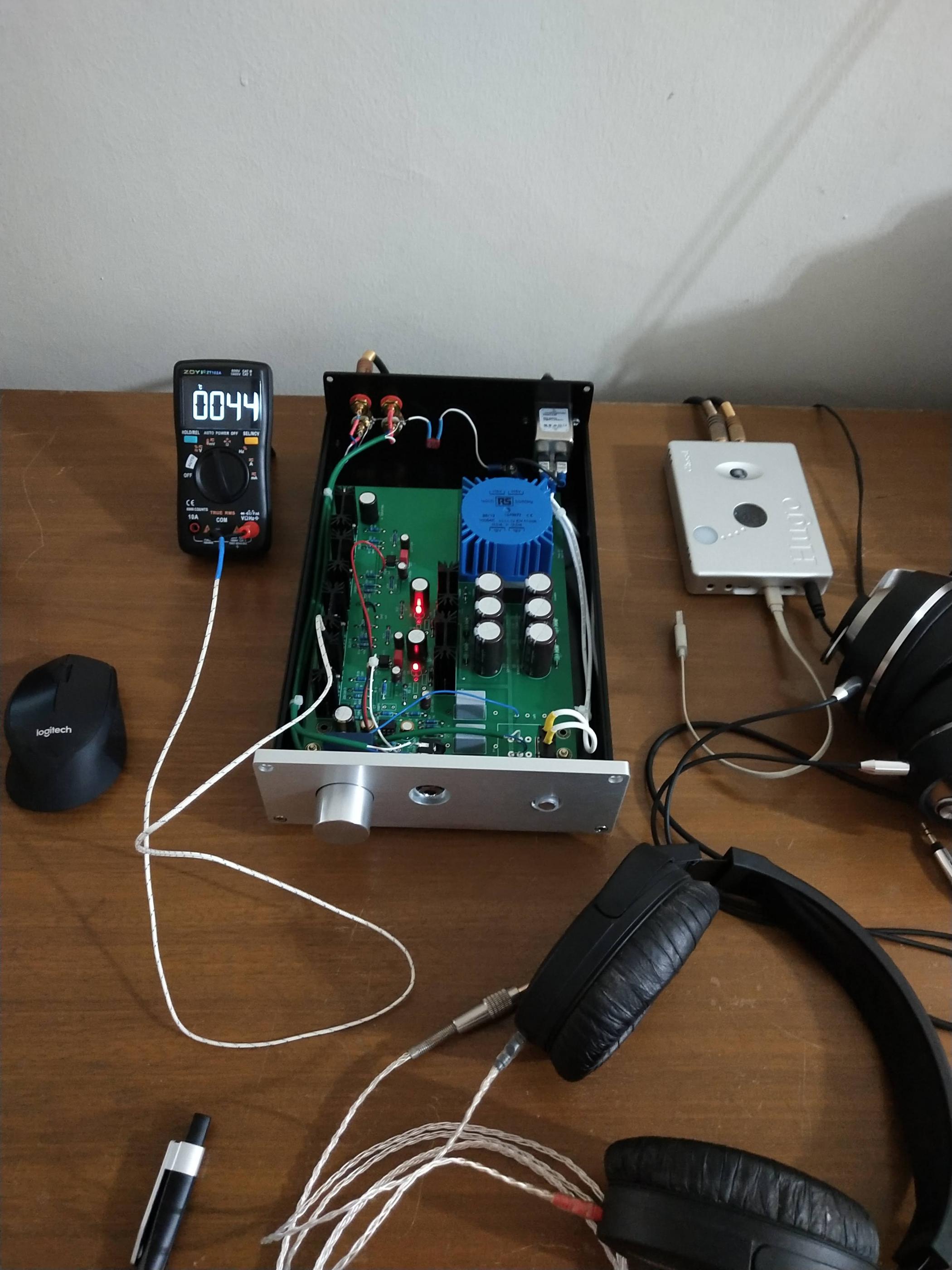

Offsets with the stock opamp is roughly ~4-5mV on both channels, matched perfectly too. Decided to swap it out with the Burson V5, went down to ~0.1-0.3mV on both channels.
Running on 18V transformers with 10 ohm resistors the bias is 56.2mA. Heatsinks running at cool 43 celcius (109.4 fahrenheit).
Everything sounds correct. What a fun build.
Just to be clear, am I inserting two ground wires into the hole of the PC board where it says ground and then inserting one of each wire in pins 2 and 4? Can you please explain this a bit more? I want to make sure I get it properly installed.
If you're planning to use headphones with a 4 pin XLR, yes that's the way.
Much appreciated good sir!
