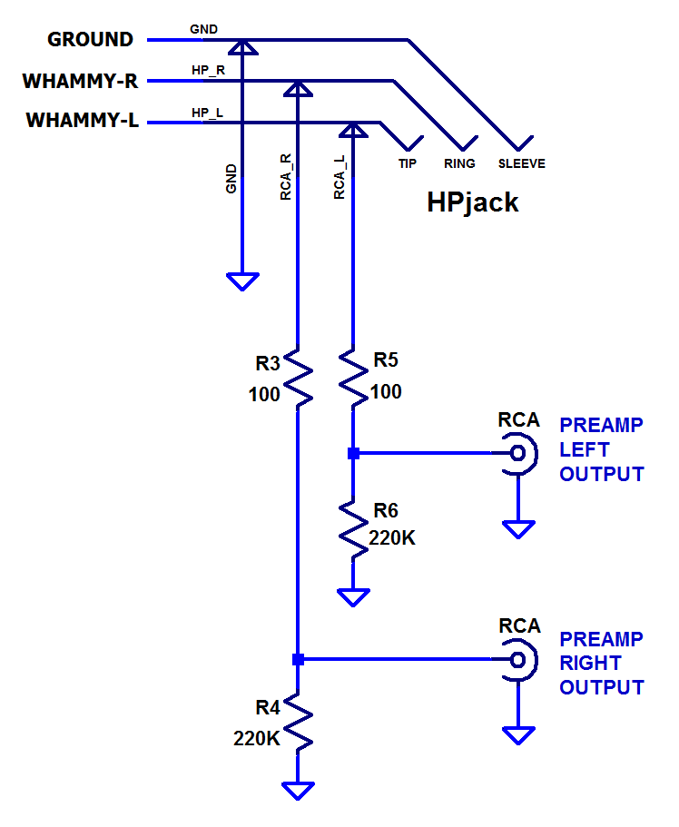

I received a Private Message from a member, who is considering building a modified WHAMMY that includes a switched headphone jack and "preamp output" RCA connectors. S/he asked a bunch of questions which, in my opinion, are best discussed in the Forum where everybody can participate and learn.
The builder is thinking about using an arrangement similar to the one used by the Noir headphone amp from the DIYA Store; schematic below.
In this arrangement, the switched headphone jack (a Neutrik NMJ6HFD2) connects the WHAMMY outputs to the RCA jacks if, and only if, there is no headphone plug inserted. However, when a headphone plug IS inserted, the WHAMMY outputs are disconnected from the RCA jacks; the signal path is interrupted.
I'm sure the builder would love to have the opinions of other Forum members, about this sort of idea. Perhaps including, but certainly not limited to,
Thank you to everyone!
- Is this a reasonable idea? Does it have hidden (or obvious!) flaws?
- Are the 100 ohm resistors really necessary? Or can they be eliminated? What's the optimum resistance value?
- Are the 220K ohm resistors really necessary? What's the optimum resistance value?
- What are some other options for switching headphone jack functions? Are they preferable to this one?
