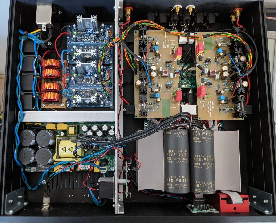

I'm running the double WHAMMY boards as a pre-amp for Purifi class-D power amps. As these power modules like a good drive I'm using the circuits as is and did not include any more series output resistance than the already existing 10ohm resistors in MOSFET stage.
I have also short circuited both C1/C5 and C26/C27... as no capacitor is better than arguing which capacitor sounds better. DC offset at power amp output is < 8mV, which I deem perfectly fine and safe.
Switching the output via a 6.5mm plug contacts should also be just fine.

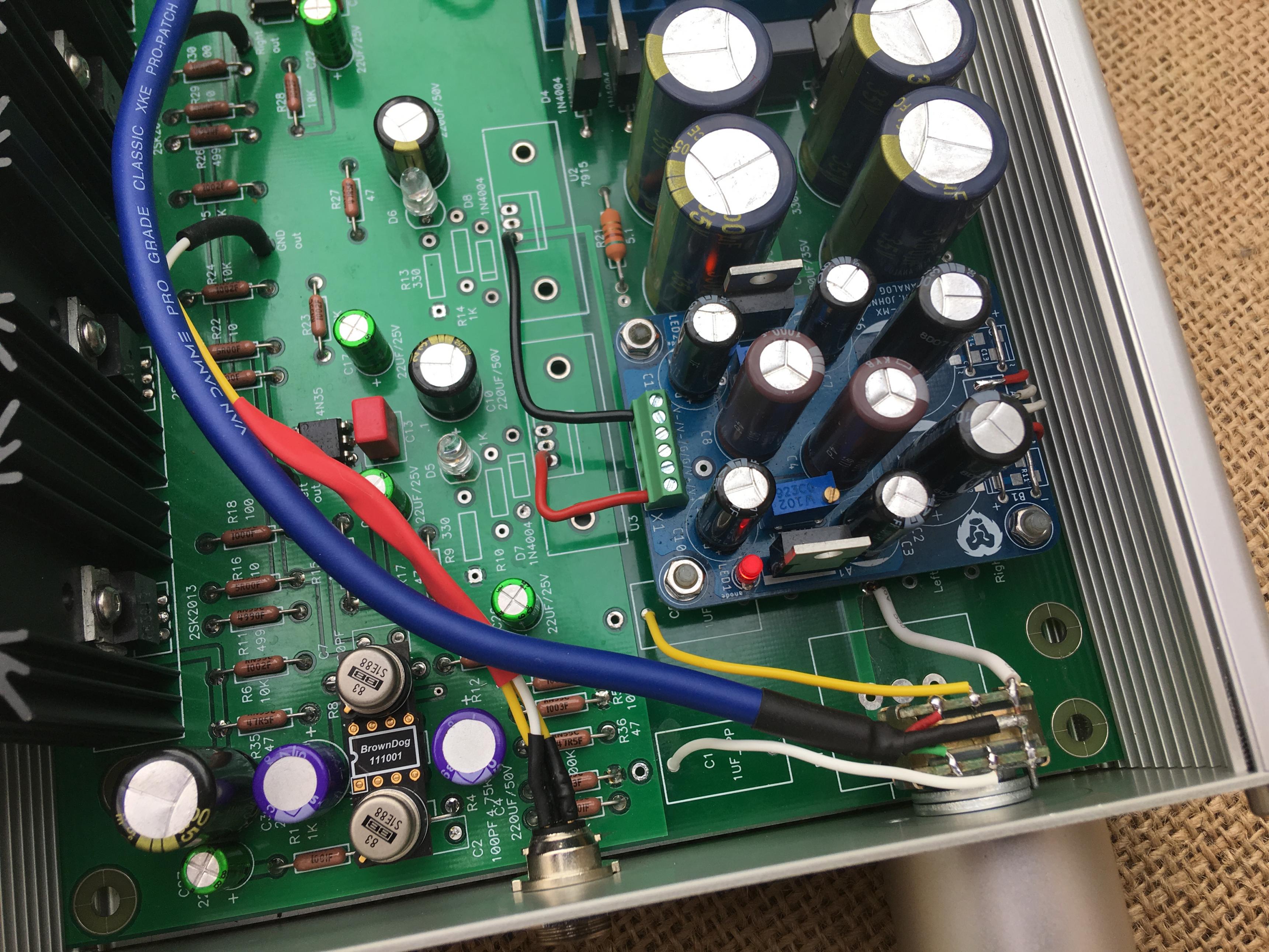

I wanted to follow up on this in case anyone else was interested in trying the Sparkos regulators. They are indeed drop-in replacements and handle the same specs as the 7815/19s that are used in the 'stock' Whammy PS (+/- 15VDC @ 1.5amps max). I ordered some and will use them in my second Whammy build. I'll report back on the impact after I've had some time to listen/measure things.
I took a look at the Sparkos regulators last night based on the thread here and have a simple question as it is not obvious from their data sheet: are these drop in replacements for the 7815/19s (i.e.: pin for pin and resistor/bypass caps) ? The data sheet discusses recommendations for certain types of caps to be attached close to the regulators.
The other question is: is it worth the hassle/cost? I can say for sure that their dual-discrete opamps are in the Whammy. The only discrete I found at a similar level of quality are the Burson ones, but at that point its a matter of taste - which is half of why I am personally obsessed with this stuff! 🙂

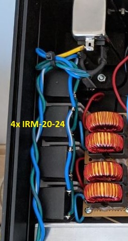

I have two questions as I am looking into building a Whammy with a dedicated, external power supply using DiyAudio Super Regulator boards and it looks like you are essentially doing this here:
1) The Whammy needs regulated +/- 15VDC @ 1.5A, and the base build for the Super Regulator is setup for 1A operation. What mods did you need to do to handle that added current requirement?
2) Where did you connect the outputs of the SuperRegulator into the Whammy circuit? Its hard to tell from the photos.
3) It appears you added some inductors ahead of the super regulator. What did you use and what are the advantages? Adding L to supplies is often debated here, and the consensus was to use CRCRC as sufficiently low noise/etc... so I am curious to understand.

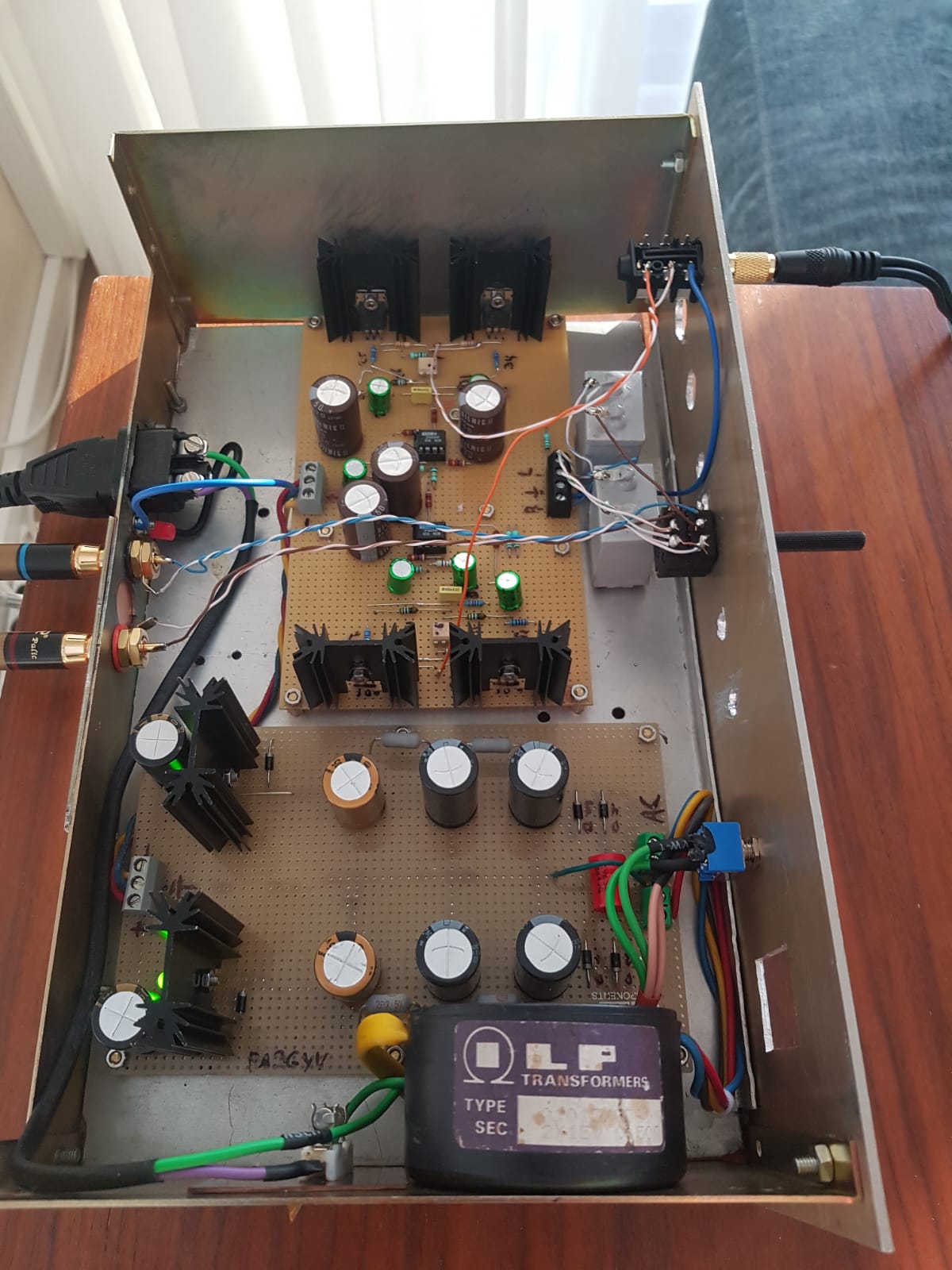

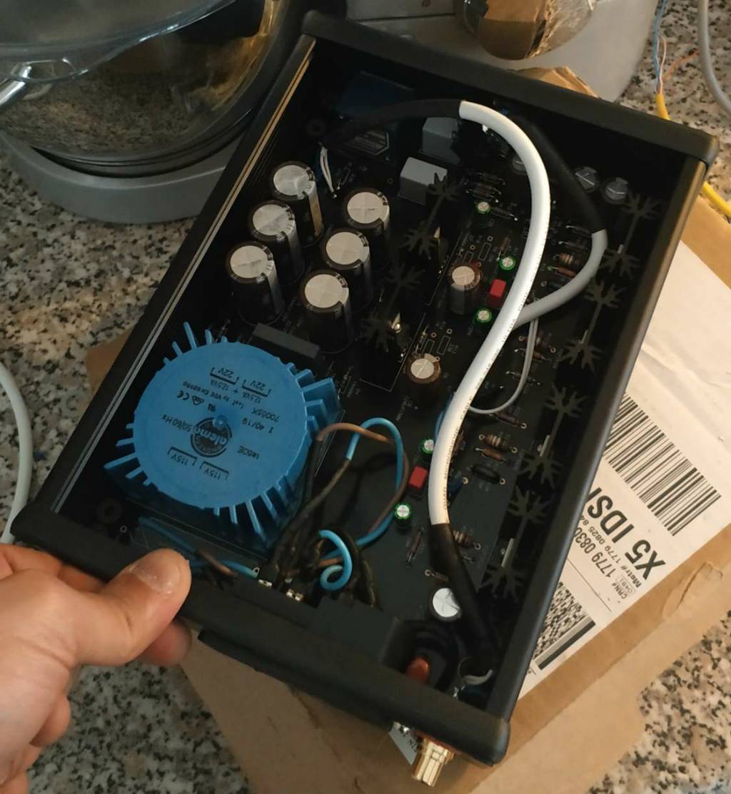

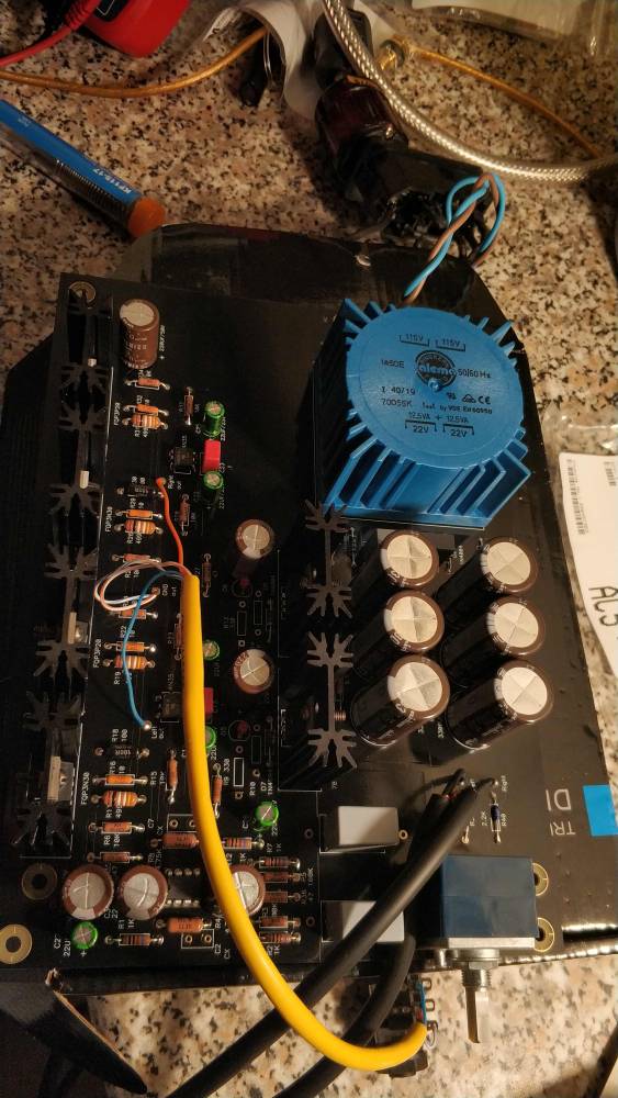

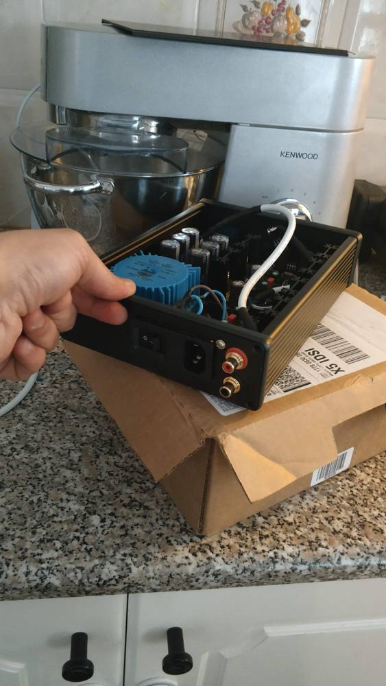

I couldn’t wait for the pcb to arrive so I started the project with parts I had already laying around. I made this one dual op amp because I had a couple of opa604’s and will do tests with opamps like the AD797, OPA1611.
Have to finish the housing (cosmetic), arrange the wiring and replace the potmeter with a blue Alps potmeter.
For now I’m listening with a HD6xx headphone, the thing is death silent, no hum whatsoever. Dynamic, open, detailed. I could listen for hours. Will do some comparison (by ear) with my Sjostrom QRV08 amp.

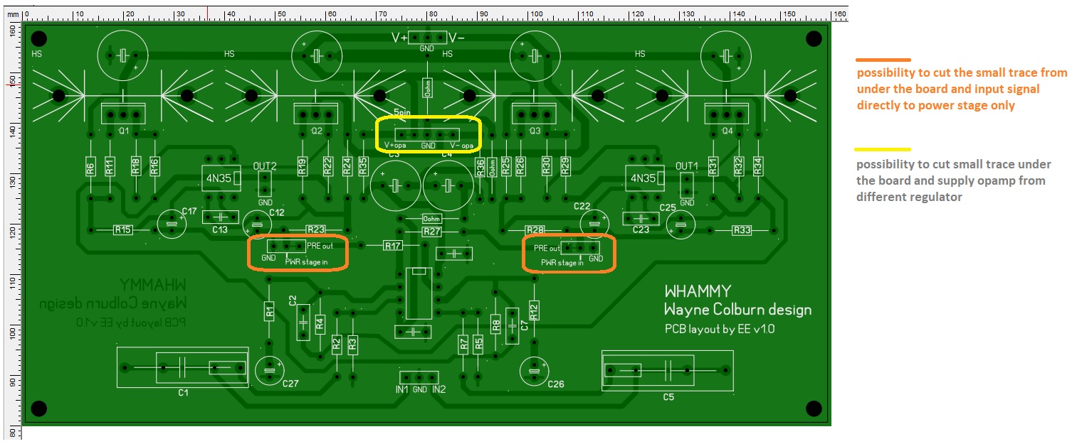

The PCB is a self drawn custom version - power goes in from mid edge of the board behind heat sinks.
The Super Regulators are exactly as per original schematic - just the heat sinks are 51mm tall if I recall correctly. No problems for those to run one 2 channel board each.
I have 4 MeanWell IRM-20-24 AC/DC converters powering the SuperRegulators. I had those coils in parts bin for year bought for a project I never did, so I though it would be good to use those.
