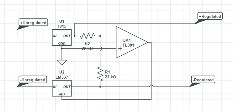

I suppose something like this could also be possible, just an inverted voltage follower. Then any positive/negative voltage regulator could be used and the negative output would just be inverted positive voltage out(This schematic isn't complete and is missing complimentary components):

Thanks for the effort, but that is beyond my ability. the normal voltage control with LM317 / 337 is not a problem, but from that I have too little clue.
Do you have a link to an example or a diagram?
I still have a board with LM317 / 337 and an LF353, which I will test on the Whammy in the next few weeks.

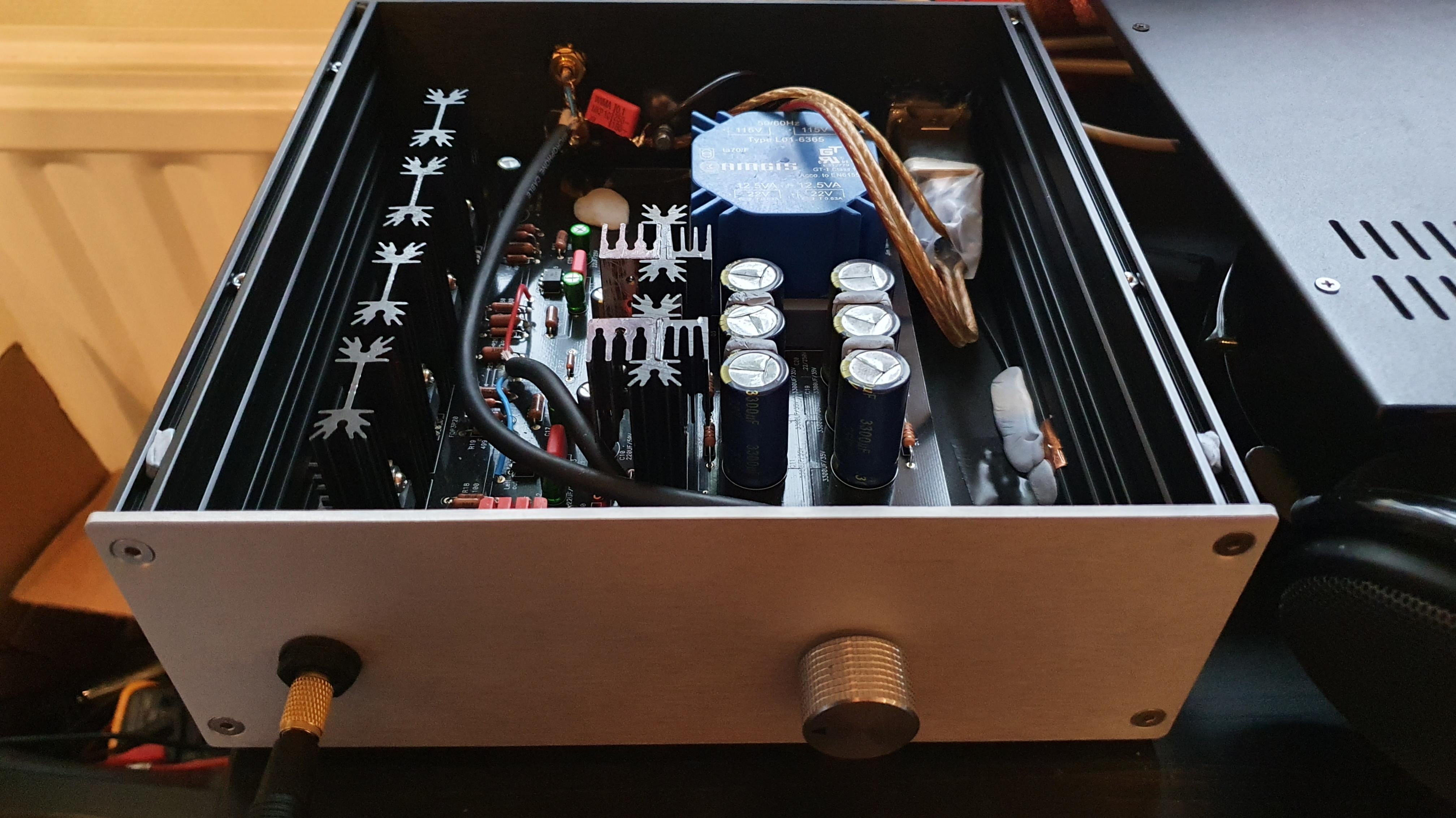

My Whammy got ready tonight and works fine.
However, I have slightly different regulated voltages on the + / - rail, + = 16.63v and - = 16.91v.
I built the Configuration 2 - “LED reference” and used Motorola MC7815CV / MC7915CV as a voltage regulator.
I measured the regulator before installation and the 7815 has an output voltage of 14.91v and the 7915 has 15.19v, so it is clear that the difference of +/- comes from the voltage regulator.
What can I do to get the same +/- voltage? Without filtering voltage regulators.
Hi Roland,
You shouldn't be concerned about the small differences in your rail voltages.
Your + rail will start to clip sooner than your - rail as the audio level is increased but that isn't a practical problem since we don't listen to these amplifiers anywhere near the point where they stop amplifying and start clipping.

Hi Mike, I'm not worried because I've measured worse for expensive commercial products. Of course also with cheap ones .
The difference in voltages is the same in all states. Nothing changes, whether at idle or under "high" load.
I just want to have a perfect symmetrical as possible voltage at the OP Amp and the amplifier to produce also no unnecessary DC offset.
It is a mixture of pedantry and fun in the matter.
