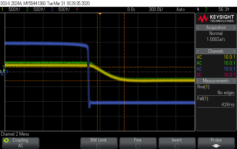

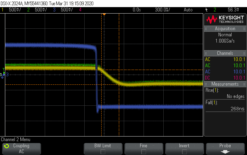

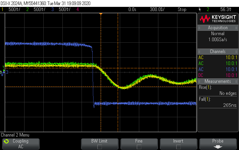

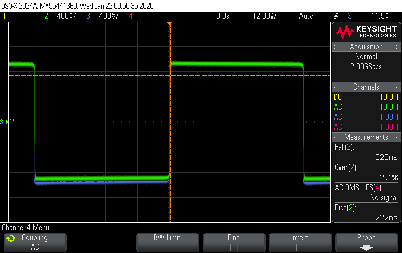

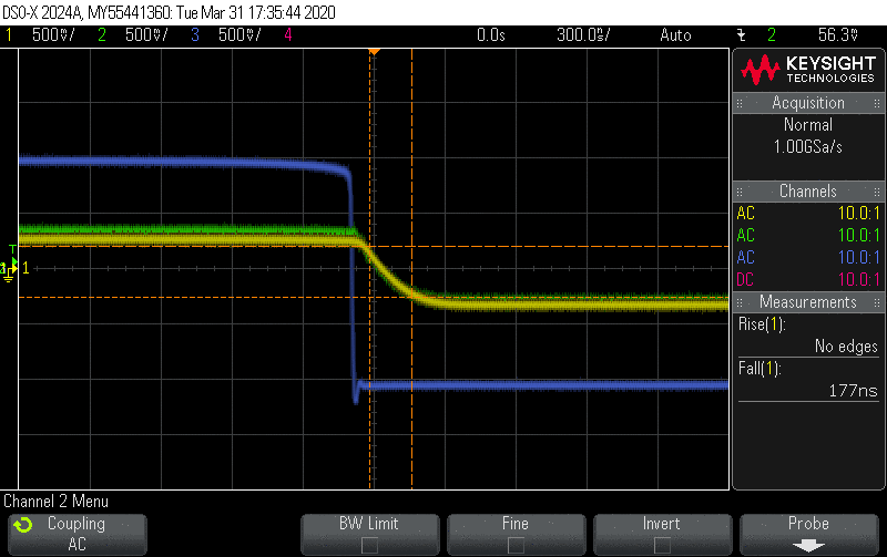

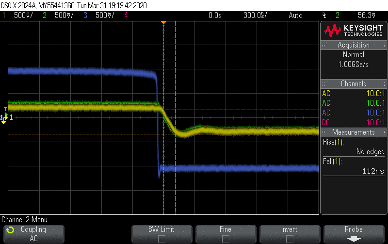

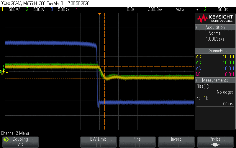

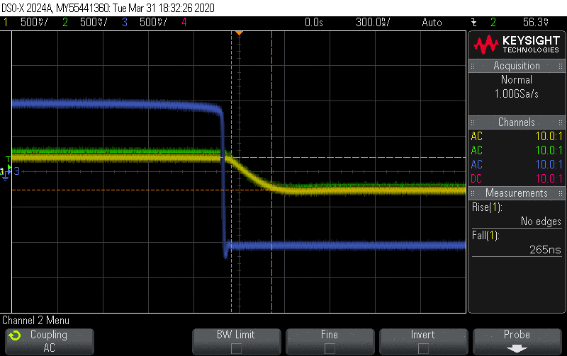

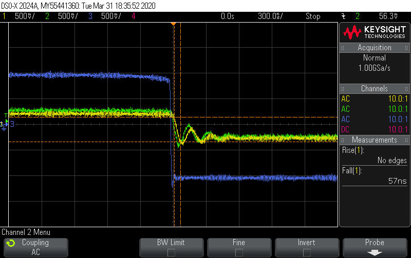

I created GIFs of how different Op Amps in my WHAMMY behave on transients, at different pot volumes.
Zooming on the (boring) 10kHz square wave, I noticed some major differences in the way each Op Amp transitions, which should be insignificant since the time constants involved are way above audible range, but I found some correlations between my subjective evaluations and the measurements below:
Blue - Signal generator (amp input)
Green - Op Amp Output
Yellow - Mosfet output (amp output)
Interesting to note how the LME49720 is a "try hard"
Subjectively, I prefer V6 vivid, then OPA2107 and OPA1642.
This V6 vivid seems to have 2 slew rates, the fast (25V/us) works at low levels, and the slow (4.5V/us) works at higher levels. Fun! no?
LME49720 has a gritty / itchy treble to my ears, and on the opposite, V6 classic lacks details and micro dynamics which makes it too boring.
OPA2156 seems to break loose when level increases too much (see glitch).
For other measurements like THD/IMD/noise etc, see my website in signature.

Very interesting Martigane, thanks for your time and effort. The subjective results graphic on your site is nice, looks like the 1642 is the best all rounder while the 49720 is the most laid back. For the money OPA1642 is a good one for sure.

Yes, LME49720 sounds laid back , and OPA1642 is great for the price!
My favorite was OPA2107 (deep and dynamic bass, very nice extended highs without harshness), until I received V6 vivid which sounded the most balanced and dynamic, but sounded a bit harsh.. until I upgrade to a better DAC where it is now outstanding!
It' s as other poeple say, it will reveal a lot from source/recordings, so one might prefer a more relaxed experience.

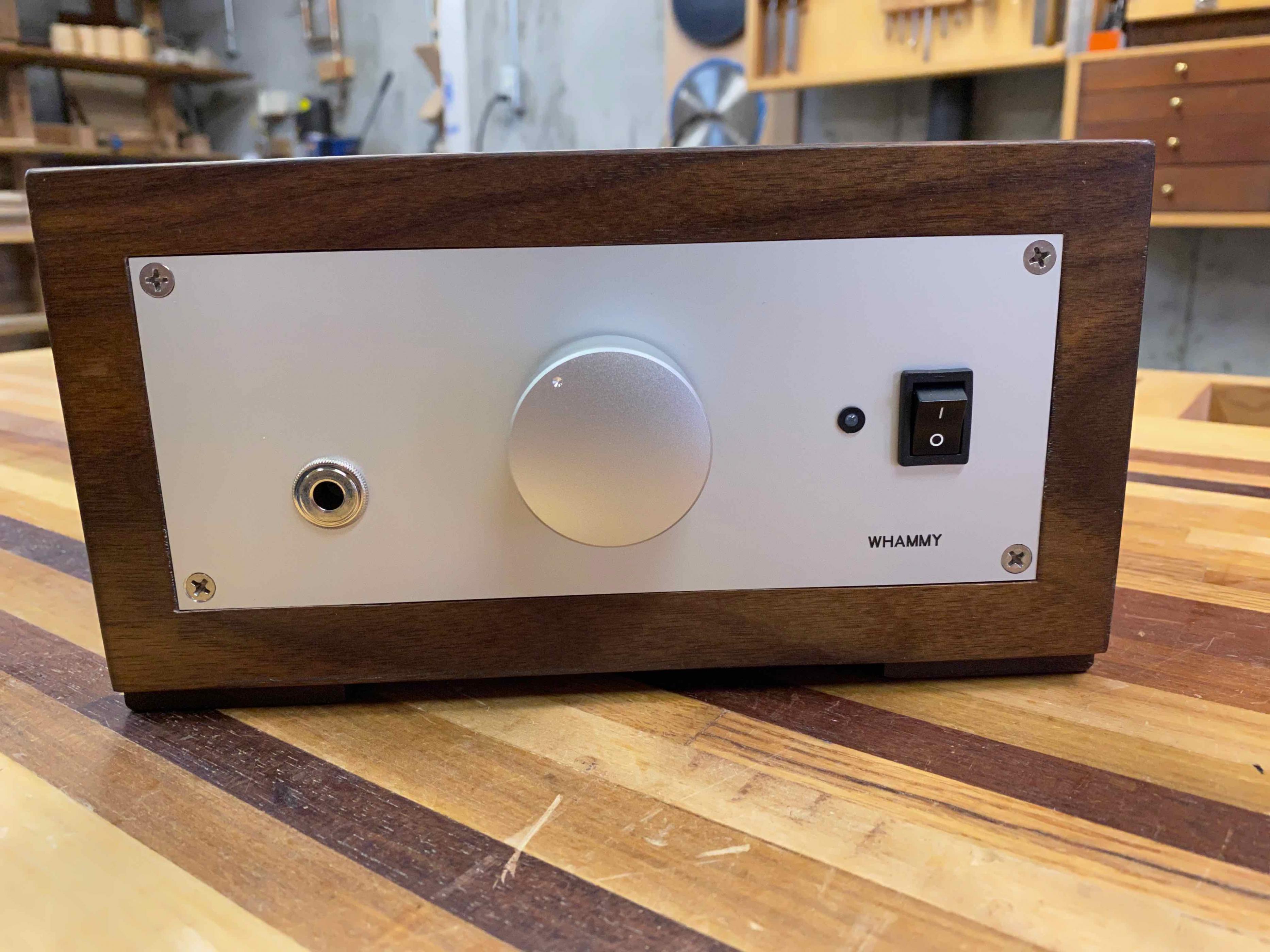

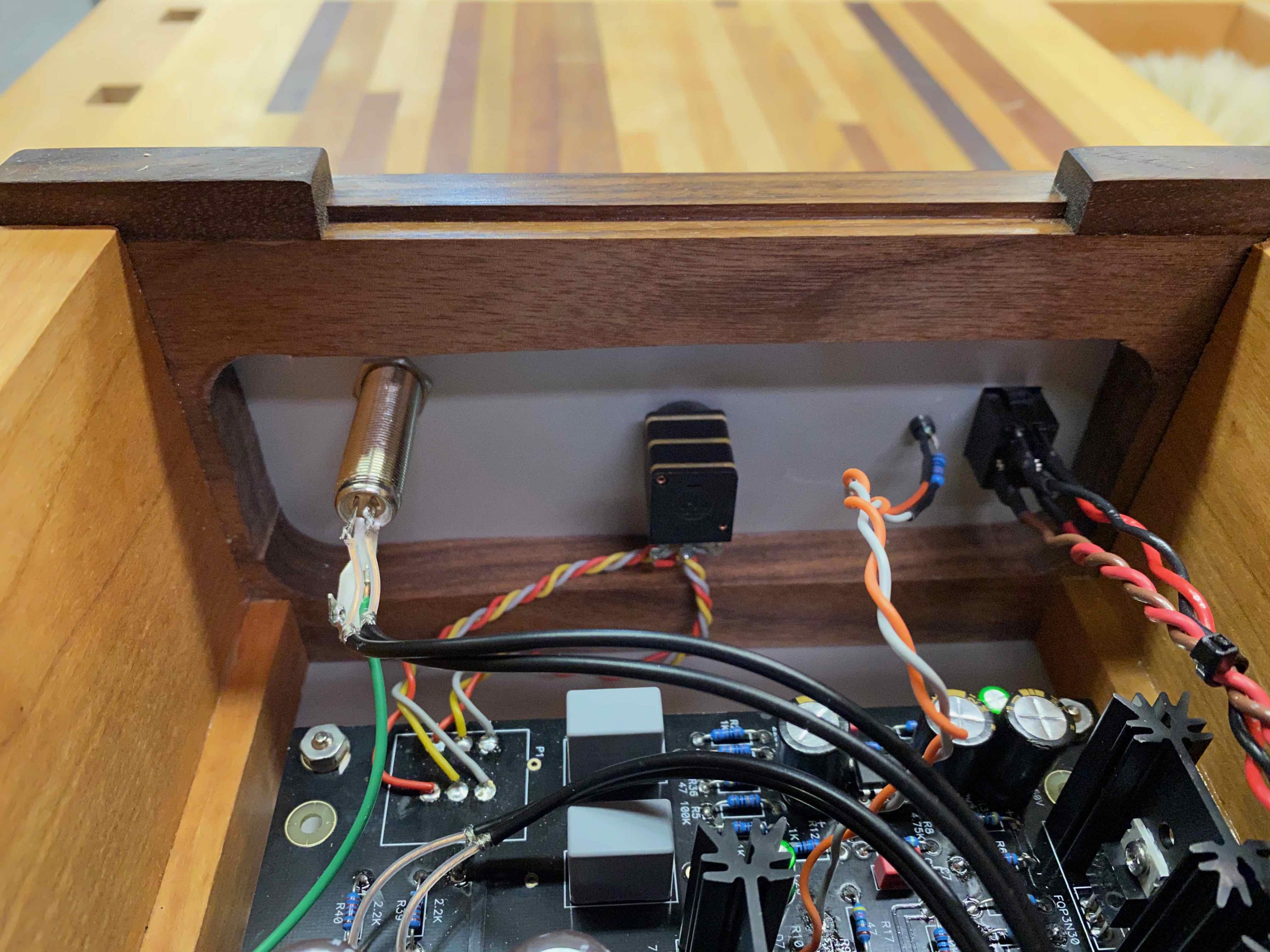

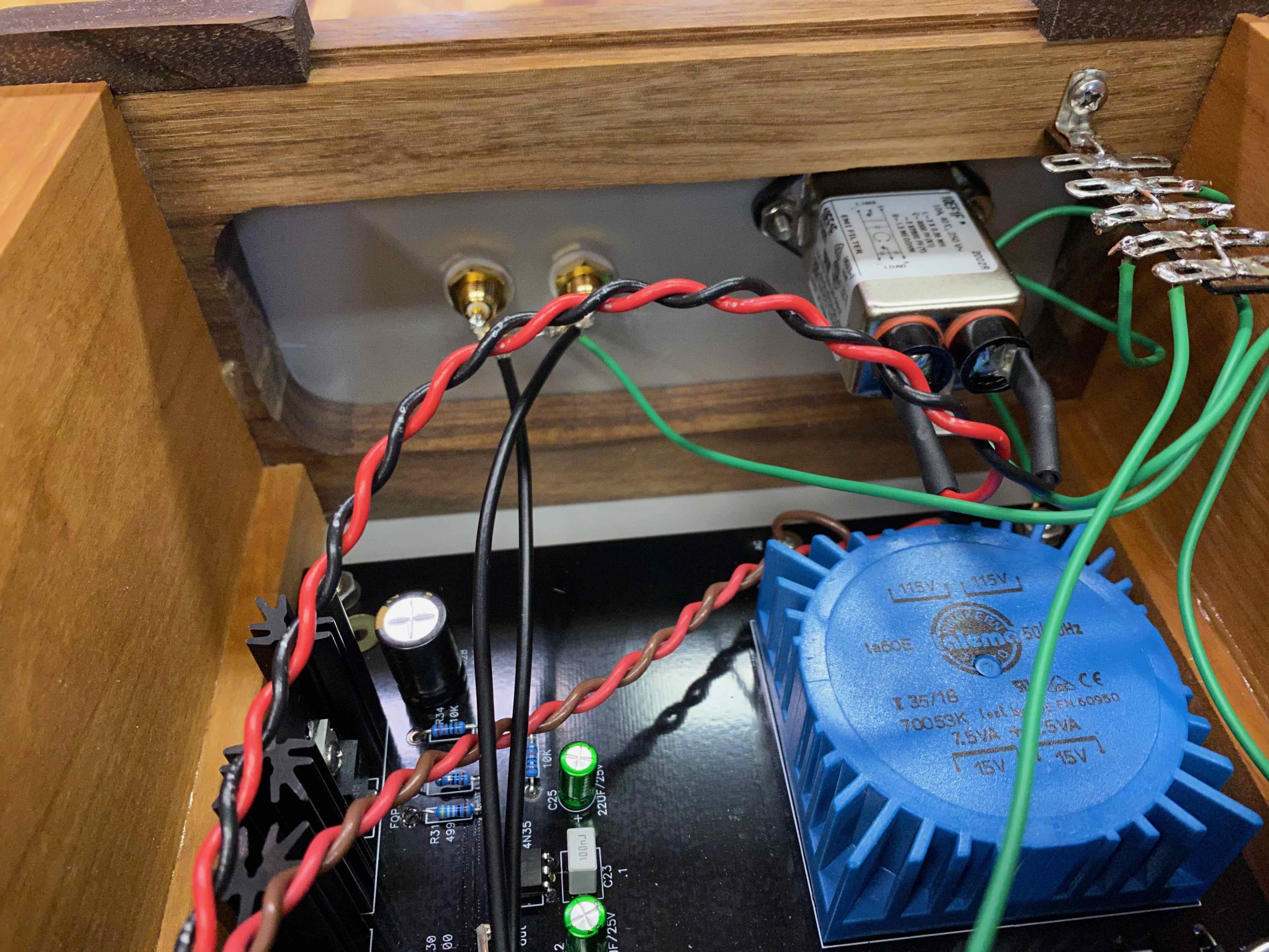

Great design, fun build - but have a hum/buzz
Not sure where I'm getting it, but I've got a hum/buzz. This isn't my first build, I normally build tube amps, and know the importance of ground loops and star grounding. BTW love the design and was looking forward to this build for weeks.
I searched this thread for other "hums/buzz issues" and did see several, but all were around shielded cable (which I used - micro coax) and grounding (which I did a star ground scheme - green wires. Moving the twisted wire AC run to the front panel switch didn't make it better or worse. I also have ground runs to each metal panel as well as a ground point in the middle of the PCB. The RCA jacks are isolated from the back panel. The 1/4 phono jack isn't isolated, but grounded to the coax as well as to the star ground. I didn't use coax to the Pot, but did twist leads. I can't believe not mounting the Pot to the PCB directly could cause this much hum.
The hum increases with higher volume, it's there where I have the inputs connected or not. Bad enough that it's not really usable - very sad. I'm wide open to ANY ideas. Pictures attached.'
Thanks in advance,
Michael
Thanks in advance,
Michael
You have the ac ground connected to signal ground and a couple of loops going on. The center ground should go just to the headphone jack. Isolate the ac ground by Connecting a .01 - .1 cap from the ac ground to the input jacks. See the build guide by 6L6.
Thanks Wayne, BINGO!! I should have know better about the direct earth ground to RCA grounding without the 0.01u Cap. That and removing the star ground too the output jack did it. Clear and clean as a whistle. Thank you.

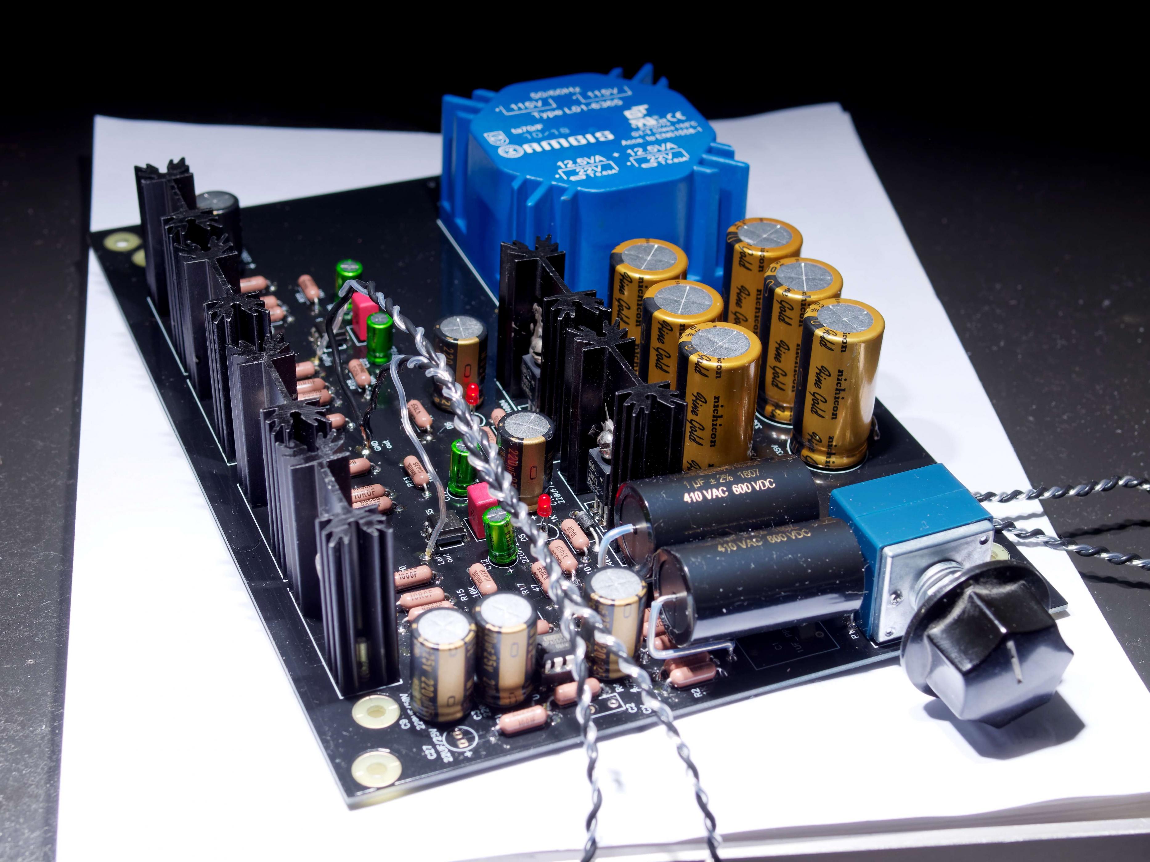

Different regulated voltages on the + / - rail
My Whammy got ready tonight and works fine.
However, I have slightly different regulated voltages on the + / - rail, + = 16.63v and - = 16.91v.
I built the Configuration 2 - “LED reference” and used Motorola MC7815CV / MC7915CV as a voltage regulator.
I measured the regulator before installation and the 7815 has an output voltage of 14.91v and the 7915 has 15.19v, so it is clear that the difference of +/- comes from the voltage regulator.
What can I do to get the same +/- voltage? Without filtering voltage regulators.
Hi Roland,
I'm just a beginner in DIY electronics, but I'd try shunting the diode D6 with a resistor, effectively decreasing the voltage boost done on your MC7915 since that one is a bit too strong.
D6 drop = 16.91-15.19 = 1.72V , so roughly 20mA, which is behaving as a 85ohms resistor in this case, to my understanding.
So if you want to loose 0.3V from that 1.72V, you'd need the equivalent resistance to drop to 71ohms.
-> Try adding something close to 420 Ohms in parallel to D6.
Or maybe wait for some guru advice, I'm just playing in the sandbox here 🙂
7800/7900 regulators have a fairly wide output specification. They all are a little different. Don't worry about it. 😀
