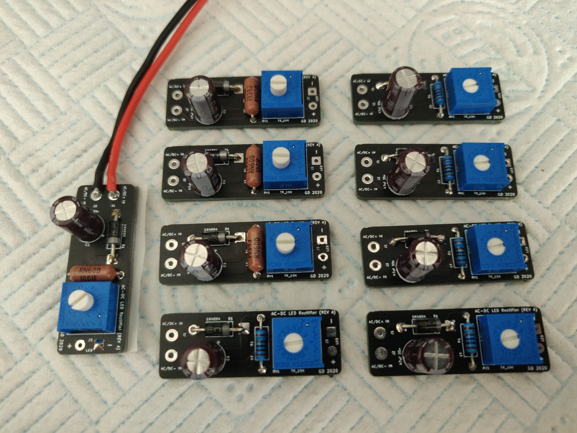

I just thought I would share the LED rectifier of a completed board for those who are interested. 🙂
I need like 4 of those really bad. Any time frame for orders.
Has anybody calculated how long it will take for the supply filter capacitor to discharge, in the LED rectifier circuit of post #2264 ? That's how much time the LED spends, gradually dimming from on to off. Make sure you choose a trimmer setting which puts a reasonable amount of current through the LED. 4mA? 8mA? 2mA? You decide. Then use that trimmer setting in your discharge time calculations.
I have tested it with various input voltages and it has a brief fade in and fade out effect. As long as you don't go above 30v input voltage there are no issues. It does the job it's meant to do. End of story.
If you're happy with a brief fade in and fade out effect, then: you're happy. Congratulations!
Others may want instantaneous off and on, such as post #2262 for example. Those builders may wish to slightly modify the circuit, or choose different component values, to get whatever amount of fade-out dimming they prefer.

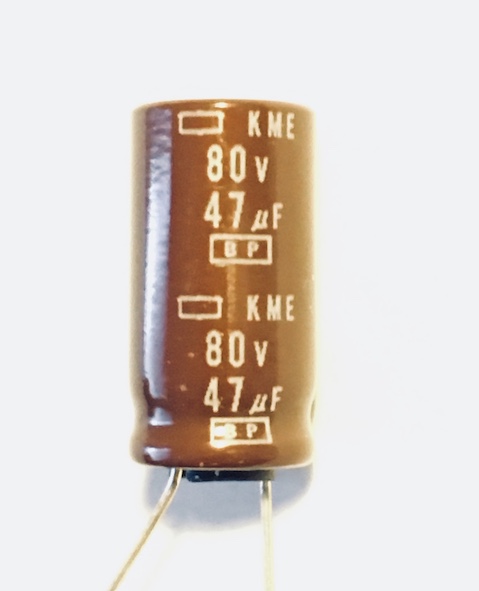

As a bipolar capacitor I unfortunately only have the KME 47uF / 80v BP.
I will first use FC 25uF.
What would be the first choice for C12 / C17 / C22 / C25?
The Nichicon UES or others?
First choice would be a capacitor of proper value, that fits the PCB. 😀
Anything past that is subjective and open to personal taste and biases. Use what you want and what you think is 'better'.

Of course I meant 22uF FC's, not 25uF.First choice would be a capacitor of proper value, that fits the PCB. 😀
I will order and try 22uF UES and a few other interesting bipolar capacitors for my next order.
