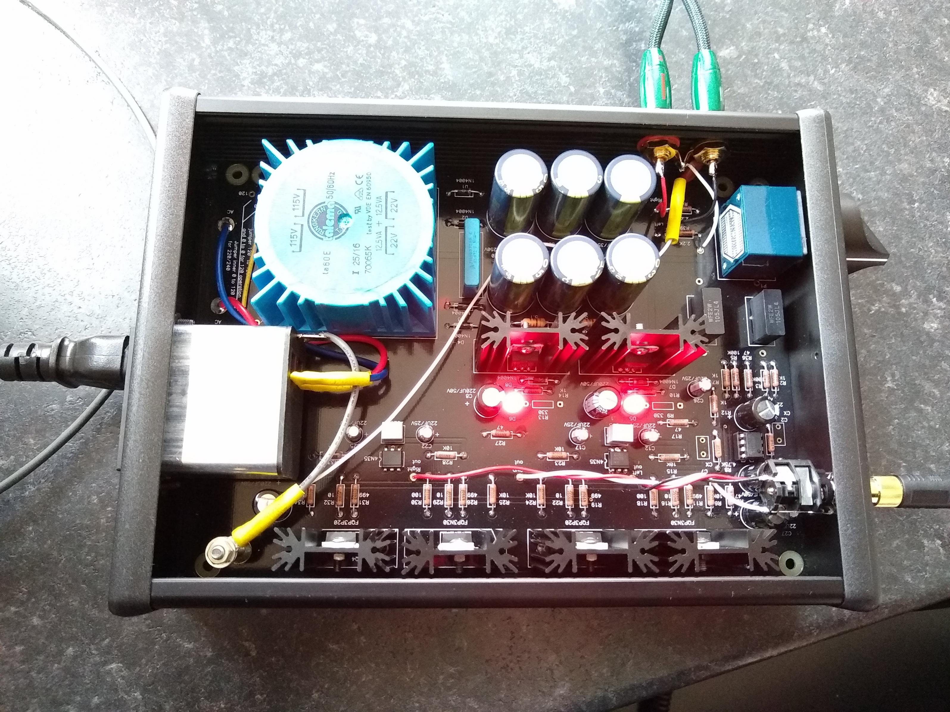

I wanted instant-on, instant-off behavior from my front panel LED, so I connected it straight to the AC from the transformer (with a couple of other safety items). It did exactly what I wanted: no graaaaaaaaadual dimming as the supply filter caps slooooooowly discharge.
See post #1530 of this thread for a photo.
This is an awesome idea and even I have some 1N4148 diodes and I wanted to use this logic to power the front panel LED switch 🙂
So from the pic how did you connect the diode in series to the hot AC wire (I meant the anode/cathode) and I think I can use a resistor of like 470R in series with the neutral AC wire or is it too low as I do not want a bright LED. I have couple of amps with 0-12VAC secondary which I usually use to power the speaker protection board. I intend to use this AC secondary winding for the LED.

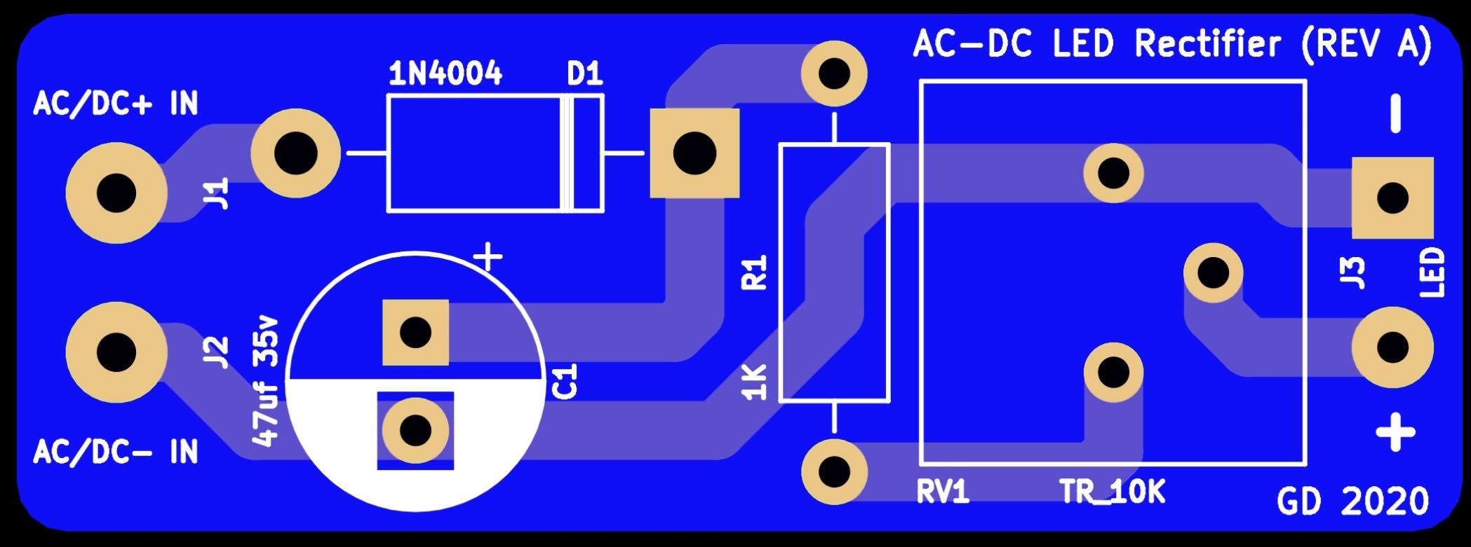

That's what I made these for.... 🙂 You can either take straight from the AC or from the DC side of the circuit. And for those with OCD, it looks neater. These also have a trim pot so you can adjust the brightness of the LED on the fly too 🙂

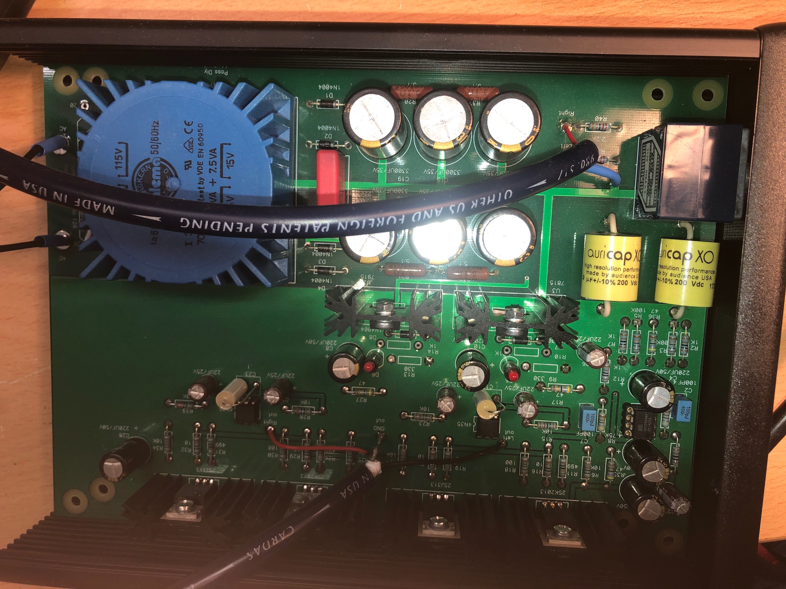

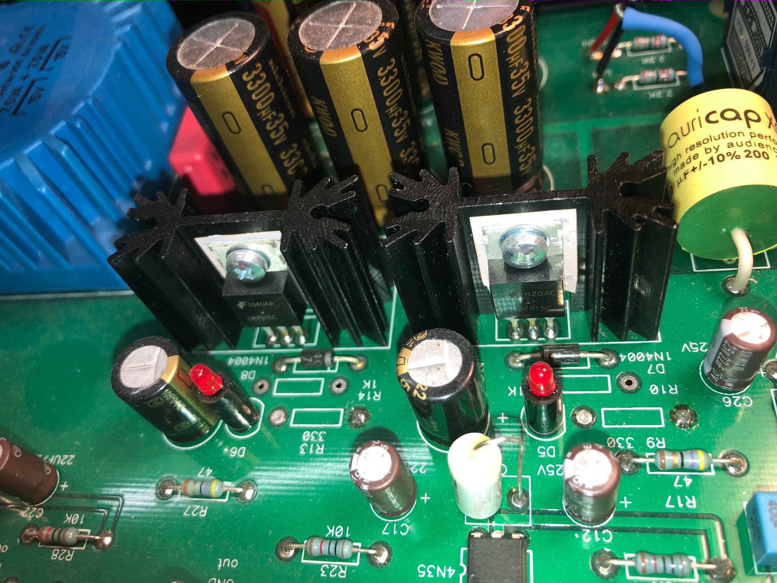

Dear Whammy Builders,
I wanted to get some feedback on a behaviour of my Whammy before I button up everything. There are three observations where I am curious about some feedback:
1. D6 lights up after switching on, but dimms down after half a second. D6 is darker when I leave the Whammy on
2. Noise. Whammy is buzzing, when I turn the Volume Pot the noise increases until I have reached 2/3 of the potentiometers capacity, at this point noise drops suddenly and increases again. When I reach 3/3 (turned to the right side as much as possible) the noise goes away. Is that a grounding issue and should go away with proper grounding in the case?
3. Offset. I have an offset of 0,08 mV left and -1,14 mV right. Both values are very low, but very different channel by channel. What can I try to get to the same levels both sides?

In my experience diodes have to be matched (just measure voltage drop across resistor and 9V battery with diode connected) if you want them to be the same brightness.
My whammy also have similar DC offset ....at least-little more in one channel..i think its depend on opamp. 1.x mV- nothing to worry about.
Thanks for the quick feedback. Yes, overall the DC offset looked very very nice, the difference between the channels was interesting. And yes, I can confirm at least, that the mentioned values where those which I've seen on the meter. 🙂

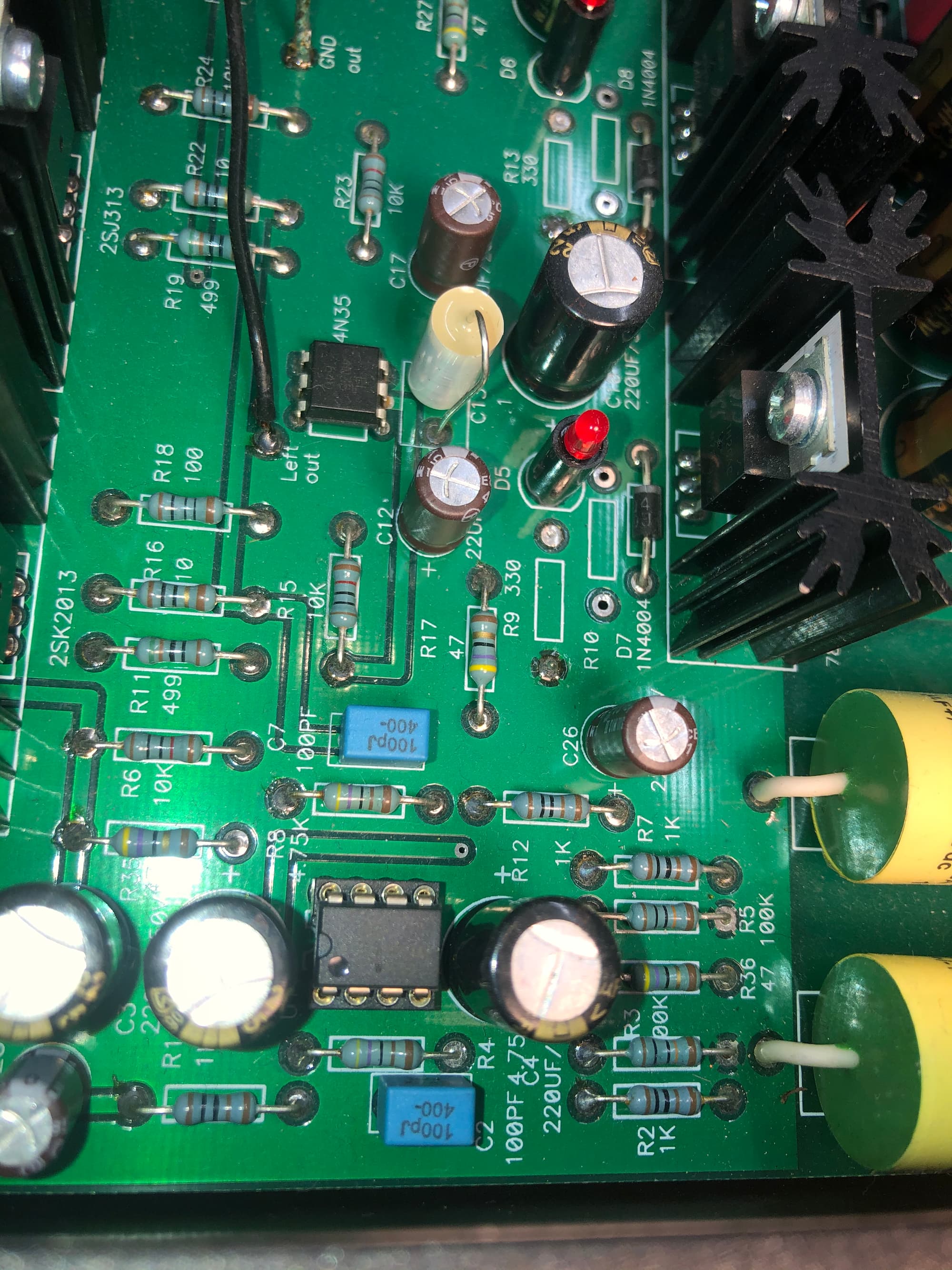

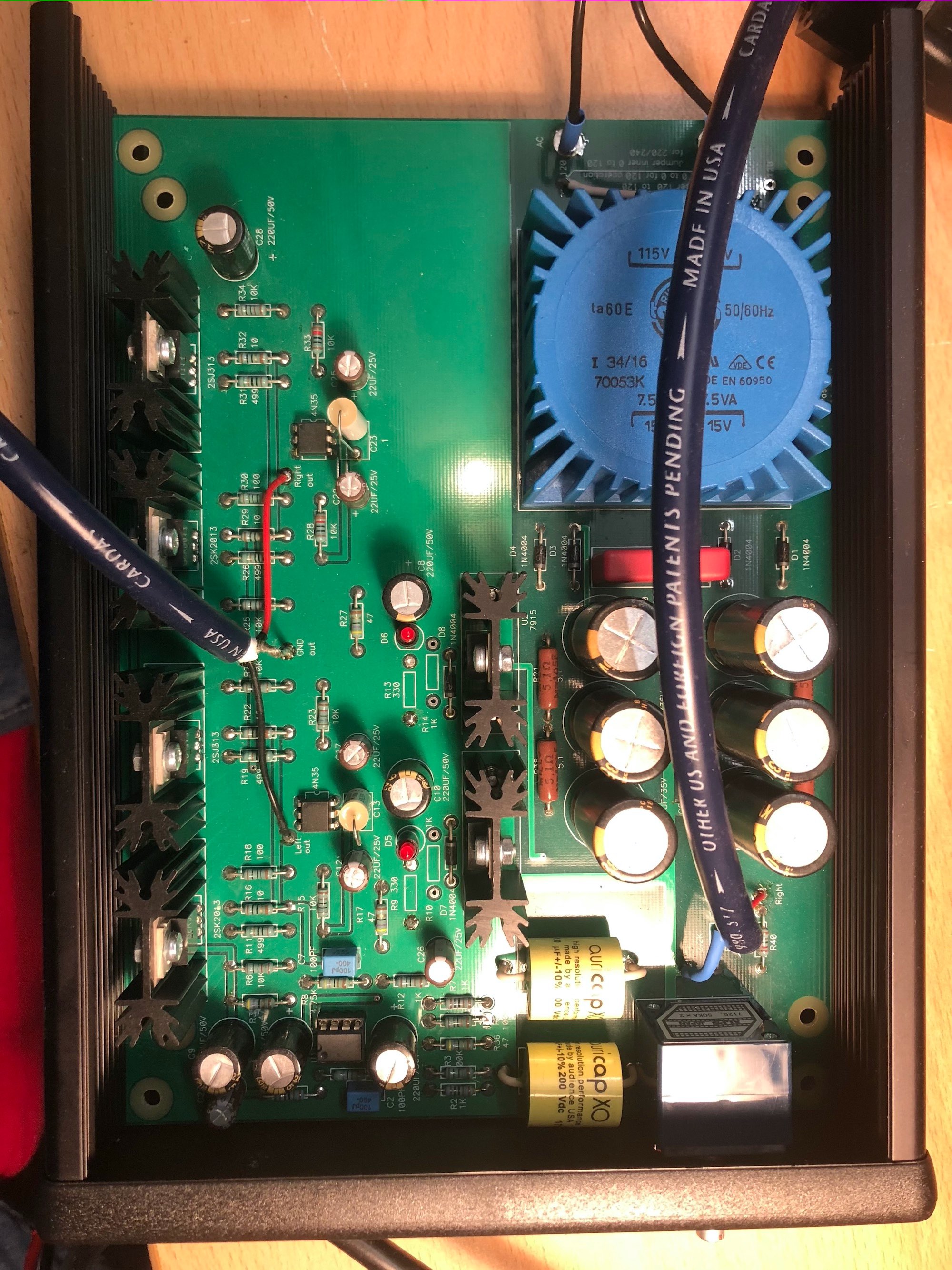

Please find attached some pictures. Many thanks again for your help!

Remove C7 and C2.
Remove the plastic bezel from the front of the chassis. Sand or scratch off the anodizing on the front plate where the pot touches it and where the front panel meets the sides of the chassis to make the chassis parts all at the same electrical potential.
Need to see the back panel.
Do you know the exact manufacturer/series of resistors? I ask because the color bands are clearly legible against their background in photos... that’s really helpful! I need to try them.
Thanks! I removed today C2 and C7 and scratched off the anodising. No buzzing or humming anymore --> it is now dead quiet even with highest amplification; Even with unfinished case and the wildest cabling you can imagine.
DC Offset left: 0,11mV
DC Offset right: -1,08 mV
Will post pictures later. What would you recommend. Leave it as it is, or try to get to equal measurements for both channels (Supply Voltage and DC Offset)?
