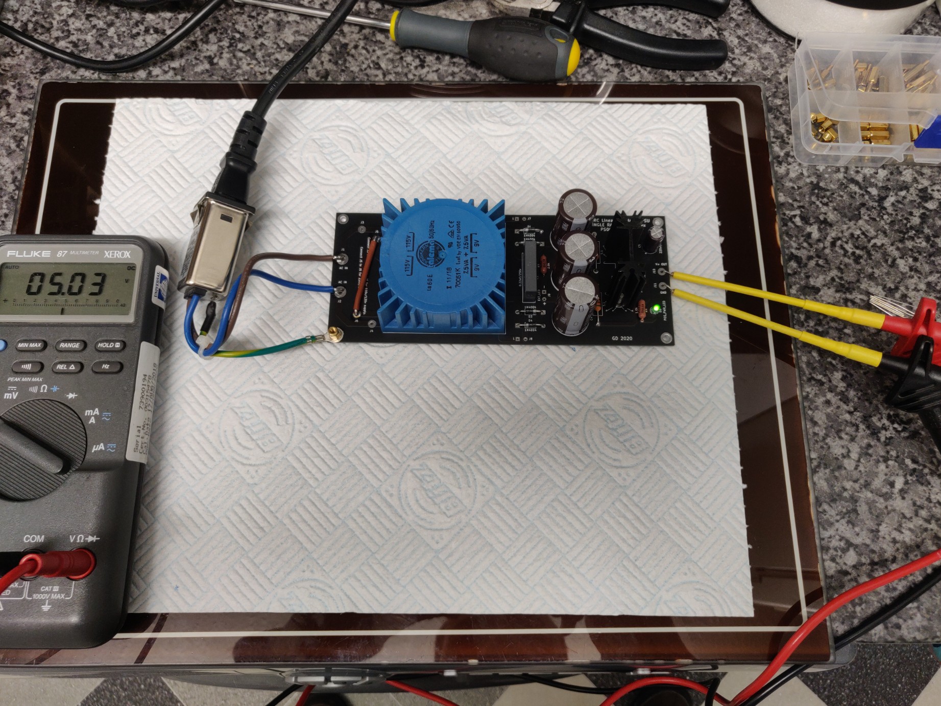

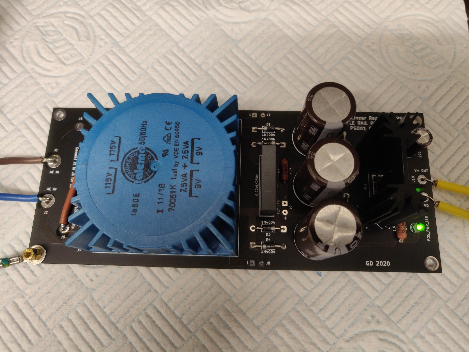

Hey guys. I have been getting handy with KiCad just lately and made a few power supply PCB designs based on the one on the Whammy and I also made a PCB of the circuit 6L6 posted which provides a rectifier to drive an LED for power on indicator.
I got some boards made of the single rail positive power supply and the LED rectifier and I am just awaiting the components from Mouser so I can build some for testing.
I made an alteration to the schematic 6L6 posted on the rectifier and made the addition of a 10K trim pot so you can adjust the brightness of the power LED on the fly.
These designs aren't just useful for the Whammy but can be useful for many other future projects.
I also did two types of the dual rail PCB. One with a positive and negative supply which is pictured and the other which is dual positive which is useful for building standalone linear power supply boxes.
Let me know what you guys think. 🙂

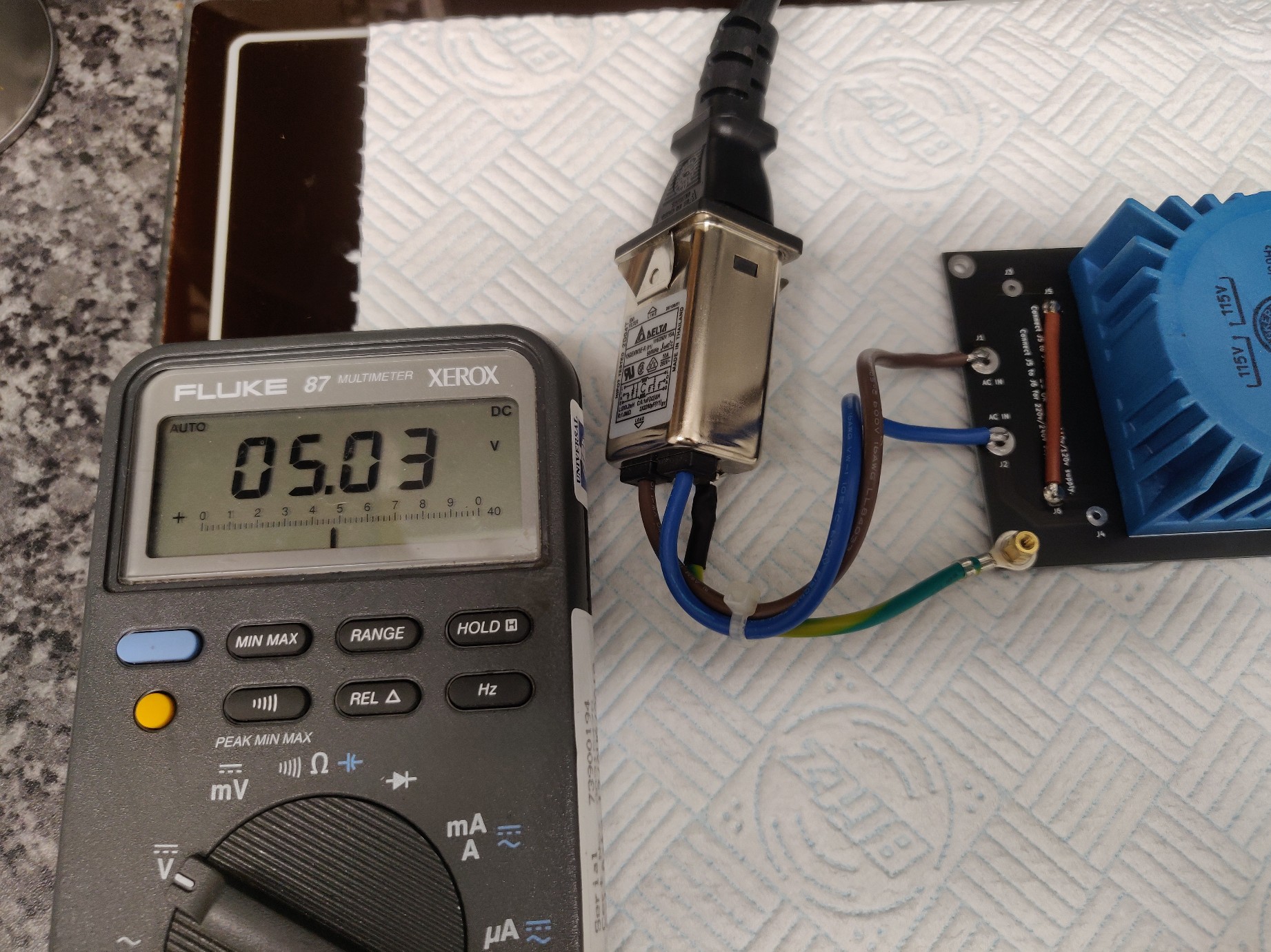

I got the single rail board built and up and running. It works sweet and would be a good PSU for anyone that just needs a positive supply that's dead quiet. I need 2 of these boards for testing so I got 8 boards left. 🙂

I have the Single Rail Positive Output as pictured and the LED Rectifier boards available.

I only have single rail positive at the moment. I'll be getting dual rail boards manufactured soon. Are you looking for positive/negative dual rail or positive/positive?

No because the pinout is different between the positive and negative regulators that's why I made 2 separate boards.
The dual positive one was made for people who want to make just a power supply in an enclosure to power multiple devices.
