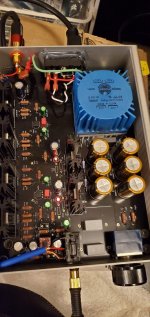

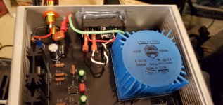

Here's my WHAMMY. Thanks to Wayne for a fun project!
Thanks to Jim (6L6) for the great build guide and parts list!

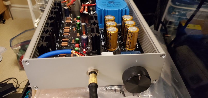

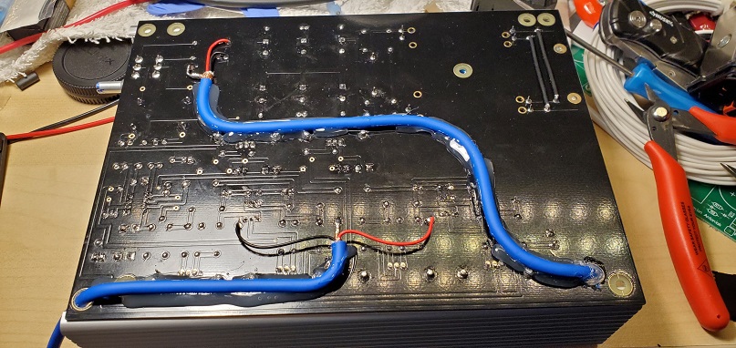

Not that it matters even the slightest bit when the lid is on, I didn't like the way the input and output wires crossed back and forth so I decided to run mine under the board. I considered drilling a hole in the big empty space at the back for output but couldn't decide if I was going to try and fit a big fat switched/filtered/fused Schaffner power inlet module and went with the $ friendly option at the end. Instead of drilling through the middle of the board - because I couldn't see any traces/tracks due to the black silk screen (can't see throught it), I decided to just drill through the mounting hole instead. One in the front for the output and then one in the back. It made connecting the inputs a bit tricky but not a big problem.
On the front, I ordered a black Neutrik locking connector but again, decided to go with the $ friendly option but mostly because I didn't like the idea of trying to drill an almost 1 inch hole in such a thin faceplate.
I've got 3 or 4 (5?) other headamp builds in mind so I'll save the nicer parts for one of those.

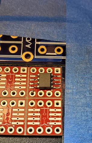

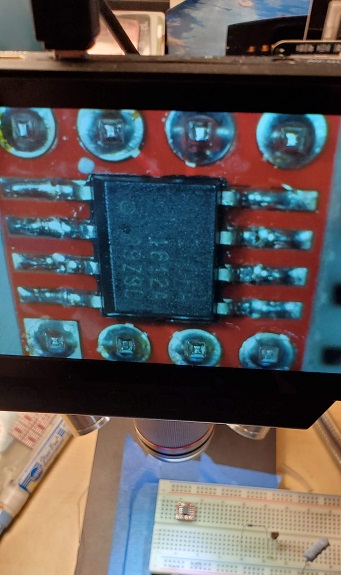

I installed a vintage LM4562 to begin with and found it to sound a bit brittle right out of the gate, which smoothed out over the next hour of listening. A great test is Norah Jones - "Don't Know Why" at 1:13 - there is audible clipping in the recording that I hear in all revealing systems. This is an acid test of course, not to say it sounded bad at all. It was very enjoyable but it was very late so I packed it in and got the itch to attempt my first SMD soldering - OPA1612 into Sparkfun SOIC-8 to DIP-8 adapter from Digikey (4.50 for 4 pcs). I finally got the chance to use the Aliexpress LCD microscope, which performed great!
I am enjoying the OPA1612 and being completely unfair to the LM4562 in that I'm letting it burn in now before further evaluation but found it very enjoyable (much more so than the LM4562) but will come back and try it again after I get used to the 1612.
Anyway, TLDR right? Everybody just comes for the pictures so I won't keep you waiting any longer. Enjoy!
Oh, right - because someone will ask - I tried HE400i, Grado SR80 and AKG Q701. I like the sound of the AKG the most but the bumps make my head hurt rather quickly so the HE400i is my favorite ... although I was burning it in with the Grado SR80 and am enjoying it very much as I type this 😀 (Listening to Billie Eilish - Just No Time To Die).

Routing the wires underneath... I love it!!!
Looks really good, well done!
Enjoy the music. 🙂 🙂 🙂
... and yes, I did the old 'measure once and cut way too much' with the inlet cutout. Glue gun to the rescue! Barely visible from the outside.
Next builds in the line:
Elekit TU-882R (thanks Victor!)
F4 HA boards that I built 12 years ago (time to go into a case)
Aleph Mini (BrianGT black boards) Aleph-H build, convert to a AJ-H (AJ-H?) and substitute Cree VFETs
... I'm sure something else will come up

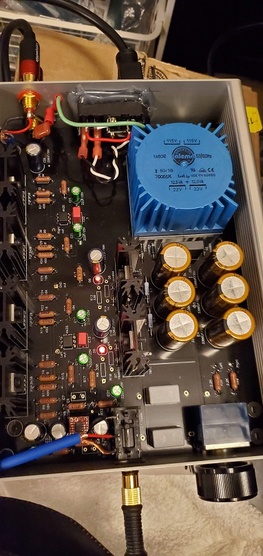

Never completed a headamp before so let me know if this is good, great or just ok. Offset is stupid compared to what I'm used to - 0.5mW and 0.6mW. Measured with pokey pokey probes instead of hooks but I can measure for real if I should.

Very nice build !

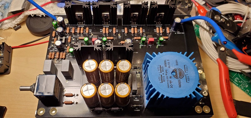

I keep thinking that whammy board was made with the bigger side for the front (where the transistors are placed)
But when I see the pot placement it gets me confused 🙂
Enjoy the music

Congrats twitchie on your build. I've been through 8 different opamps and keep coming back to the OPA1612 as the one that sounds consistently the best no matter which type of headphone I throw at it, open dynamic, closed dynamic or planar.
