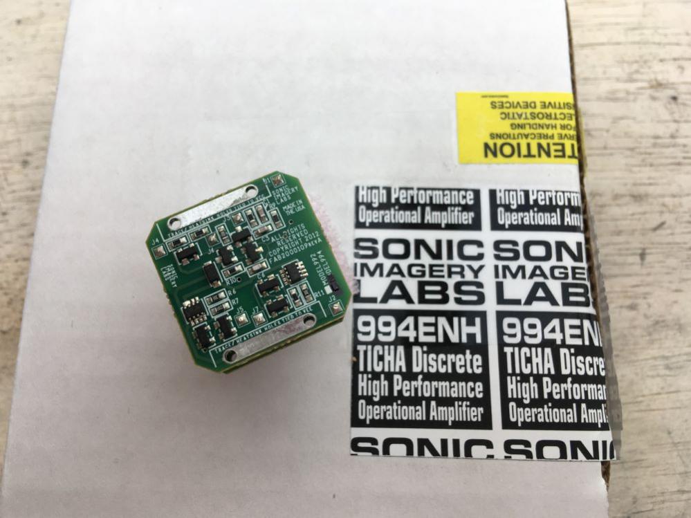

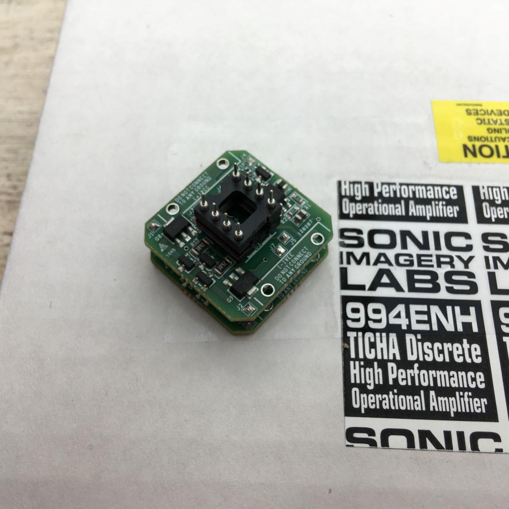

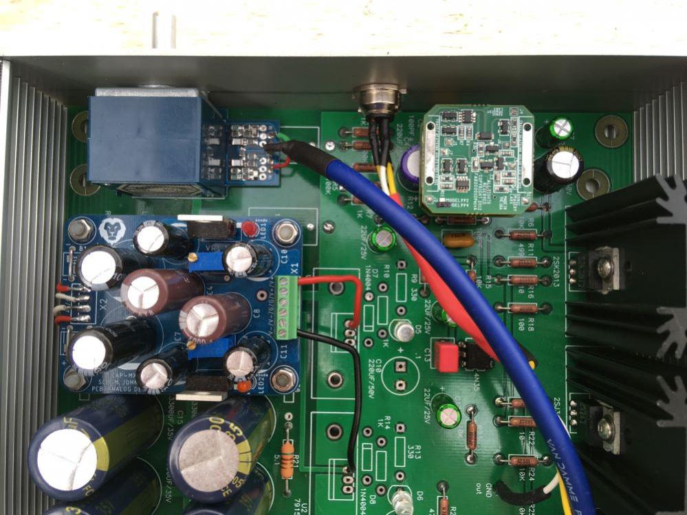

The Sonic Labs 994Enh Ticha op-amp arrived today. Nicely made bit of kit 🙂
Listening to it now as I write... Out of the box it sounds very good. Vocals are sweet and clear, smooth mids, nice punchy bass. I will leave it on for a few hours to burn in.
The 994Enh can run on +/-24V rails so have upped the Cap MX output to +/-17.5V for now, The MX has very low drop out so will push to 18V later leaving just under 2V for the MX. Right now I wished I had gone for 18V or 22V transformers for the extra headroom!

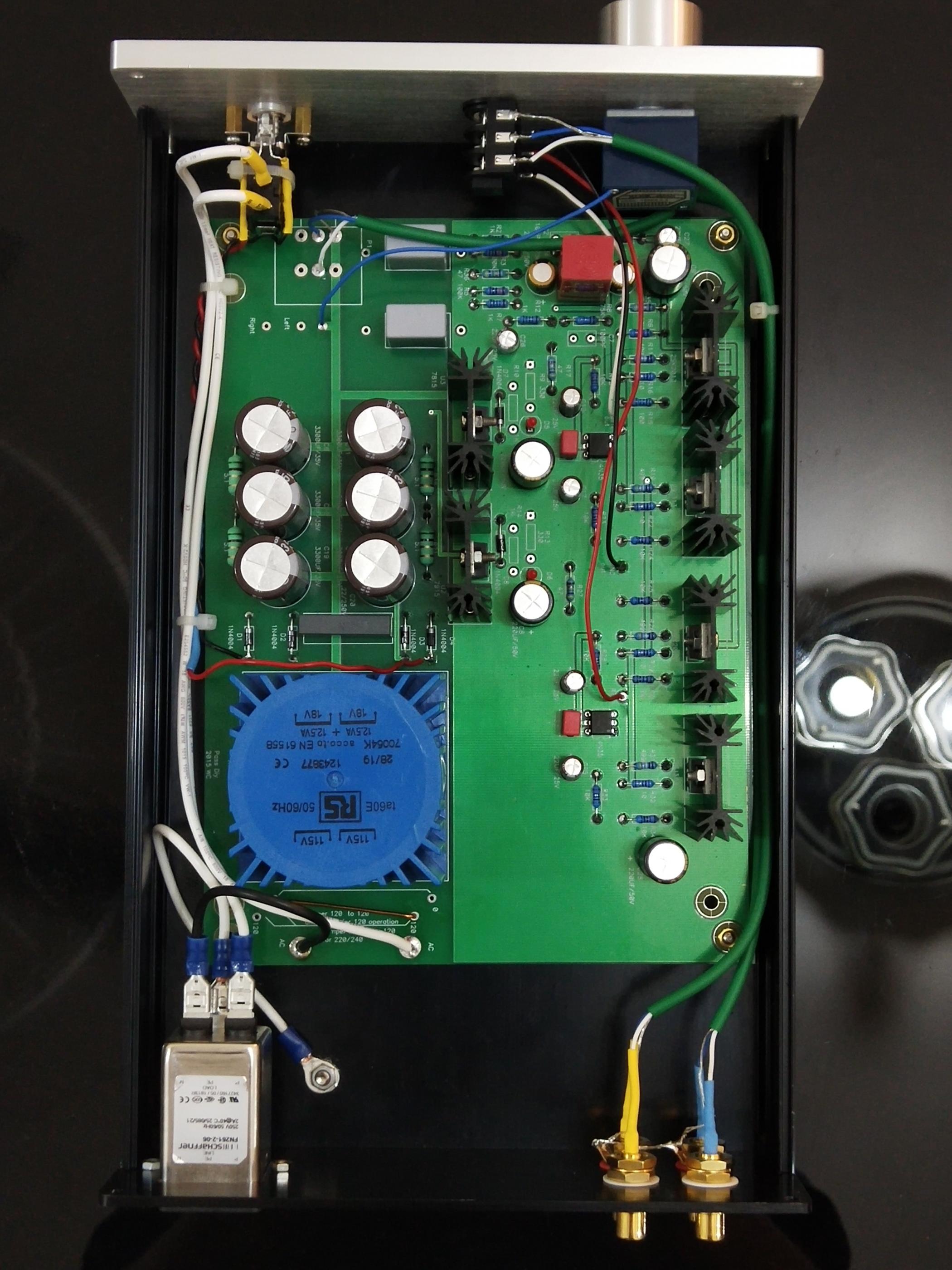

passive420,
What is the purpose of the pcb/circuit attached to the alps?
The small circuit attached to the pot is a Danyuk passive crossfeed module supplied by EUVL as part of his kits.
It works by mixing the channels slightly with a frequency delay effect that will ideally make the music image more comfortable and 'realistic', in the sense that the sound is more in front of your face as it would be with properly placed speakers. There is depth to the sound, vocals at the front, instruments slightly recessed back... it works well with some recordings and definitely with a good film score and dialogue. You can certainly listen for longer it seems.
I do like the crossfeed but having the option to switch on and off would be good.

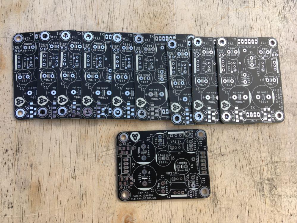

For anyone interested in trying a Cap Multiplier board in their Whammy, some more PCB's have arrived. Rest of the components are still to come but the new boards will be supplied with all SMD parts fitted, 2 x 1K Bourns 3296 trimmers plus TIP41/42's and a few caps.
Cost per PCB kit is £10, standard shipping anywhere is around £5 tracked is around £10

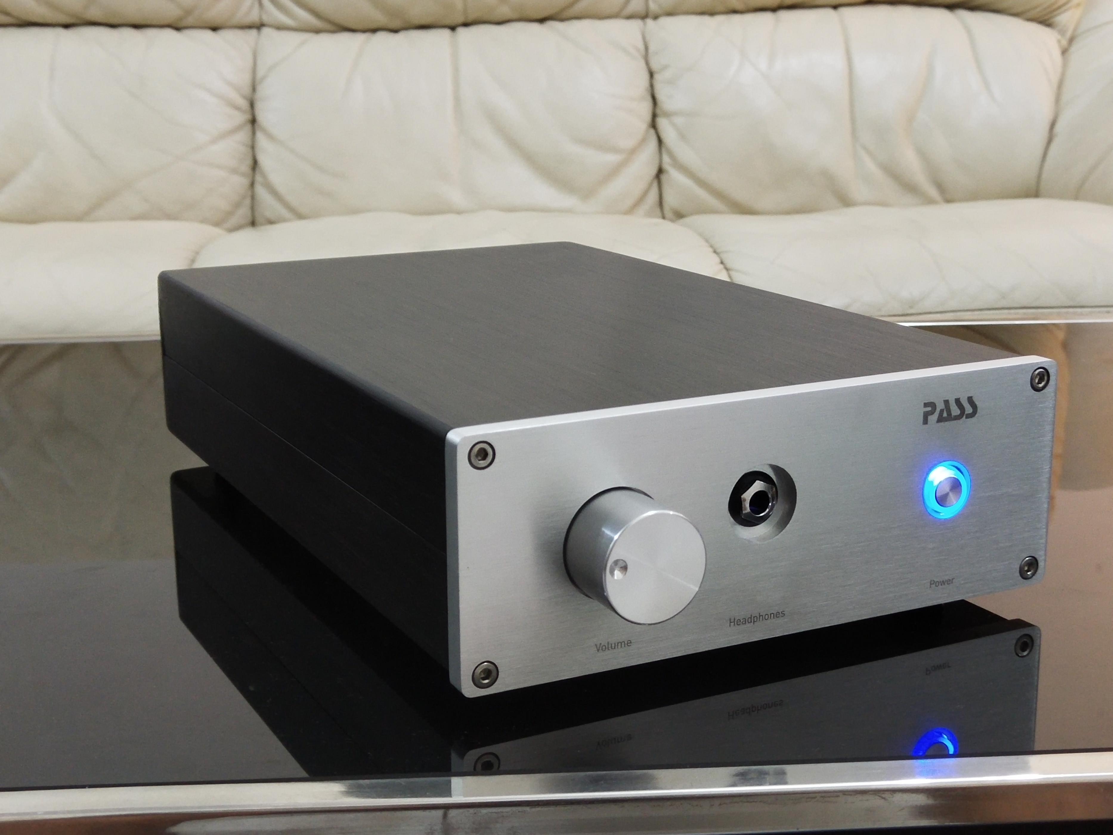

Special thanks to Mark Johnson for the LED tip (just the tip mind you, and only for a minute - quote by unce bumblef***).
Of course it's blue, it's a Pass amp 😉
