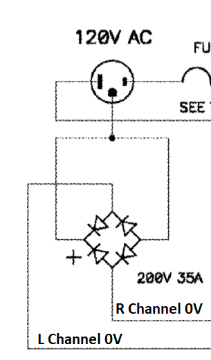

Here is a ground isolation circuit. The most important thing is to get a good hard earth ground to your chassis like Jim (6L6) stated. Remember anodizing is insulating so scrape and check with a meter. This circuit will help prevent ground loops yet carry fault currents.
To me this looks like a better method of isolating ground loops in a dual mono single chassis setup compared with a couple 20 Ohm thermistors.
Is that a fair assessment?

Yes it also has been UL, CSA, etc tested.
That's great to know.
When I have seen a bridge used to isolate circuit 0V from chassis earth, the chassis earth was connected at the centre of the bridge so that current travels when the forward voltage of the diode is exceeded. An example is attached.
In your circuit current passes through the first diode when the forward voltage is exceeded, then it must exceed the reverse voltage of the second diode in series.
Before I start using this everywhere, is this the correct orientation of the bridge?
I'm assuming there is no mistake here. If there is a fault condition and current flows through the diodes, will the diode that is reverse biased fail and the bridge need replacing?
I am not sure what to expect if the reverse voltage of a diode is exceeded, having never operated a diode like this.
Also, i wanna try using bjt outputs such as MJE2955/3055 pair. Is there anything on the circuit i should change?
This is a little different than the circuit I had posted. In the one I had shown before there is two diode drops and you won’t exceed reverse voltage because the other diodes will turn on. The circuit must pass twenty amps and blow a fuse or breaker that’s why a thirty five amp bridge is used. It’s also in our stock room.
So that vertical black line through the bridge is actually an electrical connection, allowing an electrical path to the other forward biased diode?
Please say yes. My brain is straining hard core. Actually don't say yes if that's wrong. Hahahahaha
I will attach the circuit again.
Alternatively you could rotate the bridge anticlockwise 90 degrees.
